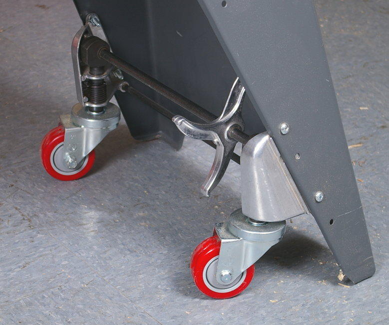

Popular Post John Morris Posted December 16, 2018 Author Popular Post Report Posted December 16, 2018 Just read the reviews on the new style casters and folks seem to like them a whole bunch. I'll need to remove the existing axle and wheel assembly, drill new holes up about an inch and three quarters, then remount the axle assembly with the new casters. The added inch diameter needs to be accommodated for thus the reason to move the axle assembly up. New users of the casters state they are moving their machine around with ease. Cal, HARO50, Grandpadave52 and 2 others 5 Quote

Grandpadave52 Posted December 16, 2018 Report Posted December 16, 2018 12 minutes ago, John Morris said: I'll need to remove the existing axle and wheel assembly, drill new holes up about an inch and three quarters, then remount the axle assembly with the new casters. Do the new ones still use the over-center (???) springs? I assume those springs act as an assist to lock/unlock versus some type of cushioning suspension? Never seen a set-up quite like that. I do have a set of the first picture Wood River wheel set (bought from Woodcraft 3-4 y/o) I installed on my old Craftsman TS. They work well. John Morris and Cal 2 Quote

John Morris Posted December 16, 2018 Author Report Posted December 16, 2018 14 minutes ago, Grandpadave52 said: Do the new ones still use the over-center (???) springs? I assume those springs act as an assist to lock/unlock versus some type of cushioning suspension? Never seen a set-up quite like that. I do have a set of the first picture Wood River wheel set (bought from Woodcraft 3-4 y/o) I installed on my old Craftsman TS. They work well. I think they are more of an assist Gramps in letting the machine down lightly when the star lever is kicked to down position, then when you want to move the machine, you kick the star lever to raise it up. Cal and Grandpadave52 1 1 Quote

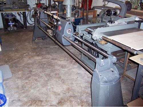

Grandpadave52 Posted December 16, 2018 Report Posted December 16, 2018 Thanks...that picture clears it up. Those casters being wider, larger diameter and the composition will make a big difference. If I had the space/place I'd own a SS... Saw this deal on CL yesterday. John Morris and Cal 2 Quote

John Morris Posted December 16, 2018 Author Report Posted December 16, 2018 3 minutes ago, Grandpadave52 said: Thanks...that picture clears it up. Those casters being wider, larger diameter and the composition will make a big difference. If I had the space/place I'd own a SS... Saw this deal on CL yesterday. I love mine, been kicking the tires with small honey do's around the home, and I am quite happy with it. There is a trade off, between stationary and the Smith, but if space is an issue, and you are willing to have an open mind over it, it's a great little machine. Remember, you can roll out to the backyard and do your work, you can roll onto the job-site, you only need a small corner to store it and cover it. Grandpadave52, Cal and HARO50 3 Quote

Gene Howe Posted December 16, 2018 Report Posted December 16, 2018 19 minutes ago, Grandpadave52 said: Thanks...that picture clears it up. Those casters being wider, larger diameter and the composition will make a big difference. If I had the space/place I'd own a SS... Saw this deal on CL yesterday. For that deal, I'd make space!!! HARO50, Grandpadave52 and Cal 3 Quote
