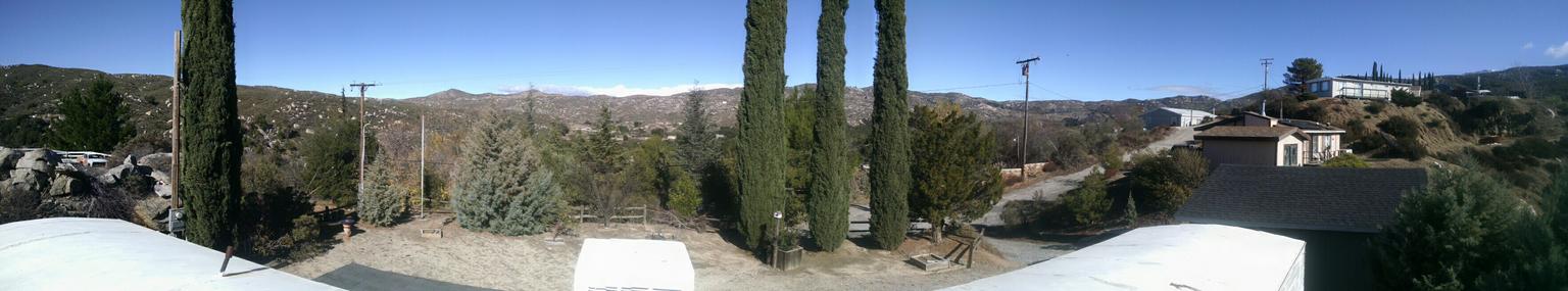

Panoramic view of the valley from the top of his roof, this is also the view from the addon out his window, as he watches tv and engulfs his TV dinners, hey, at 85 yrs old, he can live how he wants, and eat what he wants!:lol: There's the ol man at the lower right of the image, inspecting the roof.
Panoramic view out the front way, off the top of his roof, the white above the hills in the background is the San Bernardino Mt Range snow capped.

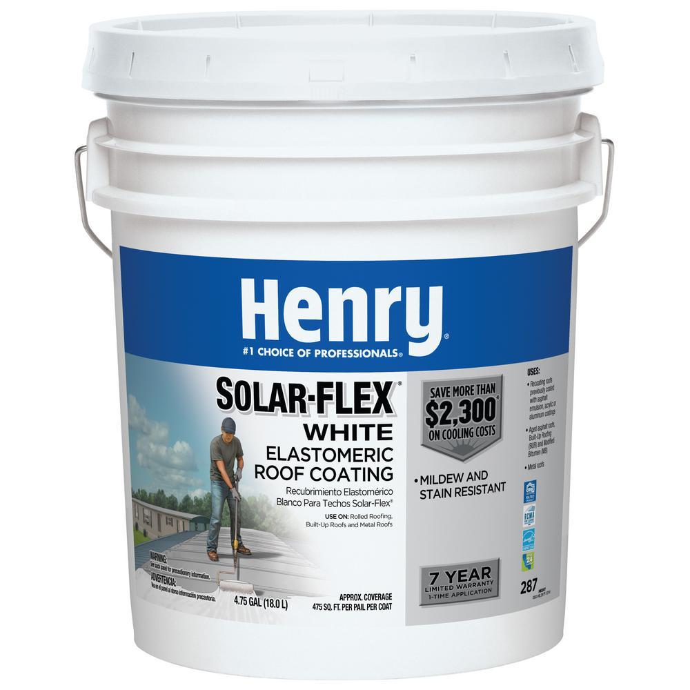

I wish to thank everyone for their in depth expertise and advice for this problem we were having. The roof coatings suggested in this topic by many of you, were not available at the time we needed them, at Lowes nor HD. I looked into getting the Black Jack coating shipped but the shipping was more expensive than the coating itself.
So I head up the mountain, hitting Home Depot on the way up, to look for any coating, any coating at all that seemed reasonable in price, and a good application for our needs. So while walking up and down the HD isle of roof coatings, and with Dad on the phone, we settled on this:
henry-reflective-roof-coatings-he287sf87
I delivered it up the hill, and I walked it up the ladder to the roof as pops has lost much strength in his old arms, but that is as far as I could go with it, he wanted to do the rest of the work, fine by me! He took an old paint roller and applied the coating, it went on nice and thick, and dried completely in a day or two, and we had a huge rain last week and so far, it held! Not a leak in sight!
He did however prep the surface first with Henry's wetpatch, he did slit and nail down the badly buckled areas, wet patch the slits, and then applied the coating.
We will revisit this roof in the spring, we are going to do a full tear off, and inspect the wood, and reinstall a rolled roofing system using Herbs sage advice about the nail pattern. Thanks all again, we ended up using a little bit of everybody's input here to get him dry again, thanks!
