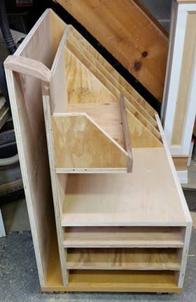

I think we worked through this very nicely, I'll have to add some supports/stop to the small shelves if I add them. Guys, do you see any room for improvement??
I might just go with one depending on how small the area is.

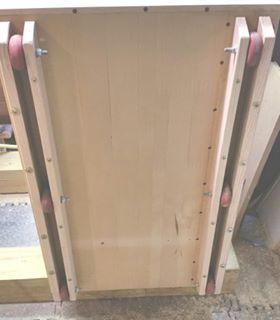

These are the wheels I'll use.

    Lew, after thinking about the design and function I went into Paint and did a realllly rough drawing. Since the cart will live under the stairs thinking it would make more sense to have open access fr
After looking at this again, I wonder if you might need a small support at the top of the space where you are planning to store larger sheets of plywood. Something between the back piece and the next large upright.
Could add a small block on top to keep it square. Kept the top clear of the stairs by a little bit.

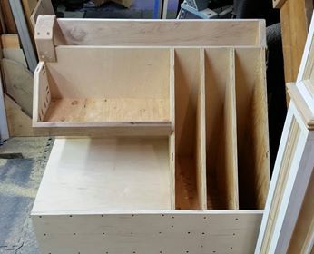

Good morning guys, thought I would post an update to this thread. The project is much further along then this but more important projects have taken up my time. I'll try to get a progress shot later today after I clear out the current work.2018-12-15 17.53.37.jpg
Pat, That looks really great!

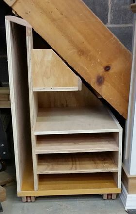

Here is the final version, you'll notice it's all screwed together to allow for changes if need be. Today I'll load it up with all my short pieces. Will probably add some markings for depth and a stop on the open flat shelf.
49054442_385675815533458_92134949177440349343438_1983619601729727_5323953056809749705043_2686198111398294_3611083175331149459797_350622152426797_495652923038603
Looks good - and useful - Pat!  And good on Lew for the sketchup for you.
I like the modifications you made for the small shelves! Looks really good setting there under the stairs!
