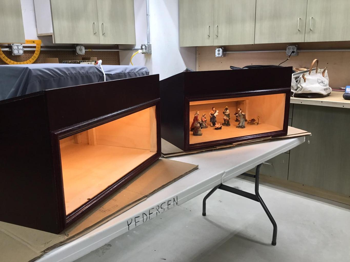

OK, after doing some online reading it appears that staining the manger is/will be, more difficult than I foresaw. Apparently Baltic Birch doesn’t do well with stains? You gotta use a dye, and mix it with water or alcohol? I have a gas burner in my basement, can I safely mix and use denatured alcohol ? The mangers grandpa made were all stained, kinda dark, I’m trying to match it in looks. Any thoughts/advice/ suggestions/ or feed back is/are welcome. Thank you, Artie

Artie, I'm no finishing expert by any means, but you might try some Pre-Stain conditioner. Min-Wax & Varathane both make it as do others, then an oil based stain (I'd stay away from water based to minimize raising the grain especially on the ply) Wipe on the oil base stain versus scrubbing in with a brush. Let dry and re-apply stain to obtain the color/look you want. With this being a relatively small project I'd pass on the alcohol/dye approach unless you plan to spray it which wouldn't be recommended in closed quarters with a standing pilot. Assume you have some scraps you can experiment on? Min-Wax makes small/hobby sized product containers too. You can experiment with 2 or 3 &/or mix some together to get your desired look. My $.02 counting 3 cents tax.:P

Well, if you use dye it might be best to use a water soluble one. there is a downside to this, it will raise the grain (even on BB). That's not as big a problem as you might think....put on the first coat of finish and then sand it smooth (it will be quick). the finish locks the fibers in  and once smoothed you are ready for whatever is next, normally a second coat. As for using alcohol that may be more of a personal comfort thing, but I don't think there is any danger. I have a gas burner in my shop and use shellac all the time with no problem (padding it on, not spraying). The fumes would have to be much more concentrated to cause a problem; but like I said pick your comfort level. You could pre stain like Dave mentioned. This stuff is also sold as sanding sealer, or you could use Zinsser Seal Coat (shellac). Any of these are simply very thin finishes that seal the surface and prevent blotching..which I think is the problem you are trying to avoid. If you haven't used dyes before it will be best to experiment with them some on a piece of scrap.
