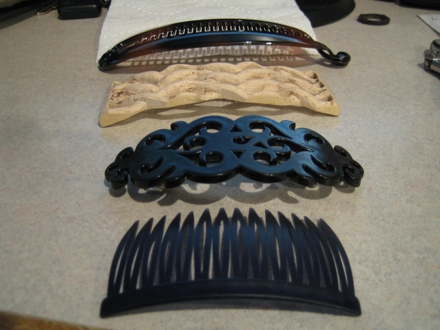

  • Rusty you got it!!  After I took a picture of my wifes hair thingies I thought I didn't want one made of wood to end up looking like the plastic things. And after looking at the things these CNC guys

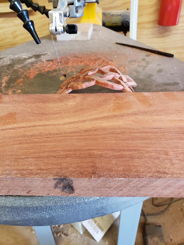

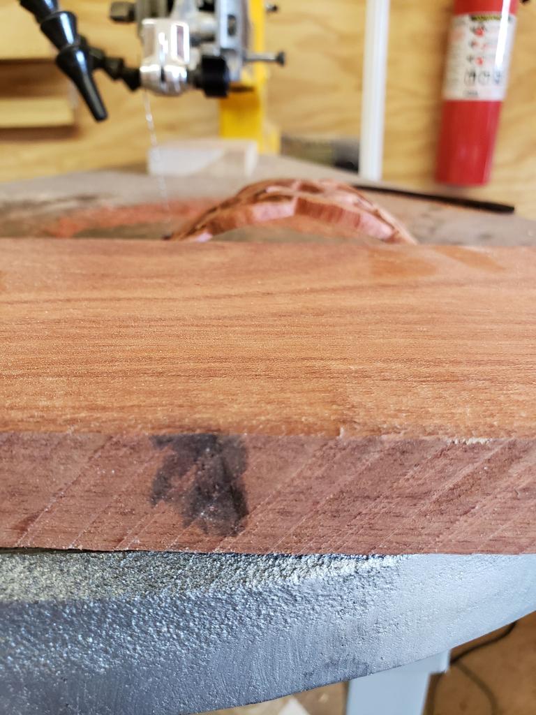

Thanks for the help everybody. I broke it. I went in the shop and found a 1 x 6 piece of bloodwood. I cut three arches around 3/8" thick and then glued them together so it ended up 2.25 inches wide by five inches long with a nice curve. I sanded it on my oscillating spindle sander to a little under 1/4" thick. Then I cut it on my scroll saw. Now I just have some shaping to do and I will post a picture.

How about gluing two 3/4" boards together then draw your lines to be cut on them. Rusty the picture on post # 13 matched the curve of wifes plastic models she uses..How wide is the pieces of wood you are starting with. I started with a board 4 1/4"long. If the curve is to be on a board say 6" long then 2 3/4" thicks boards glued together will make lots of curve..before the scroll saw design is applied to the flat area.
I cut three pieces off the end of a board about 3/8" thick. I glued them together side by side. That gave me what I needed. I got it done and broke off the end that the stick goes through. Third time is a charm.

Rusty you got it!!  After I took a picture of my wifes hair thingies I thought I didn't want one made of wood to end up looking like the plastic things. And after looking at the things these CNC guys make they all seem to look like plastic for their creations ends up too perfect.

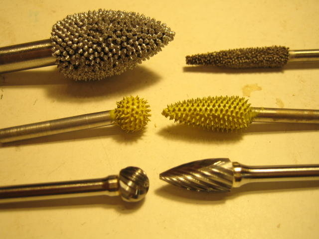

  Are you buying any of the bits www.woodcarverssupply.com sells. Thats where all my bits come from and really get lots of use out of them before they finally wear out.. These four here I bought in 2016 and am still using them every day I turn the Dremel on...
   Oh and to make the flex shaft last  I mix a little auto wheel bearing grease and synthetic motor oil together and add some to the cable. The oldest flex shaft I have was bought before 1992 and gets used every time I turn the dremel on.. Just add  a small amount at a time for if the cable housing is plumb full it might wear out the motor because of too much drag..These 4 bits  are the one I use all the time bought in 2016. 1/8" shaft size and I keep them in a small baby food jar full of lacquer thinner to loosen up the gunk... Then clean them with a very very fine hand held wire brush. Only the tapered one in the flex shaft is what I used on the hair thingy couple days ago.

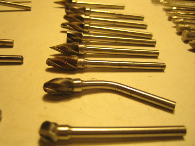

  I just added these last week.IMG_0416.JPG.d3d2e4b39b9cfdfae8c7ed82619ac76e.JPG First time I added any new bits since 2016. The big one is the only 1/4" shaft bit I use and I use it in a small air grinder. The bottom two are tungston carbide and will last longer than high speed steel. Just stay away from any of the high speed steel bits from dremel for they will only last a week or two . After using all the bits showing I then use diamond tipped round type bits to smooth the wood in the course and fine grit.
 A warning on these in the last picture which are very course 1/8" bits, I ordered this set of 1/8" bits in 2016 and they are too course for the are very hard to control and will dig fox holes in the wood and grab and bend the shafts before you can pull them up out of the wood...Only set of any bits I have and not worth what ever I paid for them. Not because of the cost but hard to use..IMG_0420.JPG.f03fb4d7efaa2e5fddf6a434d5d3d06f.JPG
  Also since this picture was taken I have bent two or three more of these course monsters.

Rusty all due respects to Dremel but what came in any of the Dremel kits are pure junk. I think Dremels bits are the reasons most guys that might have a kit from them hardly ever touch the grinders for help on their projects..
  But wait....They have some good bits and they look like the 4 I have in the above picture. In their listings they go by 9,000 series. the ones showing are from Wood carvers supply but look exactly like them  from Dremel. And are almost the same price..I did not order the whole set from Wood Carvers only the 265050,265051, 265081 and 265091..  If they were Dremel numbers 9931, 9934, 9935 and 9936. They call these 1/8" bits Structured Tooth Tungsten Carbide.  I don't know why but in their site a few minutes ago they only show the 9931 and 9935 and all the other numbers have no pictures... I have been telling people the bits are the same but I should have included I have not touched one and not used any of the Dremels so I am saying things I don't know is true or not...
  I don't think Dremel includes the good bits in any of their sets with the grinders...Just stay away from any high speed steel bits.

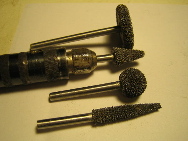

I would also advise to have an extra set of brushes and change them on any brush motors before the tool completely quits running...say once a year change the brushes.... cause if you wait till it quits chances are the armature will be ruined then buying a new tool will be the next step... These Kutzall brand I use all the time then to smooth the wood a round diamond 1/8" bit and or sandpaper and tiny fingers or on a dowel.
If these need cleaning I drop them in a small bottle of lacquer thinner for a while then use a very very small stainless steel wire brush, the ones I use come from McMaster carr and only use the hand held brushes. I guess the local stores like ace might have that small?
