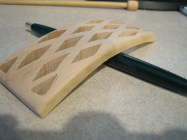

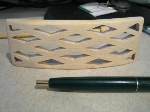

My wife wants me to make some hair clips. I am trying to bend them. Right now I have it under pressure around a piece of pipe. I keep wetting it to keep it from breaking. Does anybody have any good tips for bending wood. This is what it looks like.

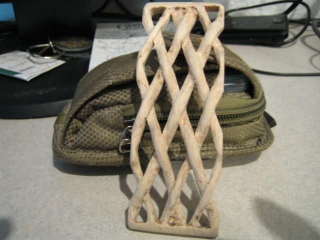

  • Rusty you got it!!  After I took a picture of my wifes hair thingies I thought I didn't want one made of wood to end up looking like the plastic things. And after looking at the things these CNC guys

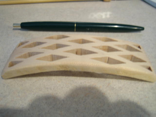

Ok in about 30 minutes I am this far along plus taking photos and loading them. Still go to grind them so it loks like they are going in and out of the pattern...IMG_0937.JPG.0b5039e5916b3e02fca6f05ae45b9081.JPGIMG_0938.JPG.929d6100bf741758b46f6c01e6c5be62.JPGIMG_0939.JPG.885ac8afeb79426dbbbead055a7f62e7.JPG
  I still have to make 12 more holes before I start carving ......And might have to glue a two small pieces on the bottoms for the pin or rod or whats it called to go through the bottom.
Edited by Smallpatch

As small as these hair clips are, well at least my wifes are small, this just seems to be as quick as anything and it won't take days to carve it so it will look like the picture.
This measures 4 x 1 1/2

That is exactly what I did. I cut it out on my scroll saw. Then I shaped it with my Dremmel. All of that was easy. I need to bend it without breaking it.
My bending formula is simply a dollop of fabric softener in tap water. You could use a kitchen pot of water. Bring it to near boiling, cut the heat off, add the softener, stir a little, drop in the hair clip. Let it set for a couple of hours. Take it out and try it on your form. If it doesn't bend easily, repeat the process. If it bends easily, cover it with Saran wrap and secure it to the form until dry.
Remember, wood has a memory so, your form may need to be a little bit more acute than what you want the clip to be..
