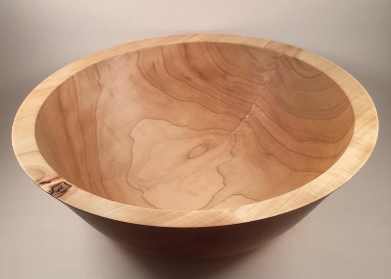

@Steve Krumanaker turned a gorgeous maple bowl and then added to its' beauty by decorating the bottom with one of his fantastic  woodburnings.
 5a578a68e7652_maplebowl2.JPG.78f07e528ace96cba84aa7b01057a2e2.JPG.a25d191800cd71d27f39f457f5319d99.JPG
Steve also answered questions about the woodburning design he used.

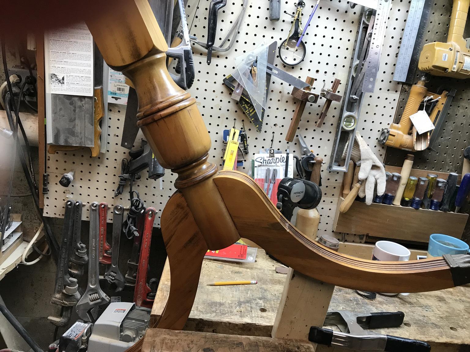

Not much turning for me. I finished the "sure my husband can fix that" project. I actually got to use the lathe for part of it. The broken leg was reattached with dowels but I had to replace some of the wood to eliminate the voids left by the previous repair job. I ended up turning an odd sized dowel for the repair.

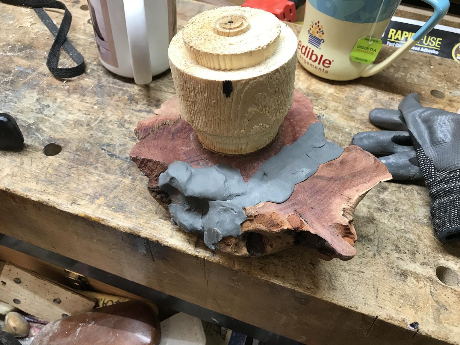

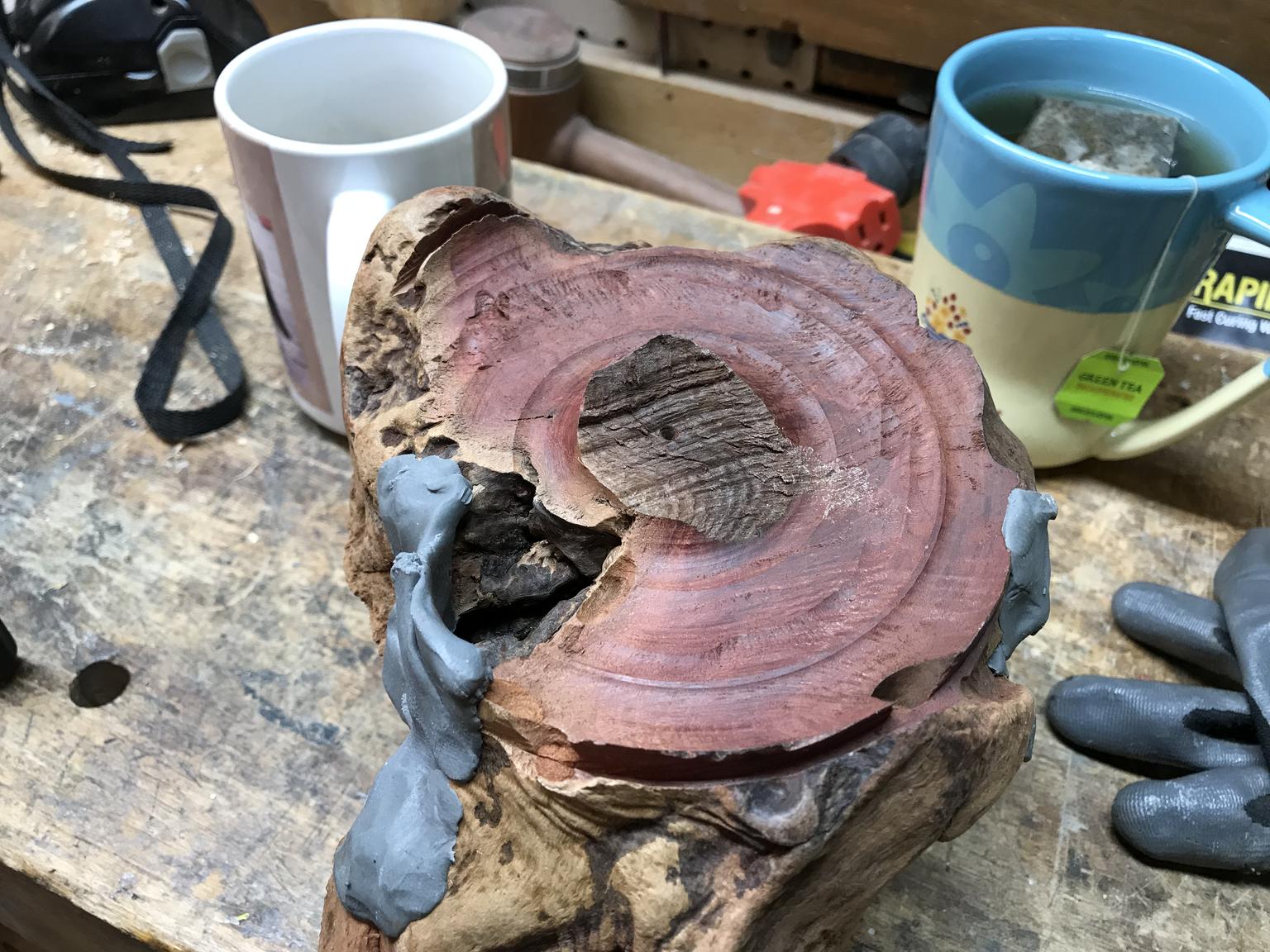

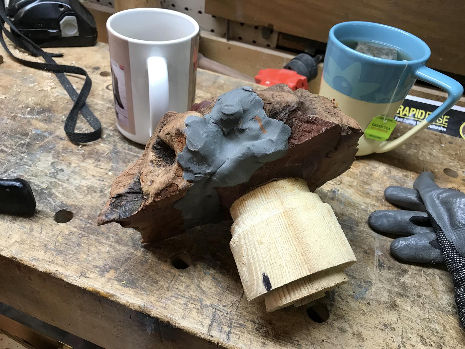

I was working on a Manzanita root and as I turned into it I found the voids were deeper and more extensive that I realized. I'm going to try and save the turning by adding some Alumilite into the voids. To keep the liquid from running out, I've sealed up the blank with modeling clay. Hope it works!

@Gerald Thanks! Waiting until the Mrs leaves the house so I can warm up the Alumilite in the microwave- without getting caught!
