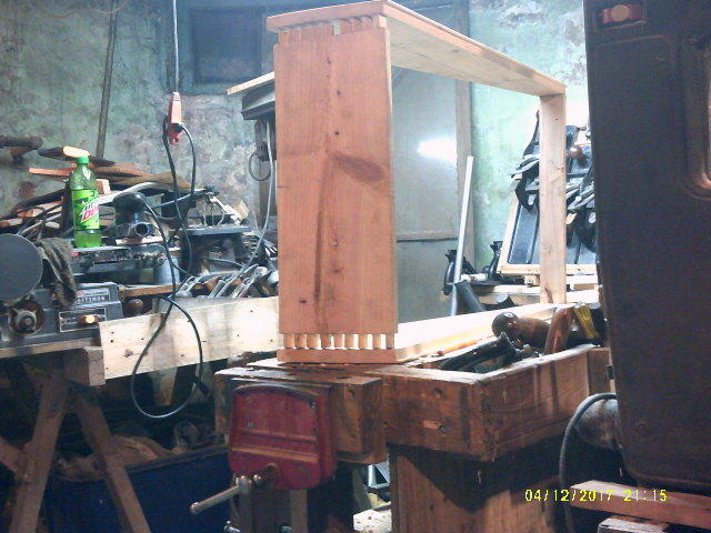

So I am practicing handcut dove tails. I am up to cut 12, still a few minor things im not happy with but my OCD wont be happy till there are no mistakes!!
Below is attempt 12
So my issues here were the knife wall for the middle pin was compressed, you could see from the inside.
The finish on the proud parts of the joint was rough.
I find that when chiselling out the waste my chisel doesn't seem to cut very well on chop cuts. I literally sharpened them before I started the joint as well!!
Maybe I am being a bit too aggressive, or could it just be that pine compresses more easily?
Hopefully 13 will be my lucky One!!

  • So I used a bit of pitch pine from my stash. This is attempt 13.   Still not perfect but not far away Now!!
  • Hey Lee, they're looking real good from here.  As Voltaire opined, "the best is the enemy of the good"  Or, "Better a diamond with a flaw than a pebble without." As I tell my wife.
  • Had a good look through all the info, very useful. . There was a bit of slop in the joints still whereas the previous attempt was nice and rigid. I did learn a few important little things, gonna try t
Those are looking really good! Your assumptions are correct, it's the pine, the pine is compressing on you and the chopping is going to do just that. I am not very efficient at DT's myself, but I have used pine as practice pieces because it is cheap, and usually just laying around, and I have experienced exactly what you are experiencing with the bad results in pine. Once you get a piece of cherry or walnut in your cross hairs, it's going to feel completely different, and everything will clean up real nice.

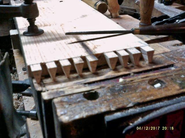

Laid out, A backsaw, filed as a rip, cuts on the waste side of the lines...leaving the lines ( I do pins first.....meh)
I chop halfway down, leaving a tab for support..
Flip the board over, and complete the chop....
Chisels I use..
I can then stand the pin board up, where I can see, I use a sharp pencil, to mark around each pin.    Then I saw on the waste side, leaving the lines..and chop out the waste.
Tails started..
Side one, tails chopped, flip over, and complete the chops..test fit?
Gaps are from getting in a hurry, and not leaving the lines.
Left more of the lines, on this one....
The more I do..the better they get....
