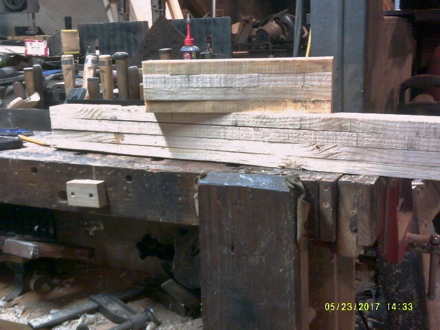

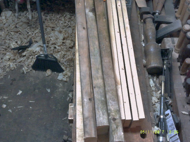

Hauled those 6 pieces of 2x4 down to the shop.    Sat the three longer ones aside, for now.....at least until after a break....

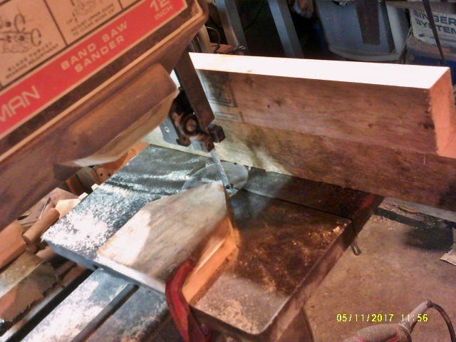

The three shorter ones, well, they had a date with the bandsaw.   I set up the resaw jig, just enough to peel off the edges past the rounded over stuff..
Maybe a 1/4"?   Once all six edges were trimmed, a small plane was landed..

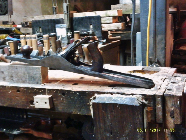

Ohio Tool Co.  # 0-7 Jointer plane.   I wanted the edges straight, free of sawmarks, and as square to the sides as I could get them.. Imagine walking around in a pile of this stuff..
Once all three boards were jointed along the sawn edges,  I dug up a 3/4" thick piece of scrap.   A pair of lines down the center of one edge marked a center line to saw.
Reset the jig to the center of the two marks.  recheck the bandsaw's table for square to the blade.   Since I had to raise the saw guide a bit.
Ran the three through, trying to stay centered...
After a LONG break, I'll come back and plane the saw marks off.
Might need that old jointer plane, again.

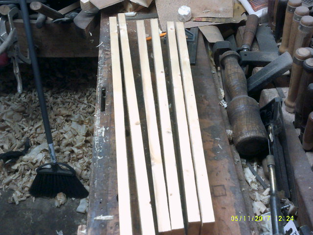

3 boards almost done, three to go..

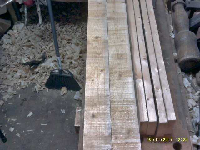

Handsome critters, ain't they.    hope to have them all S4S by this weekend.   Might need a new blade in the bandsaw...
Grandson will be here this weekend, I'll have him haul all them shavings out to the old garden plot.
Not sure what I'll build out of these...yet.   I also have a pile of other Pine scraps......stay tuned.

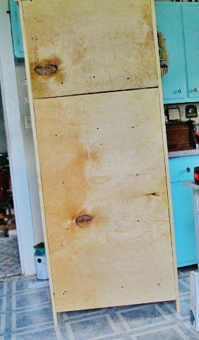

    Boss has it moved into place, and loaded up.. Need to make doors for it, next.   The Boss is very happy with it...

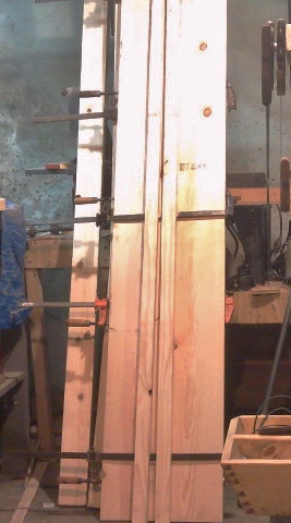

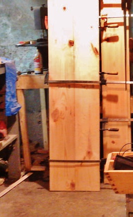

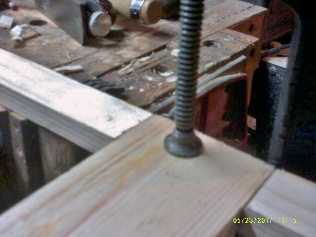

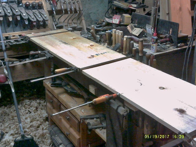

Panel for side No. 1 is in the clamps...a LOT of clamps.   Had to clear the bench completely off, add a few 2x3 stands to raise the glue up off the bench.  needed space to slide half the clamps under  the panel.   letting the glue cure for a while, before the other side's panel gets glued up.....6' long panels can get a bit heavy...
Film @ 2300 hrs...
Glue ups are either in the clamps or just out of them..
Glue up No. 1, after a few hours, the clamps came off..
2xs to hold the next panel up enough to add a few clamps....
Hard to get 6' of 14-1/4" wide panel in one picture....Almost can't get through between the end of the panel, and the washer....
Kind of sticks out there.    Have since taken it over and stood it up against the first panel.     These will be the sides of the Pantry Cupboard.   3/4" x 14-1/2" x 72"....Width of the Pantry is to be about...31" OA.   May need a bit of help getting the finished project up the steps to the Kitchen....

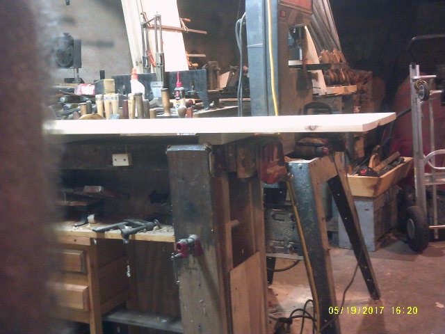

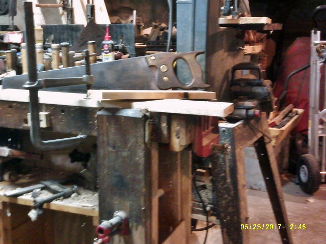

next, a second 1x4 needed cut to length.    A bit wide for the bandsaw, and too long for the mitre box, so..

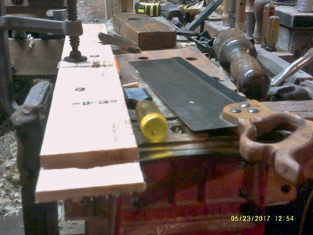

Seems I just rebuilt that saw, too.   There was a knotty piece right in the middle.   Gone now.   These will become the rails of the face frame.

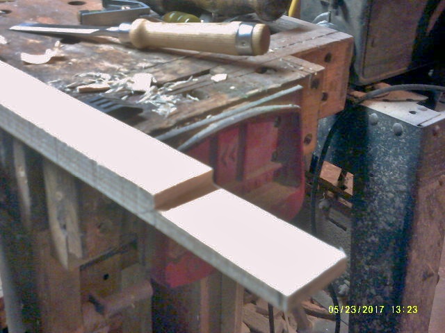

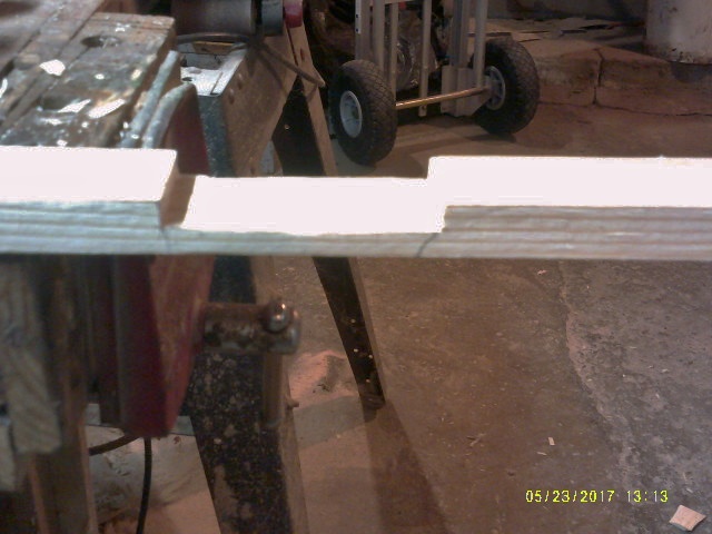

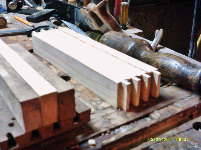

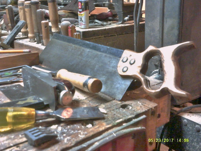

I used the skinny parts to lay out for a few half lap joints.   usual suspects.   WIDE chisel to pop the waste off.  Got the four ends done, came time for the stiles...
Needs a little trimming.   One rail is 5" off the floor.  The other goes at the top..
I used the chisel here as a pare cut .  Smooths things out...Test fits..
I guess it will do. Got all of these fitted.  time for something else..

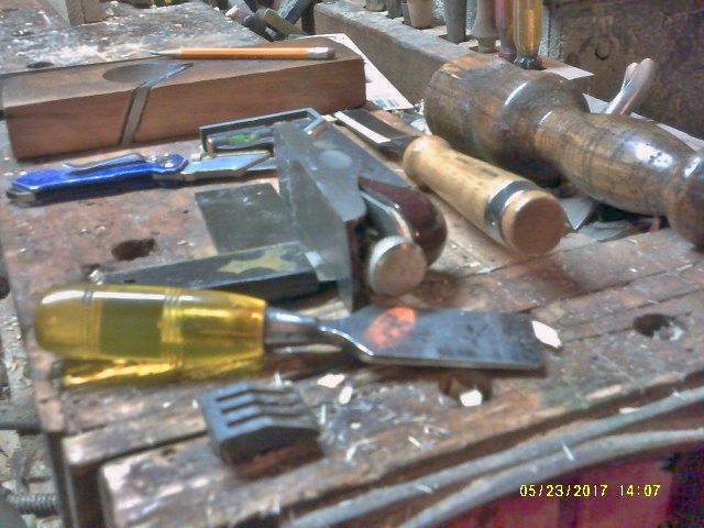

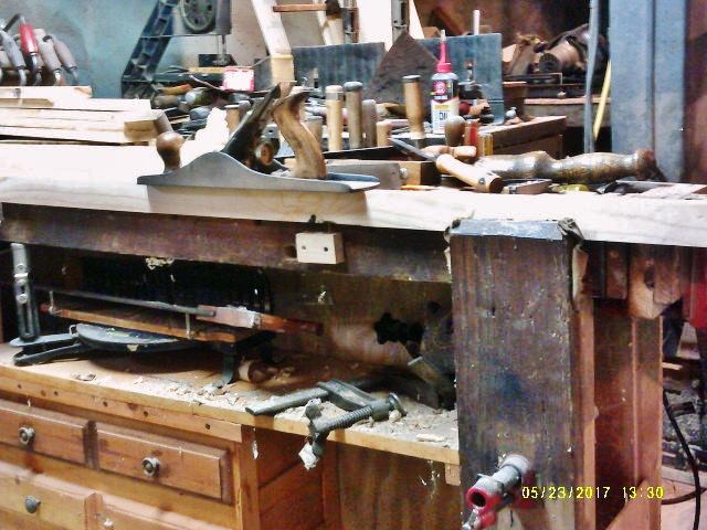

Used this to smooth down one of the 6' long rails
Just a #5-1/2 Jack plane.  As for the cast of the usual suspects..
Most of the hand tool bunch....
One of two saws used.

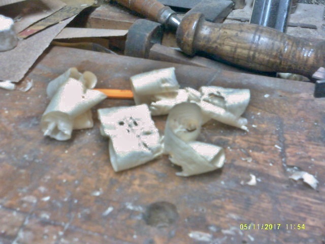

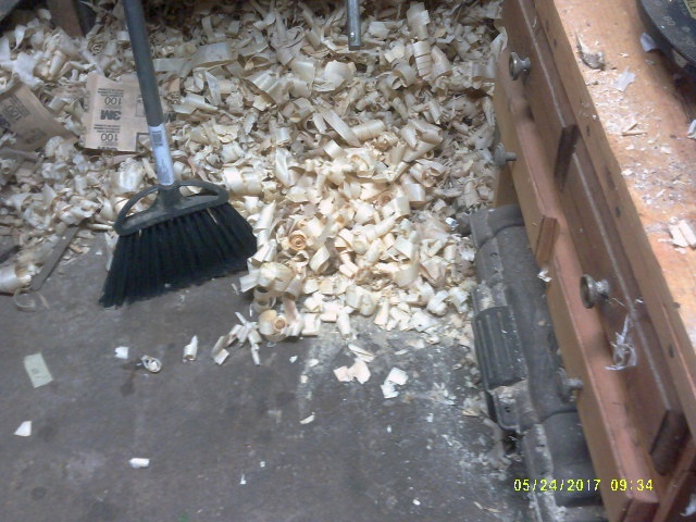

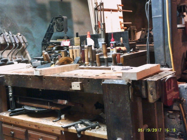

webframes.  Spent a bit of time, running a hand plane or two to joint the sawn edges straight and smooth.....made a royal mess on my clean floor..
The Stanley #5-1/2 was making big curls, rolled them right up.  The Millers Falls #11  worked over the shorter pieces.

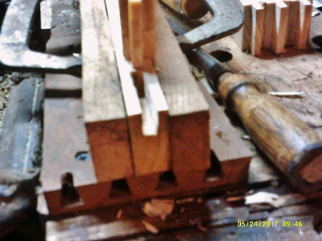

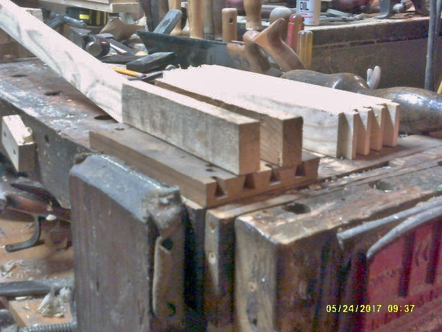

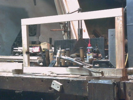

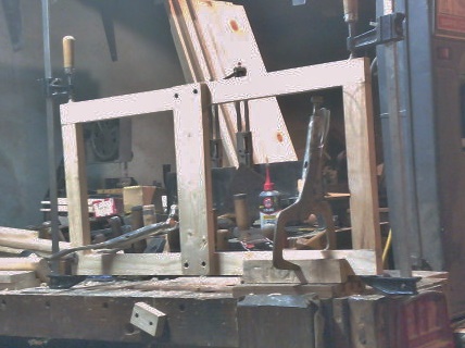

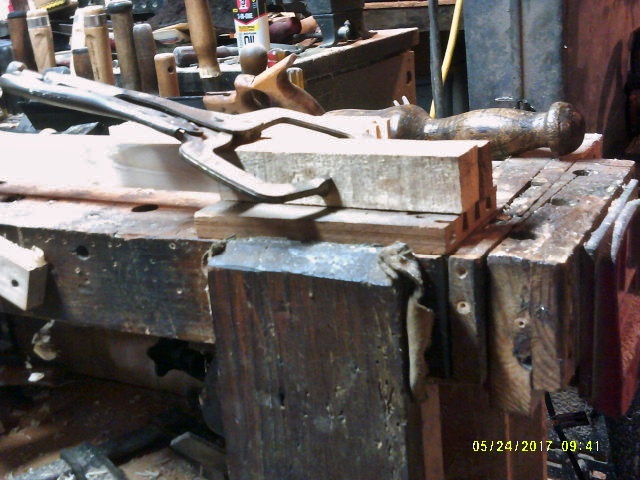

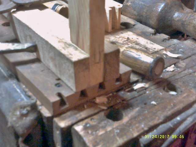

Shorties get tenons.  Set then reset a jig on the bandsaw.   All eight tenons are alike.   The "thing sitting there to the left?
Is a jig I use when chopping a mortise,  I can clamp the part in place, after marking the layout lines..
Visegrips finger clamp, works fast easy to use.   I use the backsaw to make a kerf cut at an angle, then chop a hole at the far end,  then pop the waste out..
Then a dry fit
Rotate, repeat until all four corners can be dry fitted, with a square..

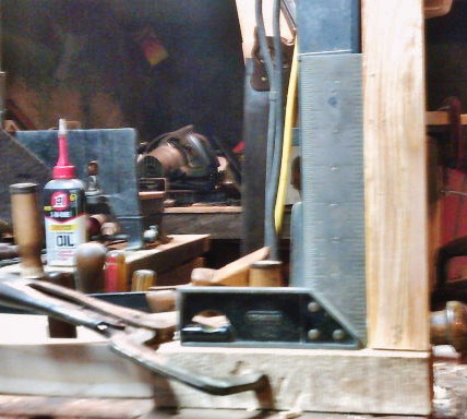

Jig also can be a "Third Hand" How square?

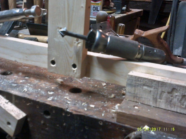

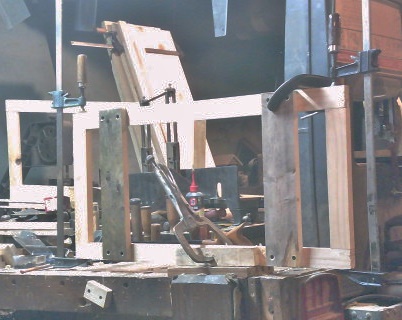

Looks good enough?   I cut a few stiffeners  to length, drilled a few pilot holes.   Small drill had a counter sink bit..
Things were ready for some glue...
Since I had both frames done.   Third hand helps with the glue up, too.  Bottom frame gets two stiffeners, as a bottom shelf will sit on the frame.  Top frame was a bit easier..
Only needs one.   The top of the case will sit on this frame.   So, that was this mornings efforts.   Waiting on glue to dry, before I start a glue up on the face frame....
