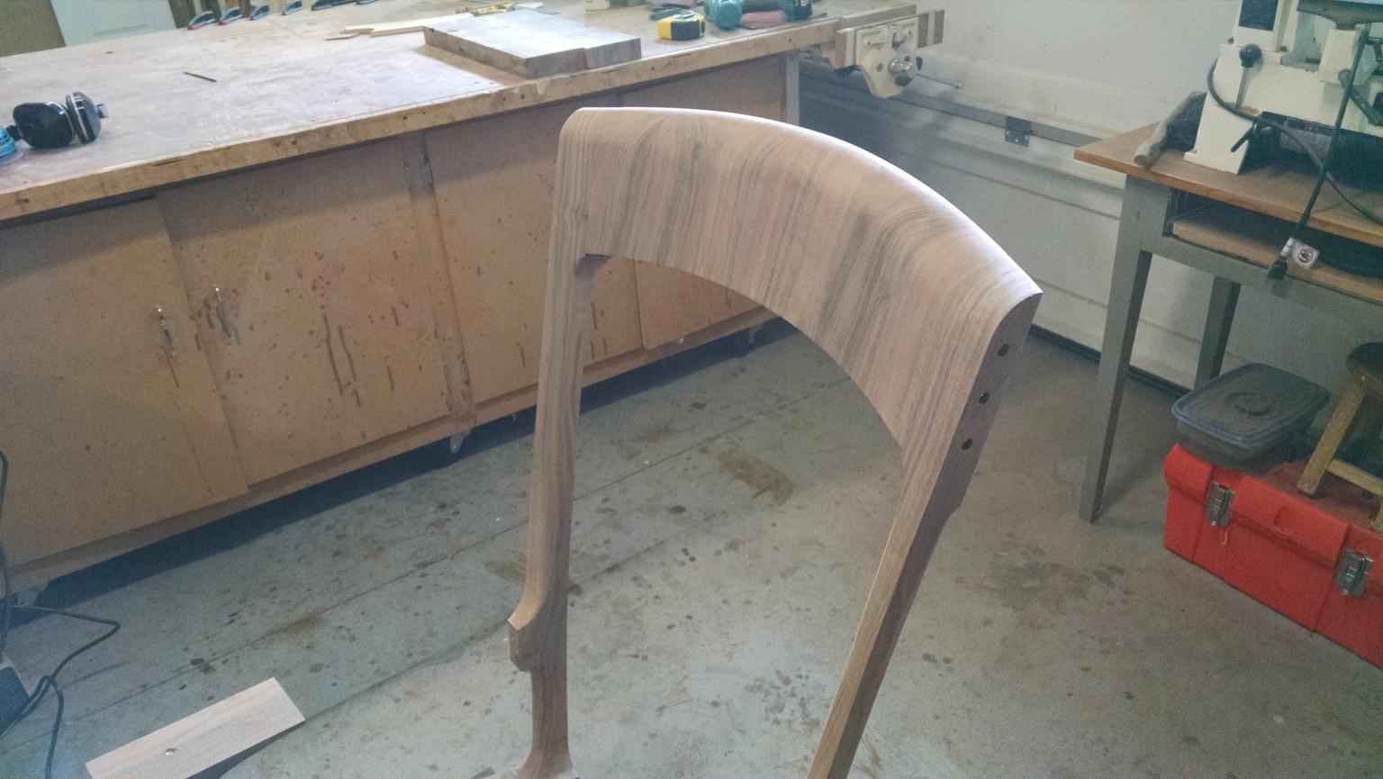

Today I started on the final shaping on the headrest for the rocker. Photo below is the roughed out coopered headrest.
I had to plane down the glue squeeze out because the next step is to joint one end of the headrest and I need a relatively unobstructed surface to ride against the joiner fence.

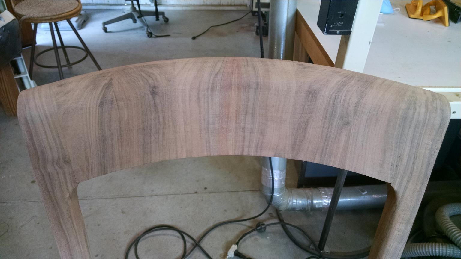

Now that one side is cleaned up pretty good I made one end of the headrest nice and flat for a good reference surface for the band-saw operation.
One end is nice and clean now.
I traced a nice arc on the rough end with my pattern I use for all the rocker headrests. Remember I need the clean end to ride on the band saw table.
I hung my 3/4" 3 TPI re-saw blade on my 14" band-saw with riser-block. And I cut on the pattern line.
My band saw is well tuned, it has to be in order to make cuts like this. I am however looking for a set of new guides, these are a tad worn. But they seem to be holding up fair for now. I can saw veneers with my 14" Grizzly Bandsaw, it's a good saw.

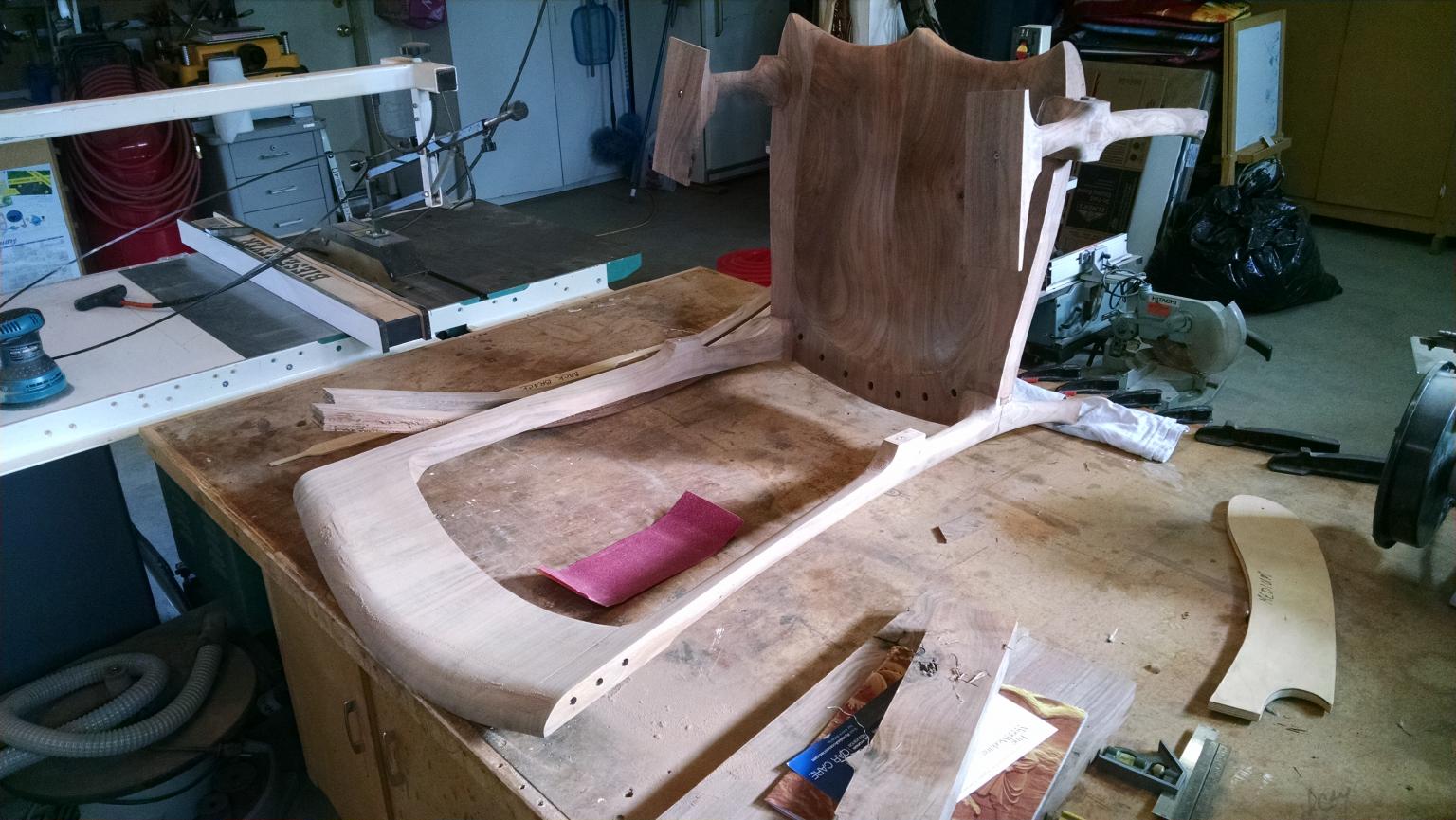

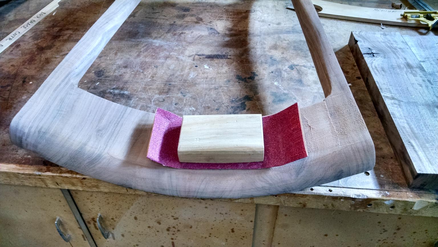

With my sanding block sawed and shaped to the same radius as my headrest, I need to sand the lumps out by hand and also level the surface, this is a long process, it typically takes about a half hour or more to get this arc nice and smooth with zero imperfections and lumps. I use 60 grit for this process.
I can get a ton of leverage when I clamp it up to my bench and I am able to exert body weight down onto the surface.

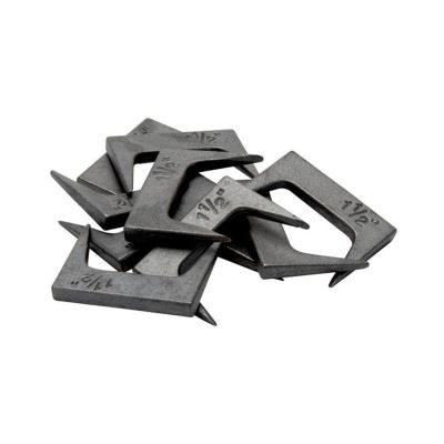

You bet Herb, I am glad we could spur the creativity and ideas along! A little cool secret for getting those headrests coopered are these little guys known as "Pinch Dogs", thus the holes you see in the headrest at the end grain joints. They have a ton of holding power and they are very easy to use, very archaic, but worth their weight in gold for odd shape glue ups. I used no clamps for the headrest, just these little guys.

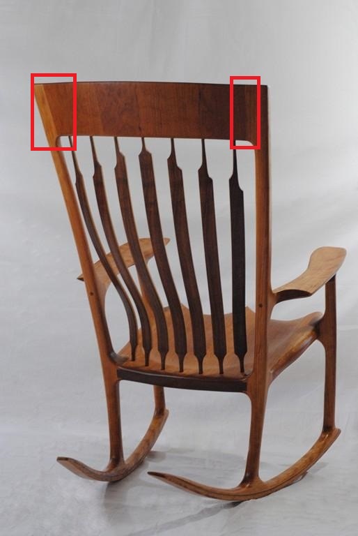

As far as the angle goes, it's the same angle for every chair, it never changes. But how it is determined is by the angle of the faces the entire headrest joins too. Imagine the top of the rear legs, and the headrest joins to the top of the rear legs at the inside top of the rear legs. The inside top of the rear legs are canted out 20 degrees each for a total of 40 degrees. In the image below of my cherry rocker I squared up in red the joint I am talking about, both joints in those locations are cut at 20 degrees, for a total interior angle of 40 degrees. I have six sections to my headrest, with 5 joints, divide 5 into 40 degrees you get 8 degrees per section, but since we have two sides to cooper for each section, you'll have to divide that further by two, so now we'll have each side of each section must be cut at 4 degrees.
Now before all that happened, there is a designer out there by the name of Hal Taylor, as much as I would love to take credit for this chair design, I can't. Hal Taylor is one of my chair mentors along with Russ Filbeck and Kerry Pierce.
But this specific design belongs to Hal Taylor, the design was created by him, and the angles were predetermined by Hal Taylor. And according to Hal Taylor, he came up with this degree by just playing with it, and he arrived at 20 degrees on each leg, to form a comfortable roundness to the back rest area.

I am not familiar with the terminology "draft" Duck. I'd love a definition in this case, thanks!
  Worked as a helper in a pattern shop years ago and the pattern maker used the term "draft" to imply angles which I tend to use from time to time.
  I used the same formula when I made this and was just curious if you had a different technique. My problems were that the pieces were to small ( 3/8-5/8) for the angle so I left the small ones straight and cut the larger angles at 18* to get my circle.
