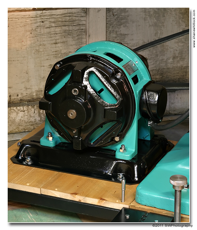

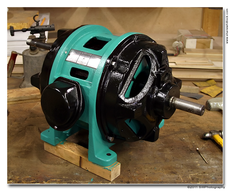

I got the old motor tore down, installed new bearings and a new paint job and she purrs like a kitten.
The motor is a 5 hp 3 phase Westinghouse motor.
Next I made a 3 3/4 inch diameter flat belt pulley for the motor and got the motor mounted to the base. With the 14 inch pulley on the saw and 36 inch wheels this will give me a blade speed of 4400 sfpm. After getting the motor mounted I stitched up a leather belt to drive the saw.

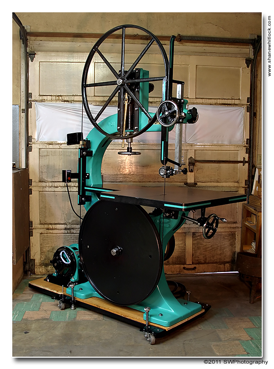

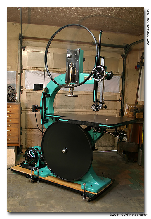

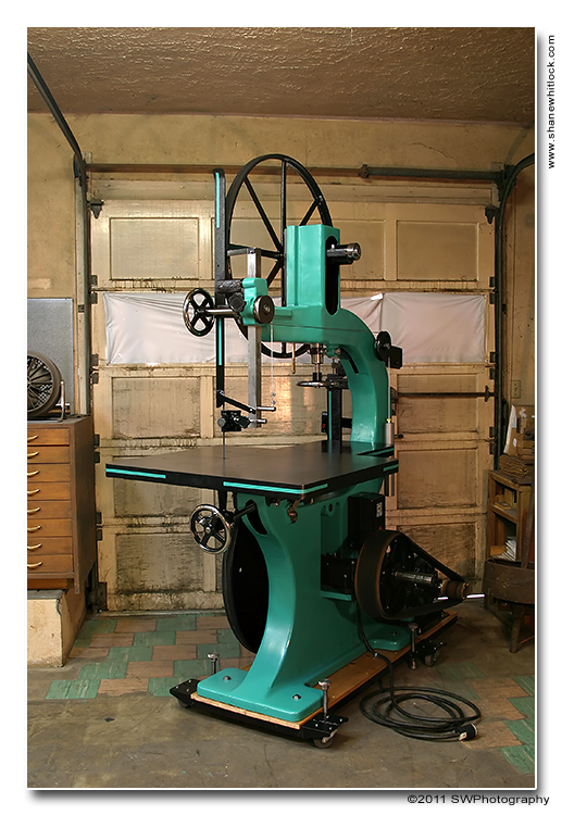

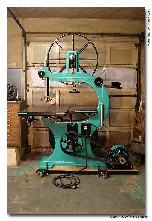

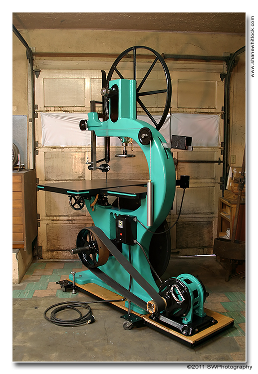

Woohoo ... the restoration is complete. Take a look and let me know what ya think.
Enterprise Manufacturing Co. 36 inch Band Saw
Saw Specs:
Manufacture - Enterprise MFG. Co. in Columbiana, Ohio
(no serial # or model # stamped on badge or anywhere else on the saw).
Wheels - 36" by 2". Upper wheel is spoke. Bottom wheel is solid cast iron.
Main Table - 30½" by 36½", tilts to 45 degrees.
Auxiliary Table - 15½" by 19¼".
Blade Length - 223½"
Blade speed - 4,244 sfpm.
Cut Capacity - 18" resaw and 35½" between C-frame and blade.
Blade tension is provided by spring and counter weight.
Wheel pulley is 14", also made by Enterprise.
Overall height of the saw is 96"
Weight of saw with motor approximately 2900 lbs.
Motor Specs:
Manufactured by Westinghouse
3 phase 5 h.p. induction motor
220 volts 13 amps 1740 rpms.
Motor pulley is 3 3/4"
Mobile base with leveling screws measures 31" by 67".
Purchased for $100

As purchased
After restoration.
Passing the nickel test.

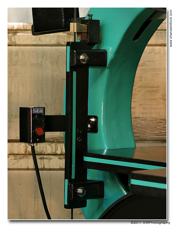

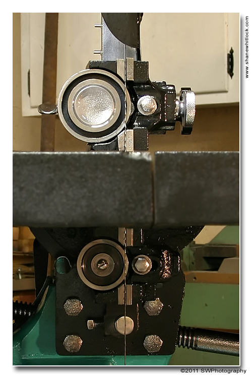

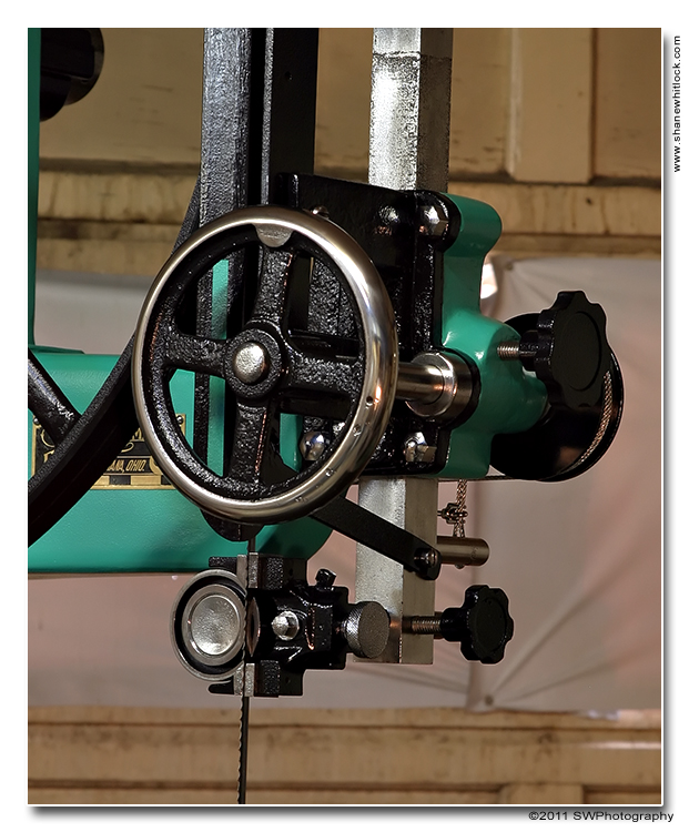

Wright blade guides.
The upper is original, the lower one is one I had kicking around the shop.
I also had to fabricate the mount for the lower guide.

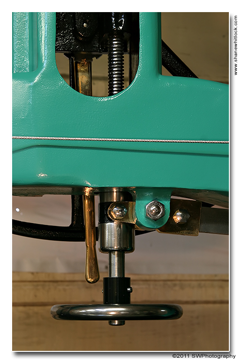

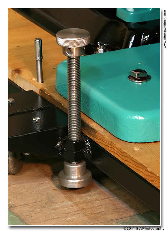

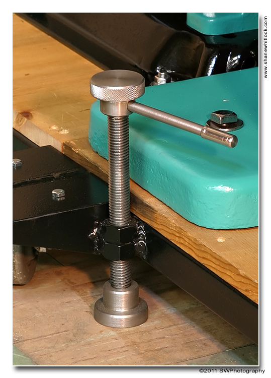

Leveling feet made from 7/8" threaded rod.
Fixed knobs and pivoting feet I turned on the lathe.
Shown in the raised position.
I also made a tommy bar to assist with lifting the 2900 lb. saw off the ground.

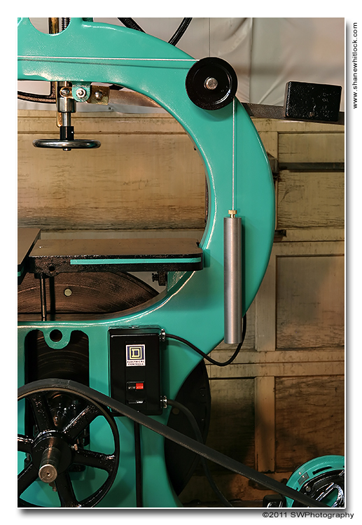

Square D magnetic starter.
Counter weight, which I also turned on the lathe,
made from solid 2¾" bar stock.
One thing I thought that was interesting is the 14" wheel pulley was
also made by Enterprise. It has the same casting numbers as the saw
which all start with a *D (star symbol and the letter D).

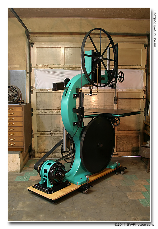

Rebuilt Westinghouse motor with shop made pulley.
Rear blade guard and push start/stop station.
The front blade guard
(which is kind of hard to see in this pic, it shows up better in the first pic)
I made from 1½" by 2" by 1/8" angle iron.
As far as I know this saw is one of a kind. I have looked at every single band saw on the Vintage Machinery website, and there are 100s of them, and I can't find another one like mine.
I am having a hard time dating the saw. It was originally ran with a line shaft and flat belt pulleys so that would make it late 1800s or early 1900s, but unlike the other 100 year old machines that I have restored, this one has hex head bolts instead of square headed bolts.
More pics can be seen on my websiste here.
Thanks for looking,
Shane

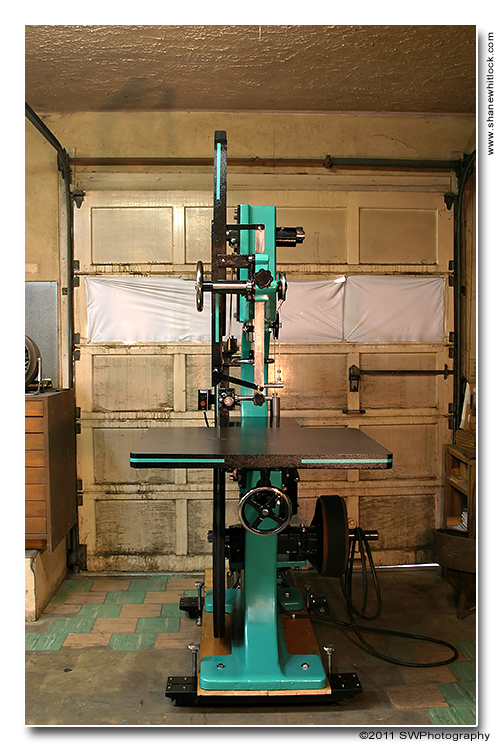

Thanks guys. I am very impressed with this saw. It's built well, heavy castings, nice machined surfaces, and very well engineered. I am looking forward to giving it a work out.
Sorry Ken, no video yet, but I realized after looking at the pics again that it's tough to get an idea of how big this saw is. After dinner I will take another pic with something for scale.

Here's one more pic with me hiding behind the saw for scale.
Shane
