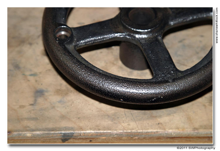

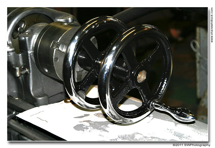

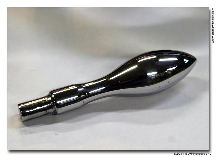

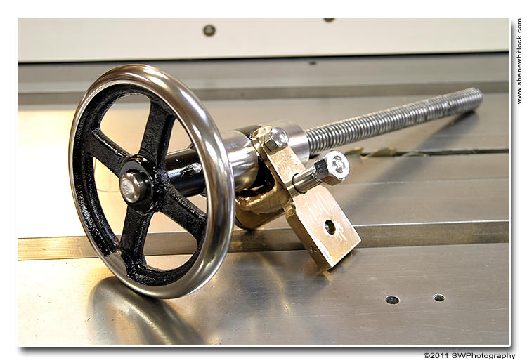

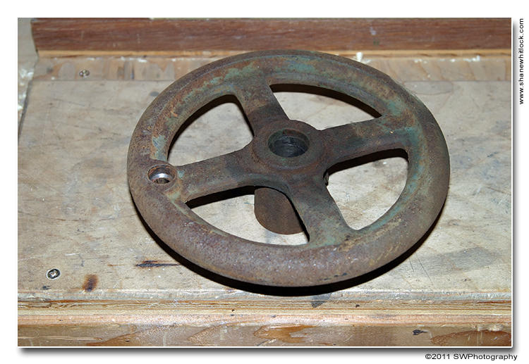

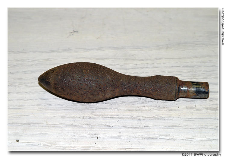

I made a little progress over the holiday weekend. Spent some time polishing the 3 handwheels and a few other parts.
Before:
After:
Before:
After hitting it with the wire wheel you can see how pitted it was.
After 2 of the 3 wheels.
And the 3rd wheel.
A pictorial I put together showing how I polished them can be seen here.
Thanks for looking,
Shane

Looking good Shane,
May I ask what you use for a sealer over the polished parts?
I imagine that you don't have the humidity problems in Utah, that we have by the big ponds (Great Lakes) so was wondering what you use.
As usual very impressive, I can allready see how your bandsaw is going to come out.
Fantasmatic Man!
Edited by Larry Buskirk
Larry, you're correct, Utah is fairly dry but parts will still rust just sitting out. I use Renaissance Wax on all the bare metal surfaces. It's a little pricey but IMHO well worth it. I will give everything a coat about every 3 months. Also works great on table surfaces, wood will slide across it likes it's on bearings.

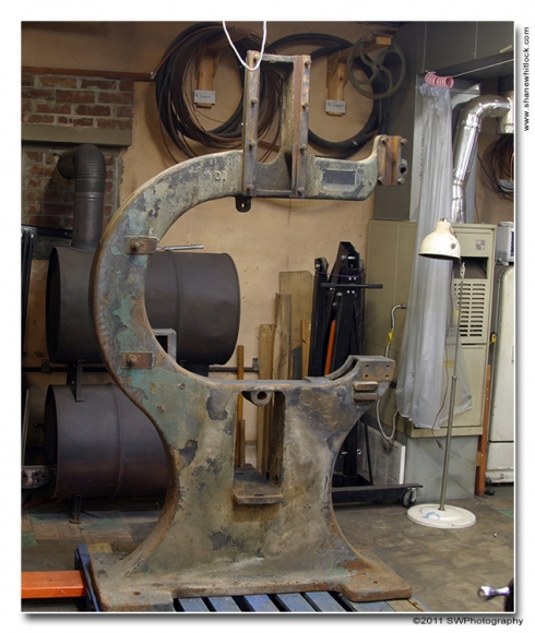

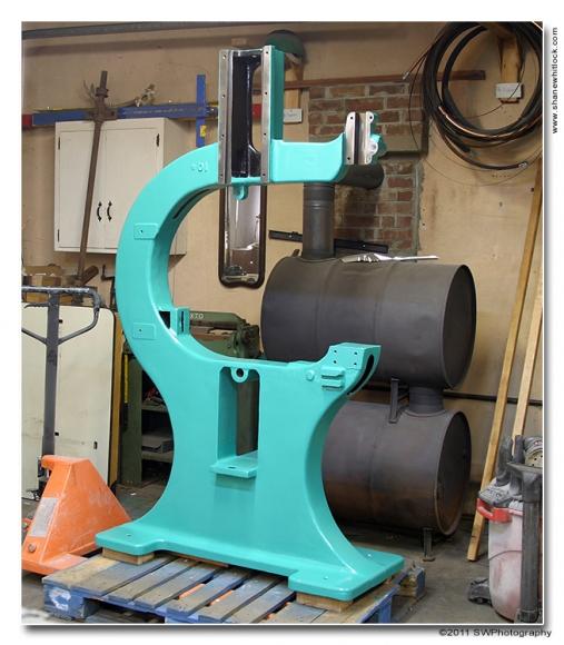

I picked this band saw up about a 3 months ago. and I have been anxious to restore this beast but had to get the Crescent Universal Wood Worker done and out of the shop first.

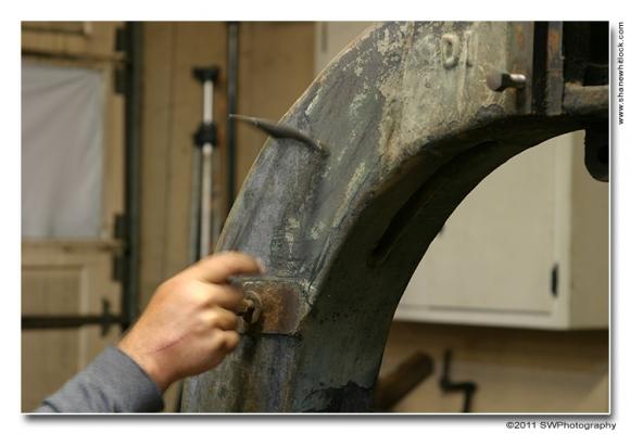

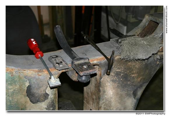

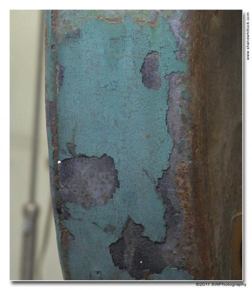

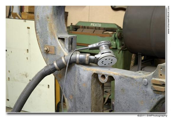

The owner finally picked the Crescent up a couple of weeks ago so I jumped right on to restoring the band saw. The first thing was to strip the paint. When the paint is flaking off like it is on this saw I have found the easiest way to remove it is with a paint scrapper, a razor blade, and a hammer.
Scrape the loose paint off with the scraper and rest of the paint with a razor. To get rid of the old asphaltum filler you can hit it will a wire wheel, but it takes for ever and is very messy. I found that a series of light taps with a hammer and it will chip right off. I had the whole saw stripped in about 4 hours.
Once all the paint is removed and most of the filler is off I finish up with a sander and some course sand paper to clean it up.
Much better.

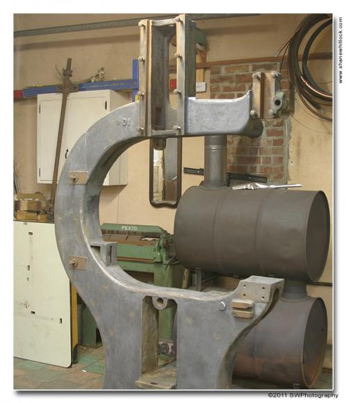

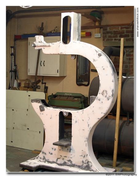

I usually don't like to use a filler on cast iron, I like the looks of the rough surface, but on this one I decided to go ahead and throw some body filler on it. Now I remember why I hate using the crud, it took me 3 full days, 3 minutes at a time cause the stuff dries so fast, to get it all smooth. I have never sanded so much in my life and if I never see another can of the stuff it will be too soon. My whole shop now has a thin layer of pink dust everywhere. After it was done though I must say the results were worth all the hard work.
I originally planned on painting this satin black with gold highlights, one of my favorite paint schemes, but I decided to brighten up my shop some. The original color of the saw was a bluish green color.
So I went with a bright turquoise color ..... How's this for bright?
My wife hates the color but I love it and think it will look great with some contrasting black.

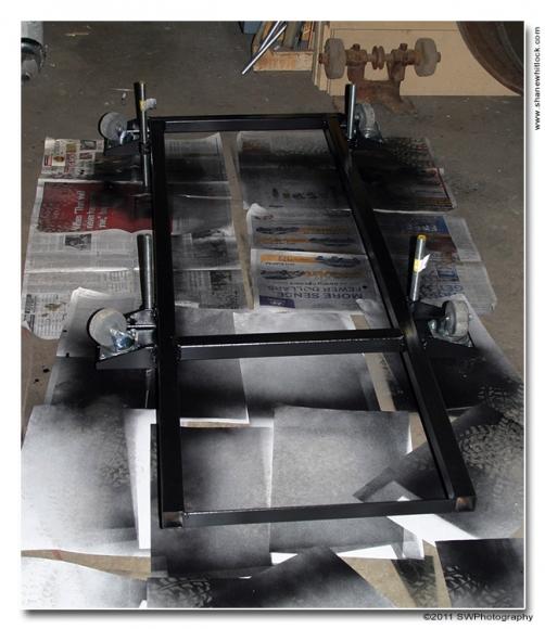

Since this is going to be tucked away in the corner of the shop I made a mobile base for it so I could roll it out to use it. I picked up some 1½" square tubing and made a base for it. Added some casters and it's good to go. (pic showing it upside down).
Well this is as far as I have gotten on it. Still a lot to do but I think it's coming along nicely.
More pics to follow .......
Shane

Try using a little less hardener in your body filler. That will give you a few more minutes working time.

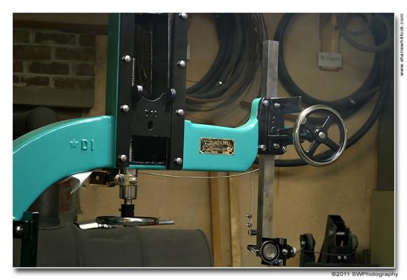

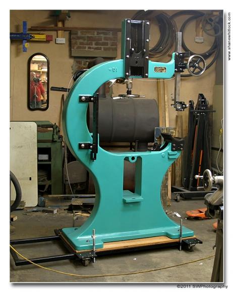

I worked on the band saw most of the day but didn't get as much done as I wanted. I painted the upper and lower bearing blocks and got them mounted. Stripped the old rubber and paint off the wheels and get them ready for paint. I also got the new tires glued on using epoxy paint. I was hoping to crown them but the paint took forever to dry so they will have to wait til next weekend.
Here's the latest pic. The color is a little more accurate on this one than the ones above.
Thanks for looking,
Shane

As you know I like the smooth casting look. The argument that they don't look like cast ARN is a lame one if you ask me. Lets face it it's a lot of work. One thing I try not to do is put Bondo on the corners or edges. What ever the fillers were in the past they were a lot harder than bondo and could take a hit. I like to grind the castings edges if I can, but this takes more time as well. I take a long time to do things though.

Awesome job Shane. I love the paint, I admit too it looked pretty bright until I saw the following pics with the black and polished hand wheels and hardware. I can sympathize with your hatred of body filler, when I was 17 I worked in a body shop, I have seen my share of Bondo!
It's pretty amazing the vision it takes to bring these back to life, it never ceases to fascinate me, I have a hard time seeing the possibilities of these machines when in their run down state. But when you do it long enough as you have, and others on here, I am sure the vision pops as soon as you see it. Color schemes, accents, etc. Congrats on another great machine in progress.

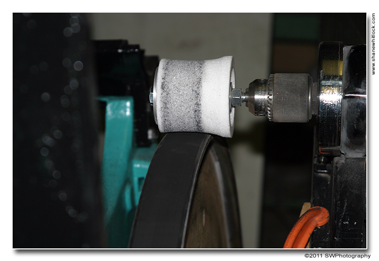

I put new tires on the wheels last week and now that the epoxy glue is dry I can crown the tires. I picked up a grinding stone from my surplus store and used a dressing wheel to shape the stone to the profile I wanted on the tires.
The best way to crown tires is while the wheels are on the machine in case there's any runout in the spindles. My plan was to mount the stone in my large radial drill press and crown the tires while they were on the saw. I figured since I could slide the head in and out raise and lower the head with a turn of the wheel, it would make it easy to line things up just right.
I turned a mandrel on my lathe and mounted the stone to the drill press. I used my pallet jack and moved the drill press into the room where my band saw is. I spun the head on the drill press thinking I could rotate it 90 degrees but soon found out it will only rotate 45 degrees ... so much for that plan.
So back to the drawing board. I looked around in my rathole and found an old motor that I robbed off of a little lathe a few years ago and used to use it as a buffer. It has a jacobs chuck on it so I used that to mount the grinding wheel. Then I clamped the motor to the table of my spindle sander and using the tilt on the table I was able to raise or lower the grinding wheel slowly into the tires. I was worried that the 1/6 hp motor would be underpowered but it worked perfectly.
Here's a pic of the grinding stone. The profile looks a little exaggerated in the pic, I shaped the outside two inches of the stone so it would give the tires a little less than a 1/16th of an inch crown.

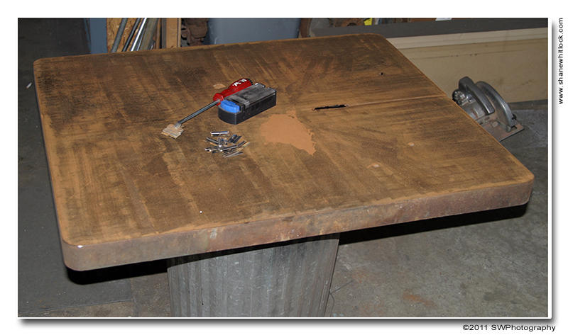

IMG_0974_001.jpgNext it was time to tackle the tables. Some of the metal on this band saw was heavily rusted leaving some of the parts badly pitted as you can see in the pic below ... it kinda looks cool polished up ... lol.
I was worried about the tables being pitted but after cleaning them up they didn't look to bad.
Most of the rust was just surface so I used a razor blade and started scraping.
After an hour of scraping and 12 razor blades I had a nice pile of rust and the table wasn't looking to bad.
With most of the rust scrapped off I mounted a scotch brite pad to my sander and worked at it for another hour. I finished it off with some 0000 steel wool and the table was looking pretty good. I could of kept polishing but I didn't want it to shine to much. I think I stopped at the right time, still has some character and you can still see the original old planning marks running across it.
I painted the underside of the table and mounted it to the saw. It took four of us to lift the table, it's a heavy sucker, up and on to the saw.
