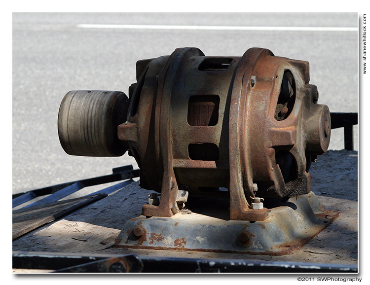

Oh, I also picked up a nice 5 hp 3 phase Westinghouse motor to power itIMG_0583.jpg

That motor looks like it came out of some trolley barn rat hole. So great when a period correct motor comes with the machine.

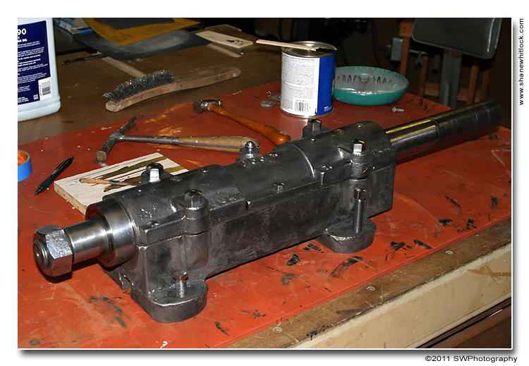

Today I was planning on pouring some new babbitt for the lower wheel but when I took a good look at them I realized they were in pretty good shape. I pulled one of the thin shims on each bearing cap, wiped down the babbitt with some mineral spirits and used some prussian blue to see how tight everything was. Everything looked good.
I also pulled out the old felt from the oil reservoirs and packed in some new felt. Then I finished cleaning the casting and polished the bolts.
I was curious as to how much this casting weighed so I put it on my shop scale which tops out at a 100 lbs. The casting, without the spindle, weighed more than the scale would handle. I guess it weighs around a 125 lbs. No wonder why my arms hurt from holding that sucker up to the wire wheel and hauling it around the shop.

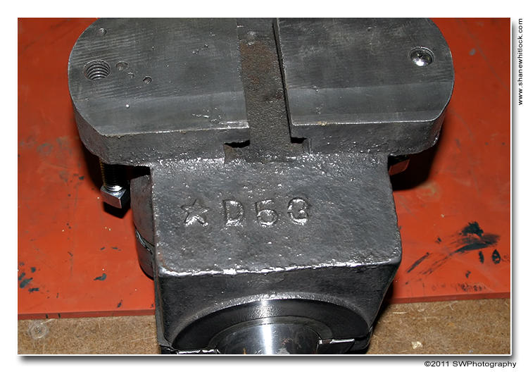

One thing I think is cool is that all the casting numbers on this machine have a star in front of the numbers.
