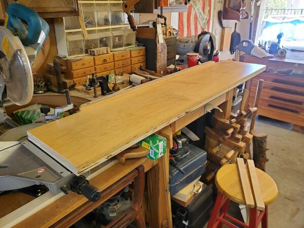

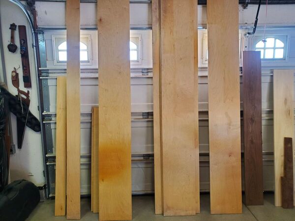

Ripped some shelves out, at 14" wide.

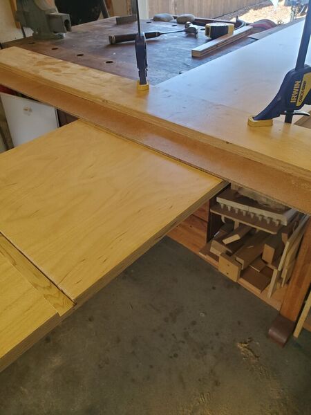

Cut to length the tower cubby side panels, just gotta rout some dados in for the shelves.

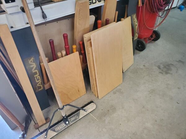

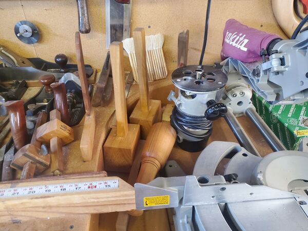

Some odds and ends left from the last build, I'll be able to use these for shelves etc.

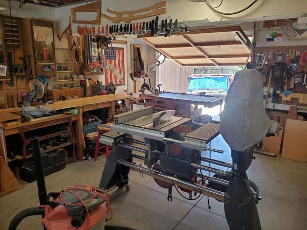

All set up for a little production!

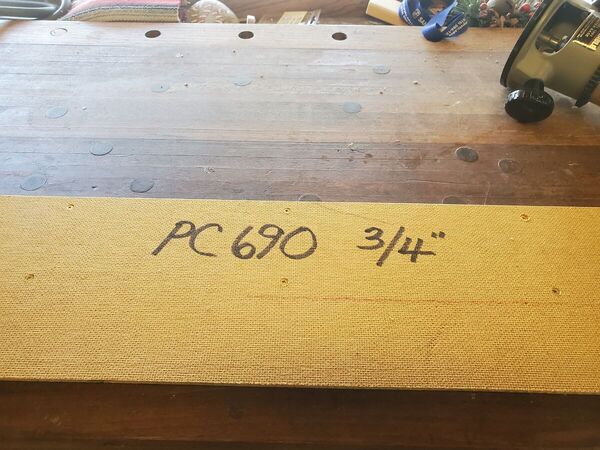

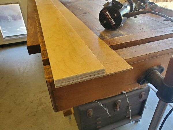

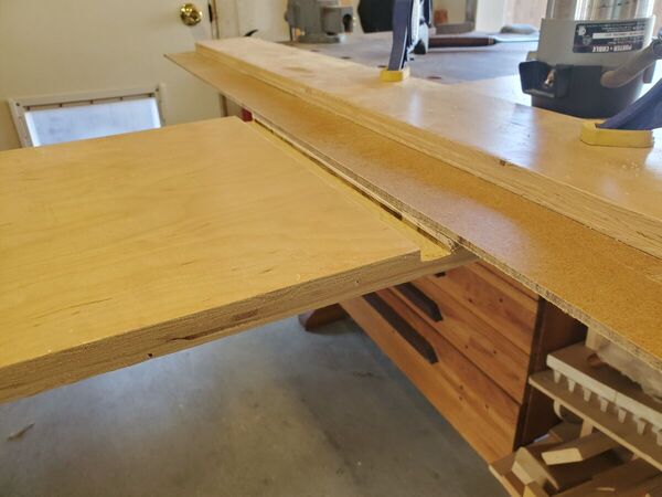

It's been awhile since I've done any sizable flatwork with dadoes, so I made up a zero clearance dado guide. I had half a dozen of these for different sized bits and for my skilsaw. I set em out on the curb awhile back.
And just as with my old ones I marked the backside with the router and bit size this can only be used for.
And of course, in the middle of it all!
Did pretty much the same thing for my table saw dado set- #of chippers, size of brass/magnetic shims, type of plywood. Just pick the slot that fits the best.
Years ago I made a zero clearance dado guide. Still have it, still use it once in a great while.
However I'm pretty much all hand tools and love it.
Exactly Lew.
Anytime I can idiot proof something I'm all over it, cuz, we'll you know😅.
The template edge is the dado, don't get any simpler than that.

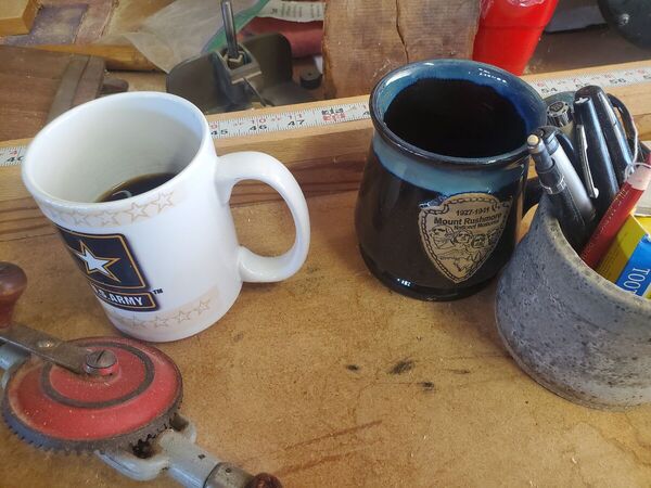

Am I the only one? I just spent 20 minutes looking for my router. I looked right in that spot 5 times. I looked everywhere, I even looked in the trash thinking it may have toppled into the can.
I looked right there! It finally clicked, hey that's a router!
While looking for my router I did however find my coffe cup, in plain view that I've been missing these last several days. I only found it cuz I set my Army cup down next to the missing one.
Is that your 10 mm socket in the cup with the pencils?
