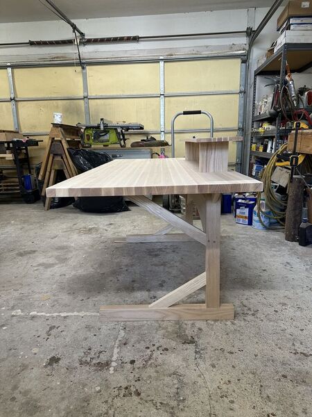

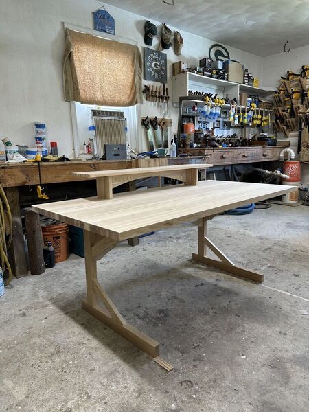

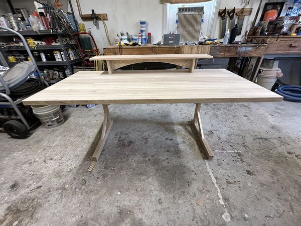

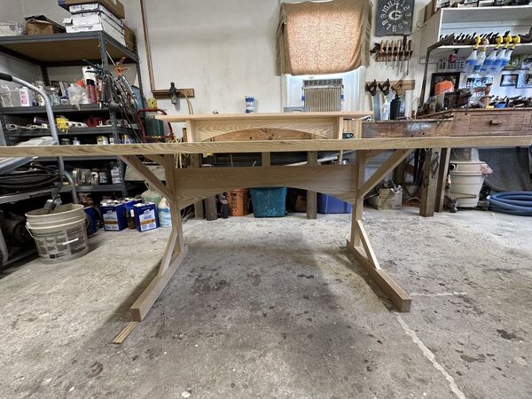

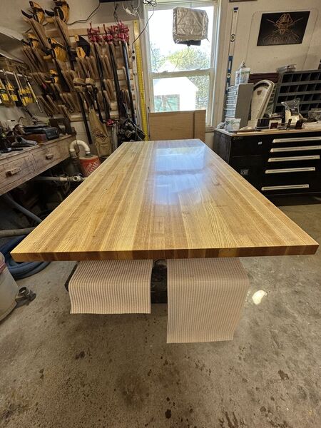

  • I’ve laid out all the strips to orient growth ring direction, numbered each one and indicated top side for how they will be in the desk top. Mating pairs have neen jointed and glued, now each pair is

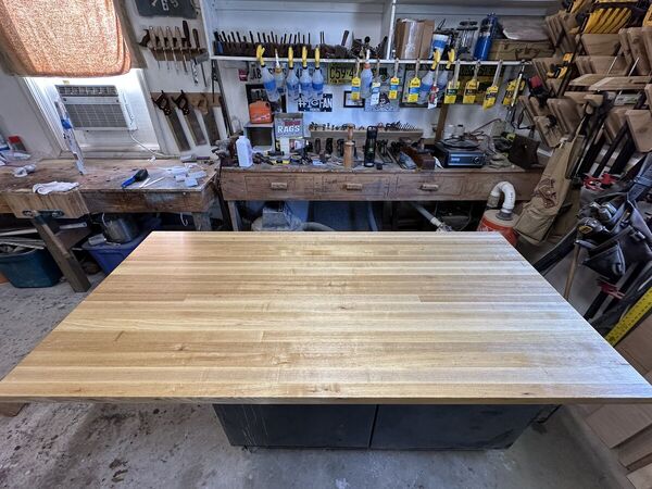

  • So it begins, flattening the top. Traversed the surface with the big try plane. It covers well with it’s weight and momentum. Really cuts nice, it made short work of this side. Made a longer 48” set
  • I have the top cut to dimension, squared and flat. The top surface needs a smoothing plane but I still have to cut mortises in the under side, so smoothing top will wait until that’s done. I finish pl

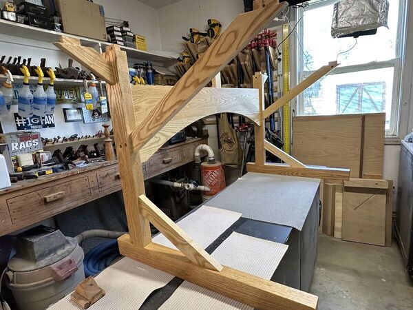

I’ve done my standard initial process of wash coating with thinned BLO and following with a natural tone stain. They’re happy with the color as is, so moving on to top coat.IMG_9174.jpeg
I’ll fill the grain on the top surfaces and coat with poly. Everything else will get tung oil finish.

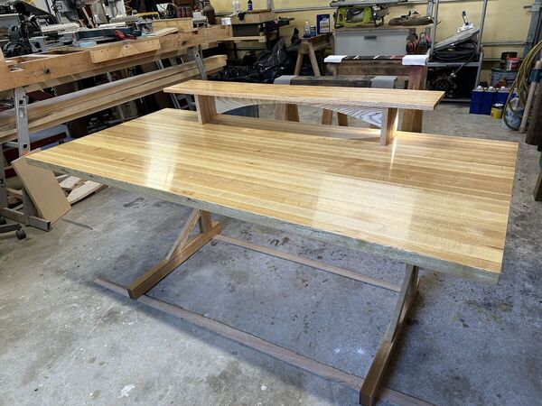

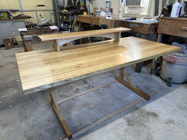

All finished and ready to deliver. The support structure is finished with straight tung oil, rubbed out and waxed. The top had the pores filled with plaster of paris and finished with polyurethane, rubbed out and waxed. The monitor stand is poly on the top and tung oil in the support, rubbed and waxed.IMG_9244.jpeg
The strips of wood on the floor aren’t part of it. It’s just sitting on those to keep it off the concrete.
Wow! I like having a big work surface and you have provided that along with a great design. Looks amazing!

Delivered and setup
Looks good! Really nice job.
