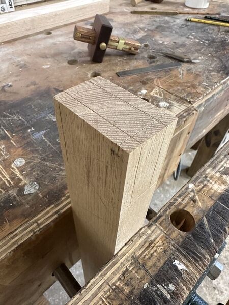

Working on the support pieces. I’ve had the feet and risers ready for a while, cutting the mortise and tenons to join them now.IMG_8766.jpegIMG_8766.jpegIMG_8769.jpegIMG_8771.jpegFit together, need to make the corner braces.IMG_8821.jpegI had to modify the original plans a little to get both the lower and upper corner braces. Used the golden ratio to figure it up. Came out like this.
IMG_8822.jpegCut and dimensioned the pieces for the braces.IMG_8823.jpegMarked out the mortise and tenons for the lower ones. Cut and joined. IMG_8826.jpegIMG_8824.jpegIMG_8825.jpegNo glue yet. I’ll have to take them back apart when I cut the upper support and top of the riser. Looking at gluing the 3 joints at the bottom and draw bore pinning the upper brace where it joins the riser.

Pieces are all cut for the support assembly. The risers are have mortises coming in from 3 sides, had to modify the tenon layout on the cross bar. Ideally wanted a 2” tenon top and bottom, but was going to run into a mortise on the adjacent side. Went with a 4” tenon on the top and 1-1/2 on the bottom. IMG_8895.jpegDry fit together, made the draw bores and marked off the tenons for fitting into the table top.IMG_8896.jpegIMG_8897.jpegIMG_8898.jpeg

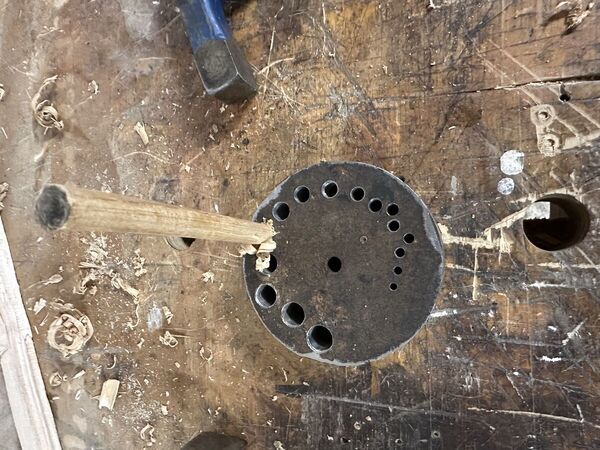

I made dowels out of white oak by driving them through a drilled plate. Each hole is 1/32 smaller than the one before it, so you can size a dowel the way you need it. By driving them through like this, you also get stronger dowels. The strongest part of the grain follows through the hole and weaker parts get sheared off. It works great for draw pinning because they usually come out with a slight curve to them and you can use it for extra tension in the joint.IMG_8964.jpegIMG_8966.jpegI’ve got all of the pieces for the supports cleaned up and glued in, the forward angle braces are drawpinned into the risers.

Interesting...what is the plate made of? And do you drive the blank with a mallet?
It’s a steel plate about 1-1/2” thick. It’s just a piece I had laying around, I’ve seen thinner ones about 1/2” thick work fine.
Hitting the dowel directly tends to smash it. I use a double headed body dolly hammer against the dowel and hit that with another hammer to drive it through. It will still damage the end some, but you cut that off as you go. I split out a piece about 4 sizes larger and cut it off a couple inches longer than what I want. Start at a larger hole and work my way down. You’re essentially beating the weakness out of it so only the strength remains and you have the dowel you want. My Marine friends can vouch for this method.
