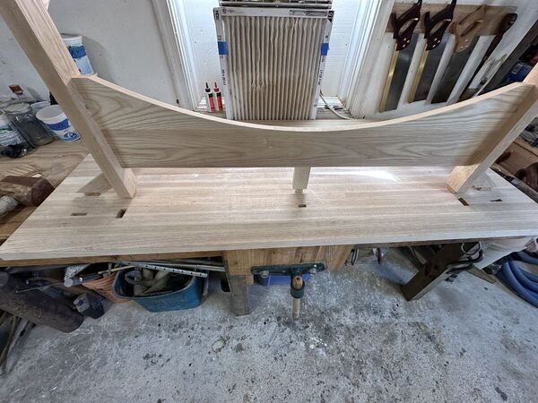

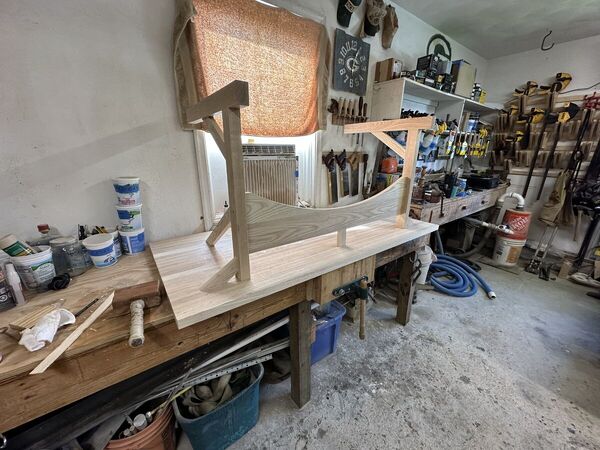

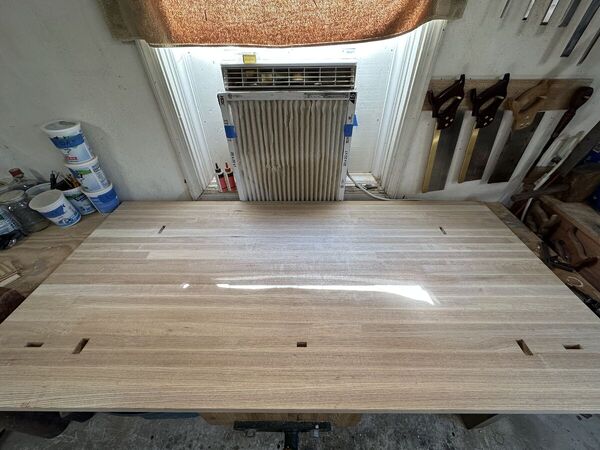

My daughter and her fiance wanted a desk to fit a specific spot in their apartment. He drew up a decent set of plans to work from. I decided to make it from ash, so I picked up a bunch of 8/4 and 4/4 lumber. IMG_8312.thumb.jpeg.89e36c704e919d8b10852d9017142edd.jpeg

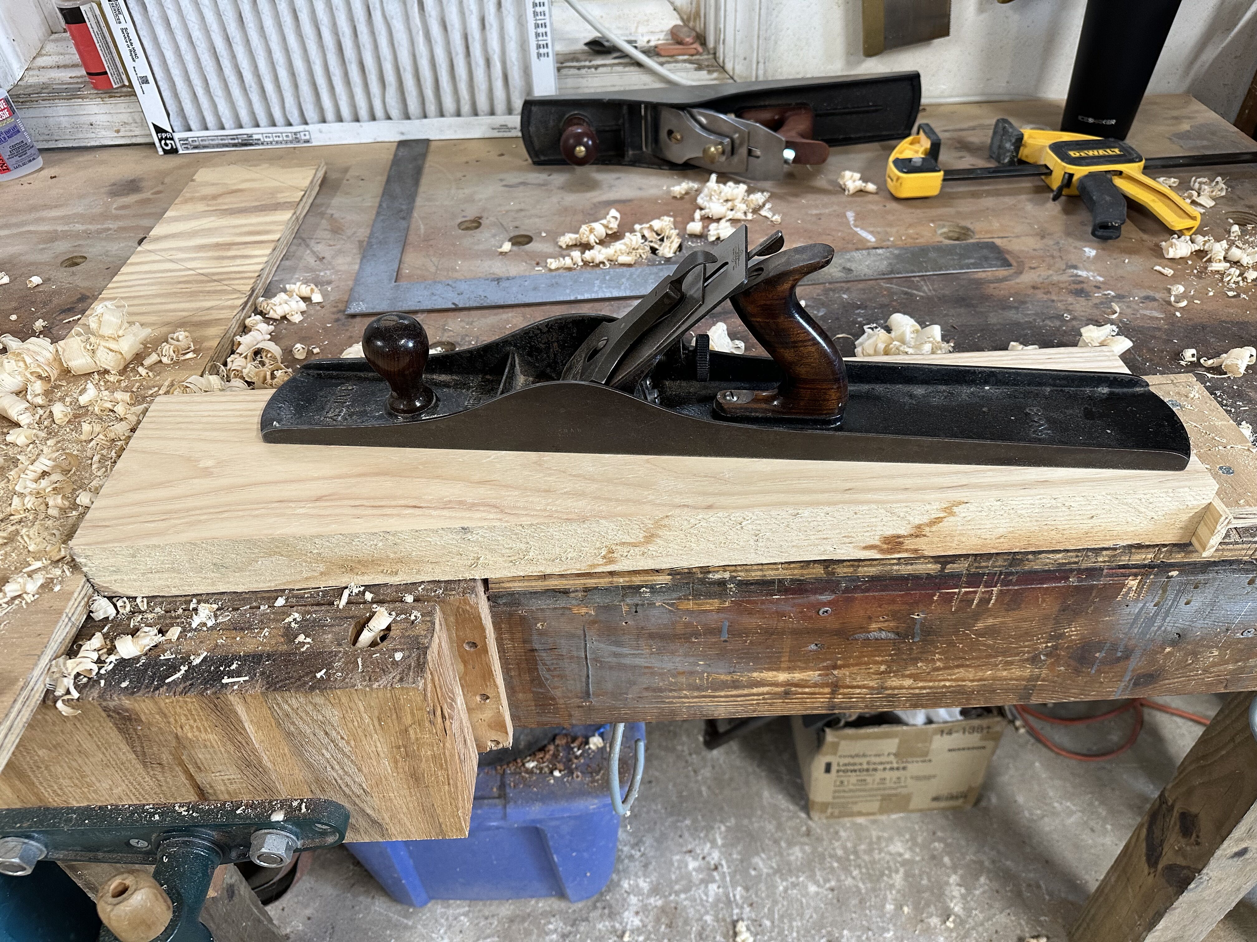

IMG_8319.thumb.jpeg.1dfb5a9daa0799b05f750684c5d7092f.jpegCut the support pieces to length, flattened one face, jointed one side and cut pairs from the same piece.

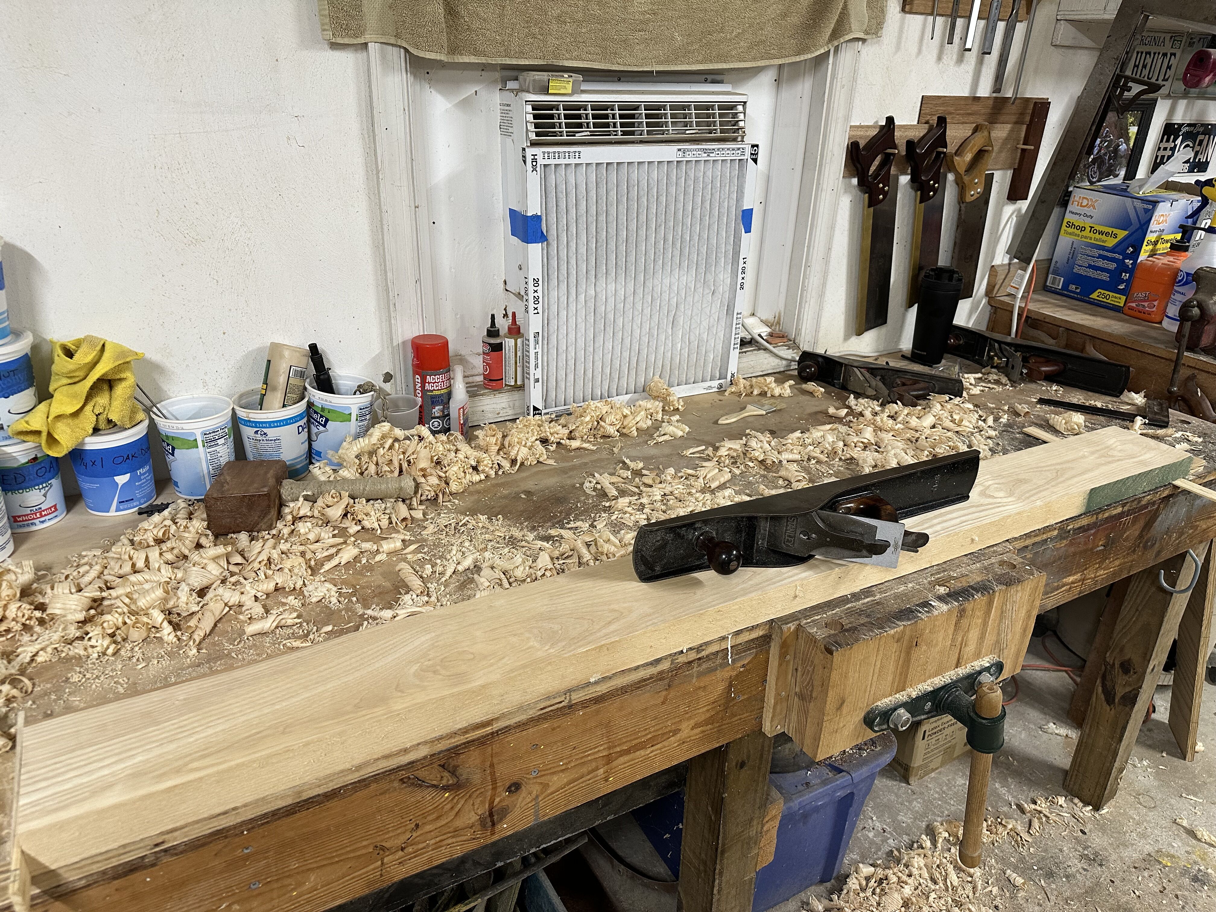

IMG_8329.thumb.jpeg.5745d6070c21f8e3ff68f11572ddeef7.jpegFlattened one face, jointed one edge on the rest of the 8/4 stuff and ripped strips 1-3/4 wide. Will rotate each strip 90 deg to bring the quarter sawn side to the face in the usual way and glue together to make the top. Hoping to have the top be about 1-1/2 thick by the time its done. We’ll see how close I get. Some of those strips warped pretty good when I ripped them out. It’s a fairly large top at 68x32.

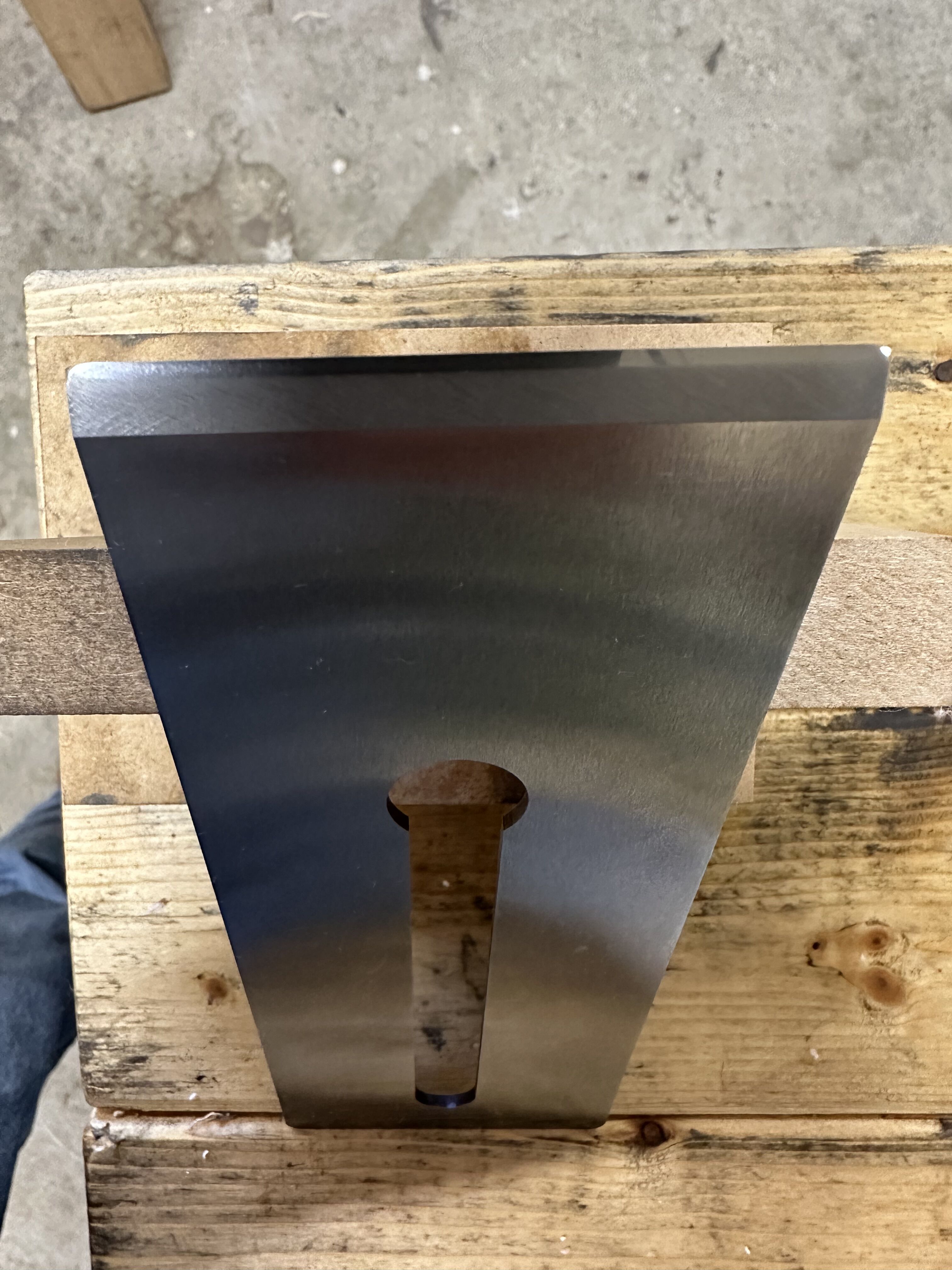

IMG_8417.thumb.jpeg.a3d4bc2db127e6e0a200f6c4306194cb.jpegIMG_8415.thumb.jpeg.d16244633781442b8749d6c9b7421d33.jpegSpent a few hours sharpening my jointer iron, now back to knocking it dull again.

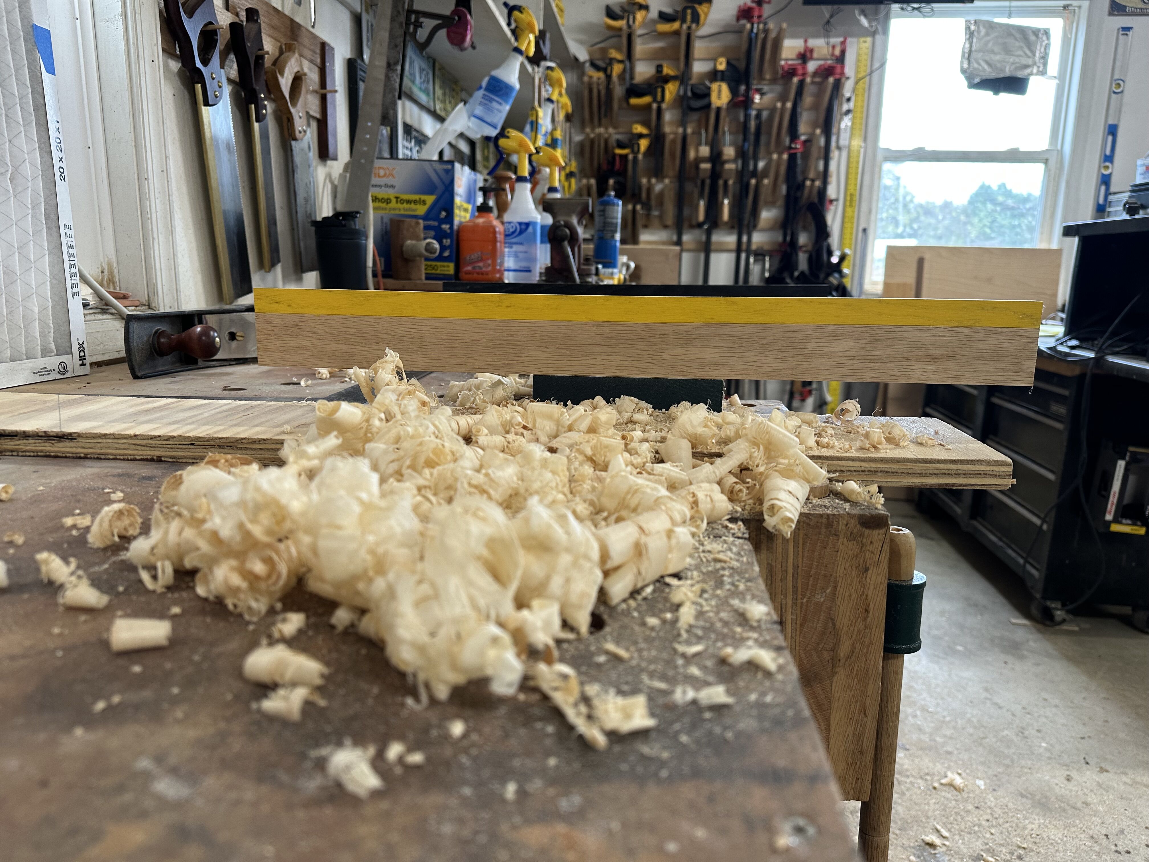

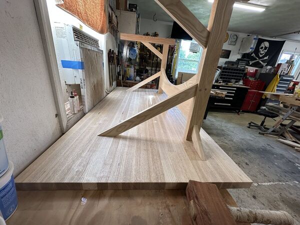

Came up shorter than I expected. Had enough cutoff pieces to splice up one more strip. Had to pick up another plank and rip 3 more from it. Should have plenty now. Got one half in the clamps and the other half ready.
Coming along Zack. You're going to need help moving that around.
You know that’s right. We’re going to have fun moving it to their 3rd floor apartment.
