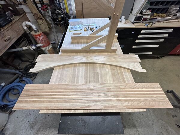

  • I’ve laid out all the strips to orient growth ring direction, numbered each one and indicated top side for how they will be in the desk top. Mating pairs have neen jointed and glued, now each pair is
  • So it begins, flattening the top. Traversed the surface with the big try plane. It covers well with it’s weight and momentum. Really cuts nice, it made short work of this side. Made a longer 48” set
  • I have the top cut to dimension, squared and flat. The top surface needs a smoothing plane but I still have to cut mortises in the under side, so smoothing top will wait until that’s done. I finish pl

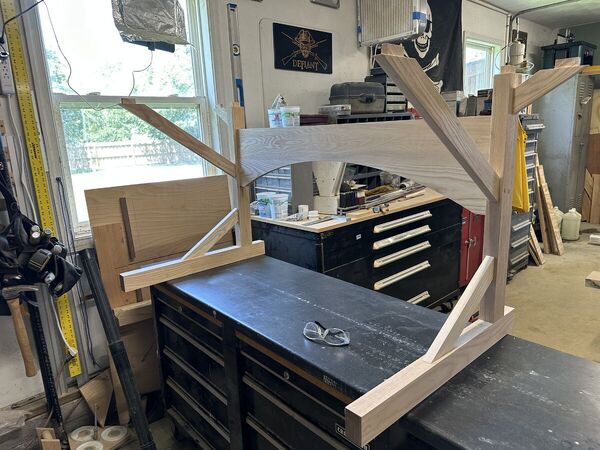

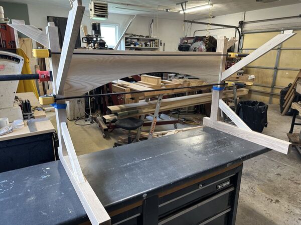

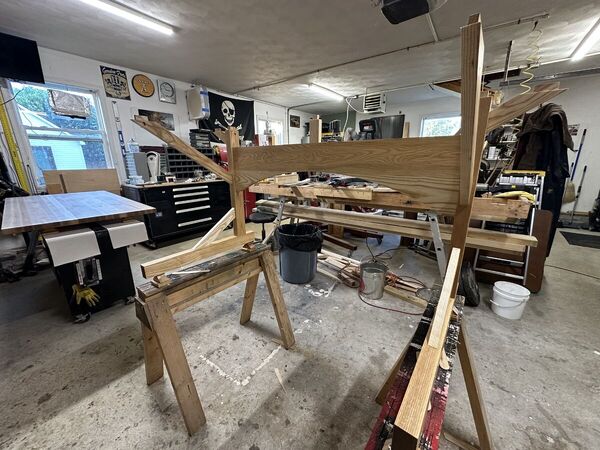

The stretcher is glued into the lower supports and clamped up. This is the final assembly for the support frame. I tightened the trigger clamps on the front side and pulled everything together with those. That makes the front side pull in a little more than the back. I have a pipe clamp in between them on the back side and tightened that one until the feet were parallel again. IMG_8999.jpegHere it is out of the clamps. Just have a little bit of glue residue to deal with and it will be finish ready. Next step will be to put it upside down against the underside of the desk top and mark out the mortices.IMG_9002.jpeg
Edited by Zack
Your last picture finally opens my eyes to what this table will look like, and I am impressed, looking goodTwoThumbsUp

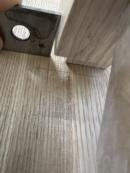

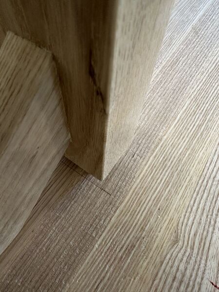

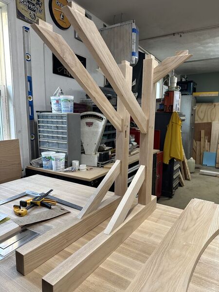

Flipped the top upside down and marked the locations for the main risers. Set the support assembly against it, lined it up and marked around the tenons to locate the mortices.IMG_9042.jpeg

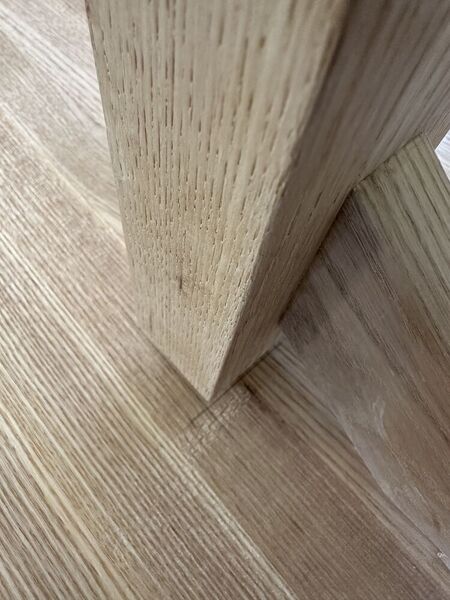

A little fine tuning, some wax and I have a good fit for each mortice and tenon.IMG_9070.jpeg

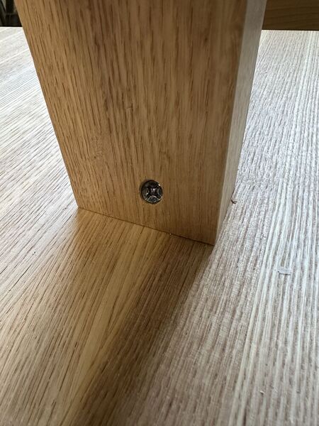

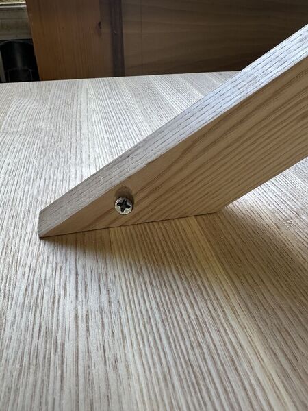

I want to have the top be removable, so I’m not going to glue it. The joinery by itself will be fine for support but I’ll put an angled screw in each of the 4 main supports into the top to keep it secured.

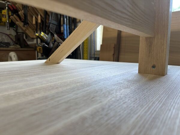

Made up some drill guides for angle drilling the screw holes through the supports. IMG_9098.jpeg
IMG_9099.jpegDrilled the holes through the supports so the screw exits about midway through the side of the tenons. This way I get the pulling force of screw as well as it essentially acting as a pin locking the tenon into the table top. I need to get some longer ones for the main supports though.IMG_9097.jpeg

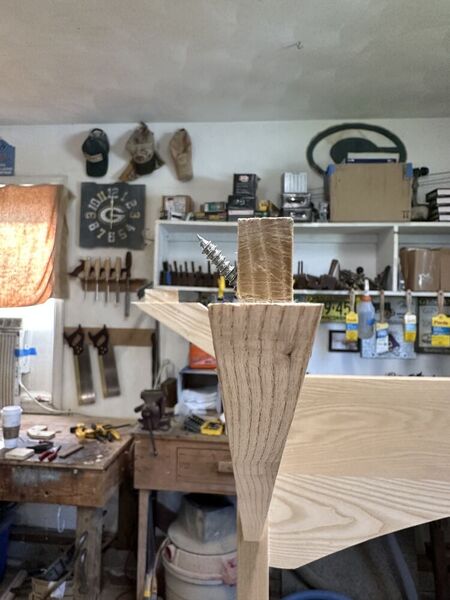

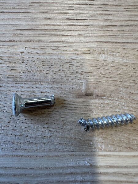

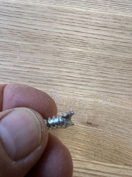

IMG_9096.jpegWhen I was getting everything test fitted, one of the screws snapped off attaching the angled support. It broke midway in the support so it left it locked to the top. I managed to drill the broken screw far enough to clear the tenon and get the support out. From there I cut a slot in the remaining piece of screw and turned it out. Got it all out nice and clean, Still able to use the existing hole. That’s a heart sinker when that happens. I made sure to burnish all of the holes with some beeswax to keep it from happening again.
Test fit, snugged up nice and tight. I’ll use brass screws for the actual assembly.IMG_9095.jpeg

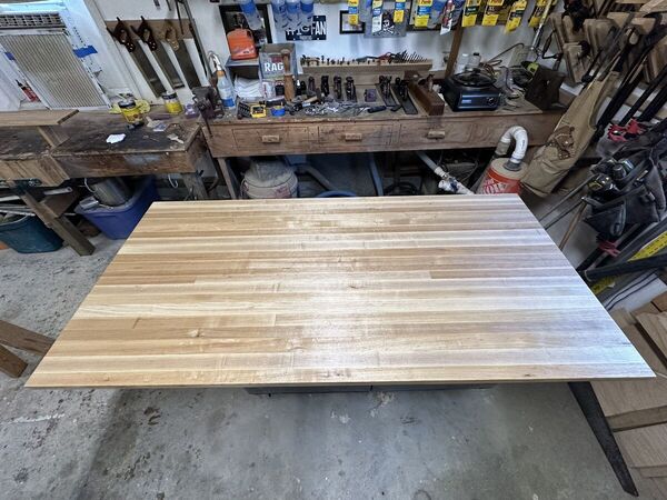

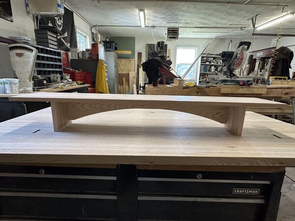

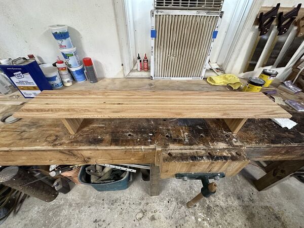

Finished making the monitor stand for the back of the desk and the top is fully smoothed and sanded.IMG_9147.jpeg

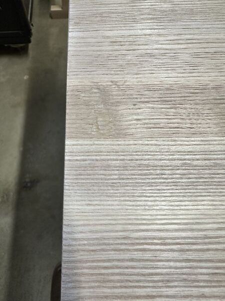

I had one bit of tear out that was too deep to work away.

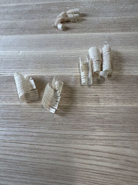

I selected some choice plane shavings for fill material.

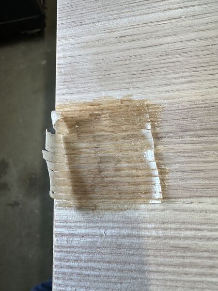

Layered in pieces of shavings with hide glue one at a time. Waited for each to dry before scraping and adding another until it came flush with the surface.

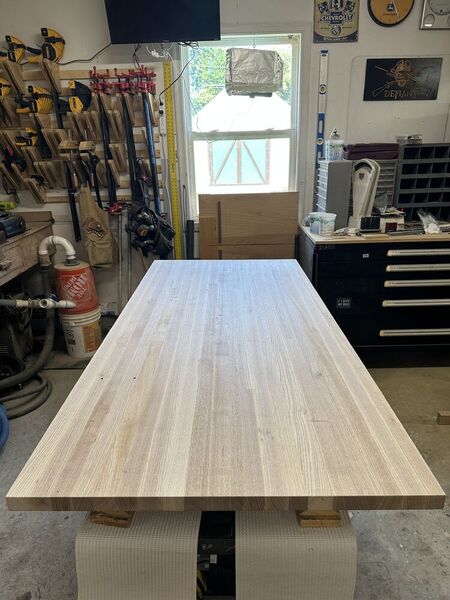

Pre finish assembly fit check
How interesting! Never saw that technique before. Worked amazing!
I've never used hide glue (please don't kick me off the site!). Is the use of hide glue a major factor in this process?
Hide glue will let the grain show through and it takes stain/ finish where as regular wood glue won’t.
