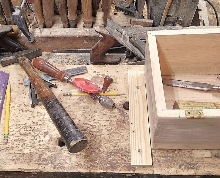

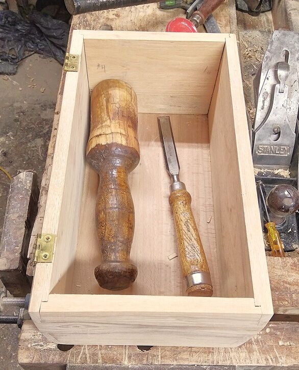

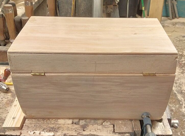

Popular Post steven newman Posted November 15 Author Popular Post Report Posted November 15 Next up? Hinge install..sorted through the supply box.. Some were too big, and some were too small, managed to dig out a pair that was just right.. Was trying to decide which will be the hinge side of the box...Tools? And these.. I also made use of this thing.. You drive a pin down, while the handle centers things up. instant pilot hole... Set the lid down onto the hinges,layout where to chop the mortise at on the lid.. And install...used a couple props, though..thin one under the lid to stop it rocking, and.. A couple of these under the box..to match up with the lid... So..pending the feet getting installed, and me finding a chain for the lid...how about a PIP? Hinge view.. A view of an ends..and.. Added a latch... Stay tuned... aaronc, DuckSoup, Gerald and 2 others 4 1 Quote

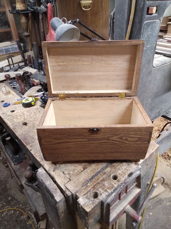

steven newman Posted November 21 Author Report Posted November 21 Ok..Brass Chain...came in a 72" long "bundle" had to snip a bit off.. That should do the trick...? gave the box a good rub down and wipe off...Got out the can of Varnish and a can opener.. aka "Church Key" the proper way to open a paint can. Brushed on coat #2....handles came in handy... Will let this sit right here... That be a reflection of the No. 6c plane sitting beside it... Will see how this turns out, later... Stay tuned.. Gerald, Grandpadave52, Fred W. Hargis Jr and 1 other 2 2 Quote
