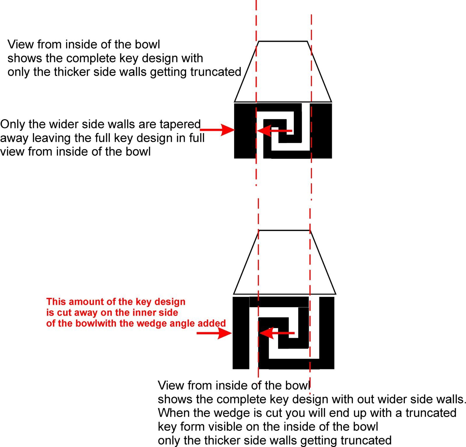

One comment on the Greek key feature ring
 It works OK on a vase because you cant really see the inside of the ring. On a bowl however  if you make the key design the full width of the wedge length it will be pretty well truncated on the ID of the bowl and visible. It will not be the same as the key image from the outside of the bowl If I were using this on a open bowl I would make sure there was enough solid wood beyond the key design ( see the picture) so only the plain wood was cut away when the wedge was cut.
Hope this makes sense. Just want you to think about this before you start cutting
calabrese55

the truncation was one of my concerns.
I'm guessing that the thicker vertical pieces will be a trial & error deal.
I was just hoping that there was an easy way to do this and that I was just overthinking it.
Guess not

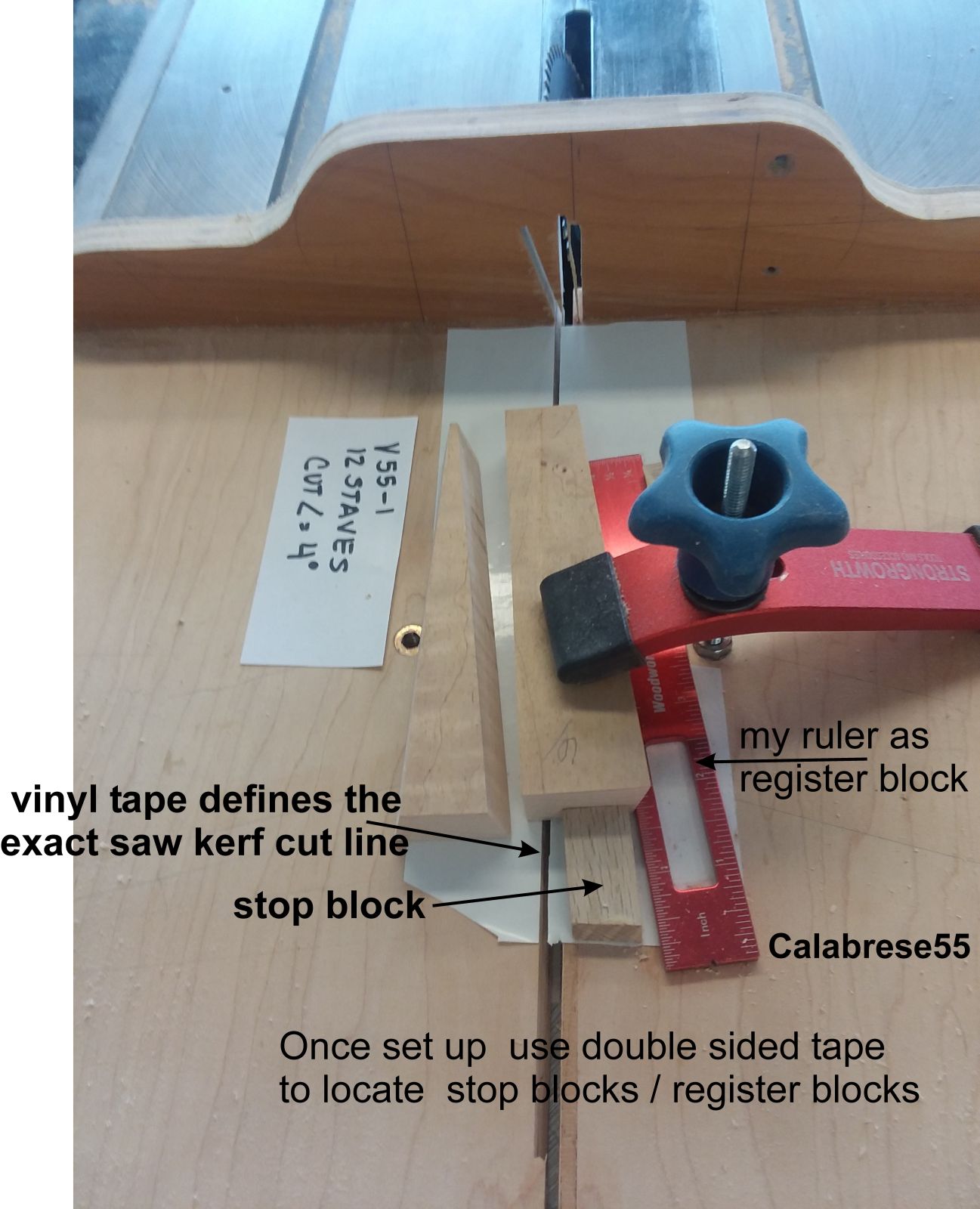

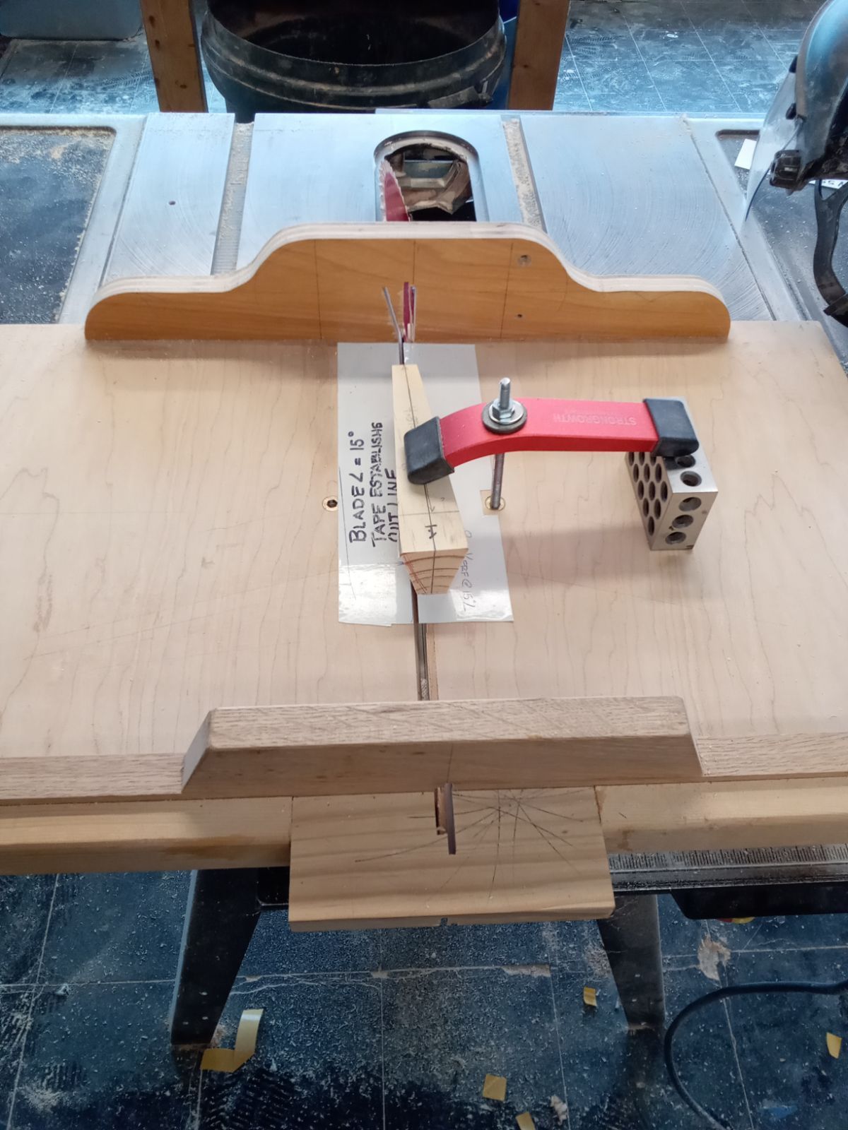

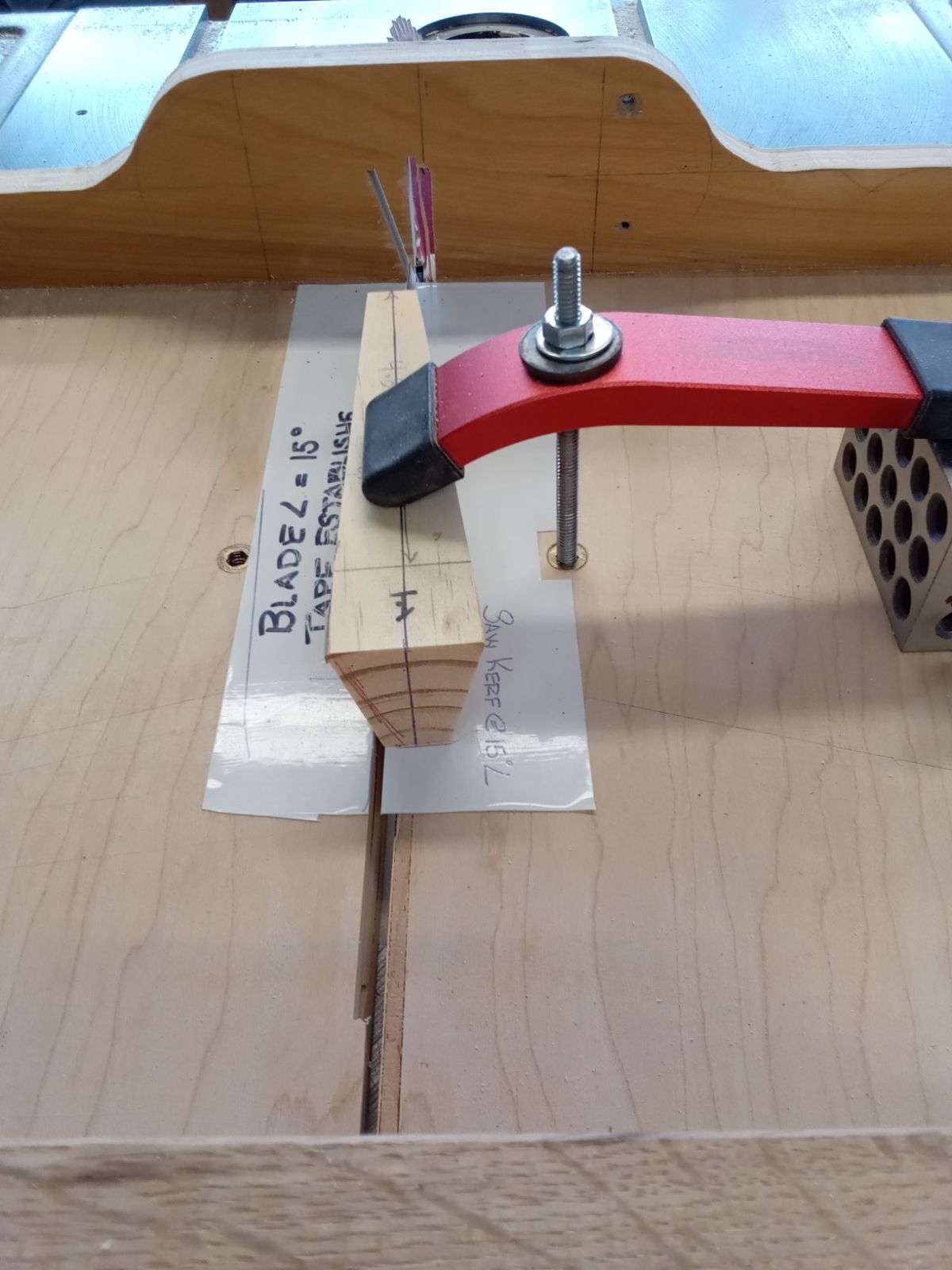

there are 100000000 ways to skin a cat I cut small wedges or wedges from short stock pieces etc on a cross cut sled with hold downs.  The picture here is a set up for cutting a vase stave  but the exact same detail works for wedges. If set up carefully it is highly accurate to the cut line. Ask any questions on the process
calabrese55
