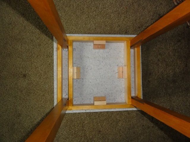

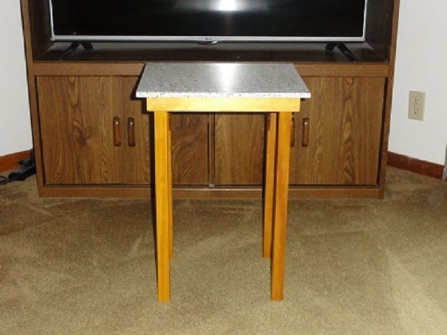

November 23, 20241 yr Popular Post comment_346889 I built this table in 2010 and have used it most every day and it was constructed with glue only. No metal fasteners, no dowels, no biscuits, etc. I use it as a dining table while watching TV. The top is Corian. Edited November 23, 20241 yr by HandyDan Report
