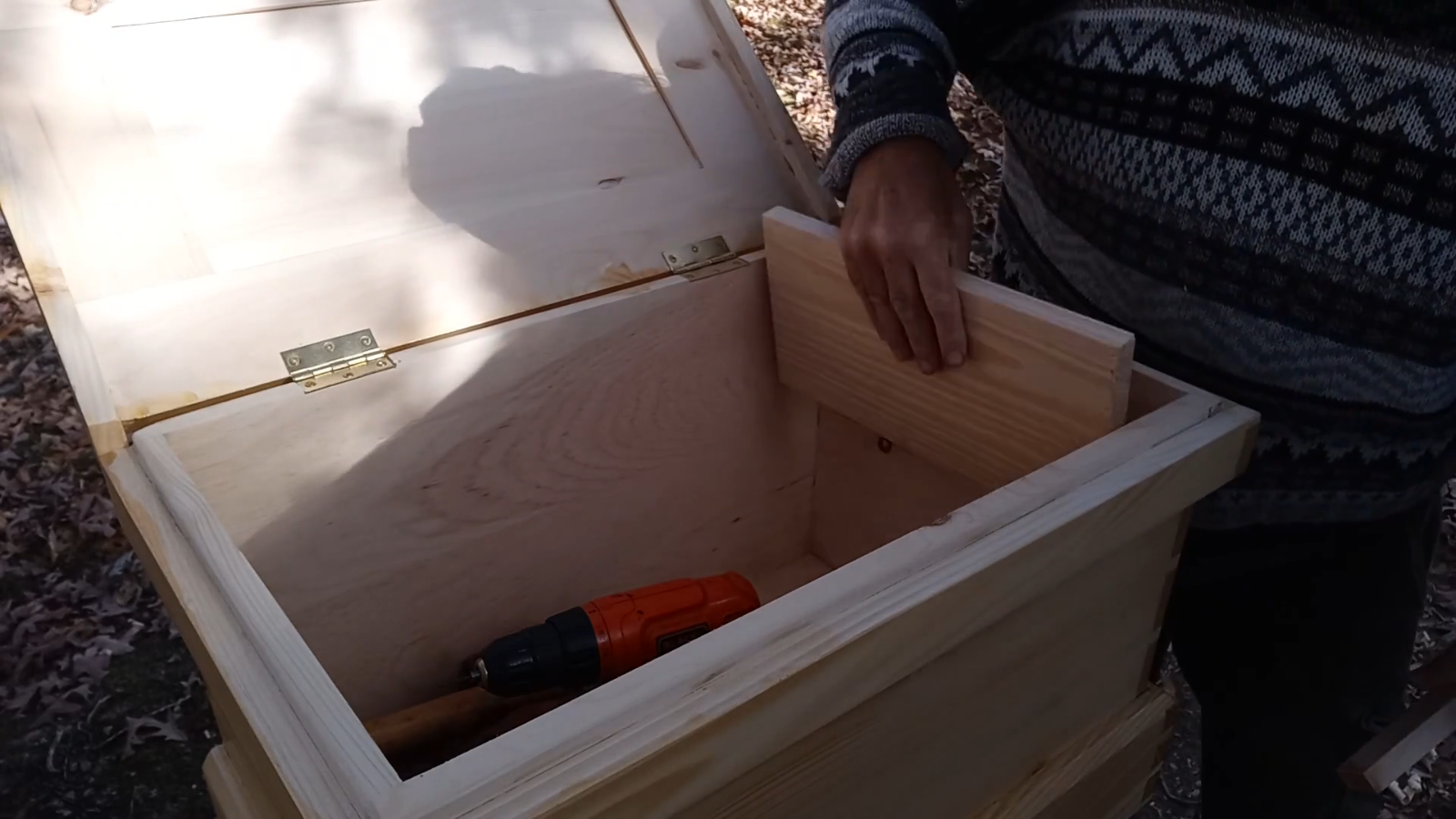

Time to make and attach the rails the tills will ride on. I've decided on two smaller ones instead of one large one.
The first thing I need is a measurement for the length, so I just use the project itself. rails1.png.250736343fb2de4ac9c63281c0adf663.png
I don't care what this measurement is, the mark taken from the chest itself is all I need.
Then, into the vise and cut it to length. I should add that i cut it a bit long, and used the shooting board to sneak up on it.

    Wanted to add some pictures of the trays in the box when they are completed. I also added a strip of leather to help hold the box open and relieve a little bit of the stress on the hinges.

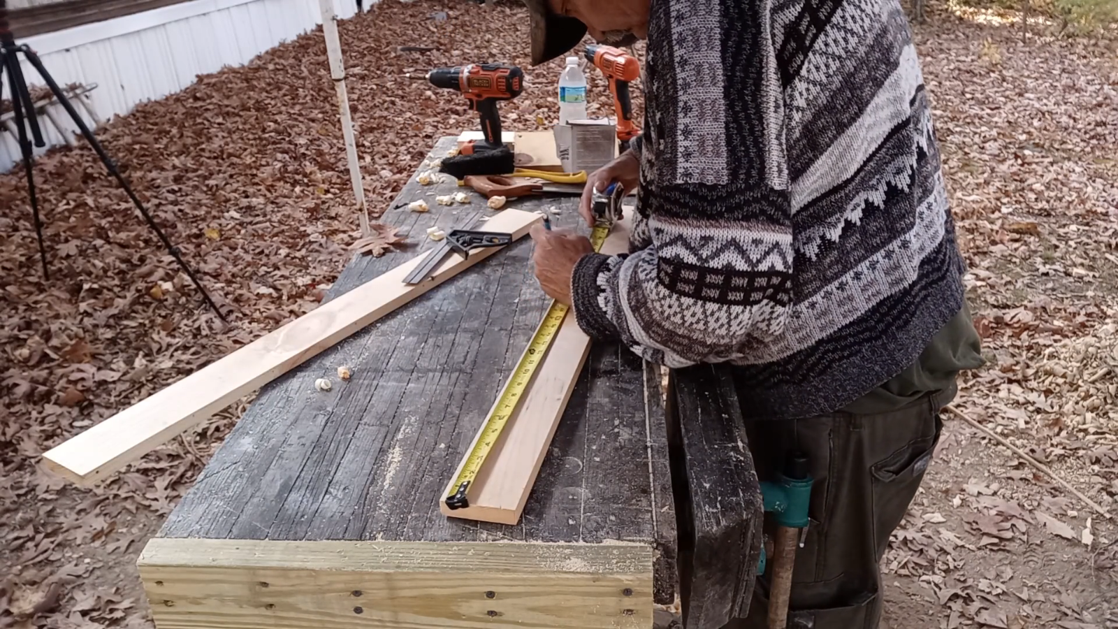

After which, I size the two rails together. I want them the exact same height.
You will notice that one of them is a bit short. It was what i had to hand, and the till will slide along that little bit of air just fine.
I wanted them the exact same height because I am using a board as a spacer that is sized so that, when I set it in the bottom of the chest and lay the rail on top of it, the rail will be at the exact height I want it's top edge to be, on either side.

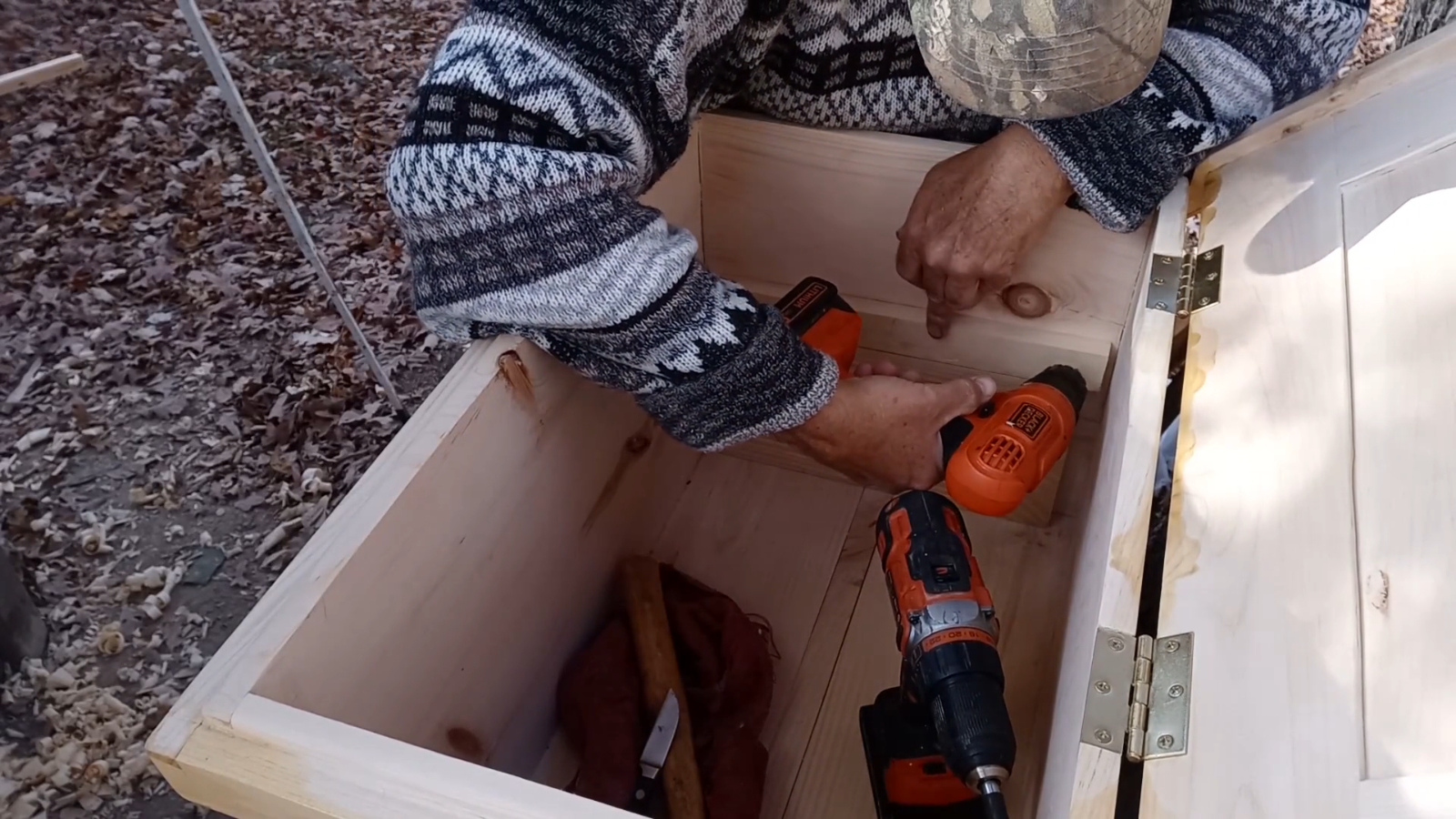

Shout out to @Gunny. I repaired my old drill, but two drills made this process a heck of a lot easier.

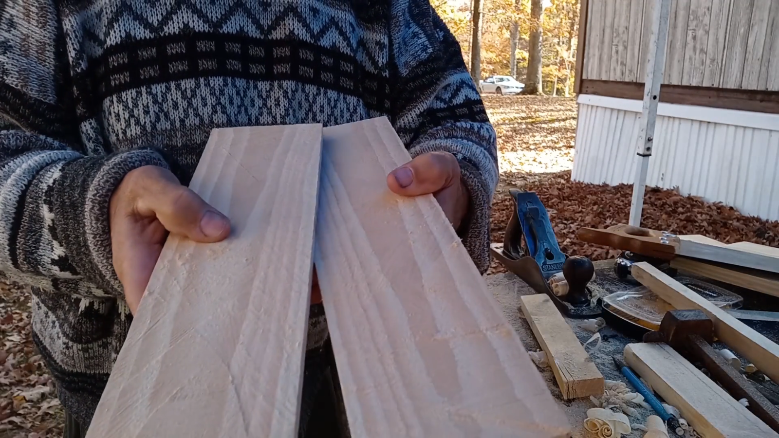

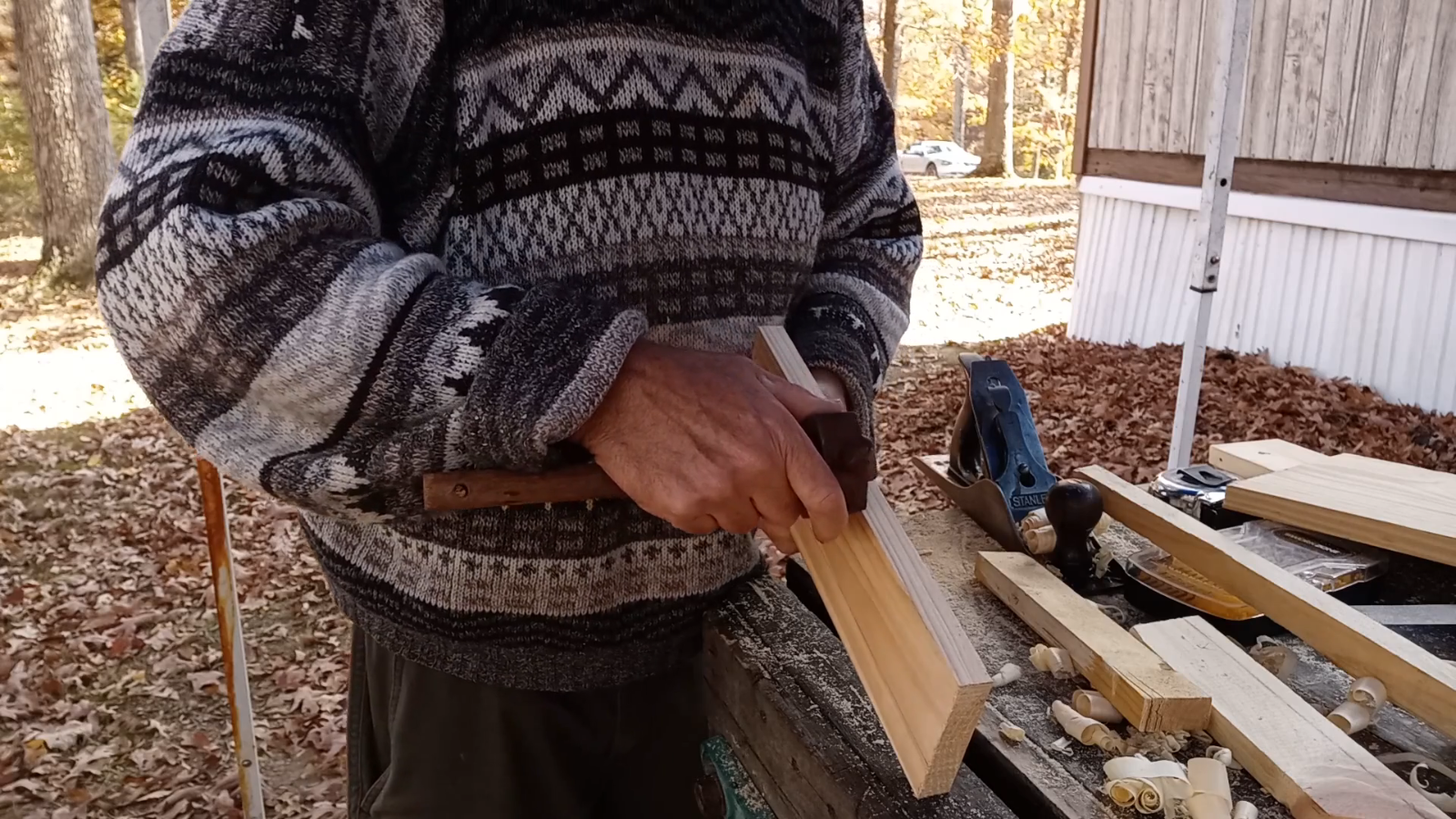

For the smaller till that will sit on top I needed to resaw aboard so that the rails for it would be thinner.
So, mark my lines......rails11.png.89e401237f691207fe91ea8f7b644ea0.pngrails12.png.7ac4009d6bb7e5d56f484b71a973fe43.png
....and saw between them.
rails8.png.683143a0337df6fa64c8aacf00e237e2.pngrails9.png.77dc5fd44a6392f4ef3cfbf506ad3da6.png
And install.
rails13.png.c5aa375bf9ab5bc4c421201d41ebb371.pngrails14.png.d97c18514bbb52ddcd3e731b1b0750fb.png
Told ya, :D  I bet we did a poll we'd find most have 3-4 drills / impact drivers / screw guns.

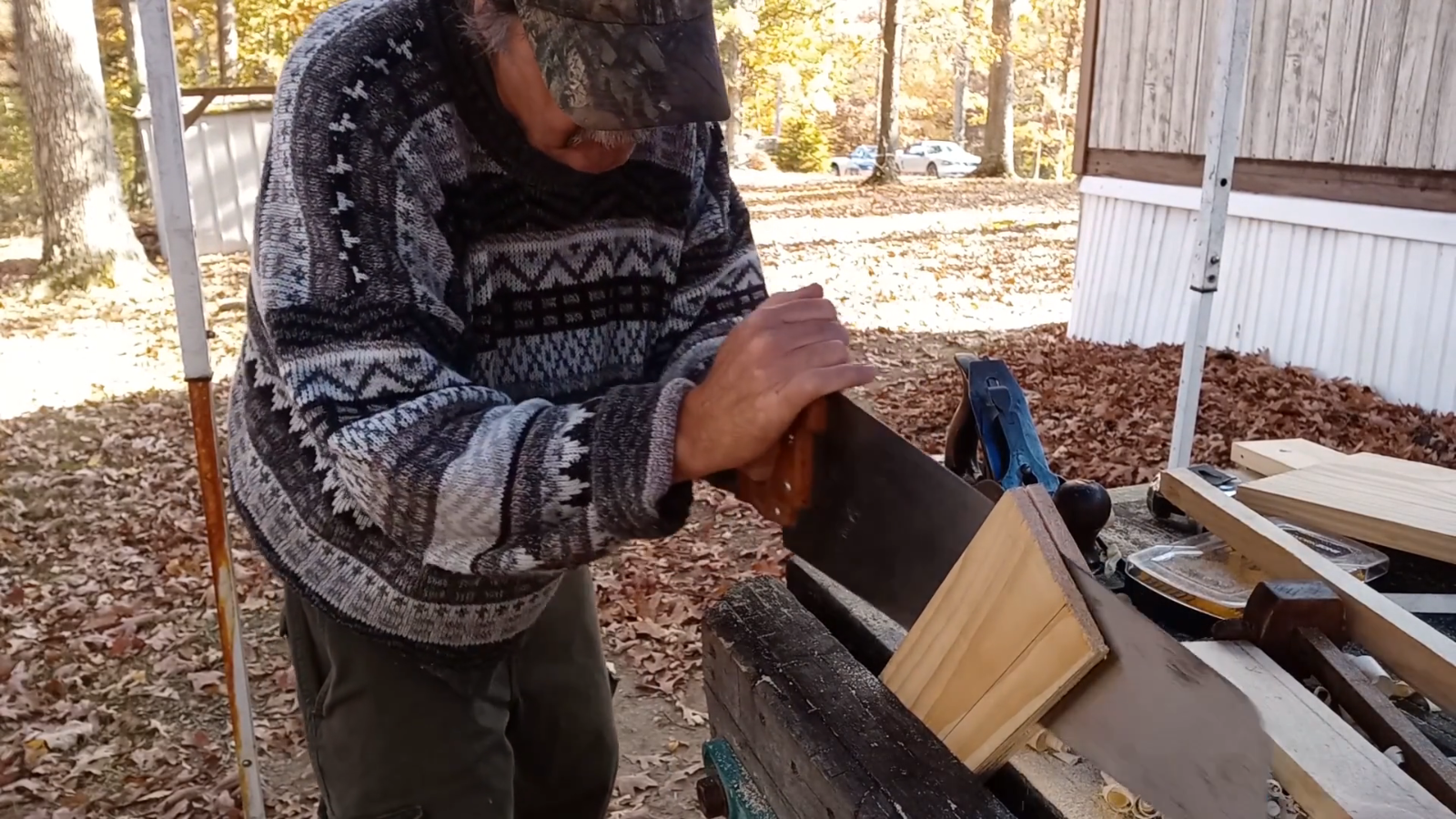

Firstly though, everything I do is with hand tools. Most of the time I am cutting pieces down from larger stock, which I flatten, square, and size by hand. I have shown some of that in this thread, but we are going to jump ahead a bit and begin by cutting those dimensioned pieces to final length.
So I'll mark it....
...and cut to length.
Then it's back on the shooting board to square up the cut.

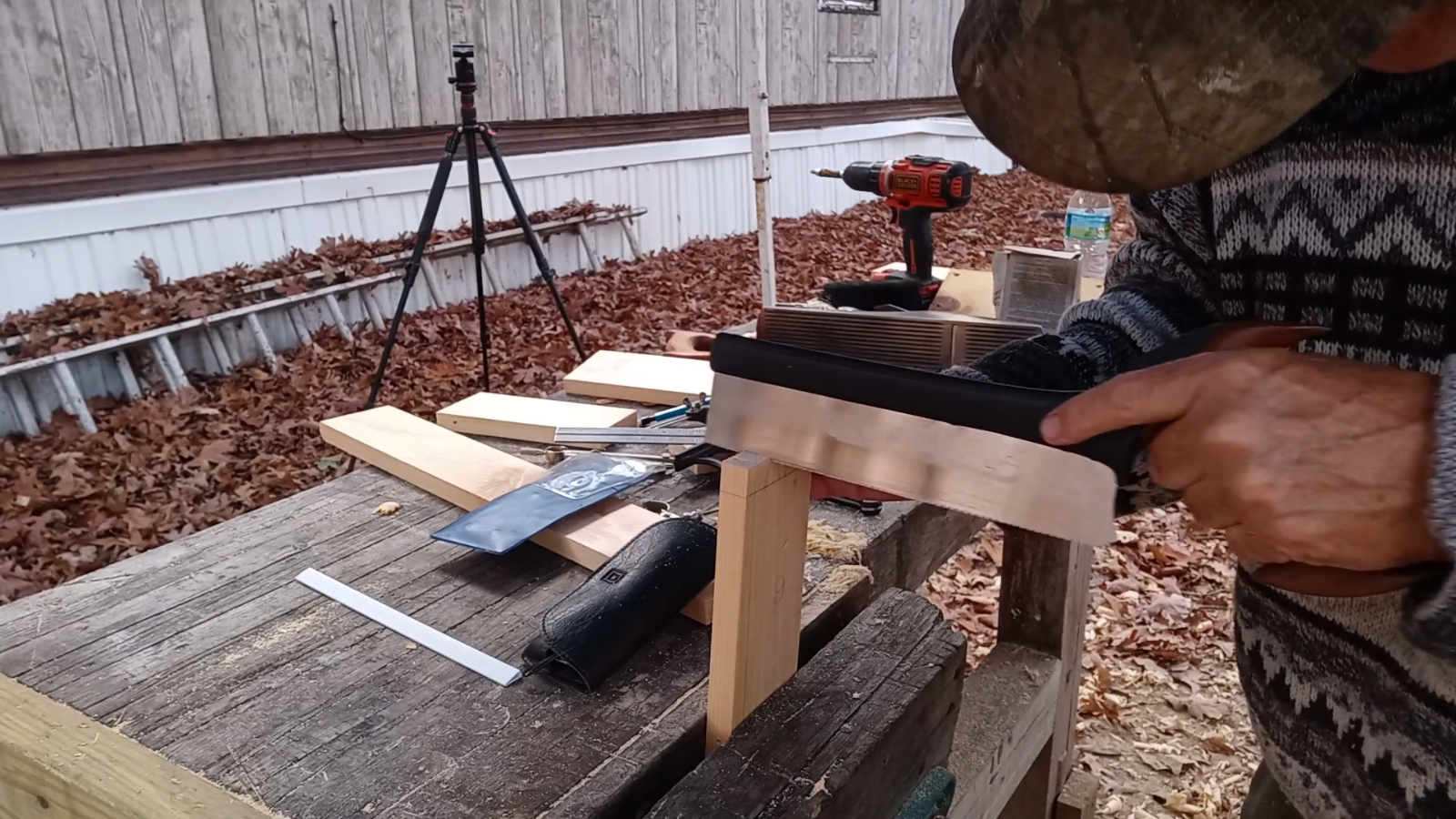

Then on to marking out for the dovetails. I use the method Paul Sellers teaches, and use the actual pieces and a marking knife and square to do the layout of the shoulders and baseline.
After which the dividers come into play.

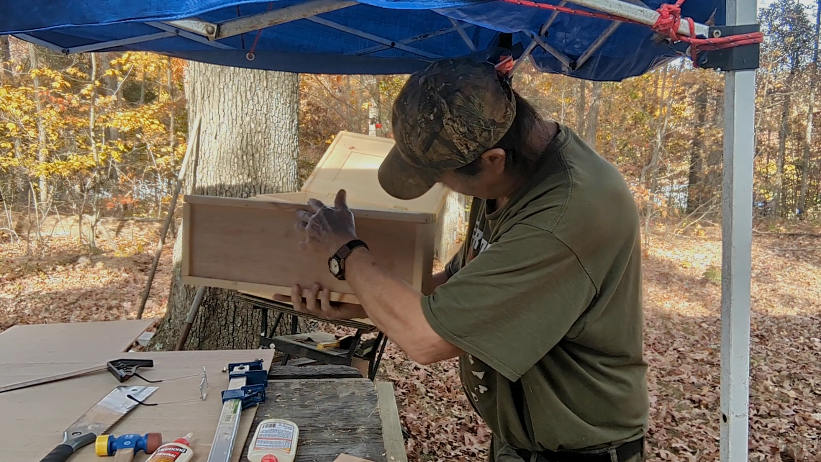

Glue up...
Assembly
Drawer #1 completed.
