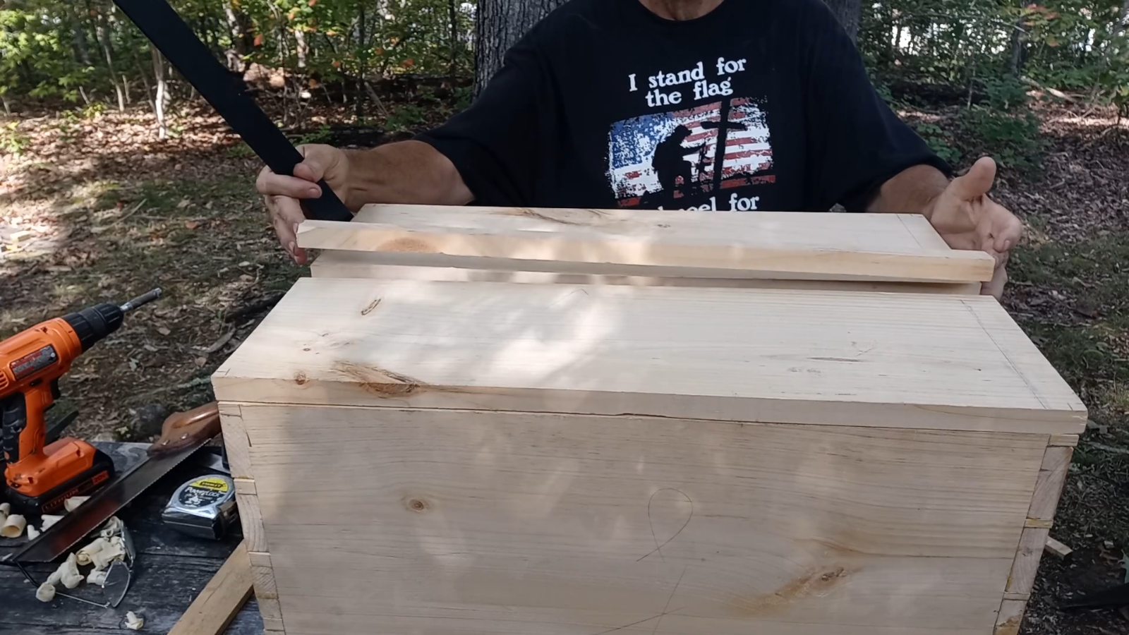

    Wanted to add some pictures of the trays in the box when they are completed. I also added a strip of leather to help hold the box open and relieve a little bit of the stress on the hinges.

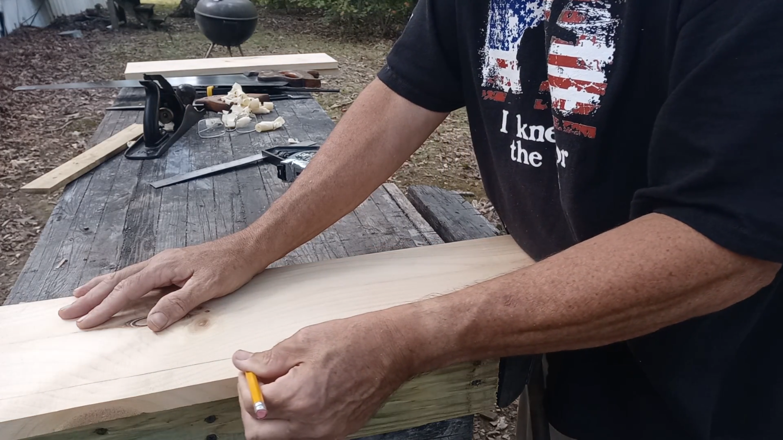

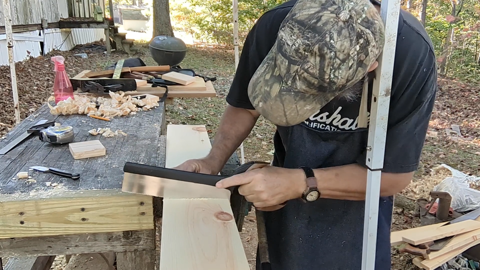

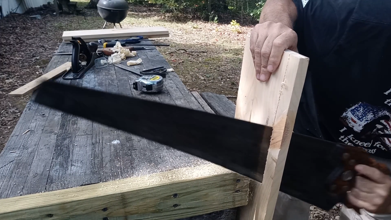

I needed two boards the length of the box to span across the depth from front to back, so I broke out the carcass saw.....
and cut them out. That's when i realized the boards I have are 1x8, and I need 1x10 to make the bottom with. I was around an inch short.
So, break out another board and mark a line.
And the Atkins makes quick work of it.

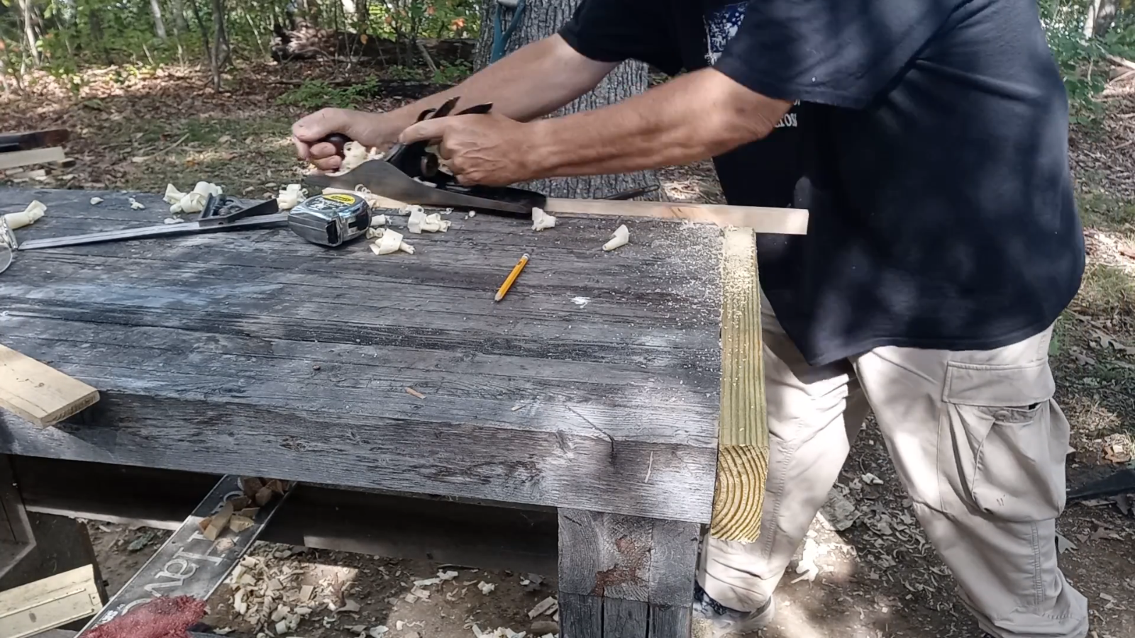

Edited by Handfoolery

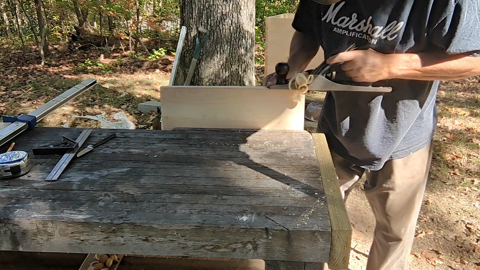

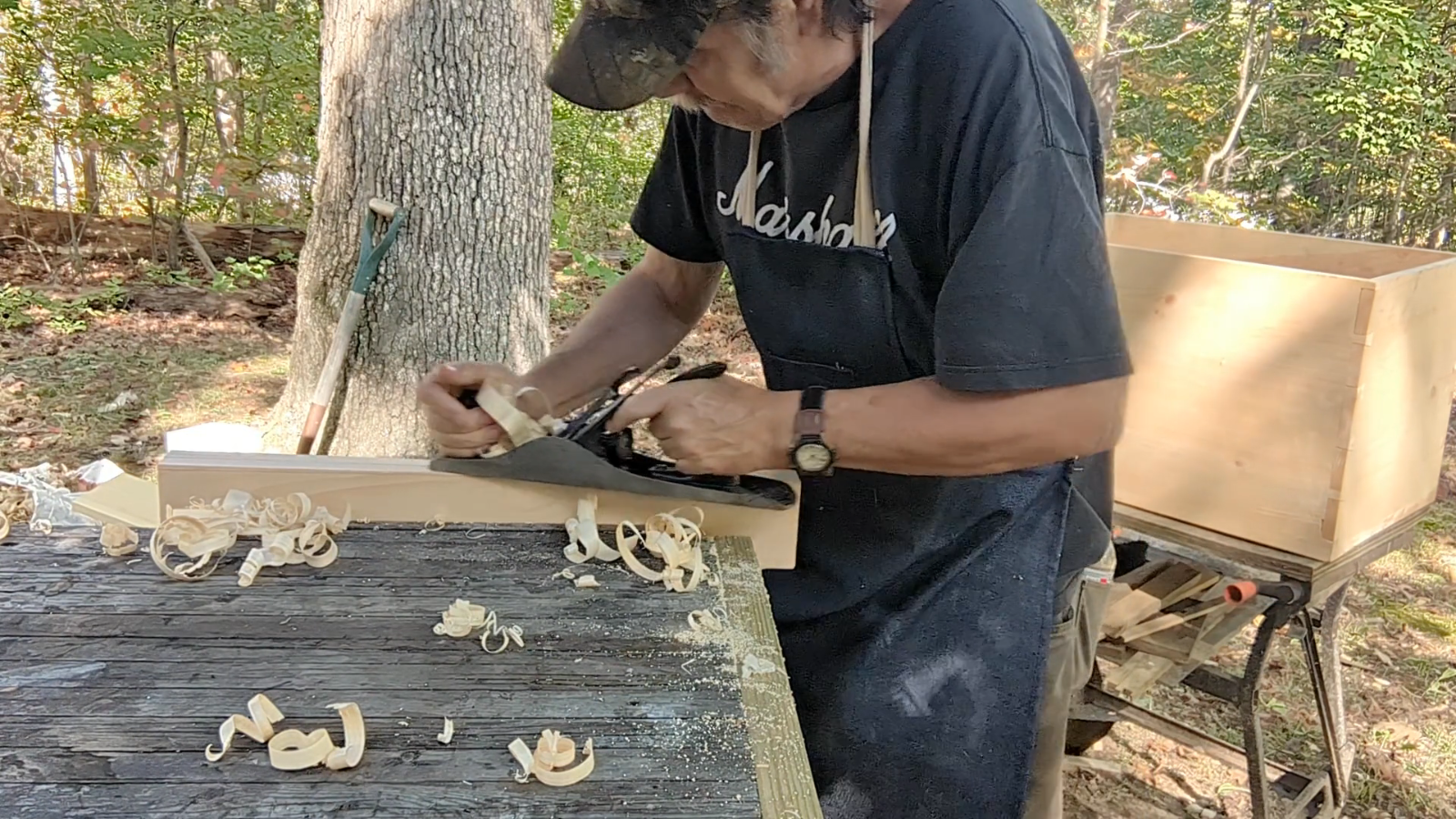

Then I need to plane that straight and square, so my good friend the #5 lent me a helping hand.
I chose to put the narrow piece in the middle.

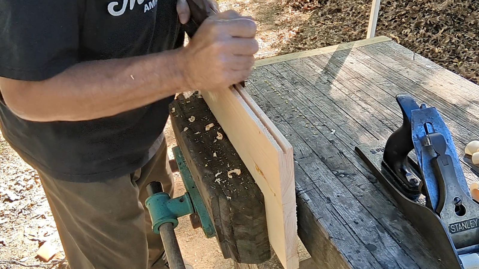

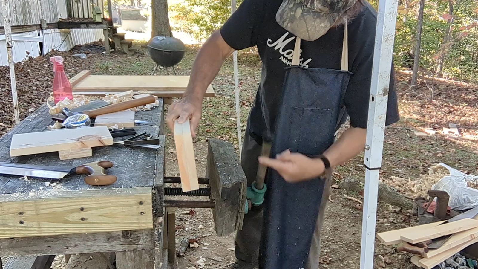

Put them together in the vise to square and size them together.
Groovy.

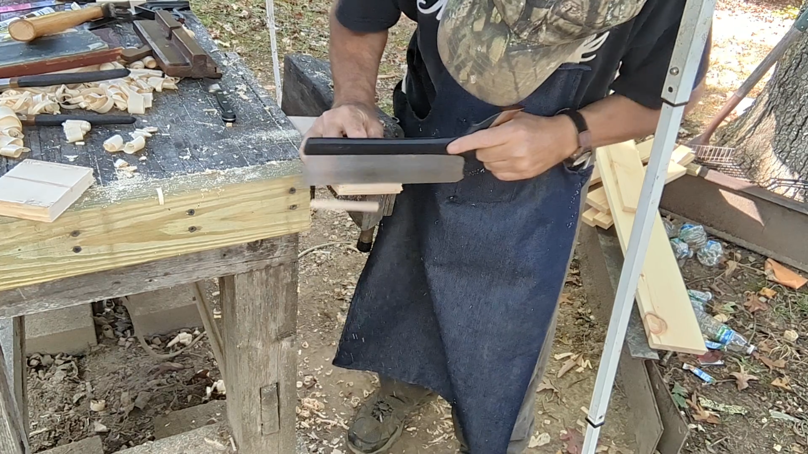

Cutting the tenons on the short side pieces.
Top4.png.4c59d320b7c01537f4510663fdcb13ec.pngTop5.png.461dfa1db18fbc5c15b8bfa432c68143.pngTop6.png.6fb8a7ddbc39c9c137a1a13b08486d1d.png

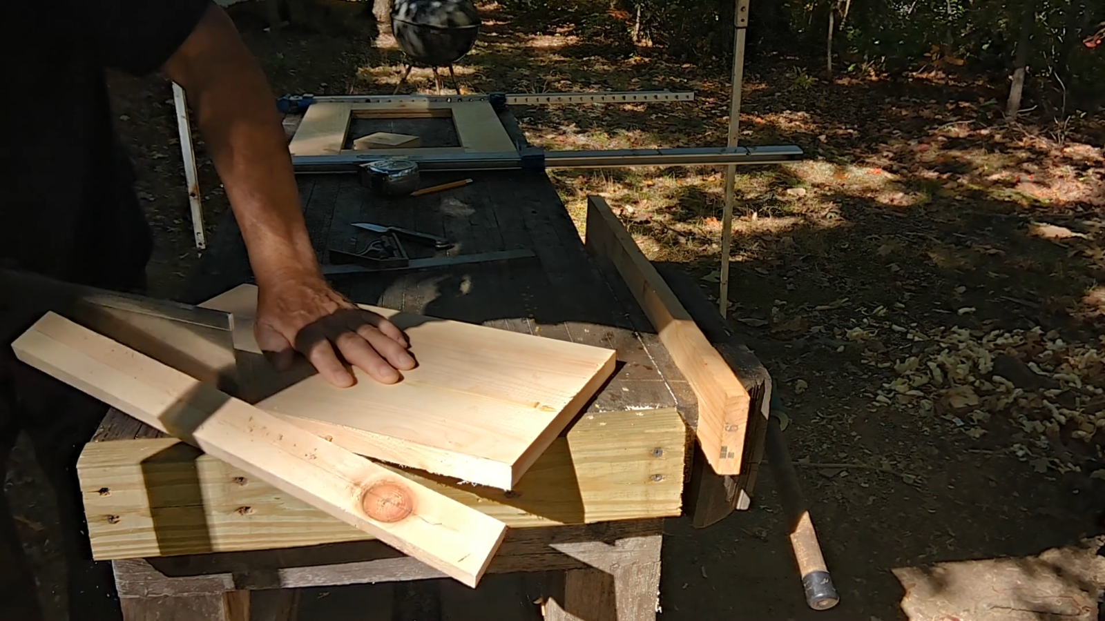

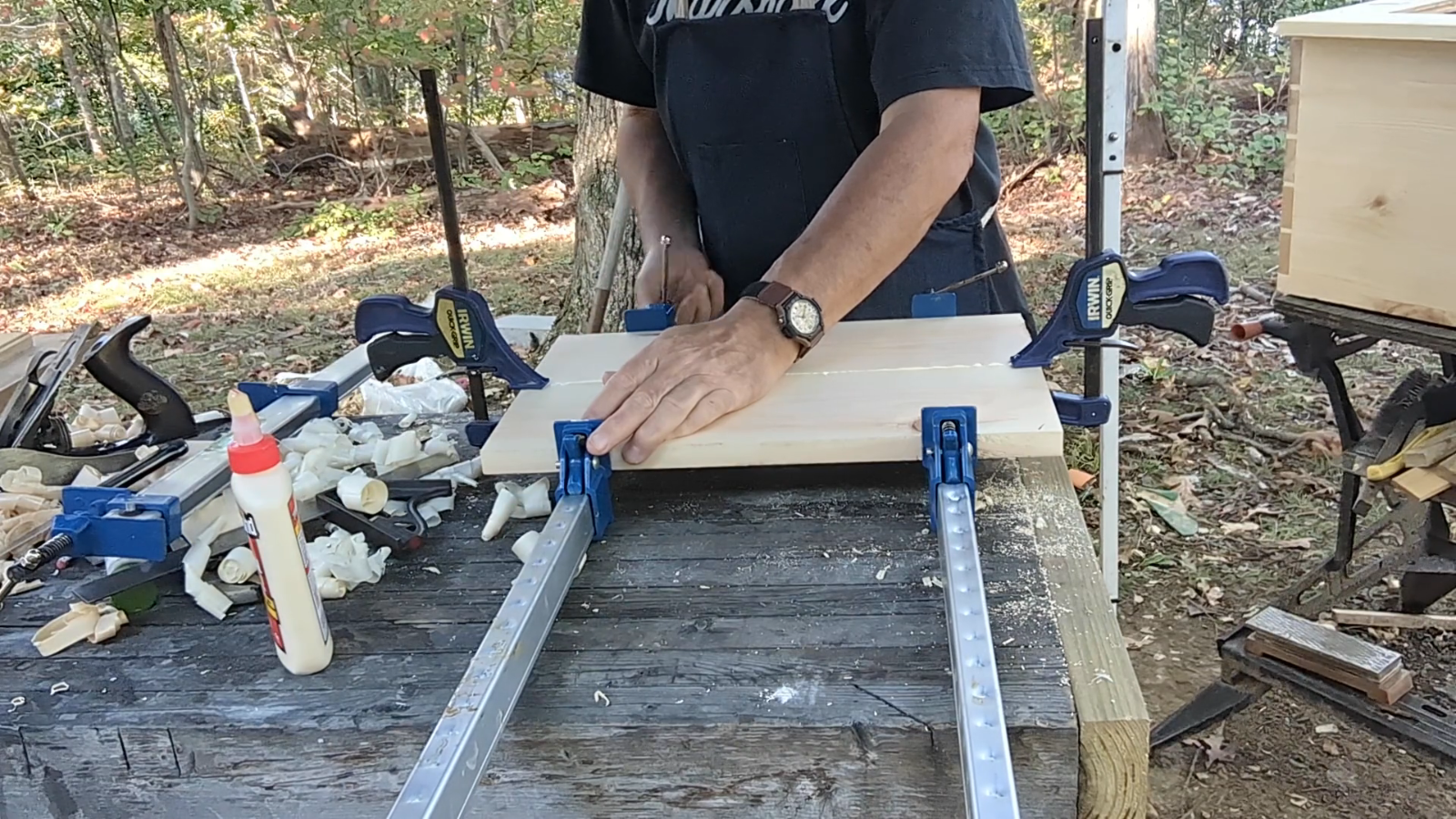

Cutting the boards that will make up the center panel.
Pop them together in the vise....
.....and joint them.

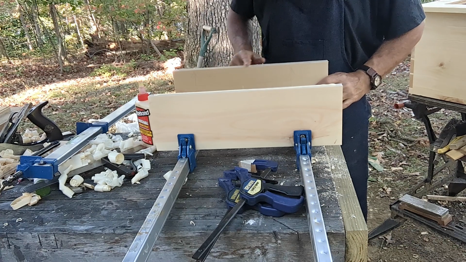

Using the finest glue spreader known to mankind.
And clamp em up.
Time to cut the center panel to width.
Then true it up and bring it to final size with the #5.
Annnnd, everything's groovy again.

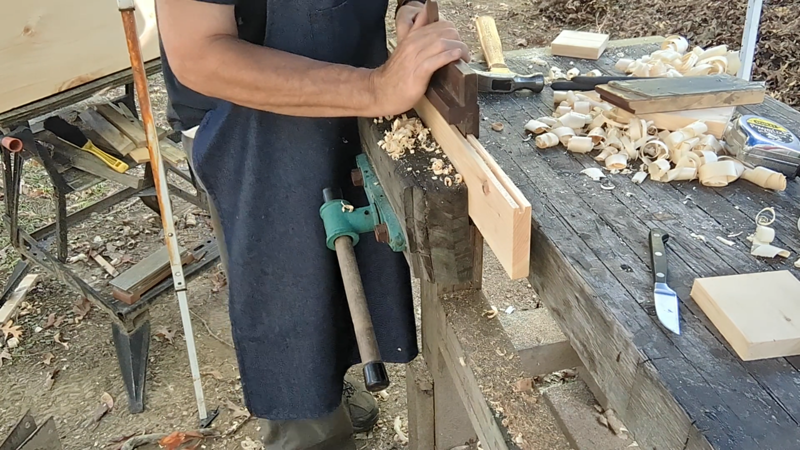

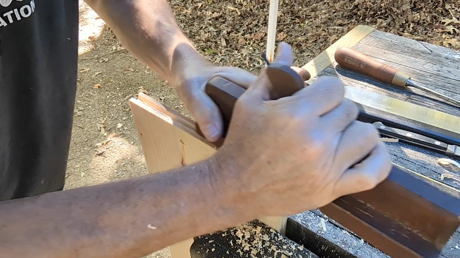

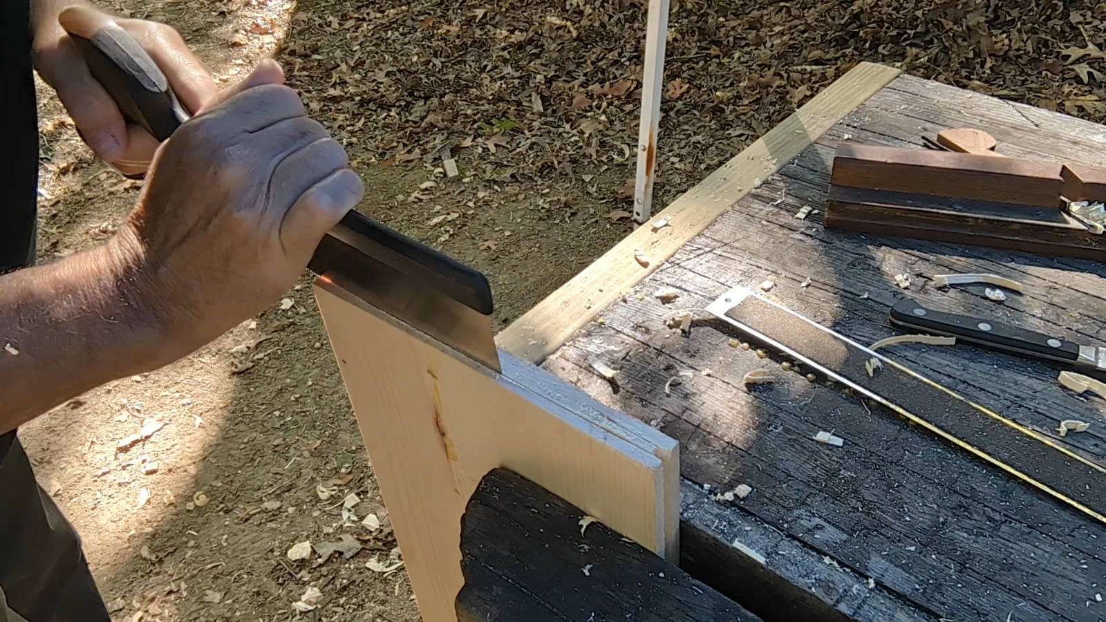

To plough a groove in the end grain I first use a saw to make cuts that correspond with the width of the groove.....panel5.png.43c65241ba372cc1f09d2e1f7d6c49b2.png
.......run the plane a bit to start the groove, being careful not to go all thew way through to the other end....
...then flip the board around and use a chisel to bevel the far end....
....Flip it back around and finish up the groove.

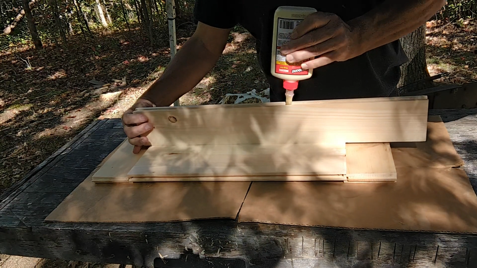

Time for the glue up.

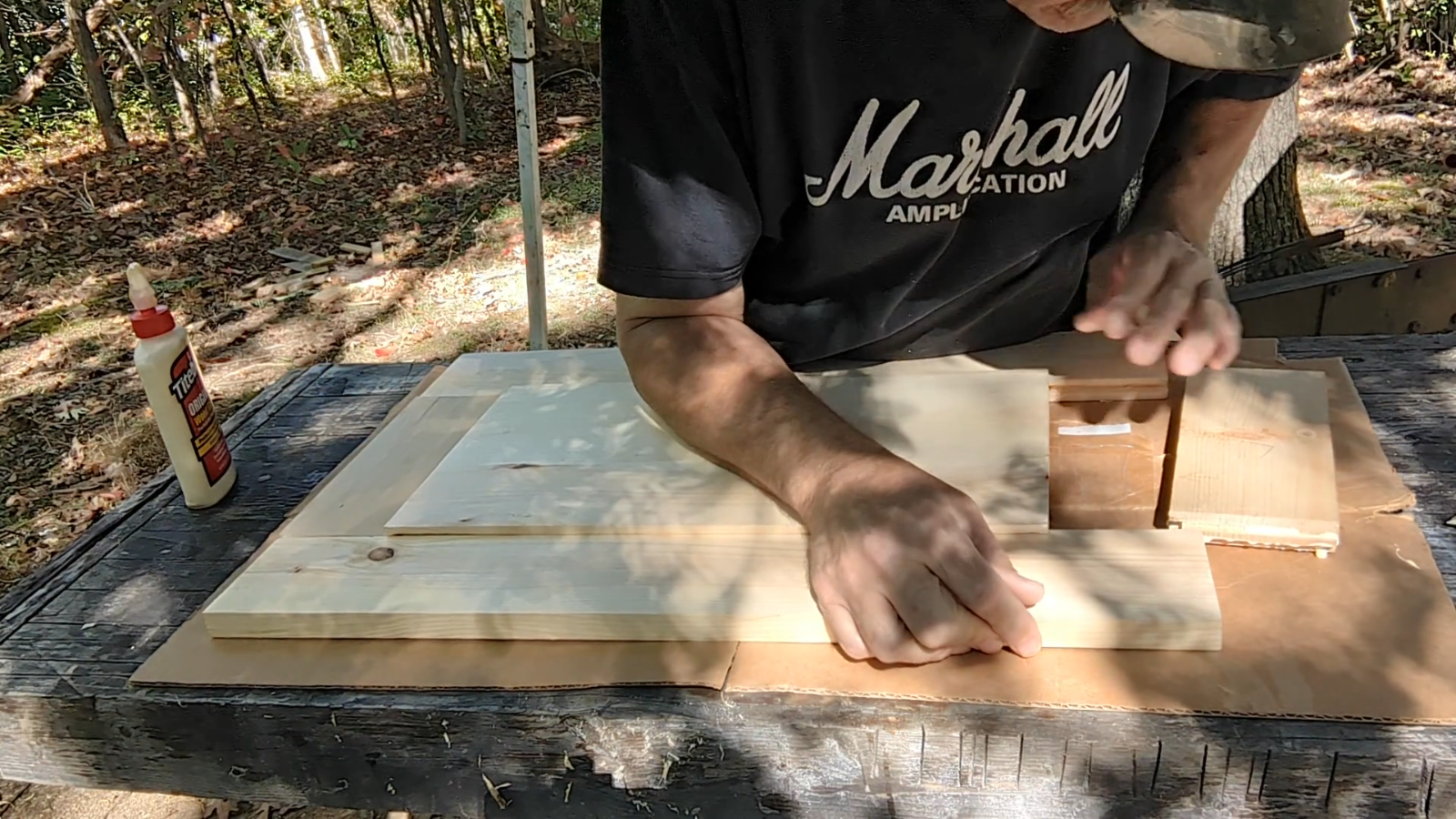

panel9.png.5587ac1364ad0bfd79f3c0354c79931f.pngpanel10.png.00073ec3bc02f336e05b19f34b5d4b78.png
Tapping things into alignment.
