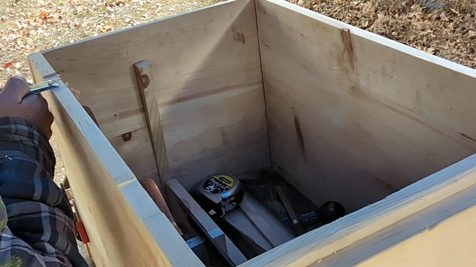

    Wanted to add some pictures of the trays in the box when they are completed. I also added a strip of leather to help hold the box open and relieve a little bit of the stress on the hinges.

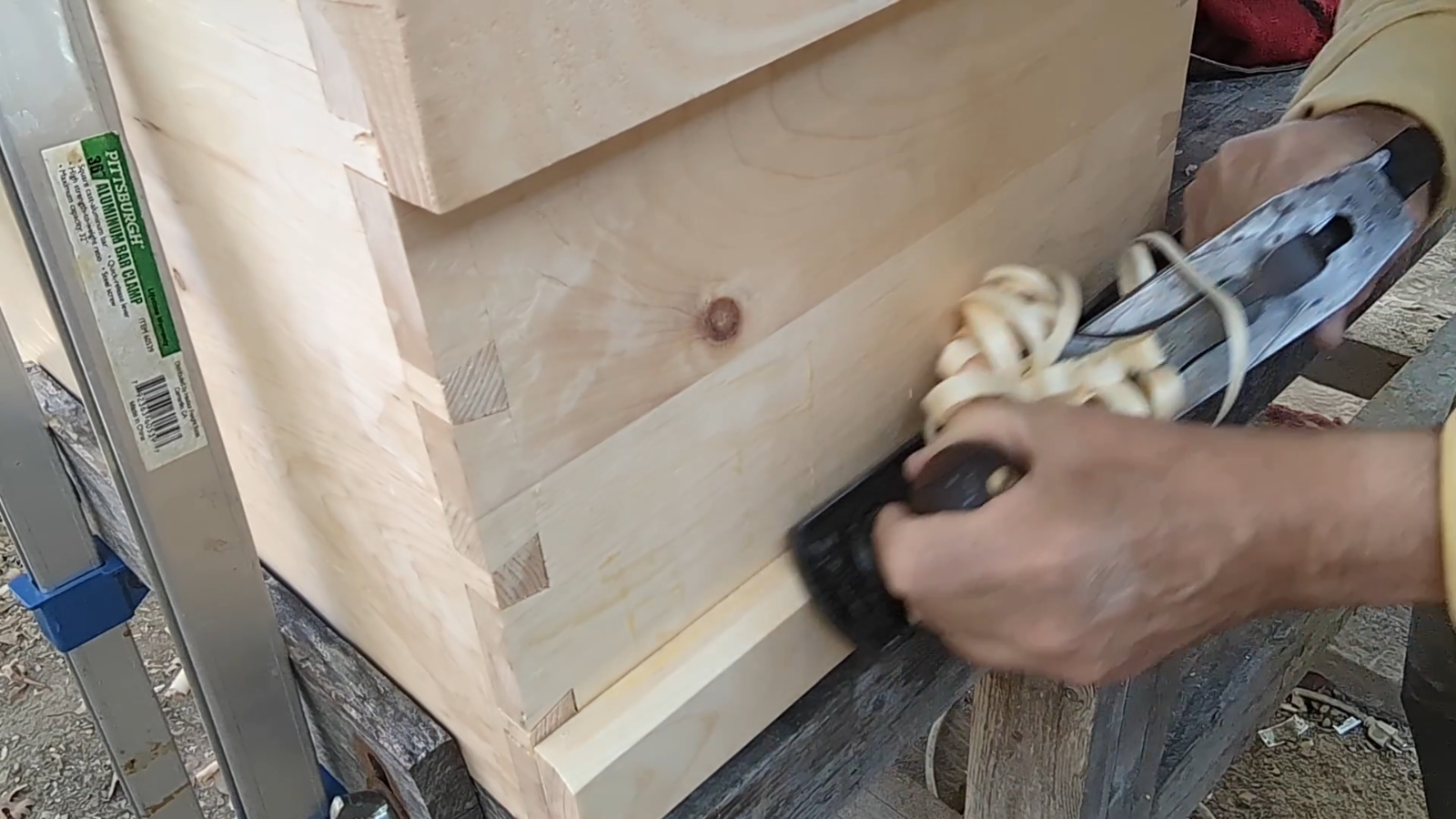

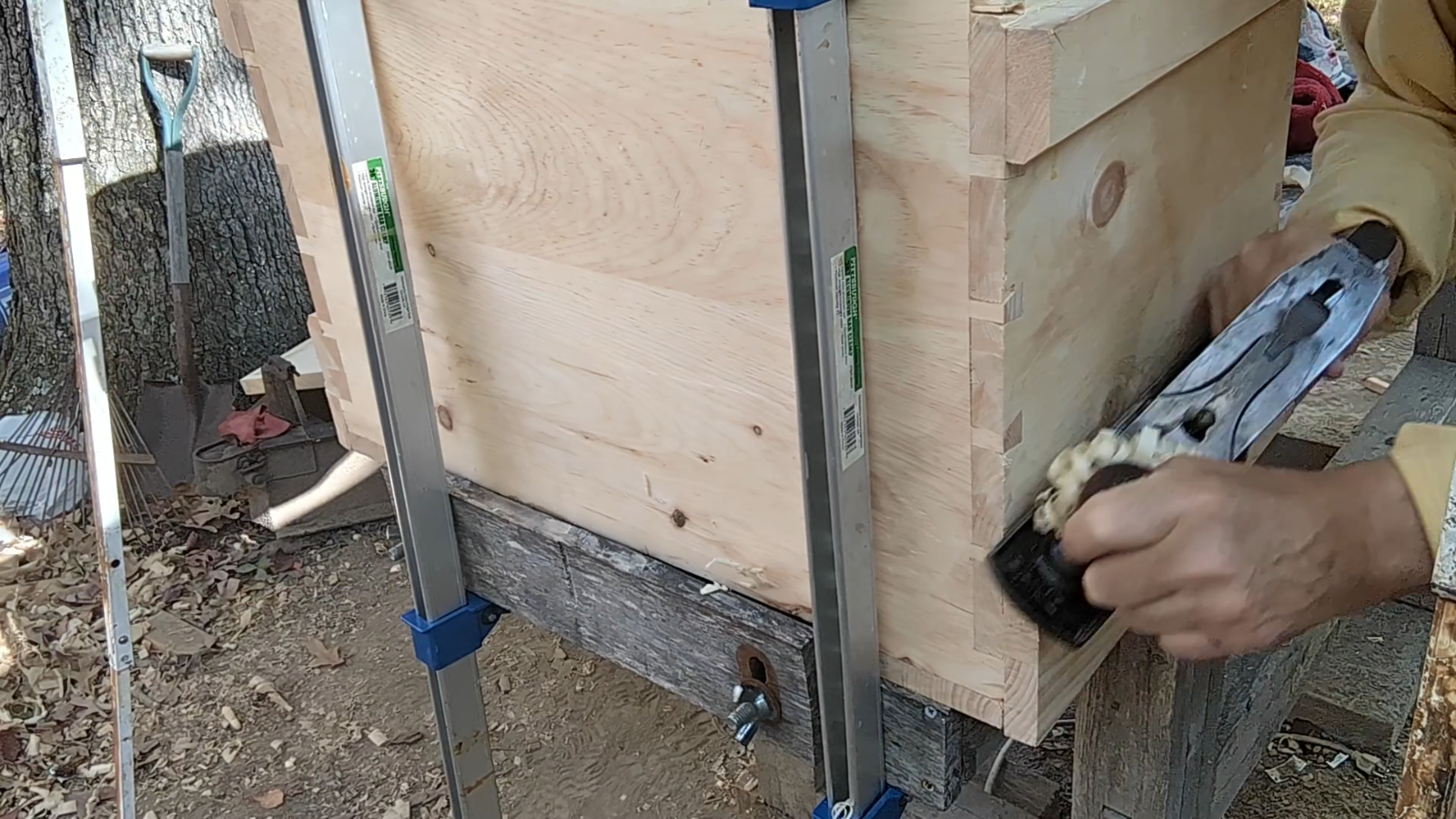

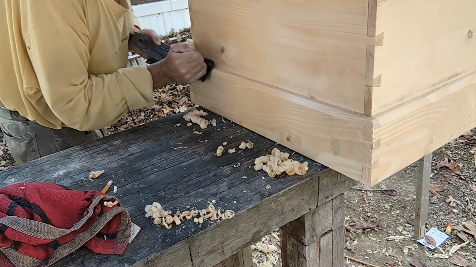

Once the glue was dry on the skirting it was time to bevel it.
I started on the underside of the skirting that, combined with the lid skirting, forms the dust seal. Short sides first....

I will have close to 6 inches left in the box after installing the saw till. I want to leave an inch for a piece of leather to hold the lid in position when opened. That will leave around 5 inches depth. A can either do one large tray, or a 3 inch deep tray and a 1.75-2 inch deep tray. Have not decided as yet.

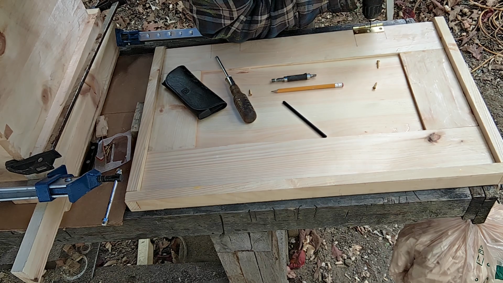

Time to install the lid, so chop it out first....
Then pare away what I don't want.
hinge5.png.a3a8b3debd5af55e8734fabff77324c9.pnghinge6.png.de6d48ac261db9f4dc71390e19ea5f69.png
I use a transfer punch to mark the hole locations.
....and drill them out.
I fitted them to the box, then they will be removed and installed on the lid itself.
Marking the location of the hinges on the edge of the lid so I can locate them properly.
After that I mark the location for the hinges on the inner part of the lid, where they go.
I cu the mortise on the box itself to the depth of the hinges when they were closed, so I didn't need a mortise on the underside of the lid. So I drilled them and installed them on the lid.
