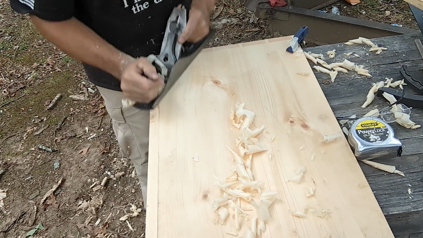

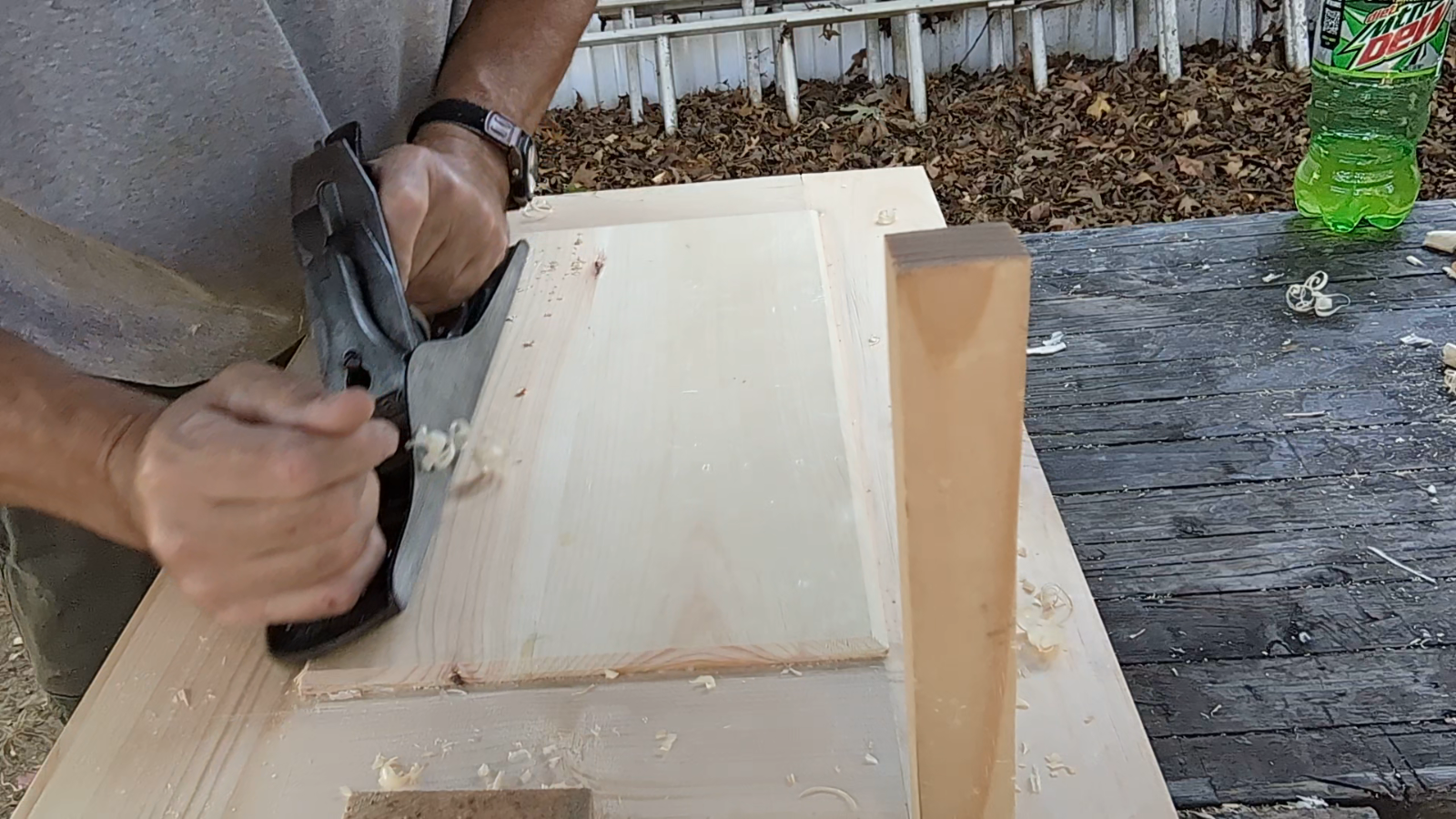

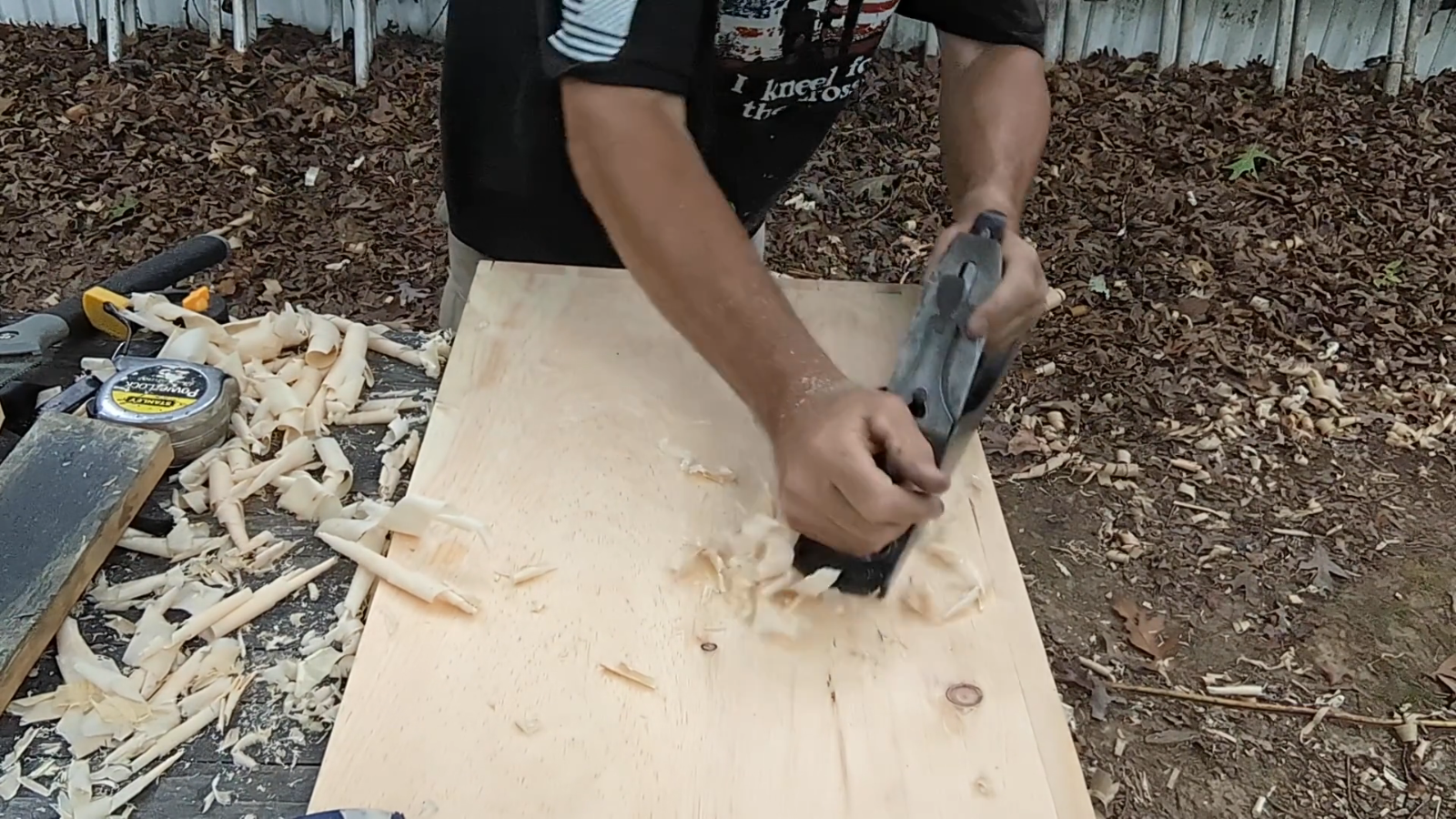

While the glue dries I took the opportunity to do a bit of smoothing.
smoothing3.png.f8a98fcfd66b1aff382006f0ee213848.pngsmoothing2.png.52c6329b2969042907181bc5f82293fd.pngsmoothing1.png.274e4d82220da6cb6b72bd8898af7320.png

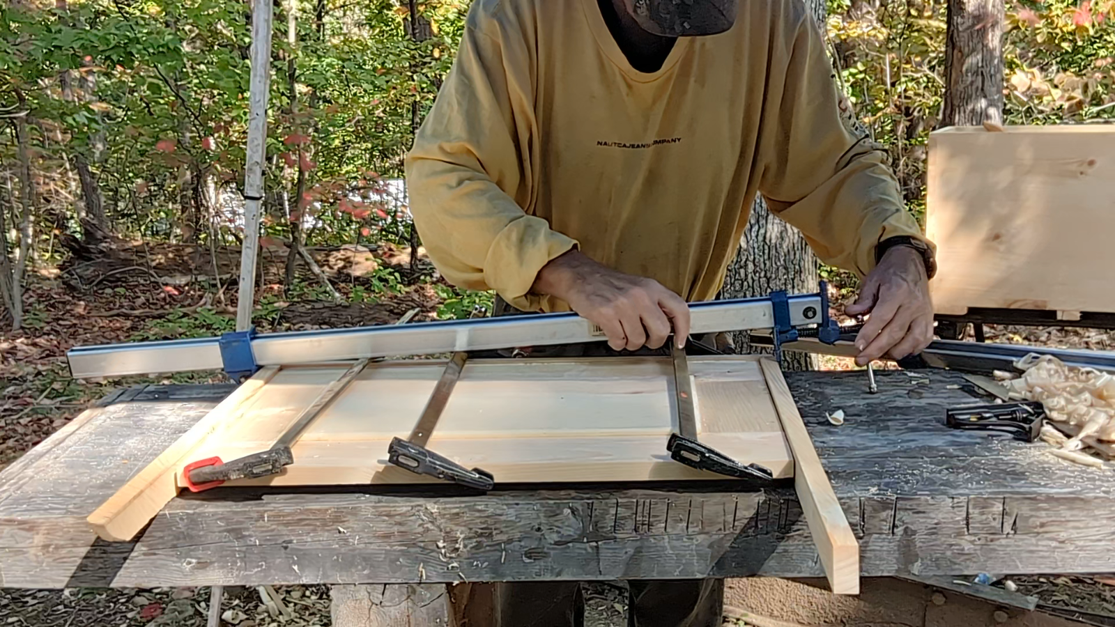

The lid for this box has a piece of trim around it, that combined with a skirting that goes around the box forms what is called a dust seal. I needed to cut that out.
The saw I'm using is the first decent hand saw I bought, from a local flea market.
It's a Nicholson, and has the aluminum medallion and saw nuts, and most likely was sold in the 70s or 80s. It has as far as I'm aware, no collector value. So I shortened the plate so that I could fit it in this box.
It's 8 tpi and filed rip. I'd prefer to have both a rip and a crosscut hand/panel saw, but there is not room enough for both, and most of the time when I need a saw without a back it is for ripping operations. But I can do a passable job with it at crosscutting, if I am careful when I start and end the cut. At least for the day to day of breaking stock down to rough dimensions.
I dearly love my old Distton and EC Atkins saws, but having a saw that fits the box and is already at hand trumps having to carry one out separate from the toolbox itself. And I'm loath to shorten my vintage saws because they may hold historical value.
Any thoughts on this subject are greatly encouraged, and I may start another thread on the subject if needed.

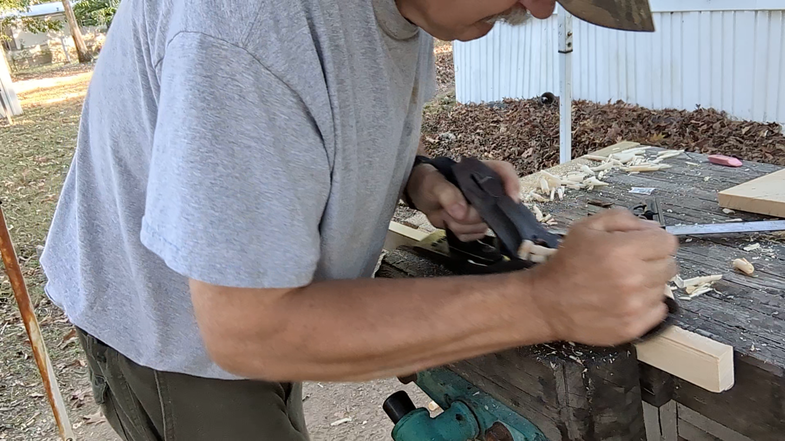

Once cut to length I needed to rip it to width.....liddustsealrip.png.dc0edbf110a005cefb2ccd4c71a094f9.png

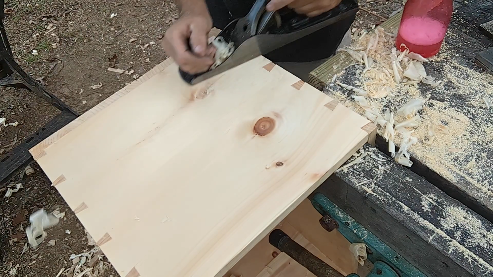

....and then plane in straight and square, and to final width.
Here I'm testing the fit of the single dovetail that will hold it together.
I think it turned out nicely.
Before I glue it in place I needed to bevel the center panel of the top.

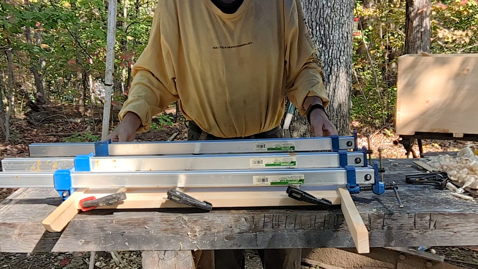

Then on to the glue up.....
...and clamp 'er up.

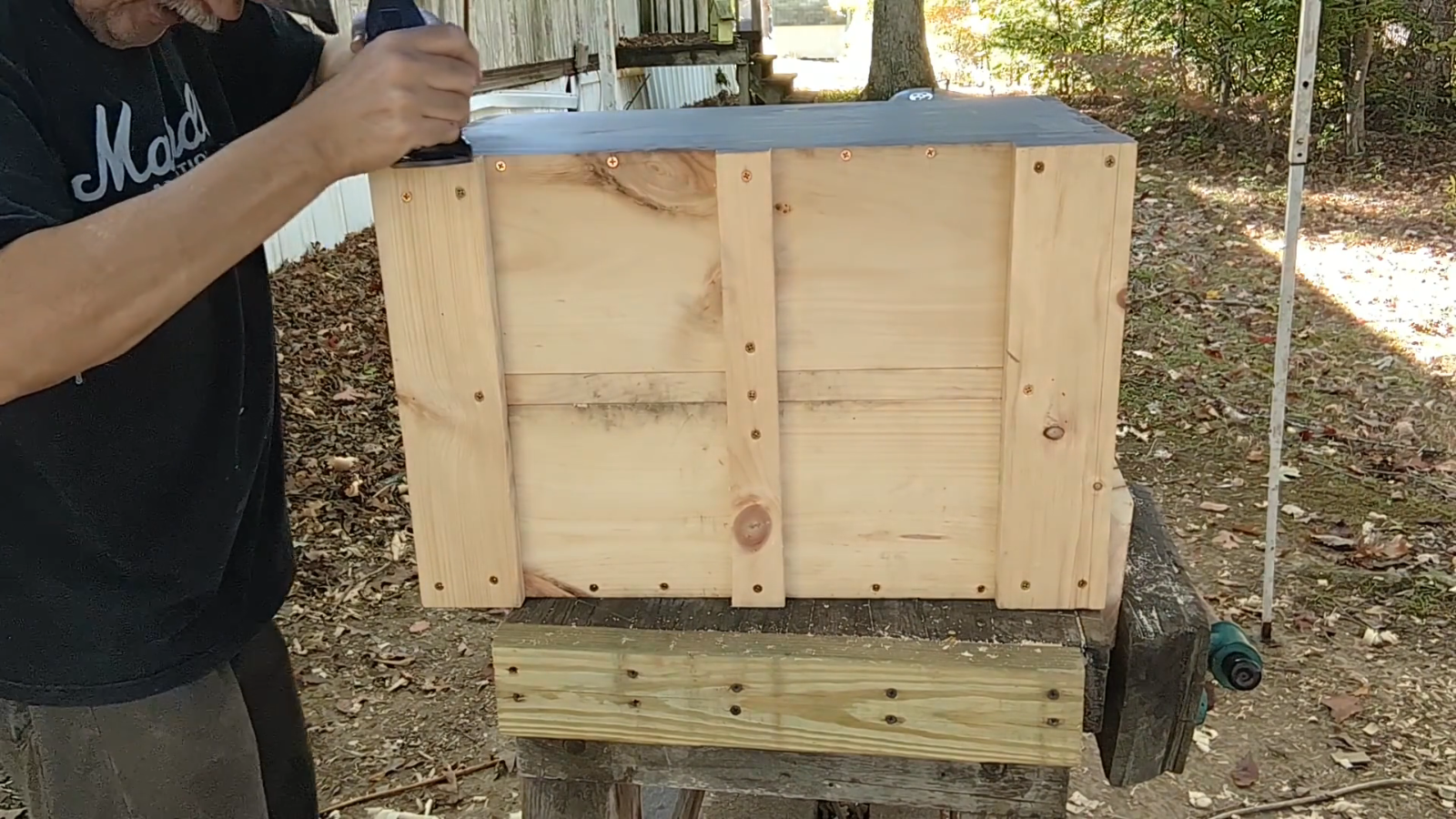

I attached the battens to the bottom in preparation for installing the skirting.
I went with three of them because I wanted one in the middle to help to support the three piece bottom.

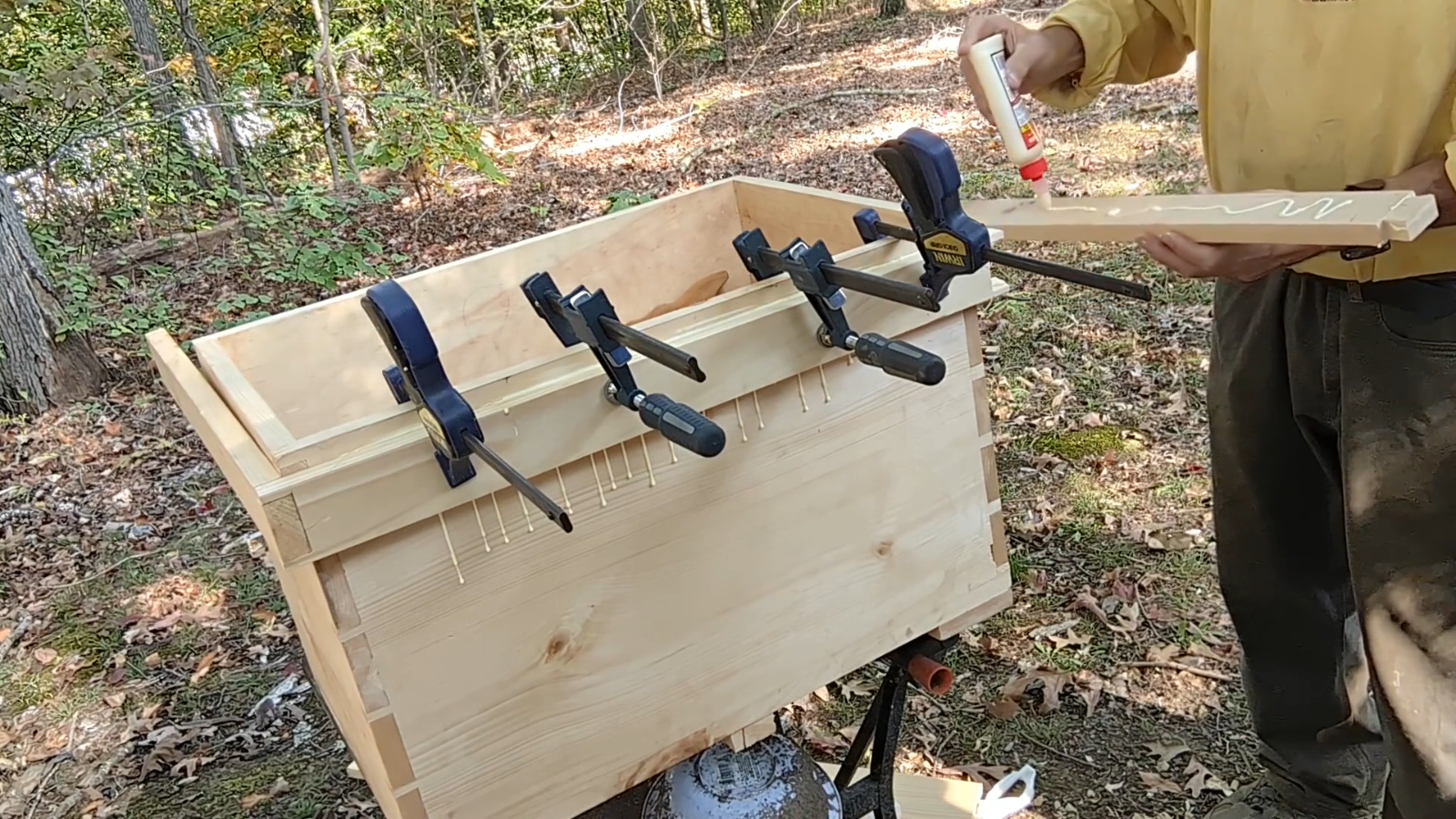

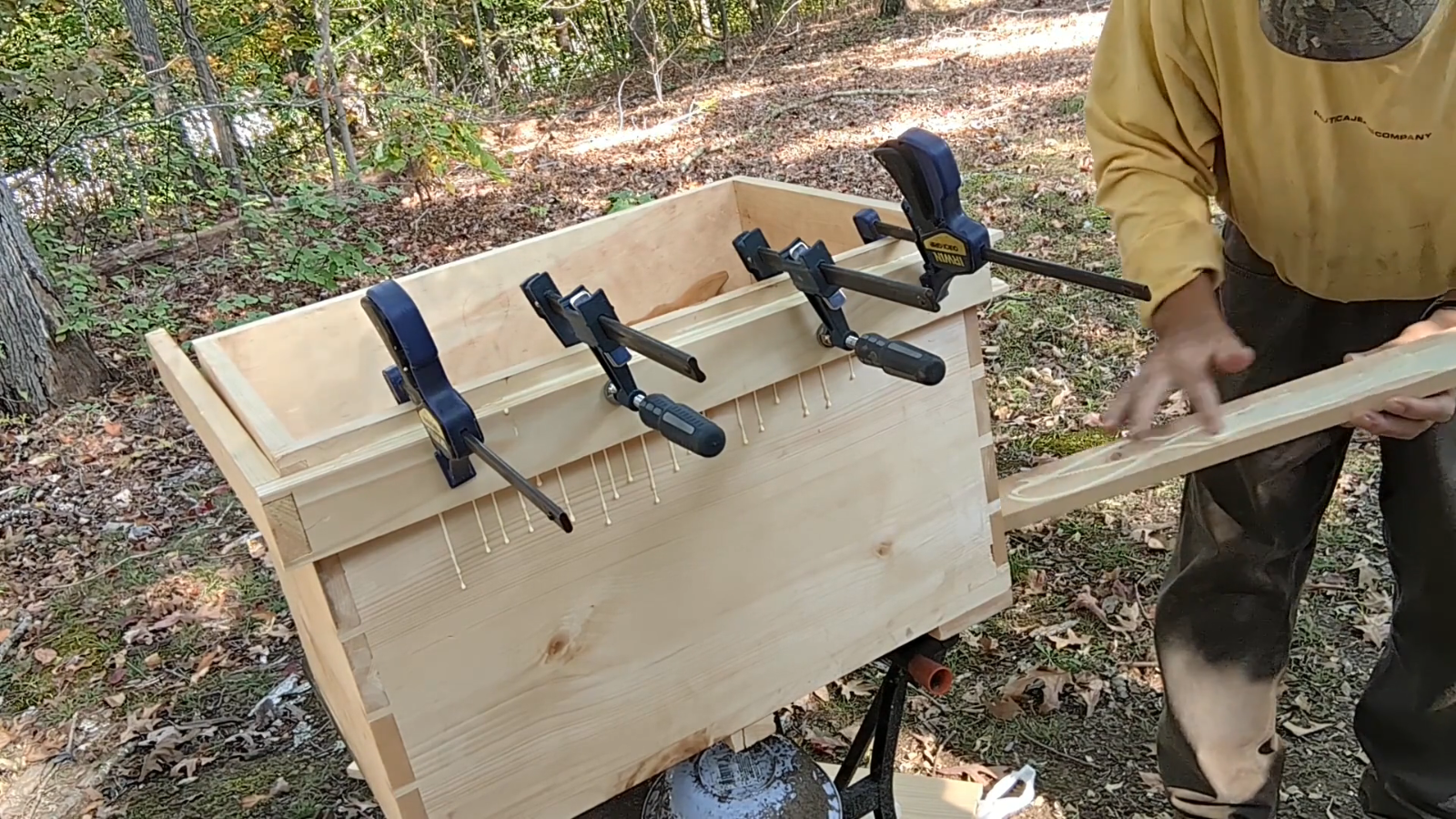

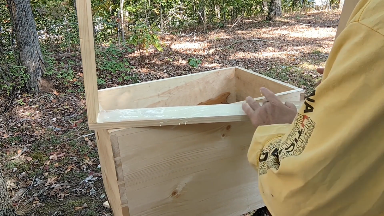

Then it was on to gluing up the skirting that goes around the top of the chest underneath the lid.
Squirt on some glue....
And use the best glue spreader, the one the Master created.
Clamp the front piece.

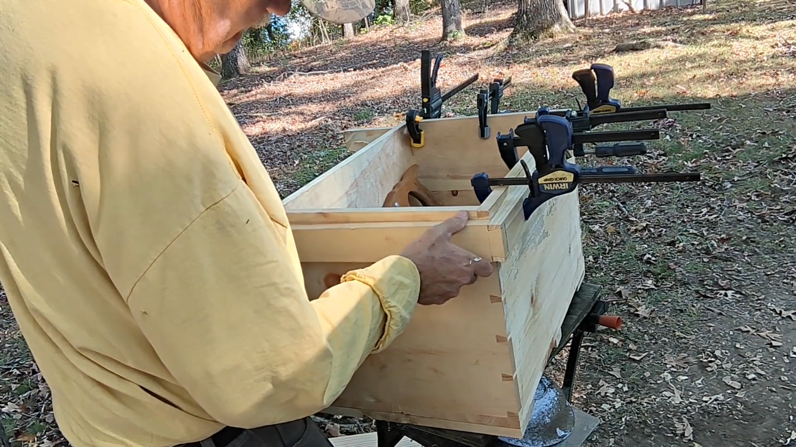

I then carefully removed each side piece. Did not want to break a dovetail pin at this point.

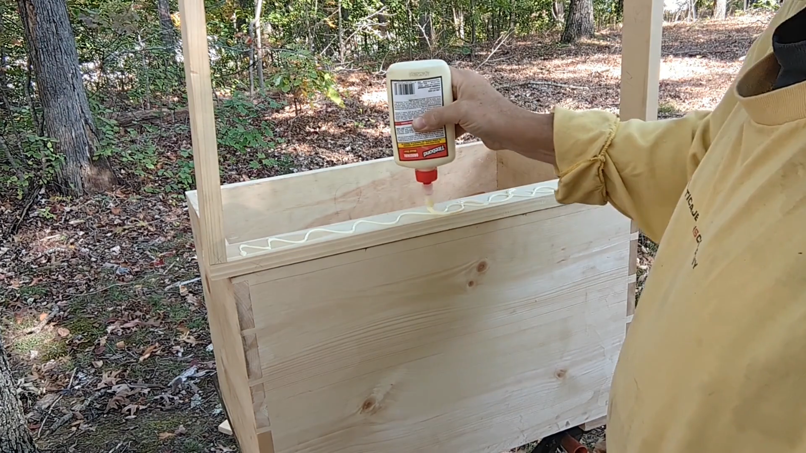

I put some glue on the dovetail joint first....
...then to the side piece......
Tapped it on home...carefully....
The same process was repeated on the other side....

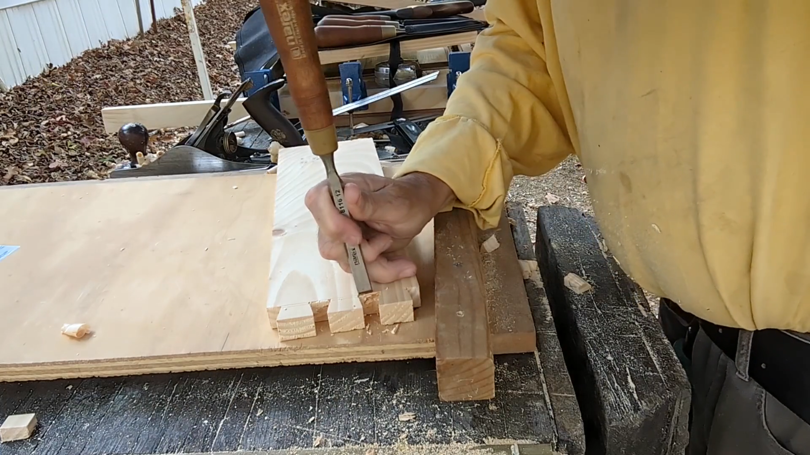

Then, after cutting out and sizing the bottom skirting, I cut the Dovetails for it....
And, finally, glued and clamped that up in the same manner.
