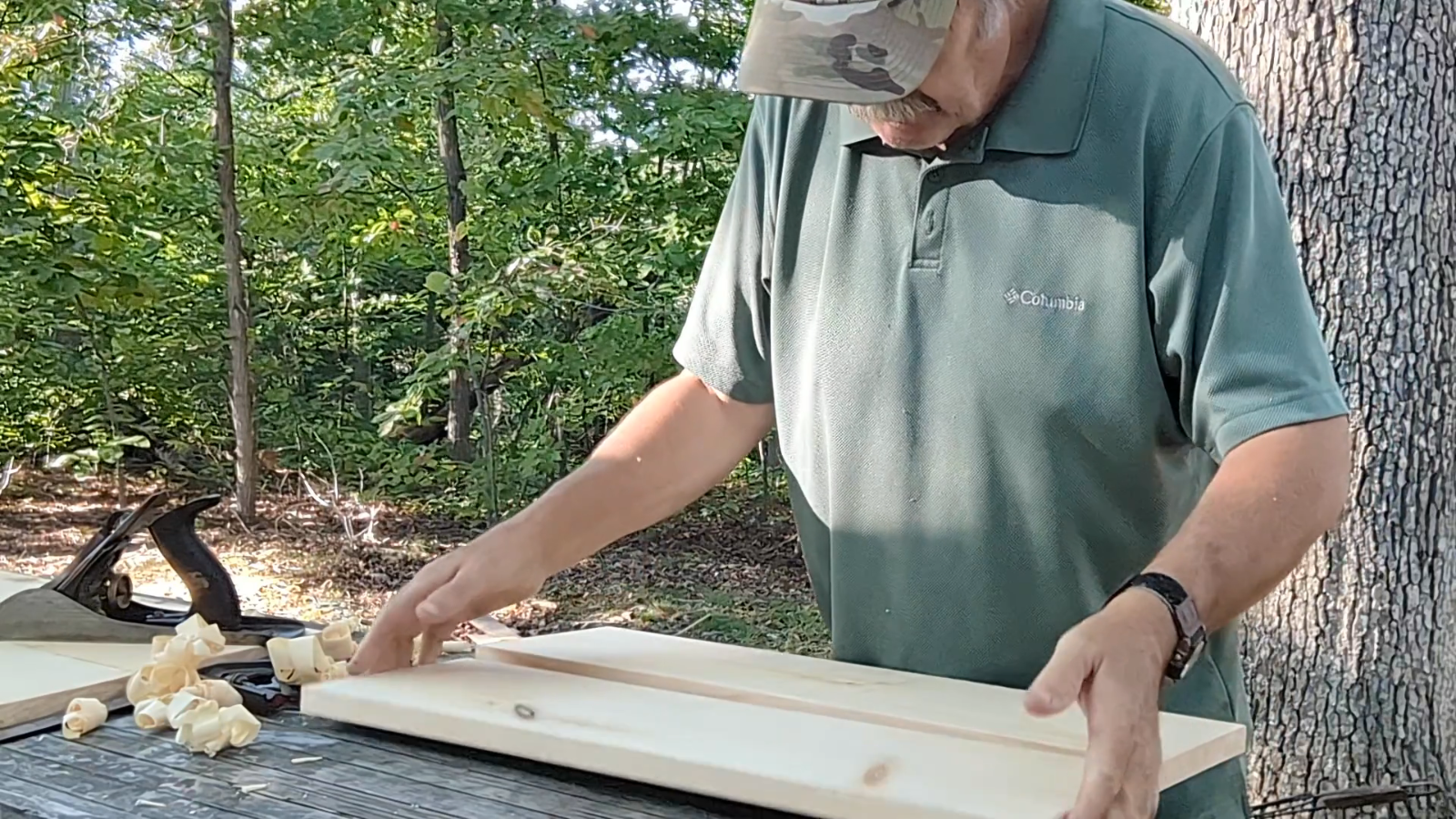

I start with the front panel, which I'll glue up from 1x8 pine.
So, put them togethe and pop them in the vise.
Then they get the plane.

    Checking for square     Eyeing the joint.
Slather on the glue....
And clamp 'er up, using the plane shavings for glue cleanup at the joint. At least on the side i can access.

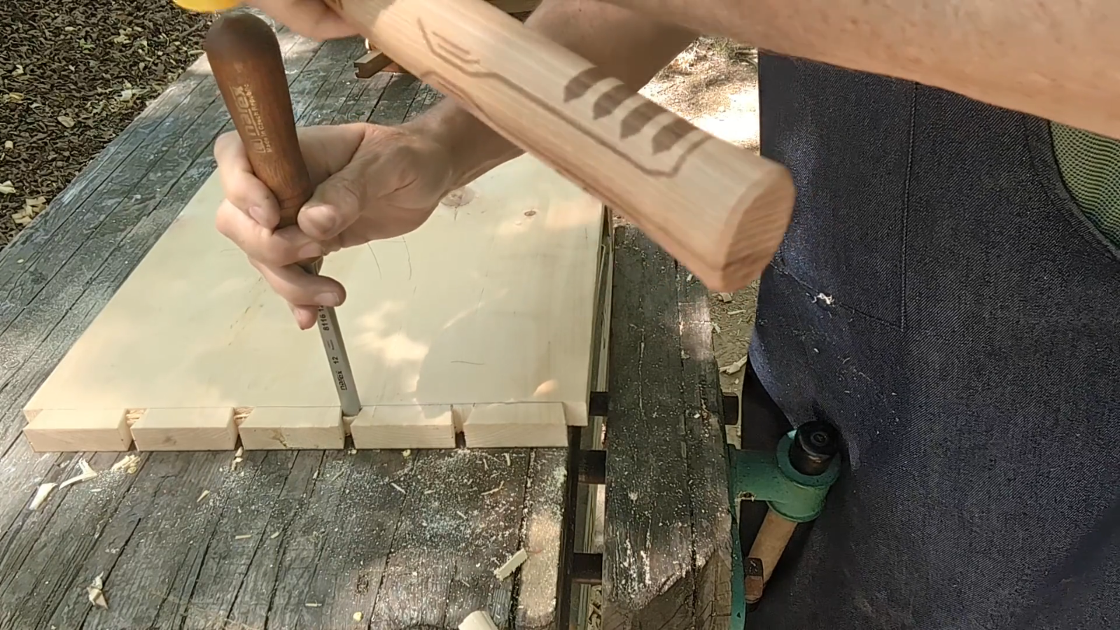

Once all the parts are out of clamps, it's time to begin the dovetails.
Start with evenly spacing them out with dividers.
I don't use a dovetail marker, nor do I worry about what pitch they are. I just lay my sliding bevel on the wood and move it until I like how it looks, then mark them.
Then saw them out......Shotcut_00_13_02_202.png.ad5f263fa9b7b4e711108518da029ef0.png
And chop out the waste.
After that is done, i mark for the pins....Shotcut_00_33_06_907.png.1cef6dd6c16dea4f7ec0155fa90f8a46.png
....and cut those.
Remove anything i don't want...
....and test the fit.
Tap them home......
