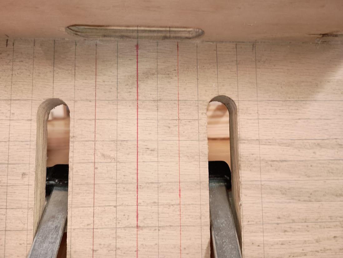

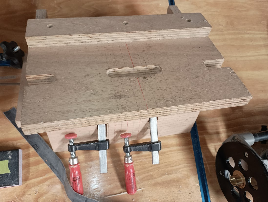

Well, I volunteered to do a "methods of work" at the September club meeting.
I dug out a jig that I made many years ago.  I basically put a fence on a piece of plywood and routed end sections and a center slot with a 3/4" router bit.  Then I aligned the base plate with the edge of those cuts and beefed it up.  I used the edge of the router against that fence as a guide.
Then I decided to make a new one similar to Stumpy Nubs, 3x3 Tamar, and Taylor tools.  It uses a router guide bearing (I chose 3/4") in a slot.   It will center the cut on a 3'4" piece of stock rather than be adjustable, that is OK with me.  If I need to make a less long slot, I saved some of the insert cutoffs and can throw one in the slot and recenter it.  Also uses MatchFit clamps, but I wish I'd added a third dovetail slot vertically in the middle.  The only hard part was getting a really good fit on the spacer blocks, took 3x as my calipers were going fuzzy (Can I blame it on that???)
image.png.dcfcbdf585cd760218faf382a756aa42.pngimage.png.8f9251ea6c56720f61c493b41905e37c.png
Test run:
You can buy a bag of loose tenon$ or just make your own to fit using a planer.
