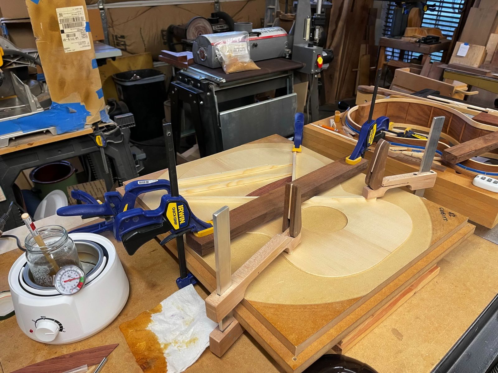

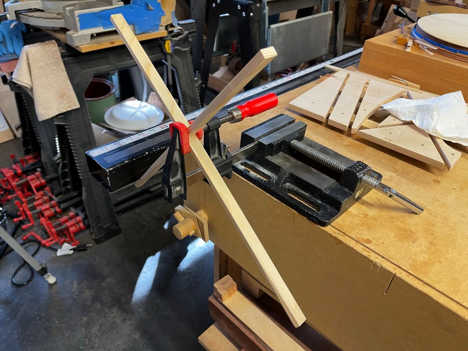

Made a little progress on the guitar build and got the X-brace glued, ready to sand the 28' radius on the bottom of the braces.
I gotta' admit David, I don't grasp the intricacies of the cross brace fitment as it relates to sound but really enjoyed the video; well except when the bit hit the pattern hold down screw:BugEyeSmiley:. Also will admit ya' scared me some with the last pass on the jointer:CoveringEyes:, but all turned out OK so on with the show. Looking forward to the next video. Fun to watch a real craftsman at work. Thanks!

Thanks, Dave!  If the joint on the X brace isn't a good, tight fit then you're relying on glue to handle vibrations and sound conductance.  Wood to wood is far, far better at this than glue.  Yes, the jointer part wasn't the smartest thing I've done in the shop but, sad to say, it isn't the dumbest, either. :o

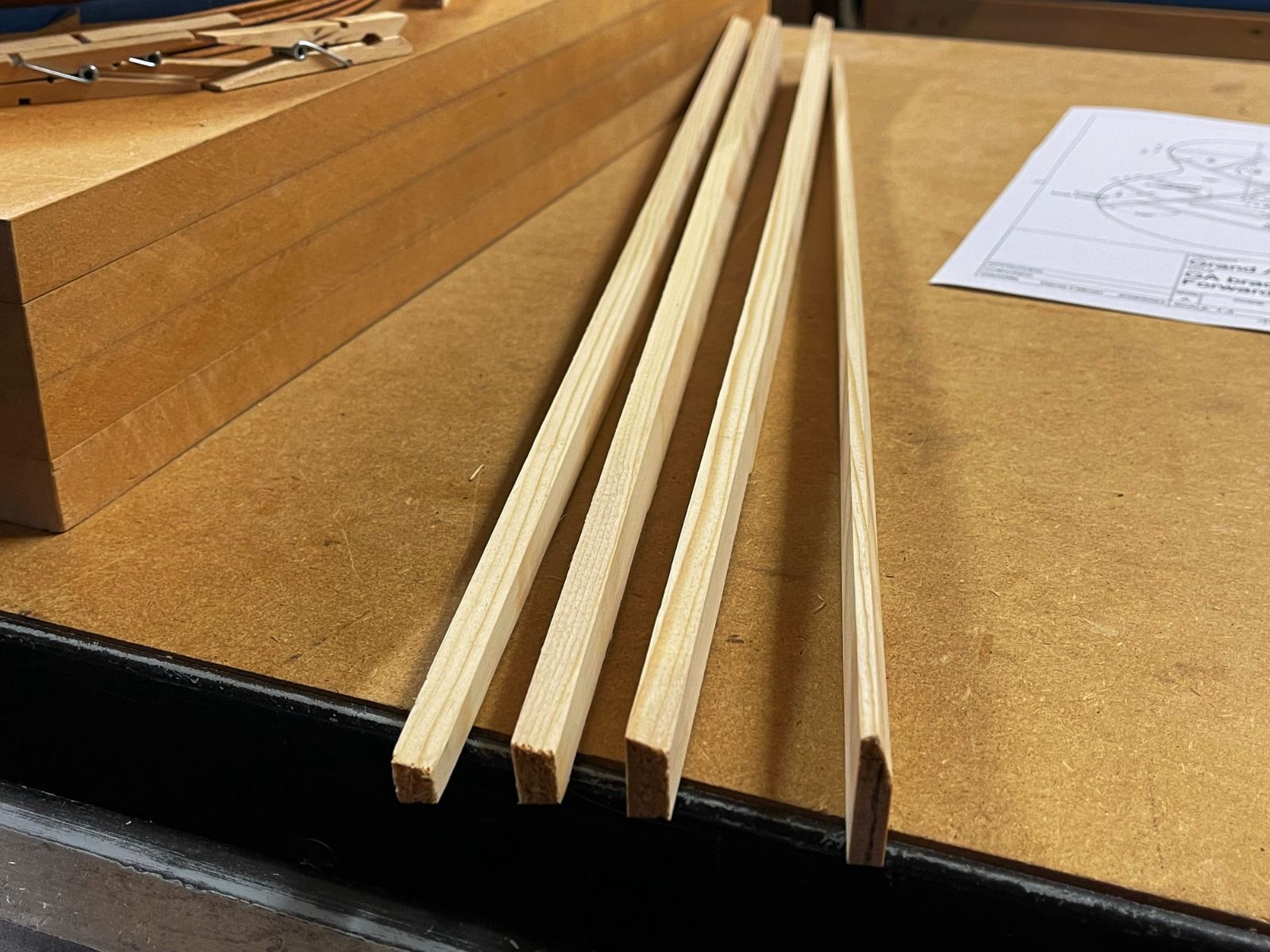

Finished the next step and began another, so here's an update -
Glued these 80 grit pieces to the 28' radius dish -

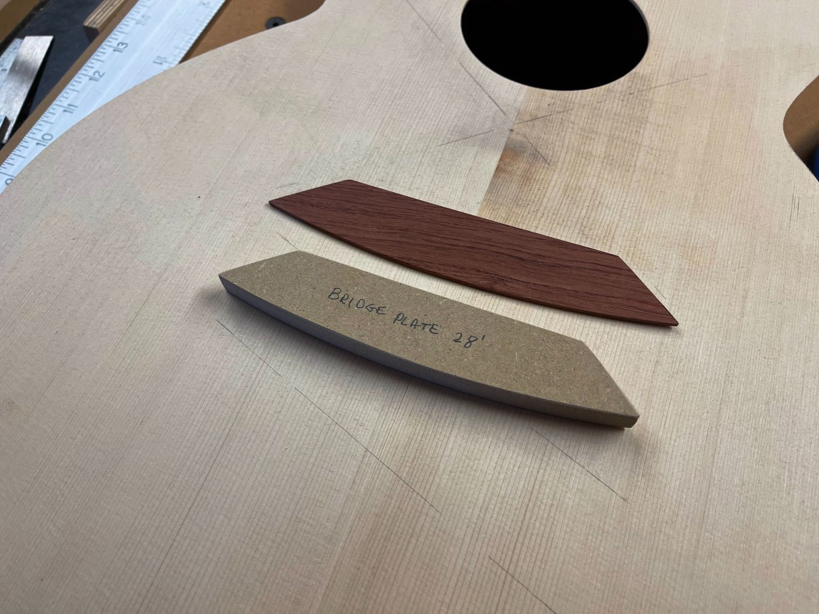

Cut the Bubinga bridge plate and an MDF caul to hold it down for gluing -

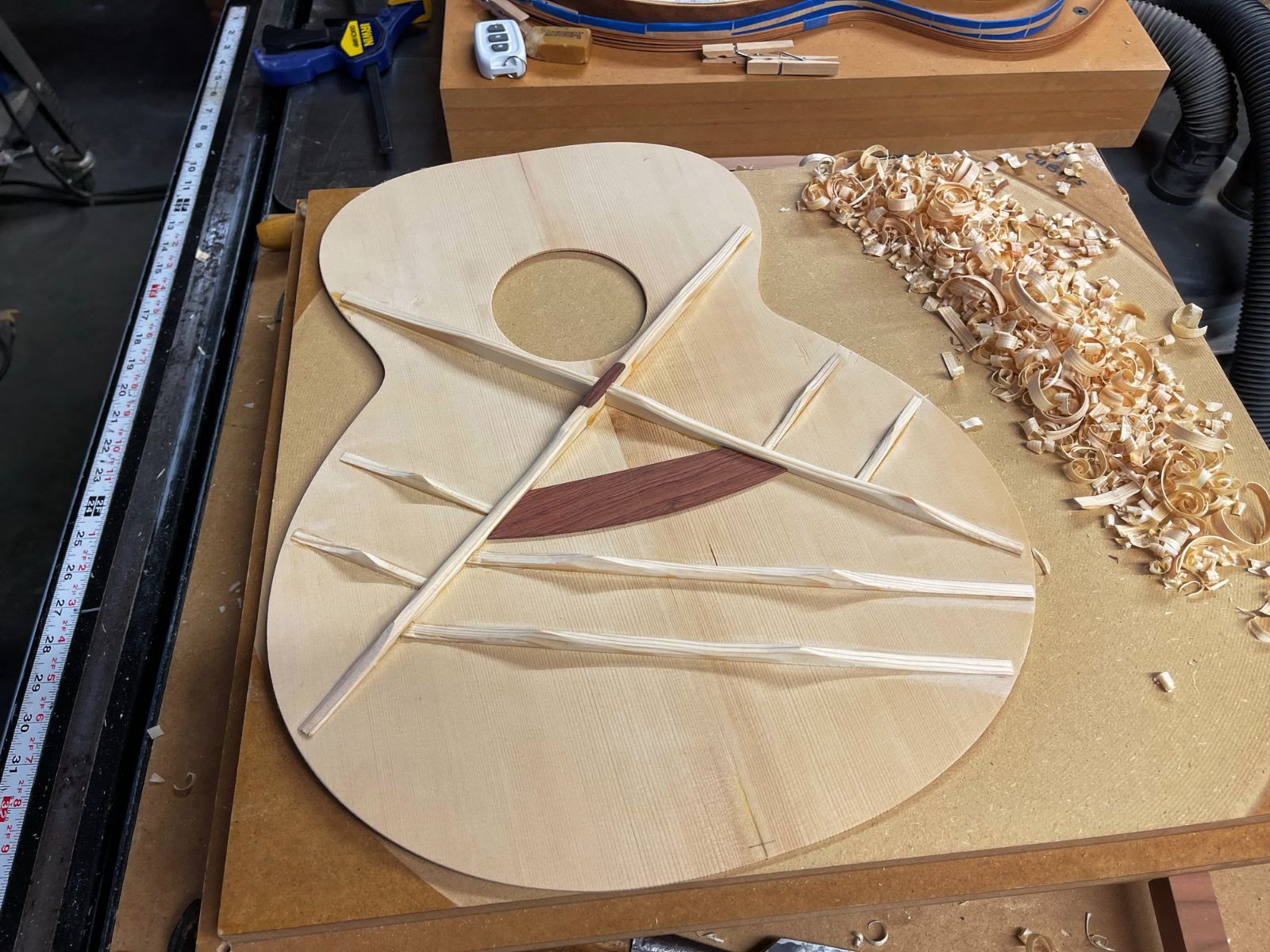

Did some carving on the braces, got a new chisel, and on to the next step!
Another awesome episode David.:Praise: I'm mesmerized as i follow along. Pardon me in advance for my ignorance but so many questions...had to pause the video so I wouldn't forget to ask. BTW, it wasn't too long IMO; left me hanging for the next one:P
  1. What is the purpose of carving down the top (soundboard?) braces? Acoustics/ tone/ resonance quality?
  2. Why the ridge crowns? Why 2 on the longer braces?
  3. Do you have a certain dimension you're trying to attain, eg a template or is is just by feel and/or sight?
  4. Purpose of the "patch" on the cross brace? Reasons you chose a different species?
  5. Manufacturer, model, ~age of the old chisel you first used. Love seeing it in use.
  6. Finally, has the whole project been about having an excuse to buy that new chisel.:lol:
Oh, one final question. The guitar background music (Mason Williams, Classical GasI think?). Is that you playing?

1.  Scalloped bracing or carving and voicing the top is more responsive, easier to get sound out of the guitar.  Guitars with straight bracing means the top is heavier, stiffer, and requires a bit more effort to get sound out of the guitar.  Straight bracing is ideal for Bluegrass or other styles of music where you'll want to 'dig in' and really attack the strings.  Scalloped bracing is a lighter top and well suited for someone who does light finger picking or strumming.
2.  Tradition more than anything, really.  That's the way the golden era of Martin guitars was built so it's copied often; it works. Many builders experiment with this but most use it because it worked for Martin.
3.  I drew the bracing pattern and played with it until I was comfortable but it closely resembles Martin, like most do.  For the final shape I tap the top and listen to the sound and from that point it's by feel.
4.  The cap on the X-brace joint is more personal preference than anything else.  I used Padauk on my first guitar but since I'm using Bubinga on the bridge plate I decided to use Bubinga on the other pieces inside the guitar that aren't Spruce.
5.  The old chisel belonged to my Dad, no idea as to the origin.  He never got it this sharp but it's not an expensive chisel; it just feels good and holds an edge really good.  The new chisel is by Two Cherries and it's a delight to use.
6.  Any project that requires the purchase of a new tool is a good project! LOL! :D
Yes, that's me playing the first guitar.  The first little bit is just noodling around in G and C and then segues into Classical Gas.
