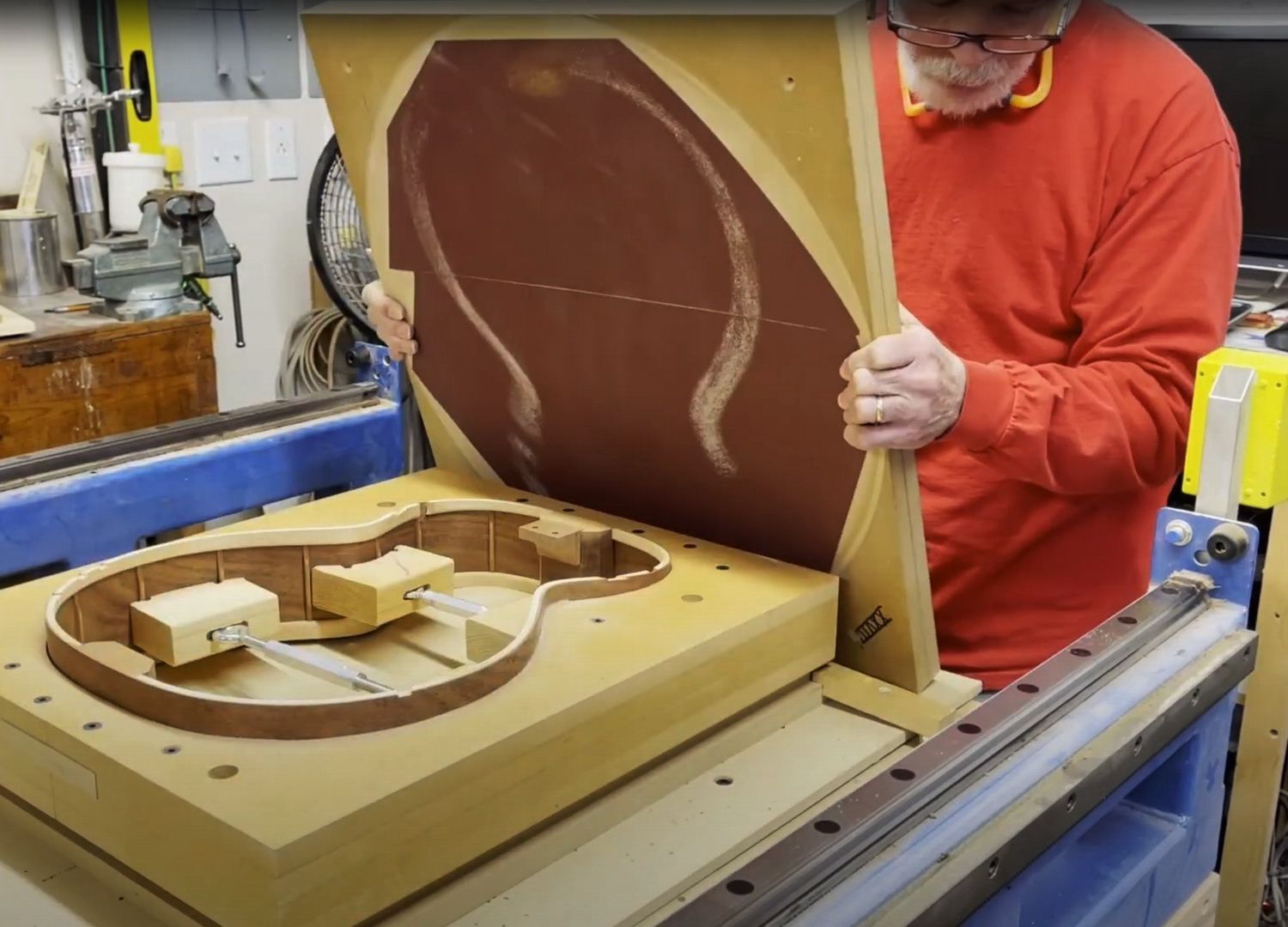

Now that I have the CNC I would like to use it for a few more tasks in the building of #2 so the first thing I did was to take photos of the body rim and draw that as closely as possible in my CAD program.  The short video below is using a Sharpie to draw that outline so I could see how close my digital drawing came to the hand shaped rims - pretty close as it turns out.

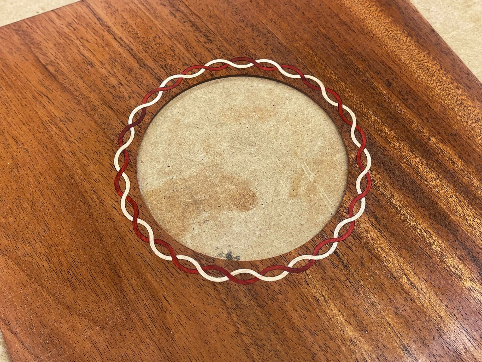

Rosette inlay test on Honduras Mahogany.  This is sort of a twisted vine that I drew and decided to use on the guitar but I wanted to test it first.  The Mahogany was already cut and the proper thickness for a guitar top (sort of, it is 0.080" thick).  The inlay pieces are Maple and Redheart.  There's a short video below showing the steps I used to make the inlay.

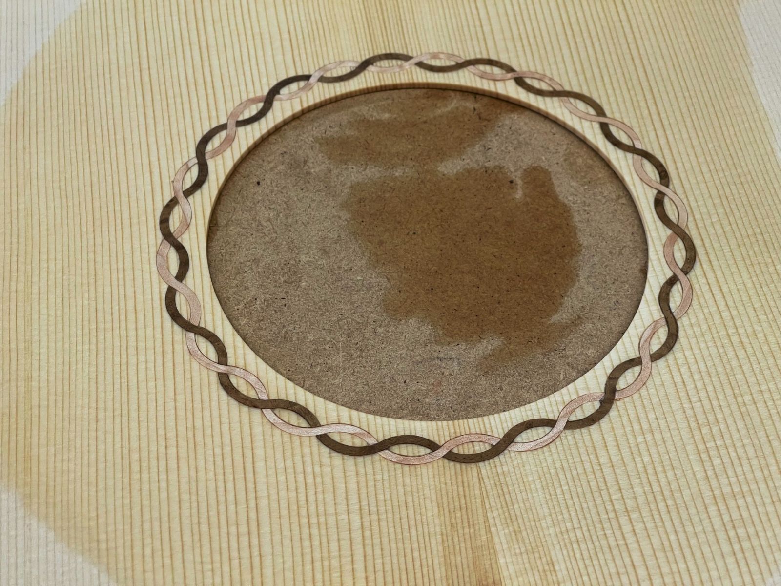

Rosette inlay completed but not yet glued or sanded flush -
Fancy. Will look fantastic once the opening is cut and eventually the finish. Enjoying the build sequence.
Thanks, Dave!  I'll probably cut the soundhole and outer profile tomorrow.

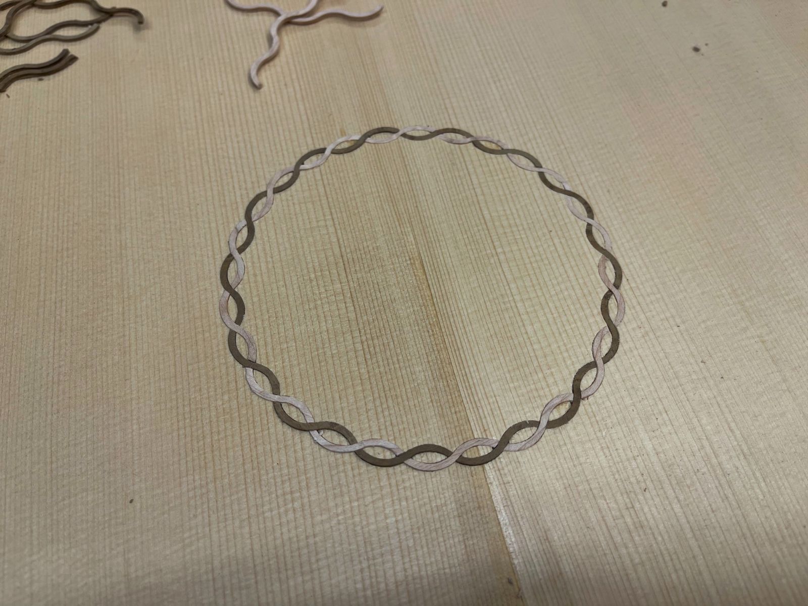

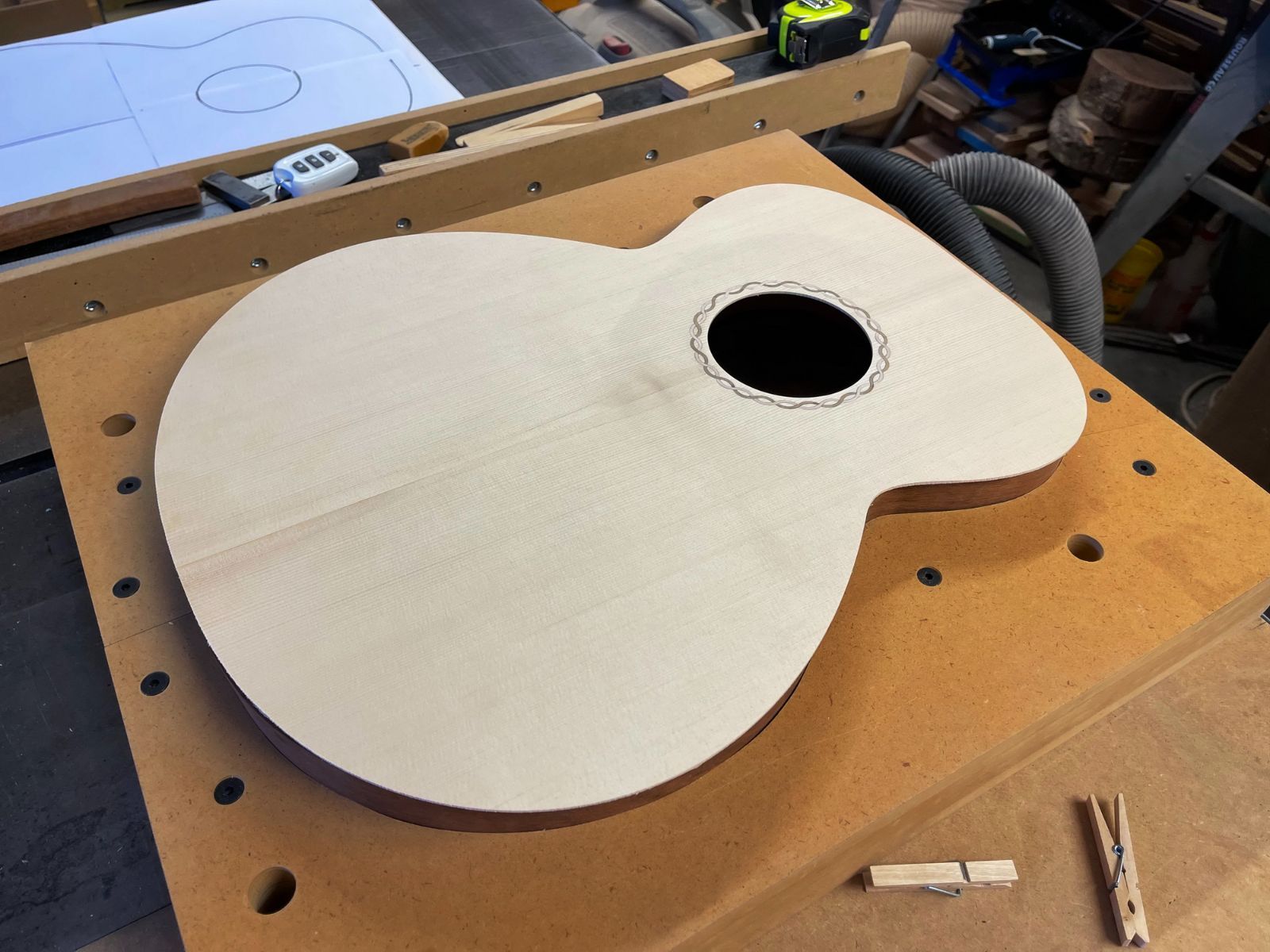

The rosette is completed and the top rough cut to shape (actual shape plus 3/16" all the way around).  No finish yet but a little Naphtha on the rosette close-up.  Not perfect but I'll take it.
