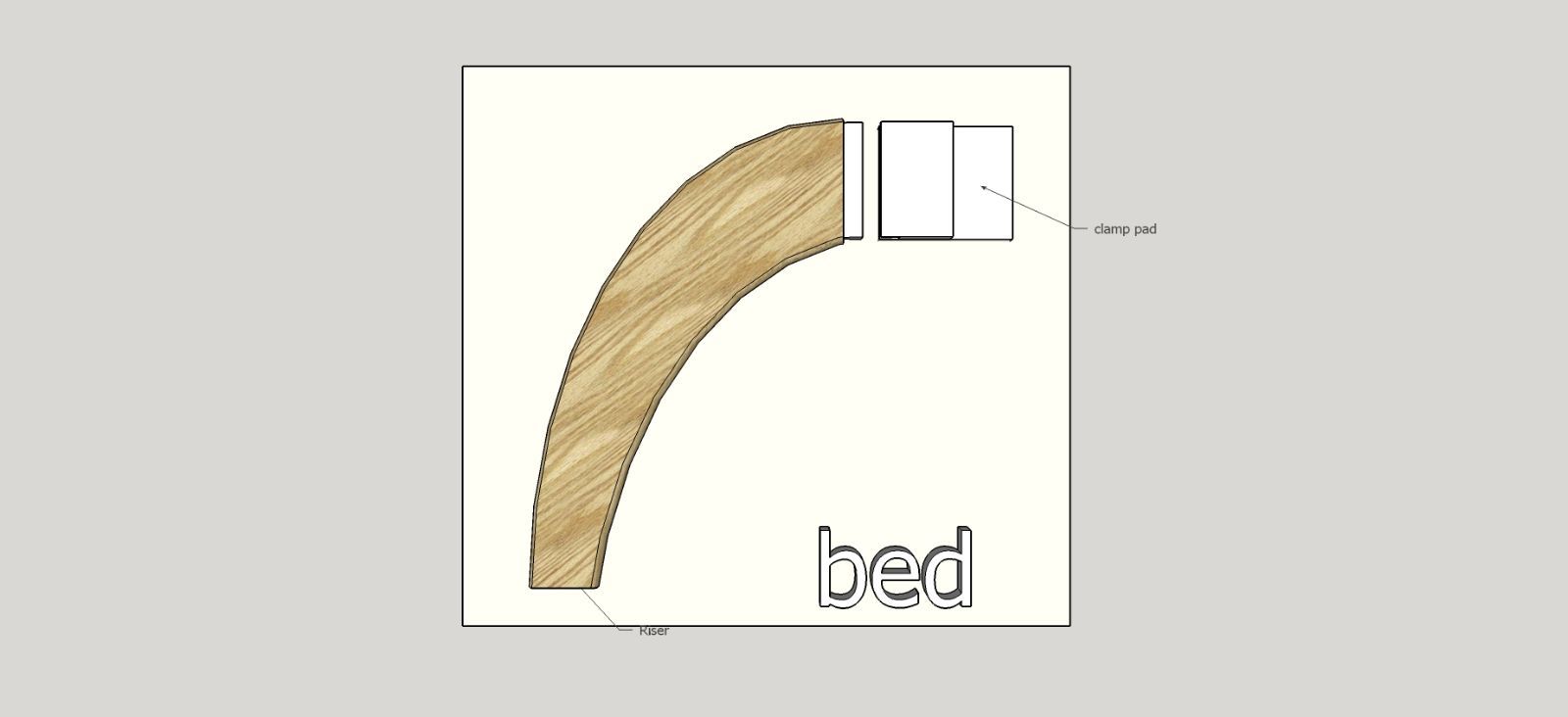

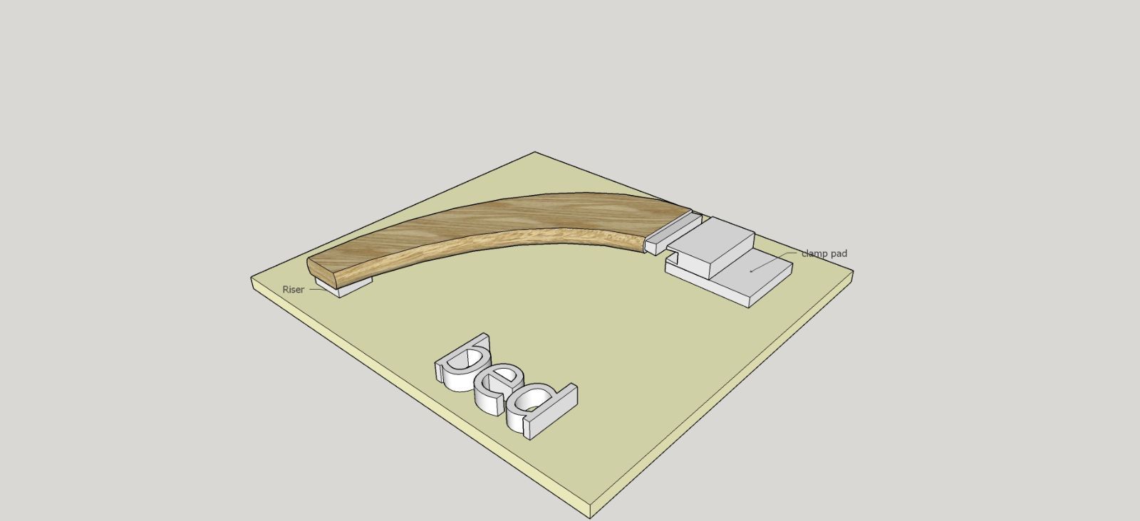

From the first picture on your link, it looks like you had made a temporary bed. Could that be a starting place for holding the work? Are you thinking of cutting all 3 legs from the same board from one setup?
I haven't found wood for new legs yet, so that is still up in the air. The jig you saw in my blog was one I made to cut parts for a student project from glued up laminated hardwood curves.  Those parts were also a challenge to cut out as if I remember right I only had one reference edge to work against and had to cut around the other 3 sides. The curves she had provided were a mess and needed considerable work before I could even clamp them in the jig.  No CNC work was cut on the top surface though.
I would make a fixture if I was cutting the legs one at a time.  I'd still have to deal with holding the work in place while it was being cut in the fixture.  Can't clamp against any edge except the dovetail end.
4D

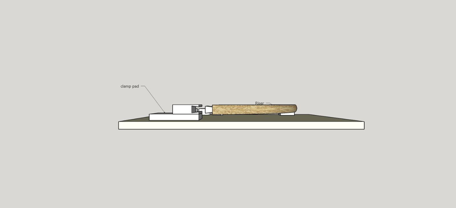

If you made a clamping device that had a dovetail to match that of the leg, with a snug fit, Then mounted it on bed like shown in your blog. Using a small riser to support the free end. Riser could be blue tape/ca glue held to the bed.
You're getting pretty good with Sketchup Lew!   With only the dovetail end trapped (and you would need a way to clamp/lock it in the slot) there is still potential for vibration/movement of the part while being cut. CNC movement is sneaky strong and if it can find a weakness in how a part is clamped down it will.  The dovetail end would also be the last part I cut. Jigging up to cut it is easy with an otherwise finished part.  Same as I did with the initial legs.

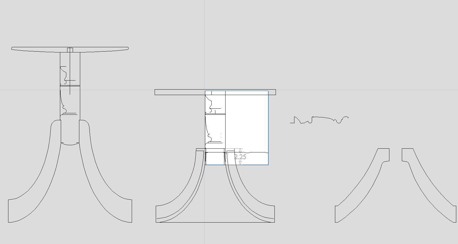

I've been sketching variations of how the legs look as part of the overall composition.  Something about the elliptical arc looks odd to me when viewed in context.  A fat skirt sense.  Flipping the arc over actually looks better, or at least refreshingly different in context. It also presents options for making the roundover edge use the same center point as the post it attaches to. An arc that drops down then sweeps out rather than sweeps out then drops down.

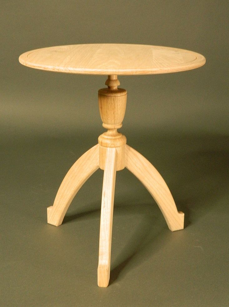

3/16" roundover bit came today.,  Ran it around the round table top, and also the edges of the original legs. Now that those legs have been softened aesthetically I think they'll do just fine. Not too fancy to compete with the post, yet more interesting than straight legs or even straight tapered legs. With the round top also paying respect to the post a nice balance seems to have been found.
I like cherry stain on red oak, and may have some if it hasn't gone bad.
The nonagon (9 corners) top deserves a post with related detail.  Did a google image search for pedestal tables and found one with a 9-sided top even fancier than mine, and the post beneath had a tapered section with 9 fluted grooves around it that made perfect sense in that composition.  The legs were also a fancier shape with more detail that also related well to the post and top.

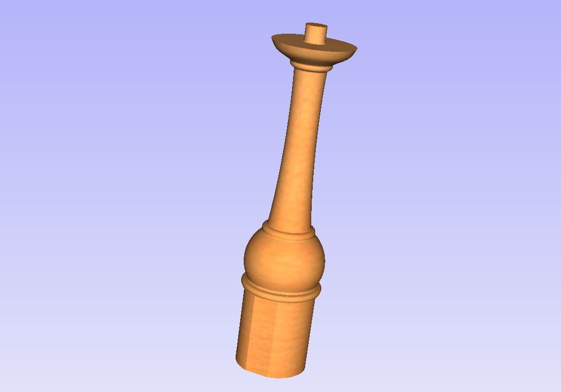

Playing around with my CNC software this is what I'm considering to do with the taller red oak pedestal table. The upper slim section though I'm trying to figure out how to facet it in 9 faces.  More of a French style.  May have to do some indexed X/Y/Z moulding cuts rather than try and do that with the wrapping A/Y/Z cuts.
