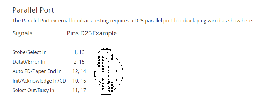

I'm at the point now where what I have should work.  I suspect the parallel cable may be flawed. Next time I feel like sleuthing again I'll take the cable off my Probotix CNC and try it.  If that doesn't make a difference then the USB to parallel adapter moves higher on the "might be damaged" list.   If I knew better how Mach3 installs, such as does it checks for a parallel port or just assume one will be there, then the sequence order of installing drivers may make a difference.
Device manager never shows an LPT1 port even after the driver for the USB to parallel adapter is installed.  Mach3 shouldn't be looking there as a path to the controller,  but under ports in Mach3 there are only two LPT port addresses too choose from.
If you have an old parallel cable laying around, you could make a loopback plug to test the USB to Parallel adapter-
2023-03-1413_06_41-SerialandParallelPortExternalLoopbackWiringDiagrams.png.a375113342b6e8e2c396541230729715.png
Dug out my old multimeter and put new batteries in it.  Checked every lead in the parallel cable for continuity between the ends.  No flaws detected nor any crossed wires.  That gives it a passing grade.  I'm now suspicious of the adapter.  Where I bought it from warns there are counterfeit copies out there that won't work.  The source I bought it from though was one of two sites the mill manufacturer recommended.  The other end of the cable plugs into the controller box.  That jack might also be flawed, meaning it'll go back to the manufacturer if true.   I'm not sure how to test it other than by elimination though.
