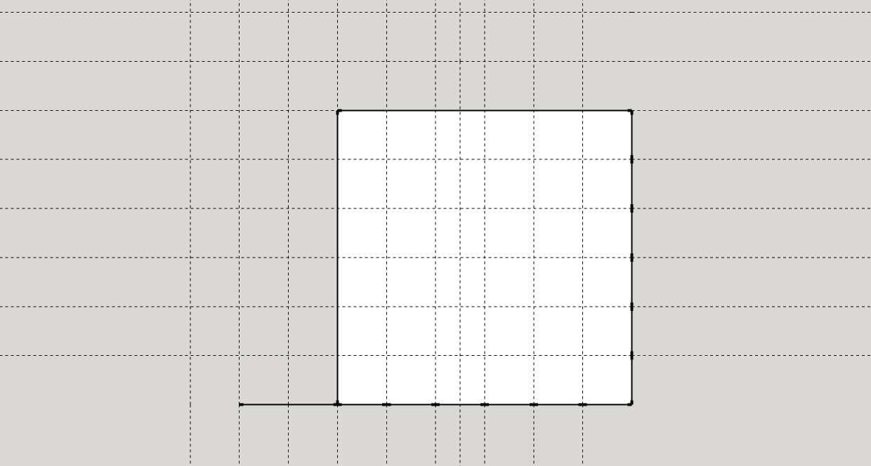

 No formula. Just played with Sketchup

Lew's solution called for 35 cuts to make 36 pieces 5/8" x 5/8".  Whew! :Hot:
After wrestling with notepaper for many minutes, I was no closer to an answer than a horse to pizza. Bending Lew's Sketchup, I see six pieces 3.75" [.625 x 6] long will form a square. And use ≤ 24" of linear plank .625" wide.

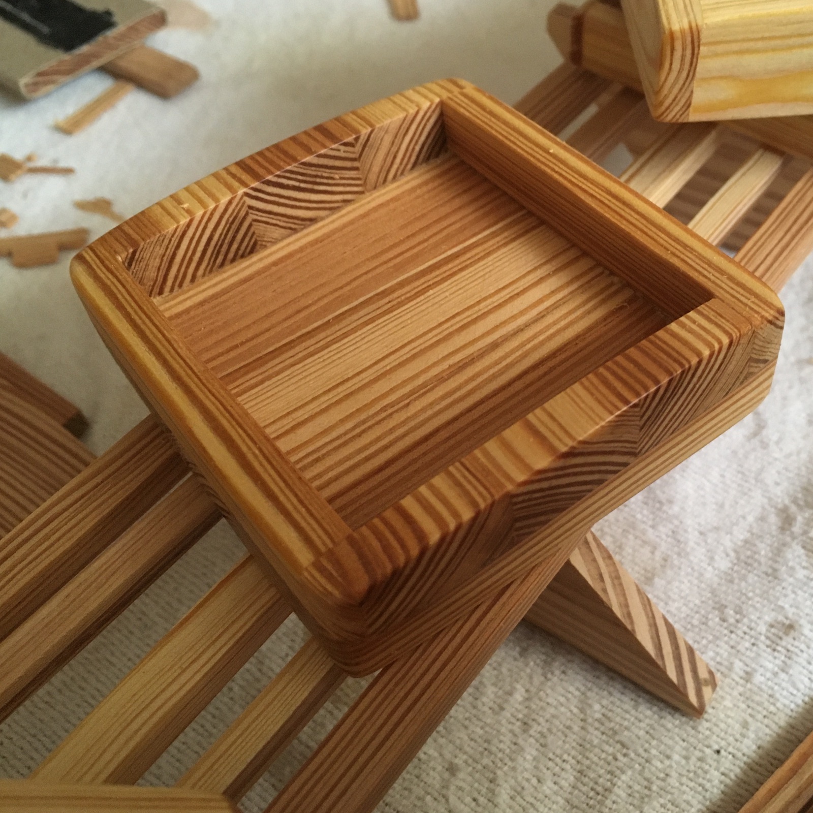

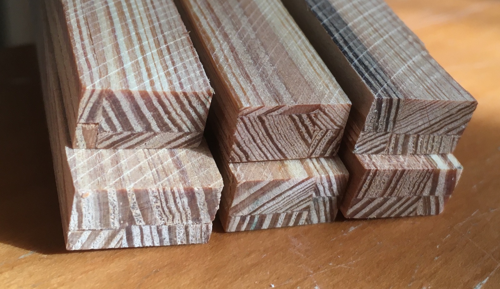

I'll have nice single slats, saved often from near the pith. They are sometimes the most amazing, the tightest growth. 30-40 RPI or higher. The thickness varies. The width varies. Rather than continue to use them as perimeter, I'm wanting to make base while the sun shines.

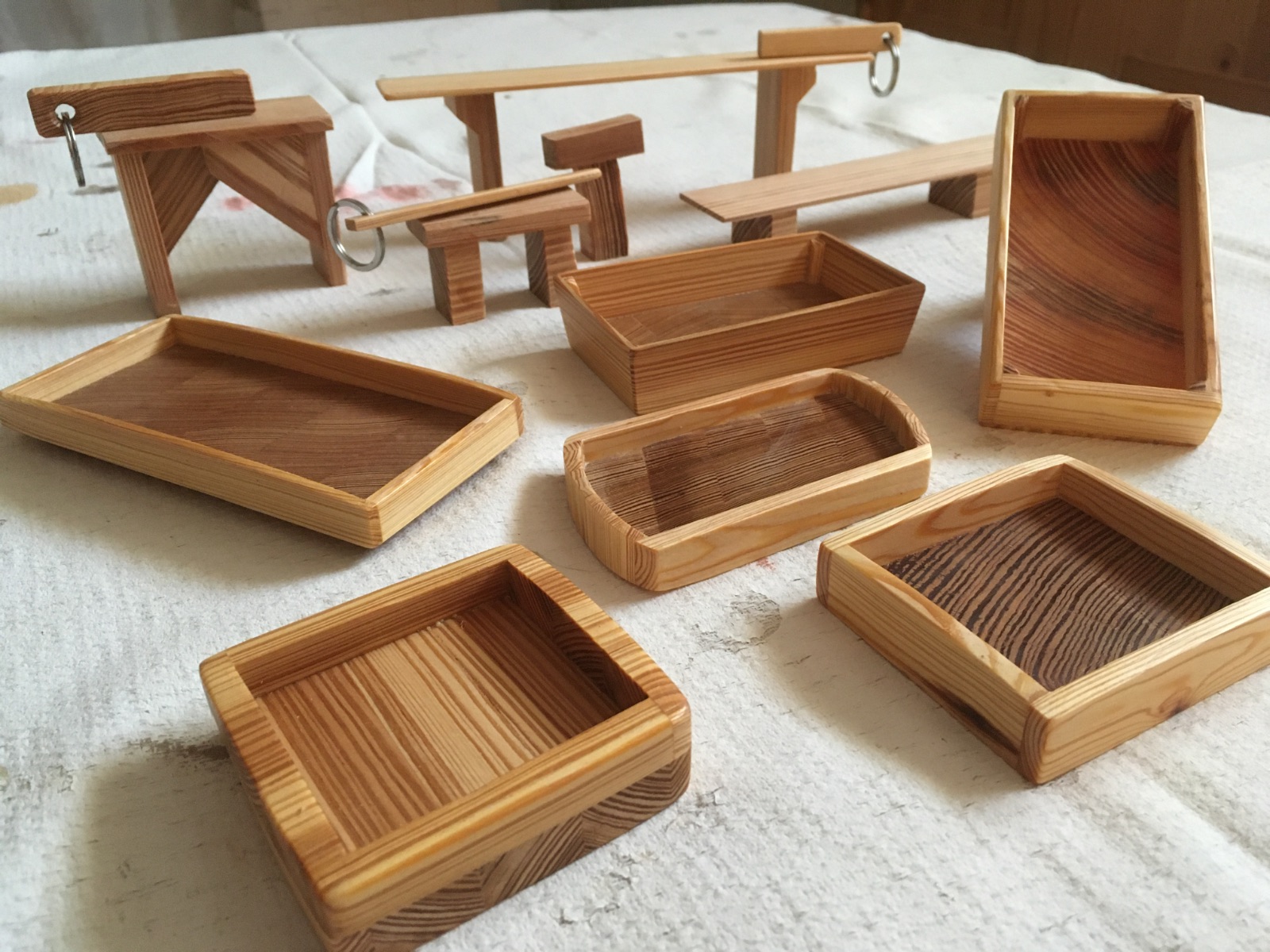

When dissecting an old beam, I end up with a lot of odd-shaped strips, slats, boards. Some of the most amazing grain, just not a whole lot of it. Keeping apples with apples, I want to begin making "single origin tray base blanks" with these single slats. At least cut up a dozen for future projects.
I've got two big projects in the 'works', half a dozen small projects cut and ready for fitting / gluing / finishing, one really big project in infancy (a portable cabana with door, made to assemble in a clever manner, pinned with 8-12 ebony violin pegs), and now want to cut up a few of these scrap strips for later assembly into squares.  The squares are for undetermined future projects.
Waste not, want not. I spent seven days and 20 hours taking the beam apart (three hours acquiring and moving the beam). From that latest beam I still have two choice 5 x 5 x 20 now awaiting a 12" sliding miter saw, and one 2.5 x 2.5 x 58 or so for a sun shutter [Panel No. 4]. The rest became my 10.8 pound camp shower enclosure frame, an 18 gallon Rubbermaid full of winter burning pleasure, and a lot of small milled wood for small handcrafted projects.

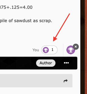

I'll experiment with the Method-DAB next week and report back (headed offline for a few days). Kudos is the preferred reward. But . . . A small block of longleaf pine also comes to mind [Small USPS Flat Rate Box]. Or a Medium USPS Flat Rate Box filled with whatever is on the shelf? Reclaimed longleaf pine, possibly reclaimed eastern white pine, something like that. Craft-worthy 'scrap'.
This is not, in this case, a 'thank you', although it can also very well be a thank you.
Woodman believes the emoticon labels should be removed.
It is (in this case) an award trophy for best, and, I believe, the right answer. :Praise:
