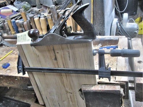

Bevels for a Monday?:WonderScratch:  Spent 45 minutes, then stopped for Lunch..:SaluteandRun:
One was fairly easy to do..:TwoThumbsUp:

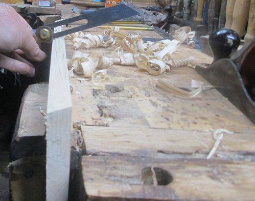

Just match the existing..so the lid will sit down flat...the other bevel for today..:WonderScratch:
Where the lid joins to the top...need to match that lower bevel...:ChinScratch:
Needed to use the tool well for something besides tools and shavings...:WonderScratch:

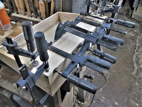

Kept checking the bevel...until it matched the bevel gauge..:ChinScratch:..had to joint the other edge straight, and remove a taper...THEN glue and clamps..:SaluteandRun:
Lots of clamps.:JawDrop:...let this sit a day...have done enough, for a Monday...best not to press me luck :DevilLaughing:

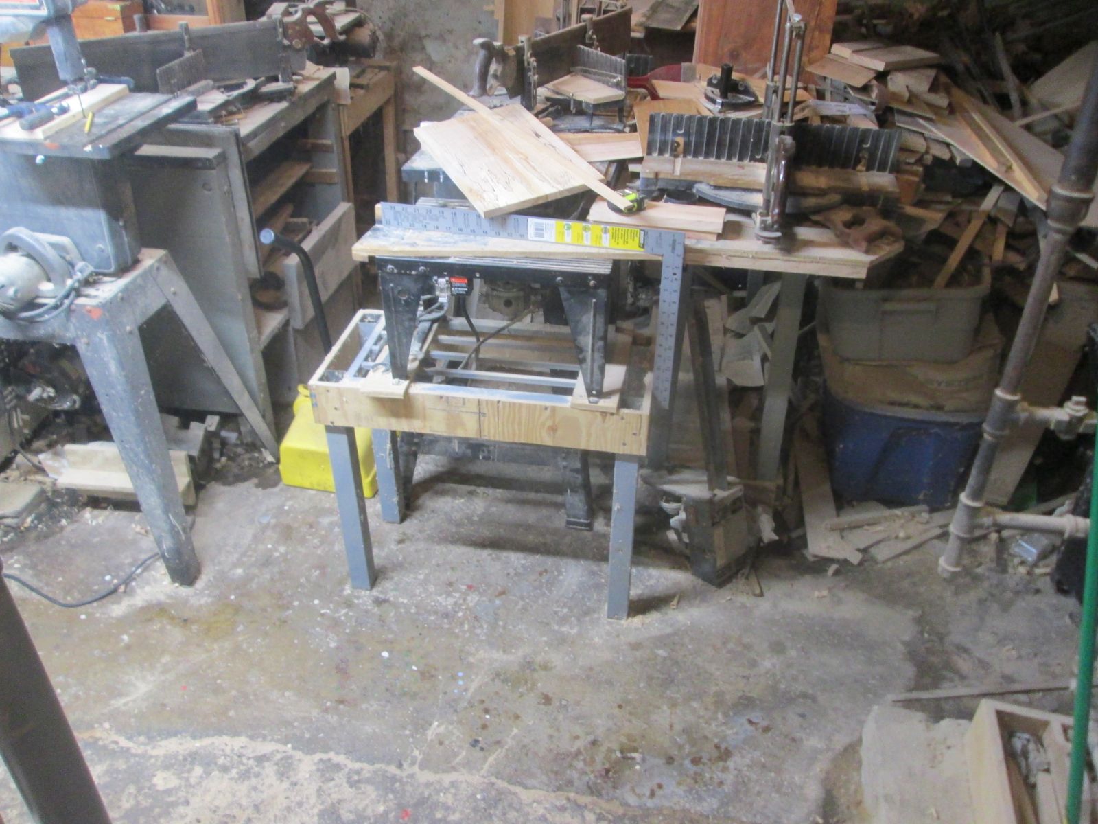

Need to dig the tablesaw back out...
It is in there...somewhere...
Out of one set of clamps.:OldManSmiley:

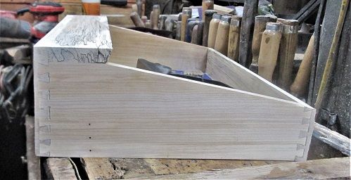

and get ready for the next set...needed 2 bevels made...this one for the top...:ChinScratch:
Easier to do it now, than after the top is glued into place..:OldManSmiley:

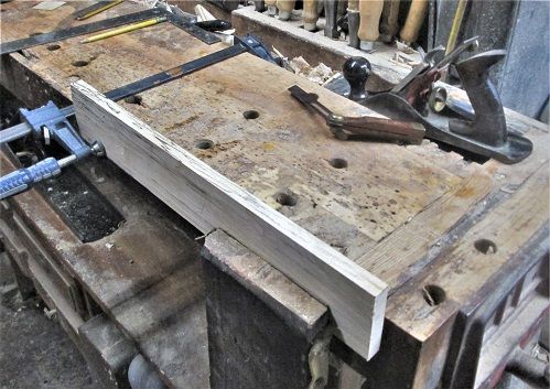

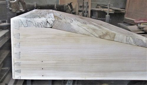

Once the bevels match...I can flip this board over. and joint the back edge, where it will get glued to the back of the desk...:ChinScratch:
I also needed to plane a bevel onto the front, where the lid will rest when closed up...:OldManSmiley:
Will clean up all glue joints, when I am done..:SaluteandRun:
Let this sit a day:Tapping:

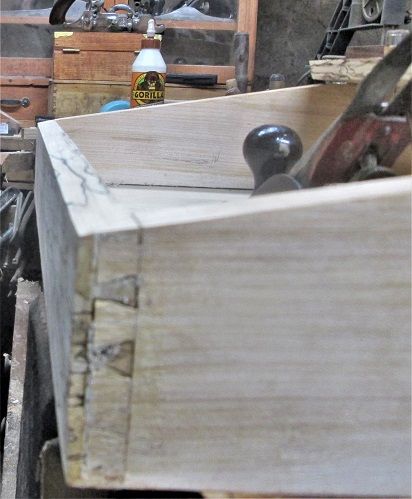

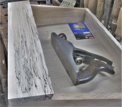

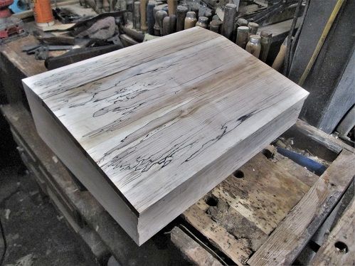

Ok, out of the clamps, again....clean and level the glue joints..
Trying to get the top to look like a single board..

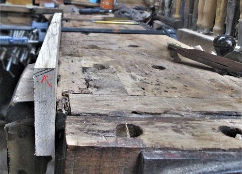

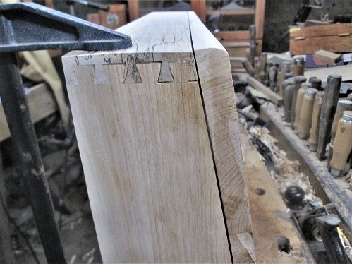

Dovetail joints look a bit better, too...checked the lid to see about length..and if the ends were square...usual...one wasn't,:ArguingSmileys: we have ways..:ph34r:
Bit of scrap to stop any blow out on the exit...was a nice try..:BangingHead:  ( more on that later)   Underside needed to be flatter...MUCH flatter...No.8c to do that chore

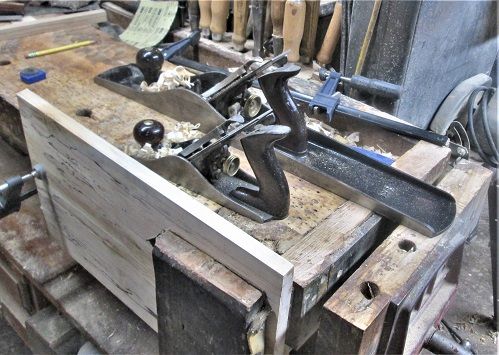

Lid then needed a bevel planed along one edge,,,to match up with the bevel in the top..so
No.8c to get close, No. 3 to fine tune the fit...:OldManSmiley:
Getting there....:ChinScratch:

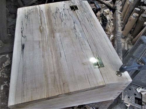

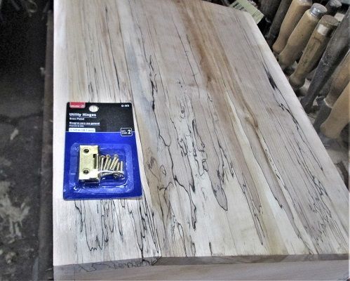

Thought about adding these...:WonderScratch:
But...should have just surface mounted them, instead of trying to mortise them in place.....:ChinScratch:would have saved a LOT of :ArguingSmileys::ArguingSmileys::BangingHead::ArguingSmileys:

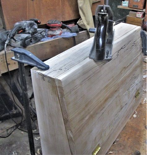

Lets see....hinges needed flattened out....:ChinScratch: but NOT bent.....Mortises were chopped..but..the lid wound up going on upside down?:PullingHair:,  then the pilot holes for the screws, were stripping out in the spalted wood.....and NOTHING was lining up right...spent the day thinking this over...:ChinScratch::Tapping::WonderScratch::ChinScratch:
Returned to the shop...threw out the bent hinges, laid the lid in place the correct way...dug out another pair of hinges, and surface mounted them..:MachineGun:
About this time, that split out..split..:PullingHair:...didn't want to just glue it back in place..wasn't in the mood.:ArguingSmileys:...took the planes to the edge..and leveled things out..and over...:ChinScratch:
Then stood the desk up on it's back, and finished the round-over..:ChinScratch:.(split out is at the far end)
And...called it a night.:GoodNight:
Those hinges are "Stand-ins" for now...need to go out and BUY surface mount hinges....:OldManSmiley:
Stay tuned...:cowboy:

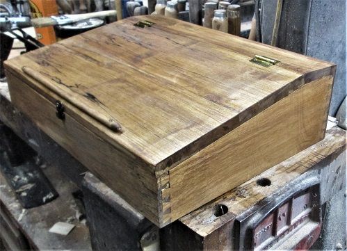

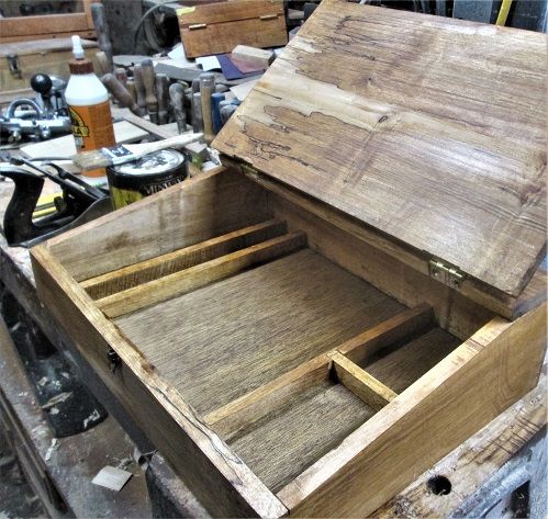

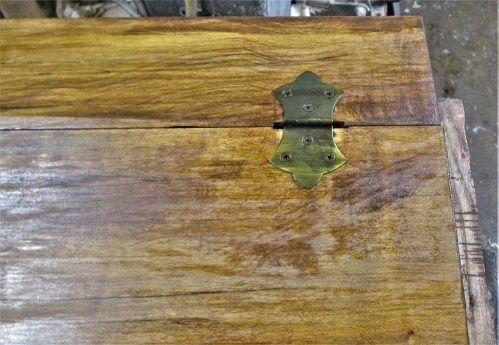

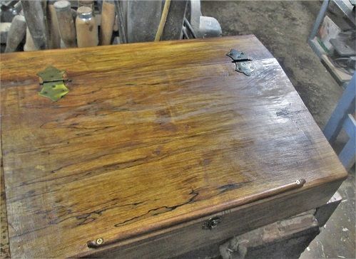

With the new hinges installed...
A latch has been installed...
Nice part of taking a lot of photos...defects can't hide ( went back and tightened THAT screw down)

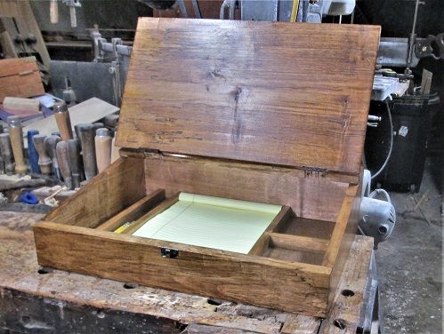

Open the lid...
Space in the center fits a yellow Legal Pad.   Places for pens, pencils, 3 x 5 cards....whatever...
Has since been given a second coat of Witch's Brew Stain, a seal coat of Amber Shellac....been rubbed down with 0000 steel wool...and is currently waiting on a coat of...
this to dry, before it gets rubbed down again....may, or may not add small handle to the sides...we'll see
Almost done..

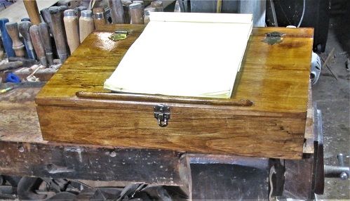

Varnish is dry, inside and out...rubbed down a bit...
Olde school Notepad?:ROFL:
Open the lid, and stow the notepad away..:ph34r:
Close and latch the lid...:OldManSmiley:

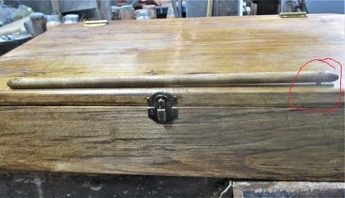

On the way around in back, stop by for a look at the end....and:SaluteandRun:
The backside....as for the underside..:WonderScratch:
yes, it also got a bit of finish...:TwoThumbsUp:
I think I can call this done?:ChinScratch:
