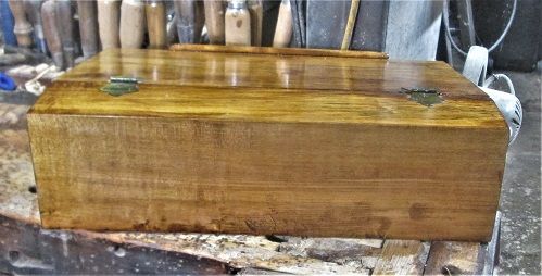

So, MAYBE a Lap Desk in there, somewhere?:ChinScratch:
Have a parts list of pieces to choose from...depends on how fancy to make the lid/writing surface...:WonderScratch:

Gives some idea of what this will look like?:ChinScratch:

It will surely be beautiful Steven, but I have to ask how heavy it is getting?
The wood was thinned down to 5/8" thick....and the bottom panel will be 1/4" thick plywood....Haven't decided on what gets built inside, yet.....
