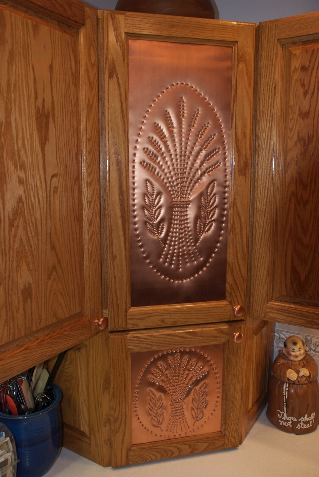

i have 3 tools:  normal punch awl, produces a nice round hole.  and two modified old screwdrivers, one makes a nice short line hole (just a filed down straight screwdriver), and the other makes a more rhombic shape, think it starts small on one end, gets big at the center, and then toward small again, and that also is made from a ground down old flat screwdriver.
i'll try to get some in progress and after shots of the work and the tools.
some punched copper from a prior house, using these same tools:
Love the look and especially the wheat pattern of those DAB. Great job reducing the size for the small door. Perfect match.
What do you use as a backer support while piercing?
for that copper, i had some scraps of wood holding down all the edges, and then the backer was like 20 layers of news paper (that day's Washington Post).  i've since found that just a sacrificial piece of plywood works fine too, and I just tape the edges down to keep things from moving around (blue tape).
that copper really wanted to bend with all the punching, very soft, and lots of holes.

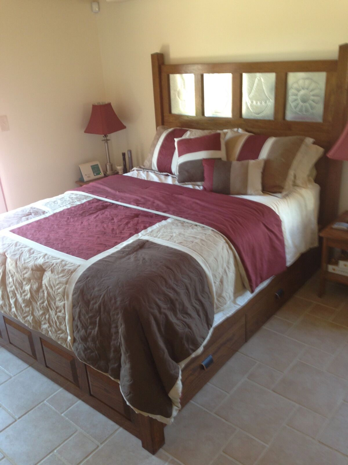

our bed, where I also did the punched metal:
those were all done with just the awl, using my own designs for Southwest inspired art.
better pic:
Thanks DAB for the feedback. Nicely done on the bed too. I picked up some sheets of copper around Christmas at Hobby Lobby. Sheets were in the closeout section. Priced 75% off IIRC. Hope to be well enough this spring/ summer to try on a project. I had considered using some rigid foam insulation board as backer, but if old ply gives the results you got that may be better.
