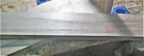

So..after getting that Paul Sellers' Keepsake box done...I still had this on my bench...:ChinScratch:
Mainly Red Oak..and one Ash..:rolleyes:

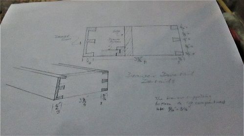

Ash is a bit on the thin side, the rest are 1/2" thick...remembered a Desktop Organizer sellers made a while back...thought maybe I could cobble another one out of this mess..:WonderScratch:..downloaded the 3 page Plan..:SaluteandRun:
Be the starting point...
Then I'll worry about that drawer....cutting list?
have already been modifying to suit what I have...:ph34r:
Letters are in the computer screen shot only, not on the boards themselves.:OldManSmiley:   These will be the bottom and the lid...
Back is a full 4" tall, as are the sides...front is just 2" tall.  And it will go above the drawer opening.

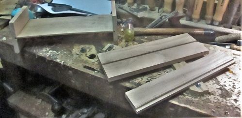

This will be the bottom of the compartment.   Needs a rebate and a few grooves to sit in...:ChinScratch:
Easy one first, right?:ROFL:
Riiight.....:ArguingSmileys:

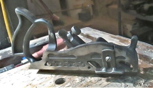

1/4" x 1/4" rebate...next, grooves laid out to match this rebate..:ChinScratch:
And hope they all line up.:ChinScratch:..took awhile..:Tapping:

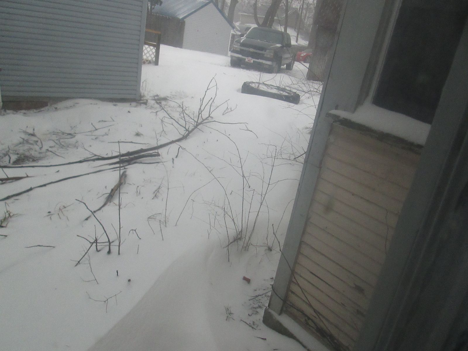

Winds from18-35 mph...colder than a Siberian Bat's rear end.....
Currently, my view of the world....

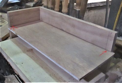

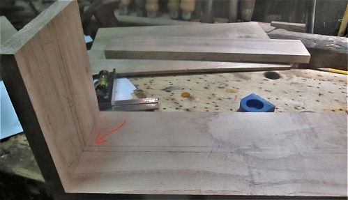

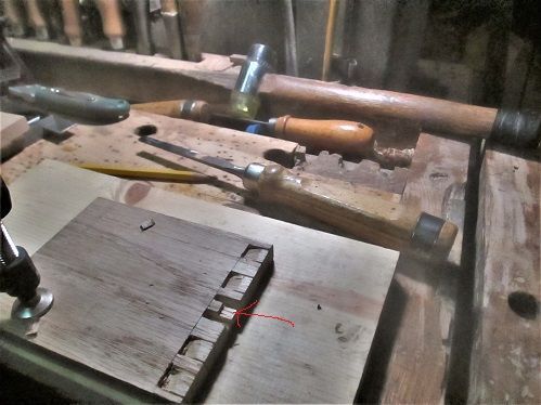

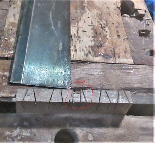

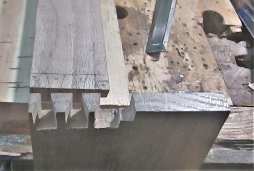

Did some more lay out work...also had 2 extra cuts to mark out...:ChinScratch:

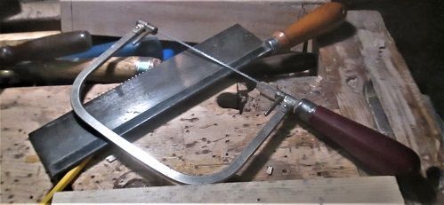

had to be careful where this saw went....:DevilLaughing:

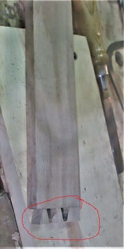

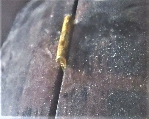

As I need to leave that tab,,,,or, at least half of it...:OldManSmiley:

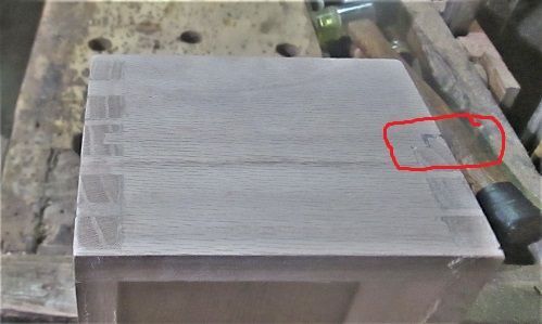

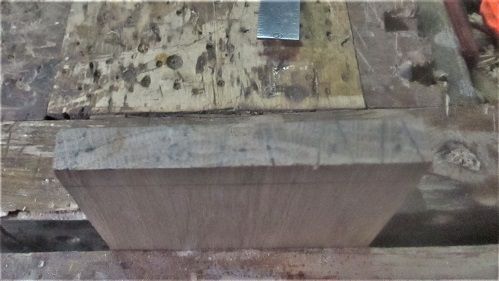

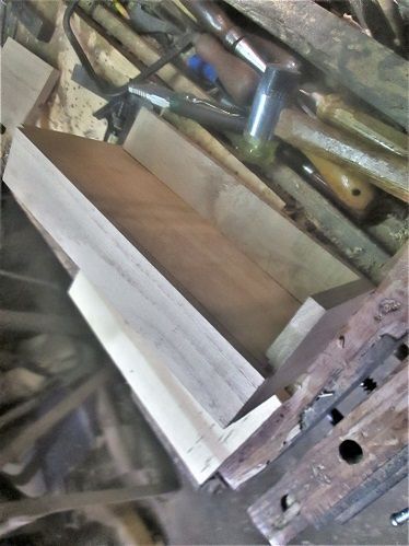

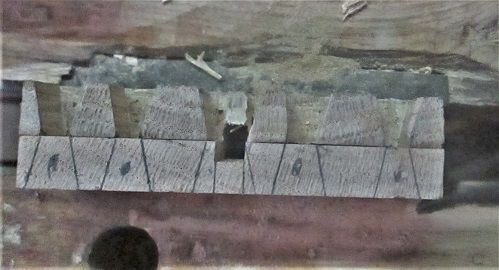

Outside face chopped about halfway down   and 1/2 of that tab..:OldManSmiley:

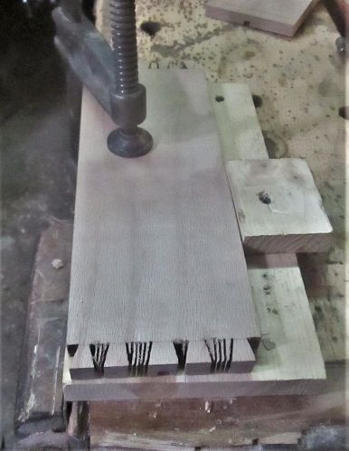

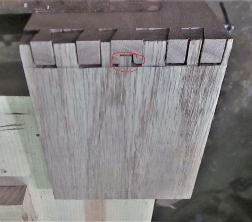

Cleaned up the waste areas...note the tab...Used these pins to lay out the tails.  Then saw and chop those,,,,dry fit?:ChinScratch:
Can't get it any further down, like something in the way, holding this apart...hmmm:BangingHead:
IF I trim that tab down a hair...and some "trash" around it,  this will close right up.   No filling a square hole required.:TwoThumbsUp:
Might have the plywood a bit oversized..:WonderScratch:

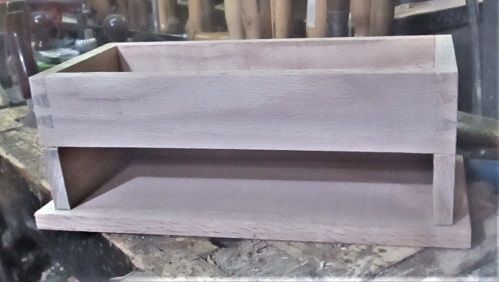

Waiting on the other 3 corners to get done, then trim this to fit...front of the compartment even fits...:TwoThumbsUp:
Should be easy to glue in place, later, after the corners are done:ChinScratch:

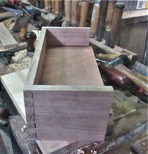

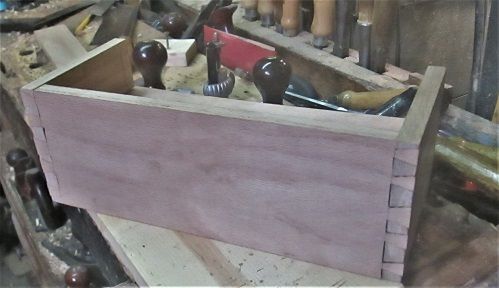

90 minute work session in the shop....AFTER an hour of Honey-do Job.....Back of the right leg now has a crampy softball size knot..that makes walking rather "fun"...:BangingHead:

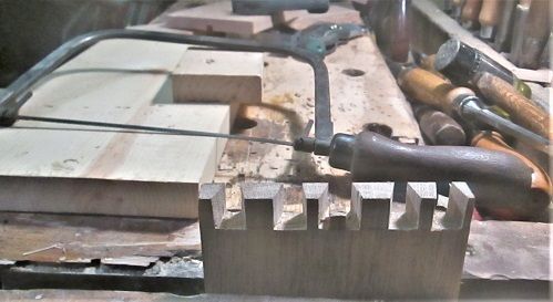

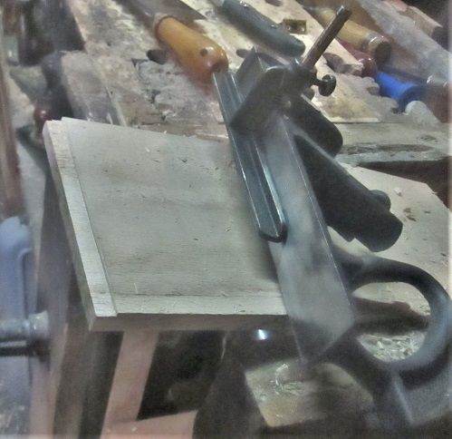

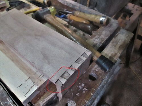

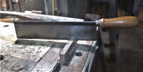

Had 3 tasks to do...one was a little bit of handsaw work..:SaluteandRun:
Followed by more of that chisel work to remove the waste..Had to switch out the old Atkins No. 50 coping saw for a newer (sharper,too) Millers Falls coping saw...to level things out, and trim that stub tenon...:TwoThumbsUp:

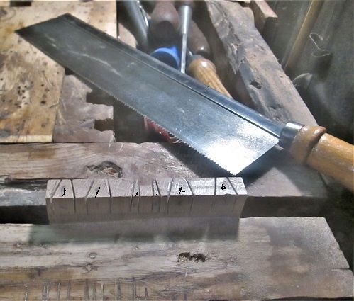

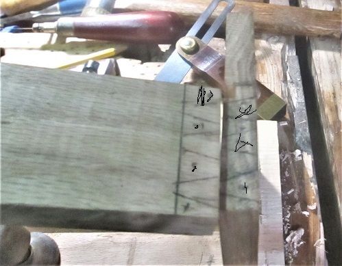

Used the pins to lay out the tails..just trace around around them with a very sharp pencil.   Then a few saw cuts at the bandsaw...:JawDrop:
Then a chisel or 2 to clear out the waste..and then a dry fit...that took a mallet to do (might have been a little too tight?:rolleyes:)
Yep...I could also cut the plywood panel for length...width will have to wait...:Tapping:
"Look Ma, no holes" :TwoThumbsUp:And, that was two out of three tasks, today....the third one?

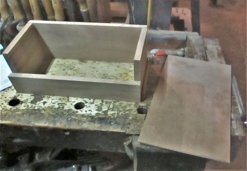

Dry fit, to cut the plywood to size...:ChinScratch:
Repeat for the other end...:SaluteandRun:

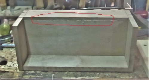

Something was holding that end out...hmm...:WonderScratch:
Need to run a plane along that ragged edge....then things will fit better.:ChinScratch:..so...

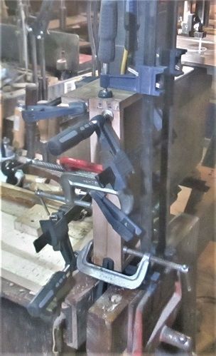

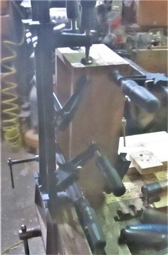

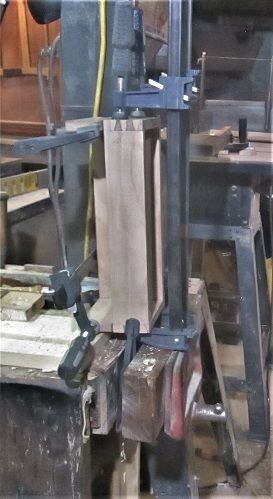

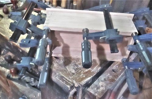

Glue, a brush to spread the glue around...oh, and a forest of clamps.   C clamps to clamp the floor board into the rebate, and a bed of glue.

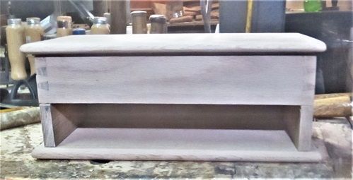

Back of the box.   Will let this mess sit right here, for a day....next up?   mill and glue on the bottom panel of the box....
Stay tuned...:cowboy:

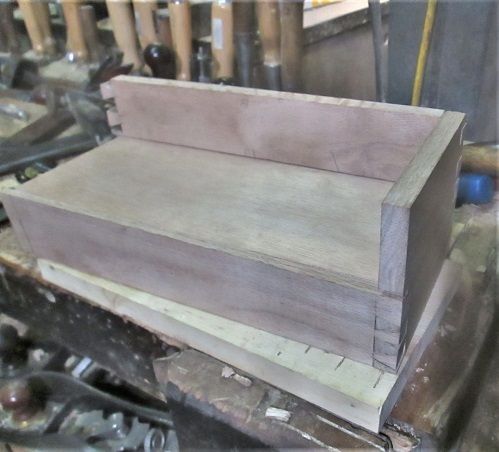

Clamps came off today..slowly...:OldManSmiley:
After about half were taken away...and nothing flew apart..always a good sign:TwoThumbsUp:
Got the rest taken off, time to clean a few spots..:ChinScratch:
And..fill a few..:BangingHead:

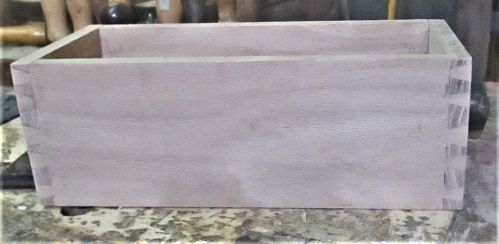

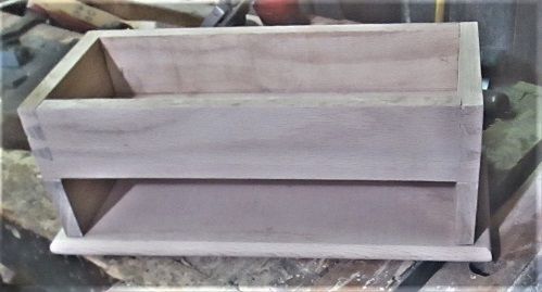

Back of the box...:TwoThumbsUp:

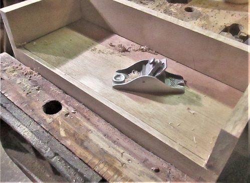

Some detail work, to level the edge..B)

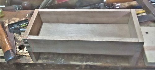

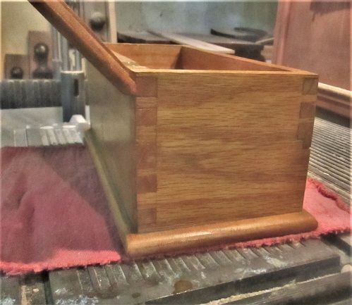

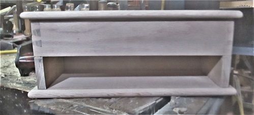

Looking a little bit better...sat this thing onto the panel that will be the bottom of this box...:ChinScratch:

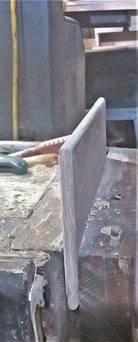

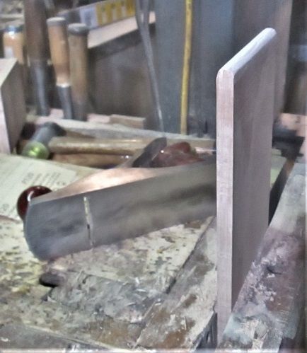

According to Sellers..edges of the bottom panel get a round-over...with a plane, cleaned up with sandpaper..so..:OldManSmiley:
I do both ends first..then..:TwoThumbsUp:
The long grain edges...looking for that crisp corner detail...set the box back on this panel..:ChinScratch:
Trying to center it up....next...still following along with Sellers...these two get glued together...so...:TwoThumbsUp:
Required 7 clamps.  Next up?:ChinScratch:

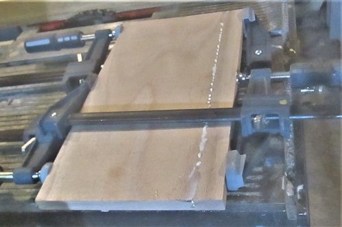

Would be the lid....except this panel isn't quite wide enough, to allow for the hinges, AND the rebated edges...we have ways..:ph34r:
Will be the "front" of the lid.   Need to let these 2 glue-ups sit a day...:Tapping:

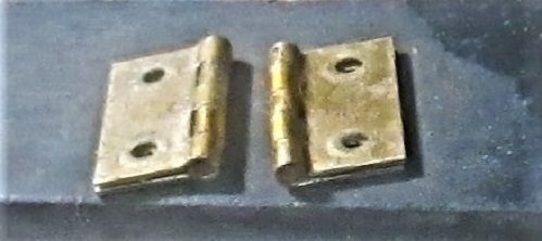

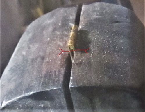

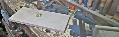

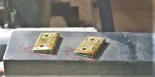

Needed the bench vise cleared off..to hold a metal working vise.  had hinges to flatten out..:SaluteandRun:
Wanted to close those gaps up, makes for a tight lid around back...clamped into the jaws of the old Monarch...:OldManSmiley:
And see how close I can get...:ChinScratch:
Hammer to assist in keeping things straight...had a slight "spring-back"..:ph34r:
Just have to remember which leaf goes on the box, and which on the lid :WonderScratch:

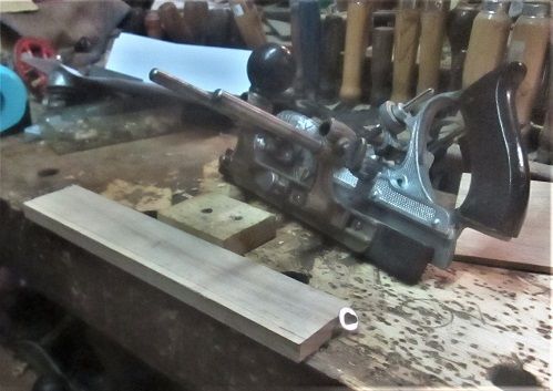

Vise put away( better eat your Wheaties, before you lift it!) need to set up a rebate plane...

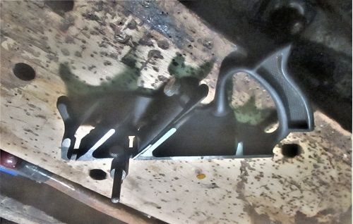

Fence installed, will fine tune it's setting later..depth stop also needed installed...
To about the thickness of the hinge leaf.   Unable to even budge the knicker's bolt, I suppose I can use a knife, instead...be sharper, anywayB)

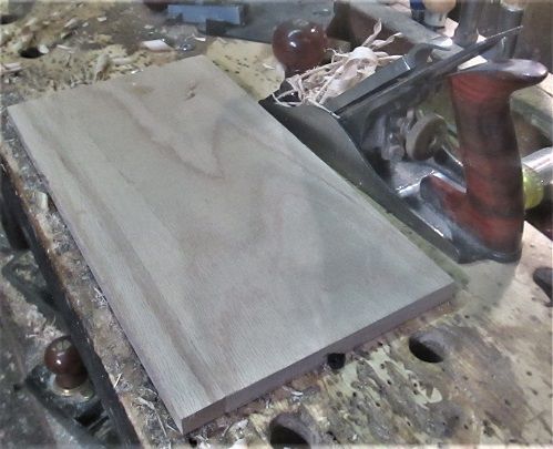

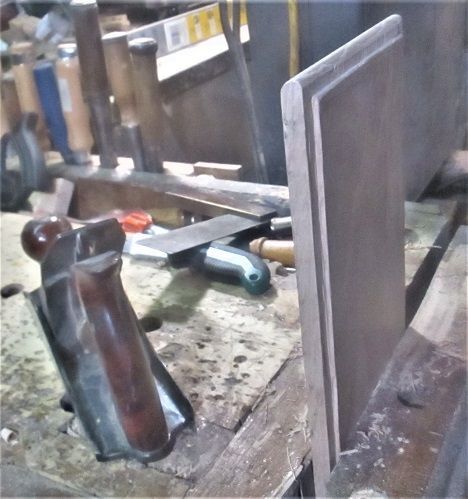

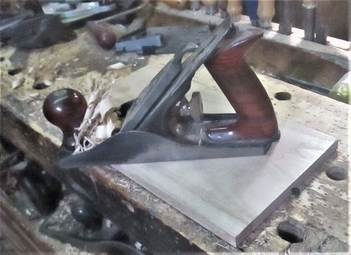

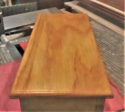

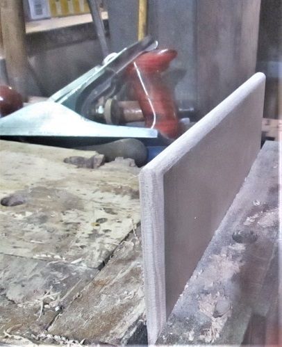

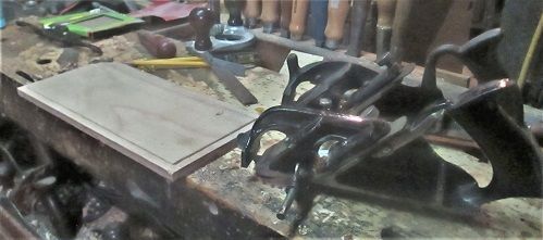

Lid was taken out of it's clamps, needed to be planed a bit, due to the glue lines..so..:OldManSmiley:
Didn't come out too badly..:TwoThumbsUp:
Have to do both faces.  Then decide which one looks the better...and that will be the "Show Side"....glued on extra will be the front edge of the lid.  :ChinScratch:

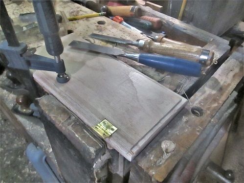

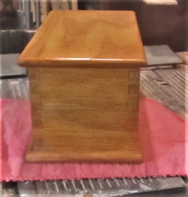

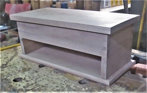

Worked on getting the lid installed, today...2-1/2 hours in the shop....kind of sore, now....must have been all the cussing going on :rolleyes:
Anyway, centered the box to the lid..:TwoThumbsUp:
Had to trim a hair off one end...to get the same rebate all the way around...then..1st rebate..:SaluteandRun:
Done.  worked on the other end.  Done..then the long grain sides..:ChinScratch:
Done.  Figured I'd try out both the Stanley/Wards and the Sargent/Craftsman..about the same...then do the round-overs...:OldManSmiley:
With a smooth plane, and a sander...both ends first...then the long grain sides..:TwoThumbsUp:
had to watch how the grain was going...:OldManSmiley:

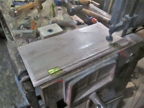

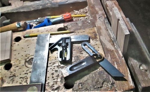

next, lay out for 2 hinges...1-1/4" in from the end..:ChinScratch:
Got a wee deep on that corner,,,happens on the bigger jobs..:BangingHead:

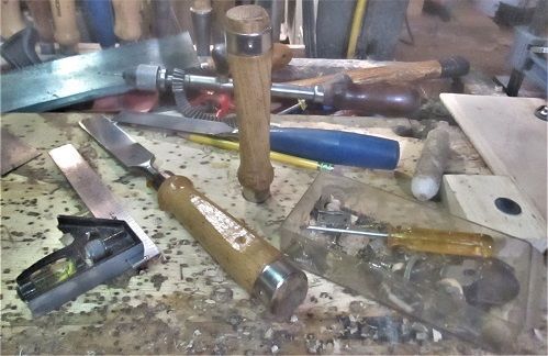

Then some hinge install tools:ChinScratch:
Smallest Phillips screwdriver I have.  Handle sticking up is attached to a 1/2" wide chisel, that kept trying to roll away...:ArguingSmileys:
One done..:Cheer:

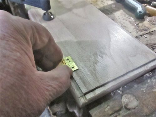

Once both were done...used them to lay out the locations on the box itself....line up the rebates with the top edges of the box.....almost had enough hands..:BangingHead:
New drill bit in the G-P eggbeater...wax on the screw's threads is REQUIRED in this Oak.  :OldManSmiley:

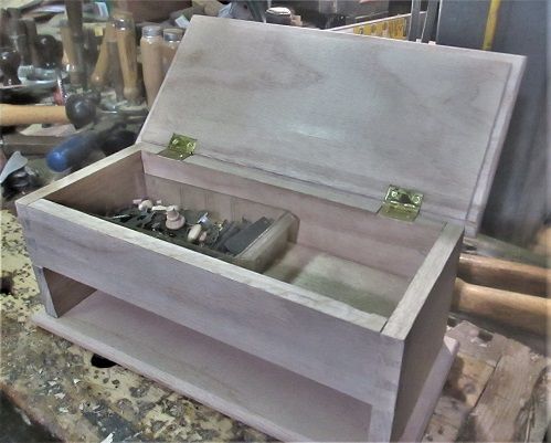

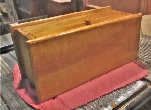

Design is such, that the rebate stops the lid from flopping back flat.:ChinScratch:
Close the lid, and check for gaps...:TwoThumbsUp:

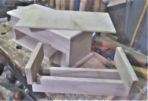

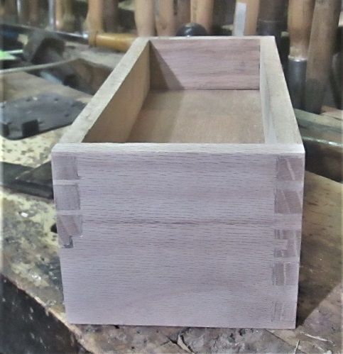

Rough cut the parts for the drawer.  Which be will the next time I get to the shop...had enough fun for today..:GoodNight:
