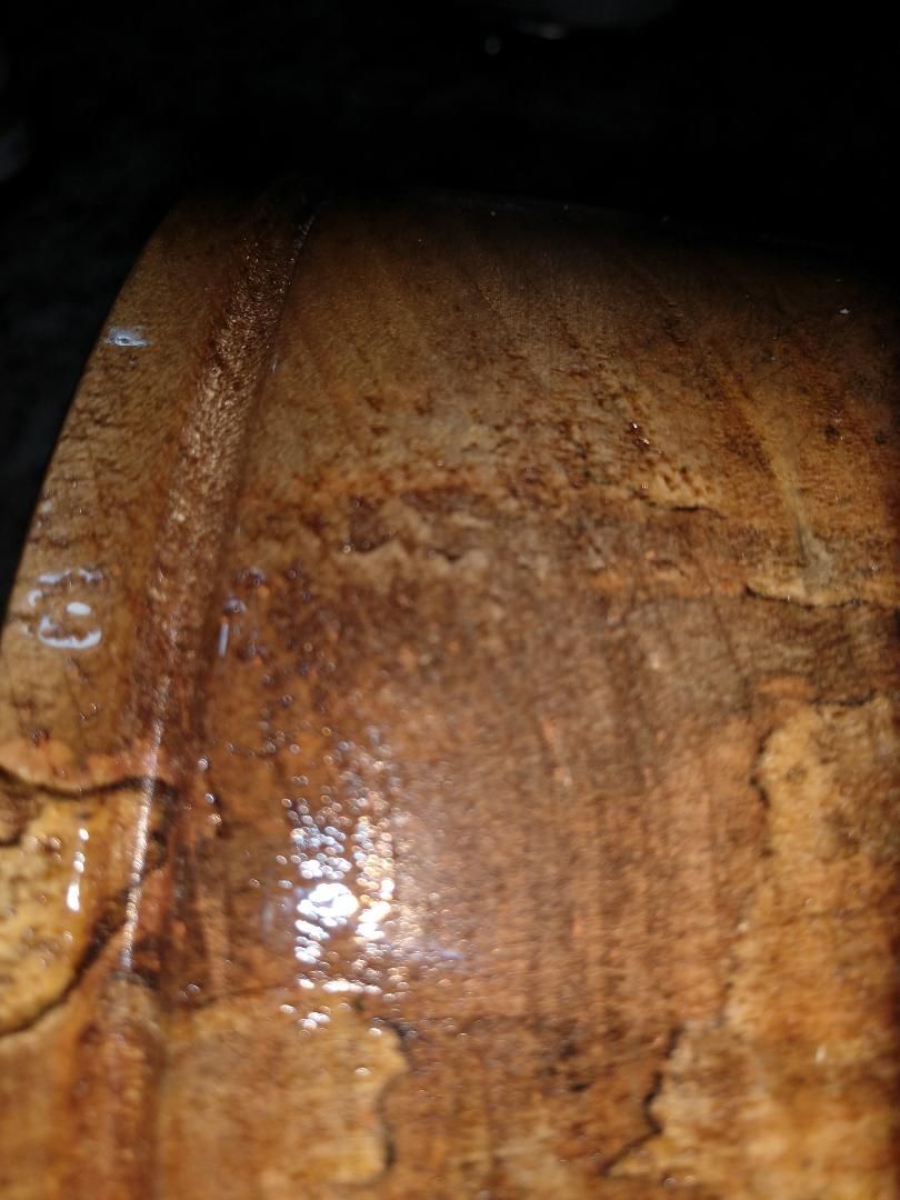

15 minutes ago, Gerald said:
how much tear out fo you have , 1/16 or less?
Yes---it looks like pox marks. Like you're looking into the end of a straw not like you had a catch. But when you run your finger over the grain it feels rough. I guess similar to stroking a cat's hair backwards. Best explanation I gave think of right now.

Can you post a picture of what you are turning?

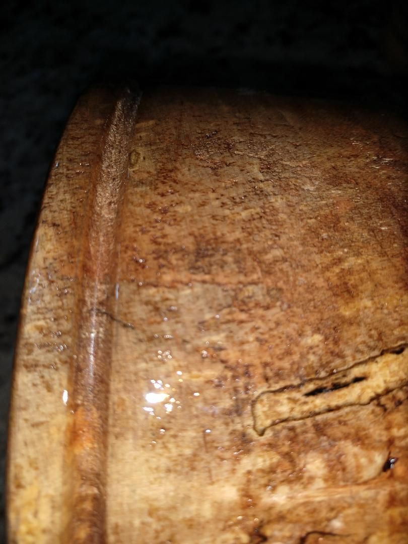

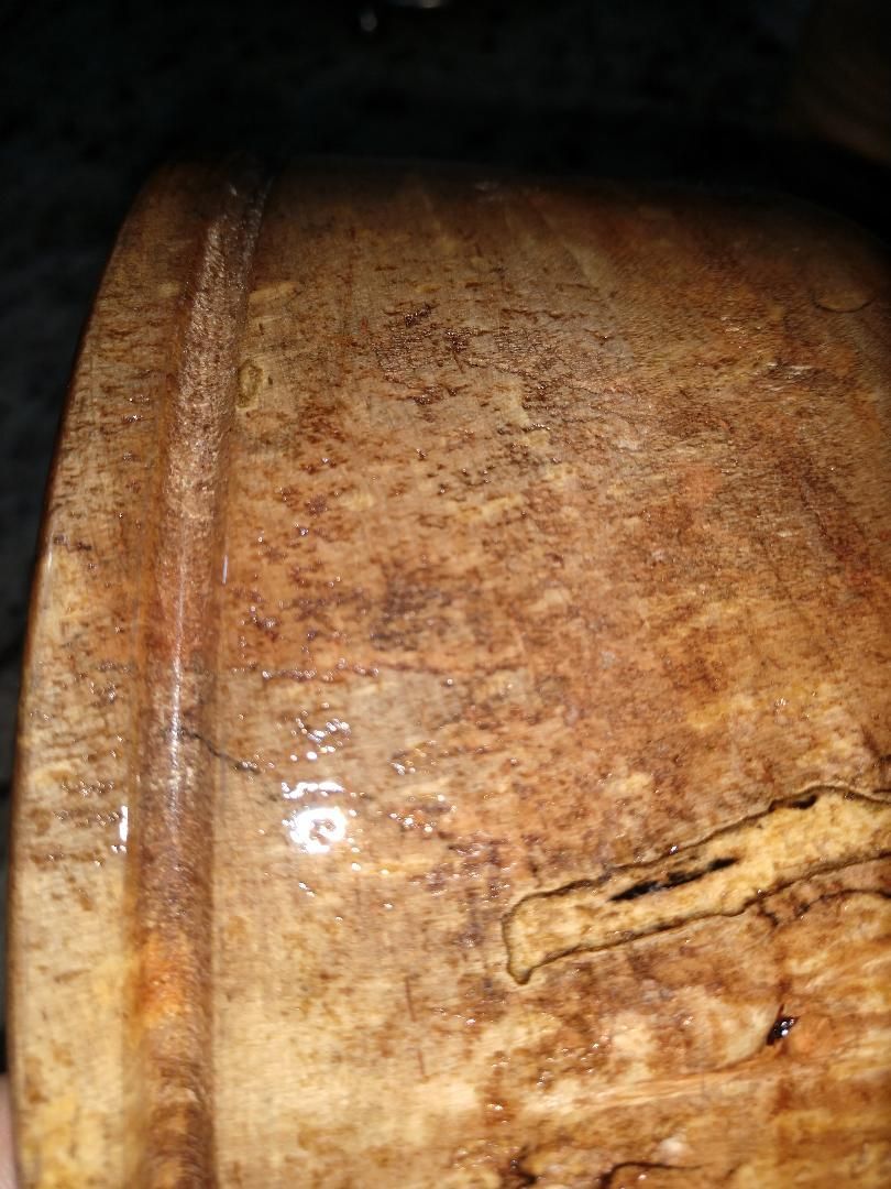

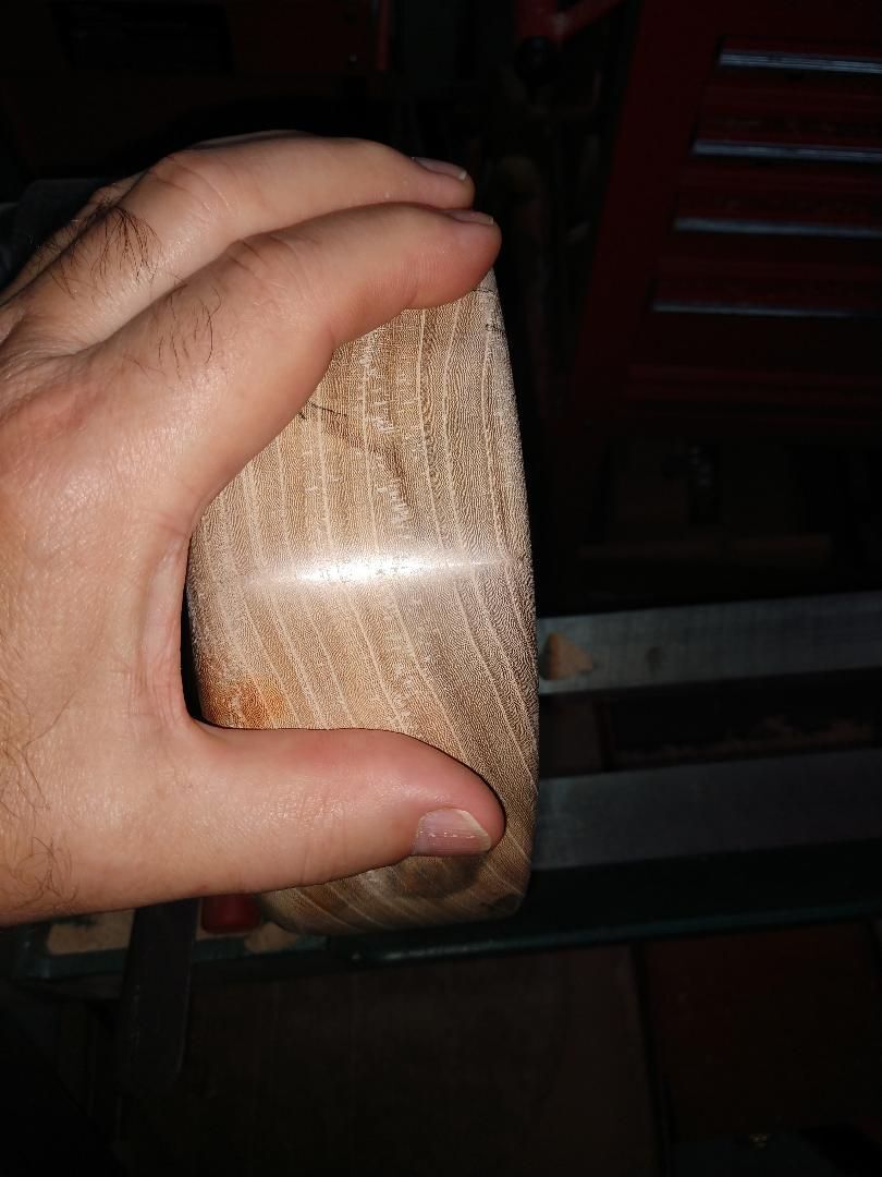

Soon---tomorrow?
Bowl #1bowl1-3.jpeg.93c9ec8d5776e4c0e0080ada33365819.jpegbowl1-2.jpeg.bf3c55a4b9dc7944e53bf00d88bce6eb.jpegbowl1-1.jpeg.571faddde6e8252c79365410f612ac71.jpeg
This is finished. sorry for the glare.
Bowl #2bowl2-4.jpeg.47fdc6be234081293eeeaa2091d489e8.jpegbowl2-3.jpeg.6c795c3a46dcafeff829d08a0ed5faec.jpegbowl2-2.jpeg.feed63d3e73fb9275a96a1c28fc35174.jpeg
Unfinished, but sanded to 3000
The first thing I see is the spalting. That is notorious for tear out. I’ve used CA to stabilize it to help reduce the tearing. I recently tried using a 50/50 mix of lacquer and lacquer thinner. Seemed to work pretty well, too.
I feel your pain on this. Those are pretty deep pock marks. When that happens, it is often easier to go back over the surface with light cut to get the surface smooth

One of the issues with any scraping type tool is tearout. I put the carbide tools in that category also. Try using a very sharp bowl gouge with a fingernail grind which shears the wood away and reduces tearout to a minimum.
Paul
Ok been away from where I could respond. Looks like the problem you had is both spalt and end grain tear out. The first solution as Lew said is a sharp bowl gouge. If you still get tear out sharpen again. Carbide is not the best tool for outside finish, even Hunter carbides do not give a fine outside finish for me.
