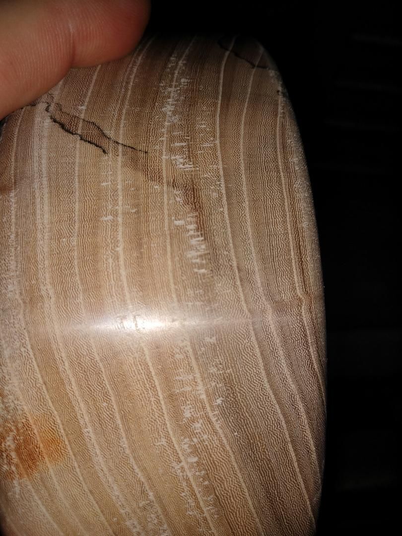

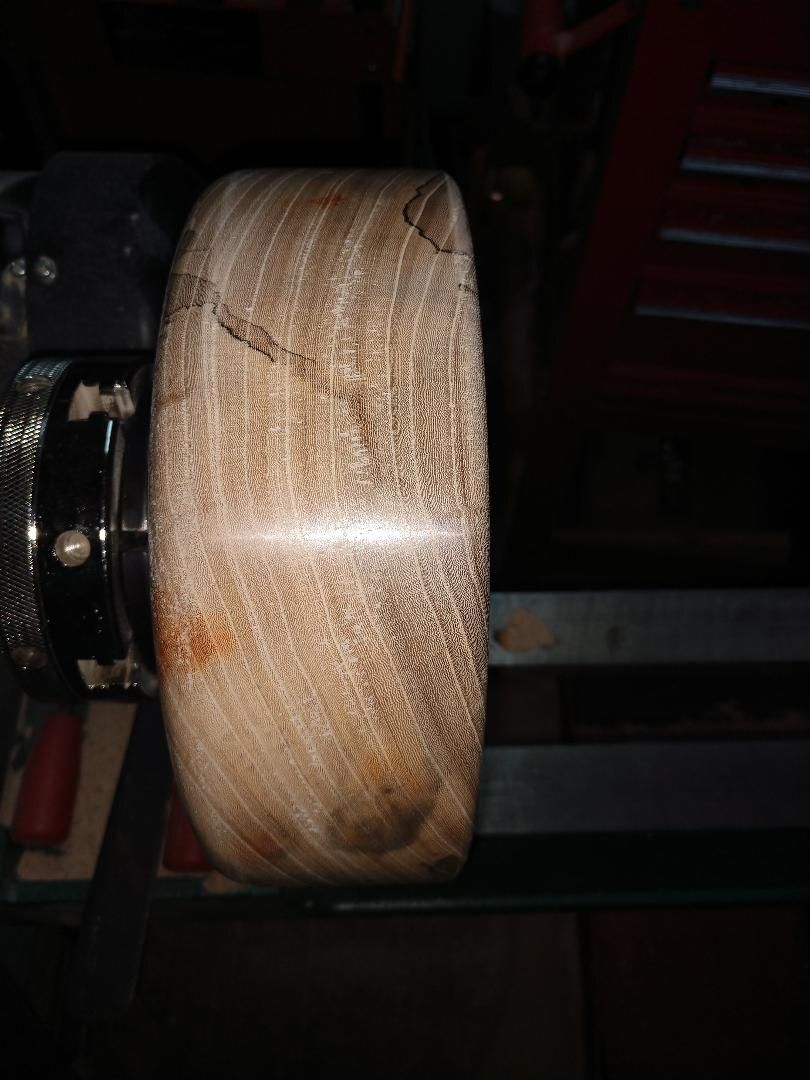

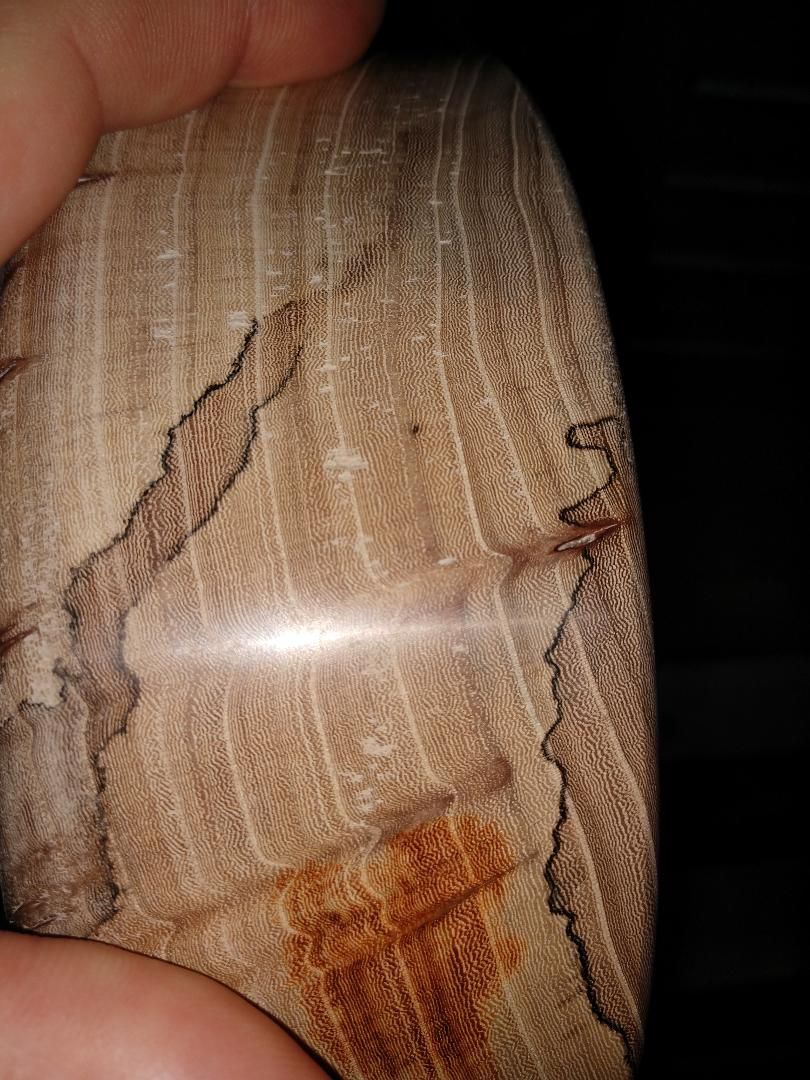

I'm turning and finishing some bowls. Sanded them up to 3000 grit (silicon carbide)----because she said so.! No stain, just Helmsman varnish.
Anyway, I can't get the opposing areas of end grain to sand smooth (inside or out). I'm still experiencing what I consider tear out.
Any suggestions to alleviate this? Is it a function of inexperience, or technique?
I'm using Easywood carbide tools if it matters. And -no- I haven't mastered a skew chisel yet. Lathe does not have reverse.
All thoughts welcome.

    I've had similar problems.  Seems like sometimes you just get a tricky piece of wood.  Doesn't look all that bad in the grand scheme of things.  Seal the surface with shellac and let it dry.  Very lig
If you are experiencing tear out the heavier grit papers are the cure for it.  Start with 80 or 100 grit and work your way up.  Tear out occurs in the end grain and end grain is hard to sand.  If you get to 180 grit and still see the tear out go back to a grit or two.
I started @ 60!!
I noticed if I stop the lathe & hand sand across the end grain I can knock it down a bit. With the lathe revolving making headway on the endgrain is a bitch.
Just sanded the $hit out of a 2nd bowl with a ROS and got better results but only on the outside. The inside is still a demon. I'm in doubt that she will approve. She seems to think the wood needs to be as smooth as a baby's butt! Before applying a finish.
While your lathe cannot reverse all reverse does is change cut from above to below. Pull lathe out and turn from other side.

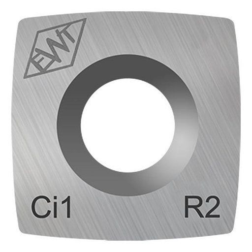

For the outside of a bowl, I have found the the EWT "rougher" with either the R2 or R4 radius cutter (depending on the size of the tool). These are not the negative rake cutters. I run the lathe as fast as safely possible and I have been getting excellent results. Equal or better than a shear cut with a bowl gouge.
For the inside, I use an EWT #1 hollower. Rough it out then very light cuts. Then finish with the same tool using a negative rake cutter. For softer wood, I us Starbond thin clear CA to stabilize the wood.

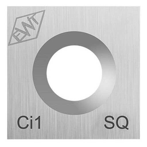

Upon inspection the cutters that came with the tools were standard cutters
I had trouble using the standard Ci1-SQ cutter on the outside of bowls. The corners tended to dig in. When I switched to the Ci1-R2 the results were much better.
Another thing, and don't tell Jim at EWT, I twist the rougher so the cutter is at about a 45° angle from horizontal. The tool is perpendicular to the turning and on the centerline as EWT recommends. This creates more of a shear than a scrape cut.
Something to consider is how much tear out fo you have , 1/16 or less? That is a lot of work to clean up. If it is more that is Rough. What Lew just said about angle of the cutter works for all scrapers carbide or tool steel .
The best way is to not get tear out to begin with but that is another story.
turning in reverse raises the grain in a different direction and is best for the second sanding but not any good here. Best bet without a BOB (bottom of the bowl) gouge would be turn lathe off and sand. Traditional scrapers are also good here but light touch or catches will get you. That is IV the tear out is in bottom as I understand.
