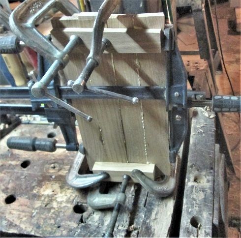

Decided to at least try to joint a few edges...
Find a few that matched each other, for a panel glue up...:ChinScratch:
Couple of cauls to keep things flat....:TwoThumbsUp:
While resawing to get the faces flat,,,,overlap was sometimes a bit...off.....this piece laid right over, just barely caught the spinning blade, and flew right back at me...glasses caught some of the impact, stiff upper lip got most of the attention....and bounced off.....heading for the burn pile.  :MachineGun:
Got to about the 4th panel glue up...:ChinScratch:
Found out I was getting low on clamps..:BugEyeSmiley:..without using the 24" or longer ones....stashed the 4 over on the saw for a day, or two...

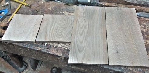

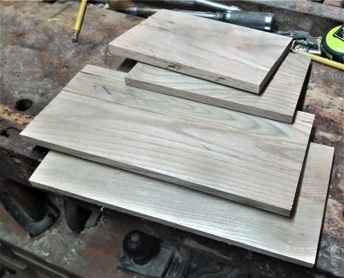

Ok...Got the 4 panels out of the clamps, today...
looking a bit ....rough...we have ways.:DevilLaughing:...60 grit beltsander and a Junior jack plane...
Then decided on what size to trim these down to...narrowest one to set the rip fence...and square the ends....two at 11" long
Other two at 5-1/2" long.  Figured I could also sort through a stack of narrow stuff...:rolleyes:
Well, maybe two stacks..:ChinScratch:
for the best match...ripped the worst edges smooth, and that Junior jack to joint a few edges...

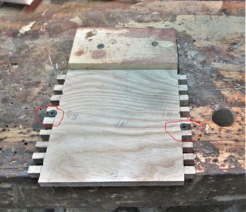

And lay out some fingers...:TwoThumbsUp:
6mm chisel set the spacing..more or less.:ChinScratch:..lower the pair of sides in the vise...
BTW, there are 2 boards sitting there, both are the long 11" sides...set inside to inside...ready for the saw..

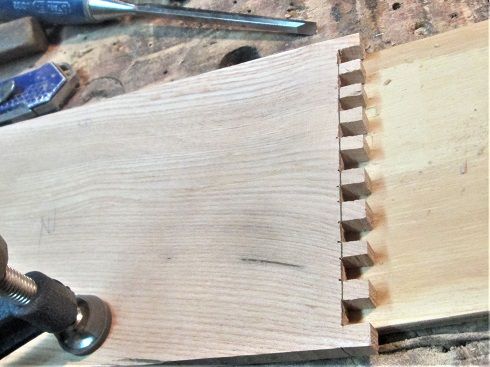

the "X" is the waste spots...time to chop a bit..
Working with just one side...chop 1/2 way down, on the show side ( outside) then flip this over..
And finish chopping them out....use these "fingers" to mark out the matching fingers on one of the end pieces...saw, and chop the waste...TRYING to leave the lines, while cutting out the waste...then first dry fit..:ph34r:
First ones are usually the worst fits, if it has been a while since I've done these joints. :WonderScratch:  repeat for the other corner, should be a wee bit better fit...in theory:ChinScratch:

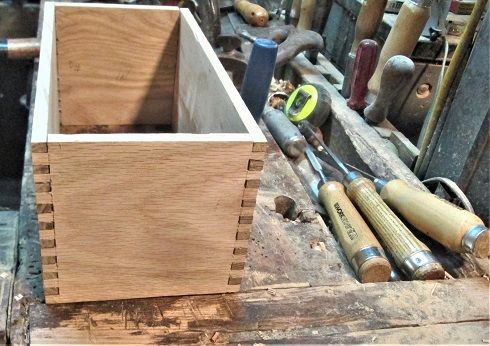

Hmmm...ok...Worked on the last 2 corners, today..:ChinScratch:
Spacing was a tad bit...off...that's fine....as I use this to layout the other half of the joint...:ChinScratch:
Was able to finally dry fit the 3rd and 4th corners..
Nice, when you NEED a mallet to slide the parts together....:Praise:

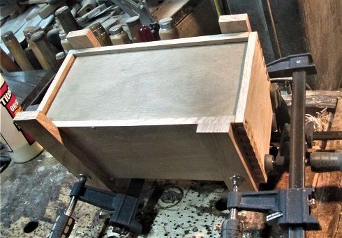

As the groove to house the plywood bottom are milled...:ChinScratch:
1/4" wide, by 3/16" deep....then cut a piece of 1/4" luann...

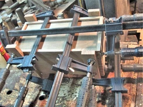

To make sure it will fit...knock this all apart, and do a glue-up..:TwoThumbsUp:
Glue, clamps and cauls.....:Cheer:
Might be just enough clamps?   Let this sit a day...tomorrow I can start on a lid, of some sort....:WonderScratch:

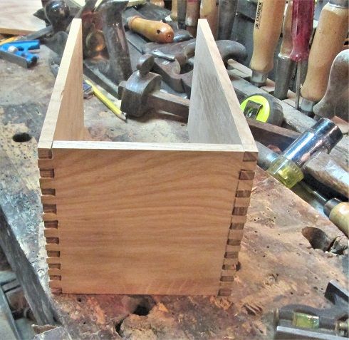

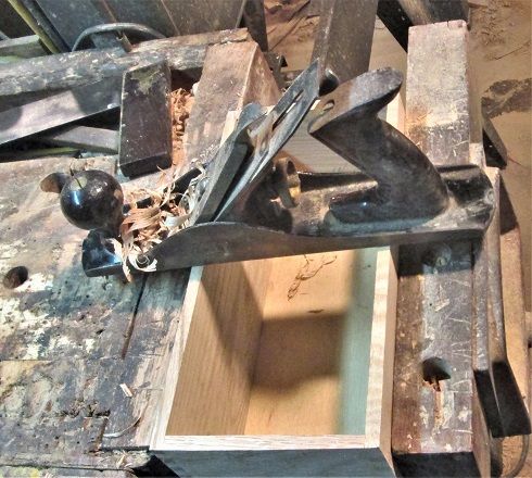

Removed the clamps, today....SLOWLY :ph34r:
Only one caul was stuck...until the mallet went by...
Needs a bit of work...

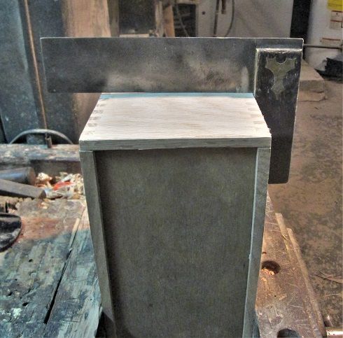

Joints cleaned up...ends checked for square..
Hmmm, needs a bit of work....
One end done....check the sides for any high spots..

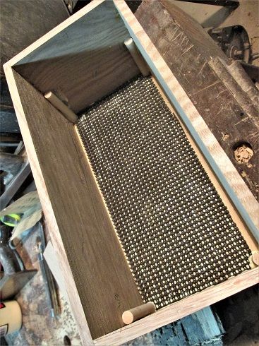

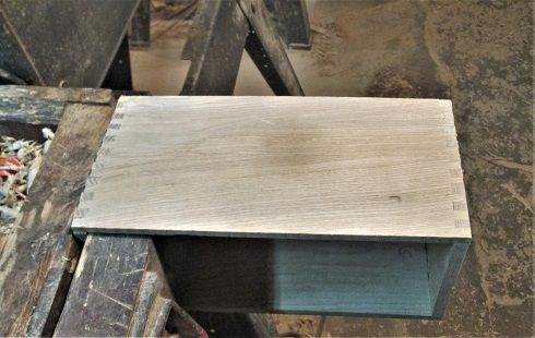

Outside of the box is done....then some details for inside...
A padded bottom, and some supports for a tray...

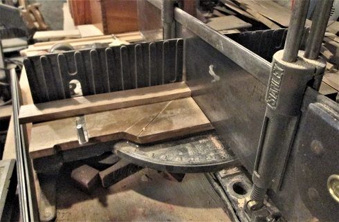

Got the cordless mitersaw up and running..
had a few parts to trim to length..

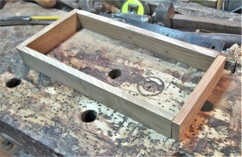

Parts for a frame..
To hold the lid..
Means more finger joints to be made..
Then make sure the frame fits the box...

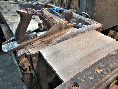

Some of the parts needed to be flattened a bit...
One edge thicker than the other sort of thing.....and a slight bow...
Blank for the lid also needed some work...on both faces...then the ends trimmed for length, and then the panel was ripped for rough width..

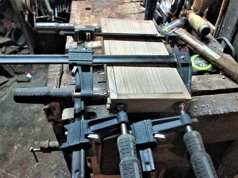

Leveled the bottom of a few grooves.   Was finally able to get the lid all glued up..
And, tomorrow, I can clean up the outside of the lid..:TwoThumbsUp:

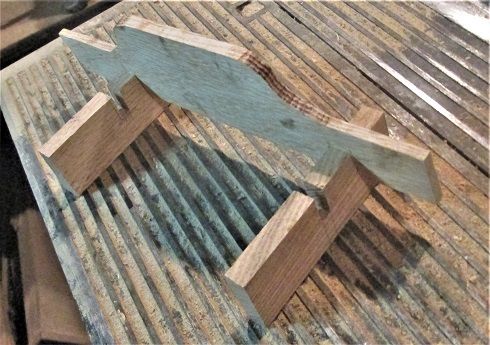

Worked on building a tray....1/8" thick slats, glued to a 1/4" plywood base...with a spacer bar..
So the side doesn't collapse in..:TwoThumbsUp:..made a blank for the handle...
Laid out where my fingers will go....decided to add a couple dividers...
Needs a fancy joint...to go from this, to...:ChinScratch:
Hmmm...:ChinScratch:
Something like this.    Drilled the holes for the grip....and of course the top half breaks off...:ArguingSmileys:.so, now it is also in a few clamps, until tomorrow...:Tapping:
