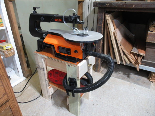

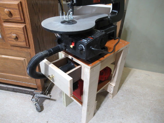

Finally  have the scroll saw set up in my shop. Built a small stand with scraps and included a drawer for blades. I added a Dirt devil vacuum that was looking for a use on a shelf below the saw. Sat in the desk chair and made my first cuts using a #5 pinned blade.  Can sit right up to the saw, straddling the stand with my legs. Absolutely comfortable. Here are my first cuts. A little shaky at first but after getting familiar with the hold down things seemed to improve.
Edited by Al B
 Nice set up Al and having a comfortable chair makes cutting a lot more enjoyable. Those vacuums are perfect for these machines. Some folks like to keep the blades in plastic test tubes, the hobby stores carry these. I cut the blade # and the maker from the package then slip it into the tube, this helps when reordering.
