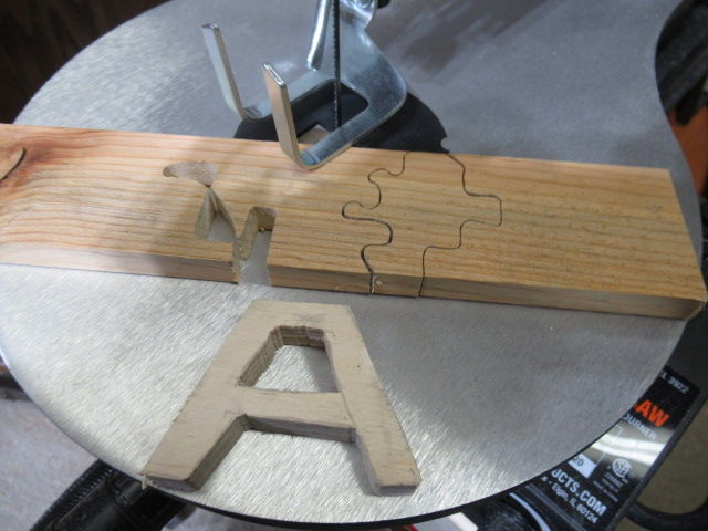

OK, decision made ! Since using pinless blades seems to be the recommended blades to use, I've decided to buy the Wen 3922 scroll saw. I want to thank you Artie for your offer generous offer. Thinking back, 50 years or so, I remember owning a scroll saw but never developed an interest. Must have given it away or sold it at a yard sale. Probably was a Craftsman because back it those days, Craftsman was all I bought. Now, what type blades should I buy.
Edited by Al B
 Al, Steve Good @ The Scrollsaw Workshop gives a great preview on the Wen 3922, https://youtu.be/1HjJTt1qpL8.
As far as blades I would suggest a sample pack to start with, usually 6 dozen each blade from 2/0-#9, gives you a good choice for sign making or fine fretwork. There are blade charts on the web that help with blade choice based on wood thickness. My go to blades are probably a #3 & #5 reverse tooth.
 Don't get frustrated with blades breaking or changing, sometimes it seems like your doing that more than cutting. Hope this helps.
