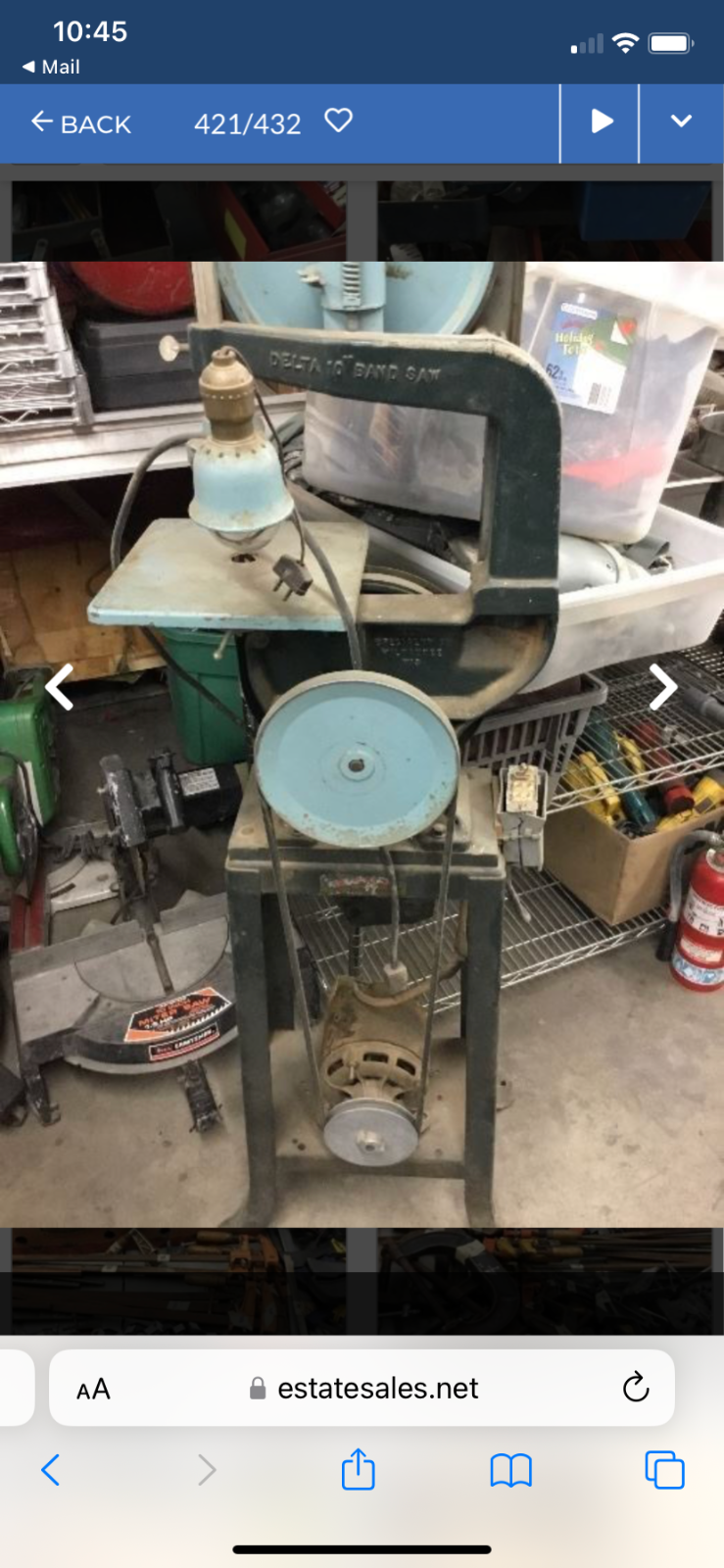

Delta model 785 10" band saw.

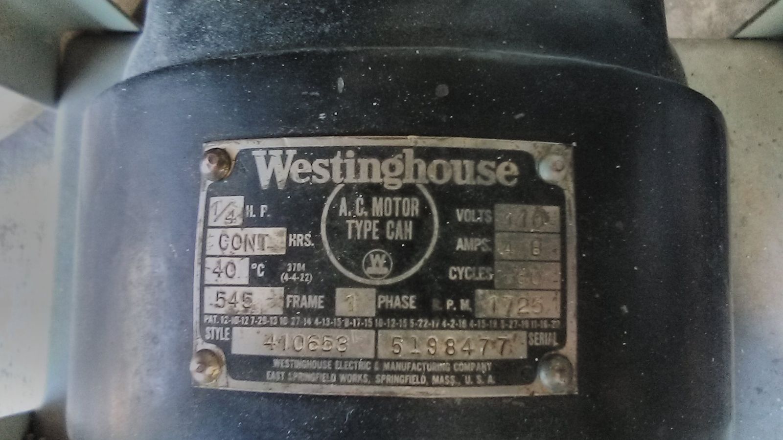

This is the pride of my shop. I doubt it has 1,000 hours on it. I'm the 2nd owner and I got it from a retired woodworker in Salt Lake City who wanted it to go to someone who would take care of it.
It's all original except for the lower motor pulley. That got broke in transit.
I did some research and I think this is one of the early models. It has stamped steel wheels instead of the cast iron that were on the later models.
I don't know if the motor is original, but it is from the same era.

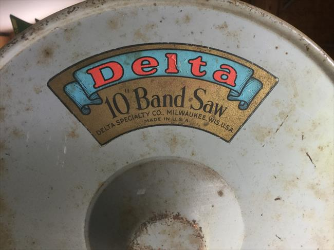

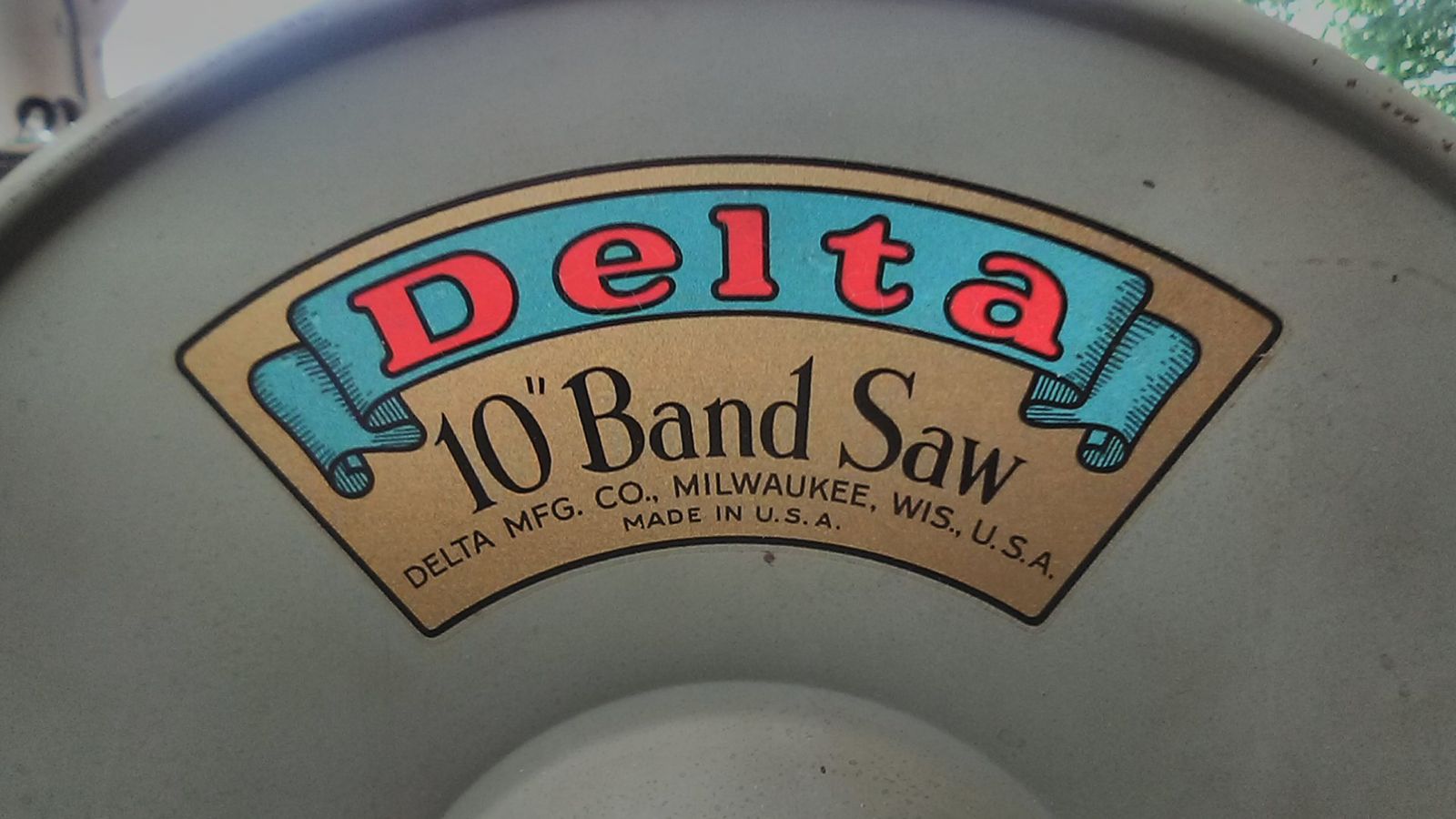

The 785 was Delta's first in house made band saw. It was first introduced in 1931, and retired in 1937.
Your machine would date from either 1936, or 1937 due to it having the 882 lamp attachment lug.
The earlier machines also had "SPECIALTY CO." embossed below the word Delta. The earliest 1931 saw also did not have guide blocks for the blade. The decal also stated "DELTA SPECIALTY CO" as below.
The saws were sold without a motor, but you are correct in that your Westinghouse motor is probably period correct.
Beautiful well built and taken care of machine.:TwoThumbsUp:

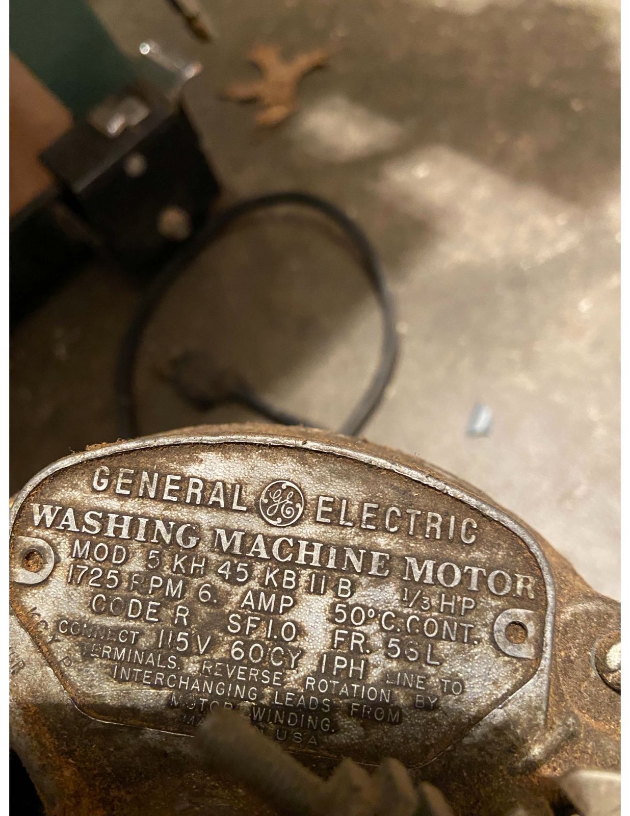

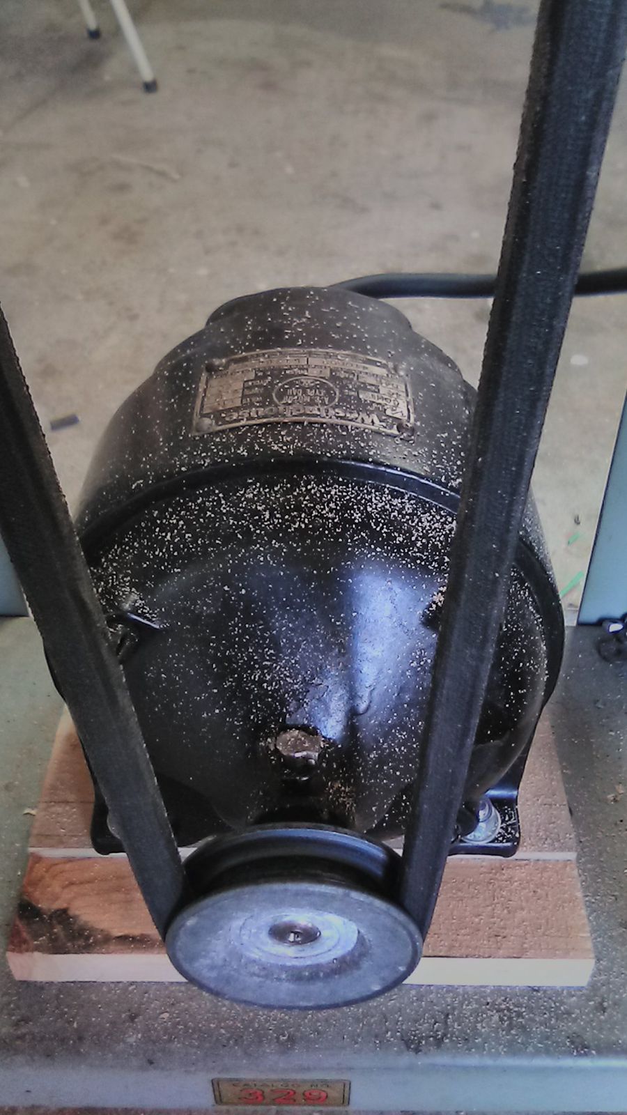

Hoping to resurrect an old thread but I just bought a Delta 785 in REALLY good condition with what I can see all of the original parts minus the motor (the “washing machine motor” was smoking really bad, I would assume it was the original motor since they weren’t sold with the saw.)
I just bought it yesterday but it’s so small that I’ve been essentially able to clean it all up, polish the parts to a shine and I’m ready to paint it.
Does anyone know the original color? (Might just go with the rustoleum grey) Also a good place to source new tires, a blade and motor? (Doesn’t have to be period correct but if new/old motor were same price I would choose old)

Welcome Michael. The original color would have been kind of a Smoke Grey.
Original blades are 66.5" in length, the closest I've came accross in ready mades is 67".
Tires can be ordered through Woodworkers Tool Works, ( http://woodworkerstoolworks.com/ ) They will require trimming the width.
They can also make blades to length.
Bearings are NLA, but can be rebuilt using replacement balls. They're like a bicycle bearing.
You'll be looking for a 1725 RPM motor, or will have to adjust pulley sizes to compensate for the RPM difference.

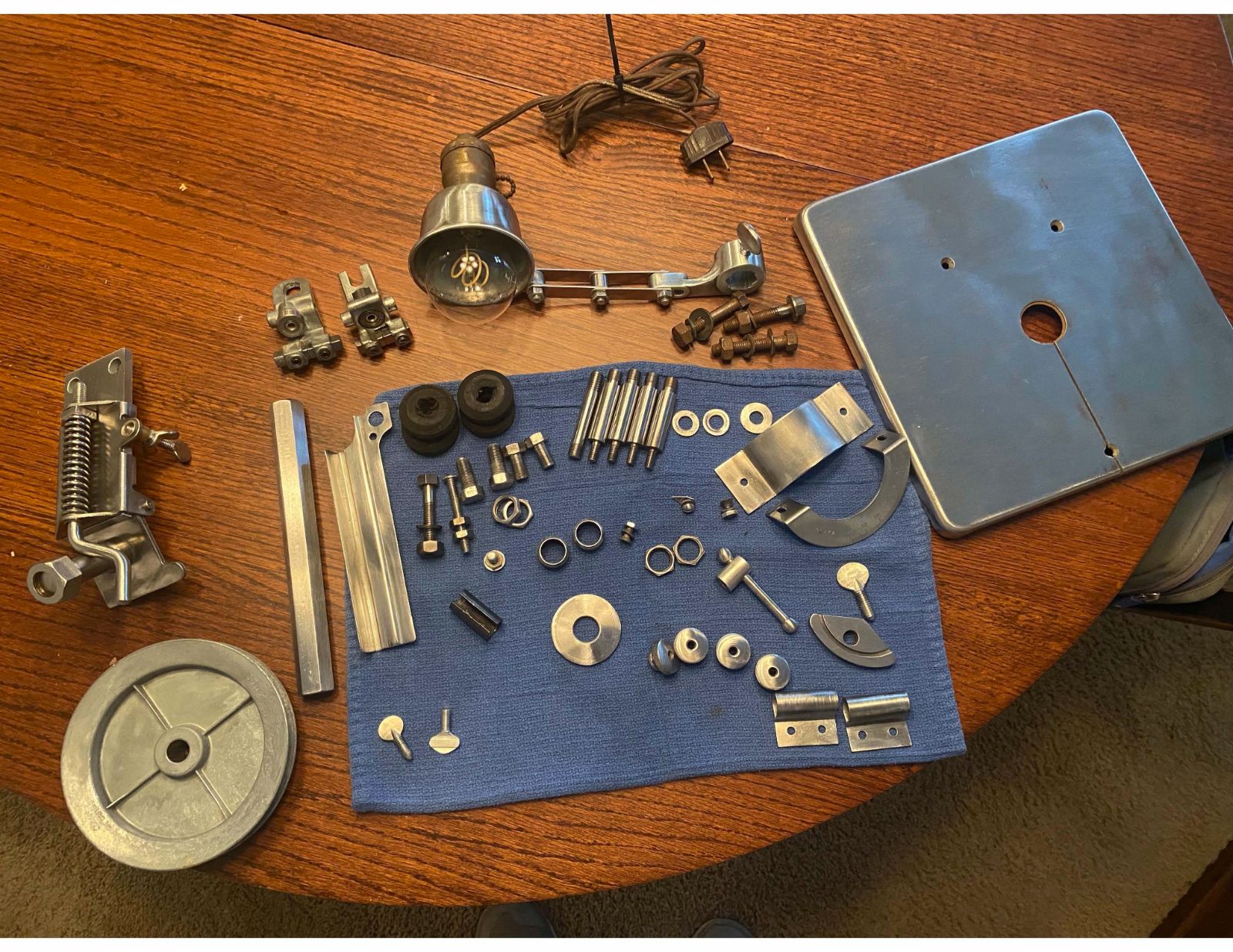

Oh my goodness, Larry. Thank you! Such a wealth of knowledge and I’m glad you replied! I actually just decided on smoke gray from rustoleum so I plan on painting it today! I am going to add some before pictures to share with you. It’s remarkable how complete this saw is, I’m not sure if there’s anything missing so I want to do a good job in restoring it back to its original condition.
I will look into the specific blade length and order some tires.
I’m wondering more about the bearings…The original guide bearings are actually really dang good… albeit they’re no Carter bearings but they turn smooth and I polished them up to a nice shine with my Brillo wheel and they’re humming.
Wheel bearings aren’t in bad shape either, I degreased them and got as much gunk out of there with my air compressor and they’re turning just fine. I plan on lubing them up with some performance grease after the paint job and rolling with them.
I plan on ordering a link belt to replace the V-belt… other than that, hope you enjoy the pictures! (I should have taken more)
@Michael D
I can't open your attachments, but the saw does look rather complete.

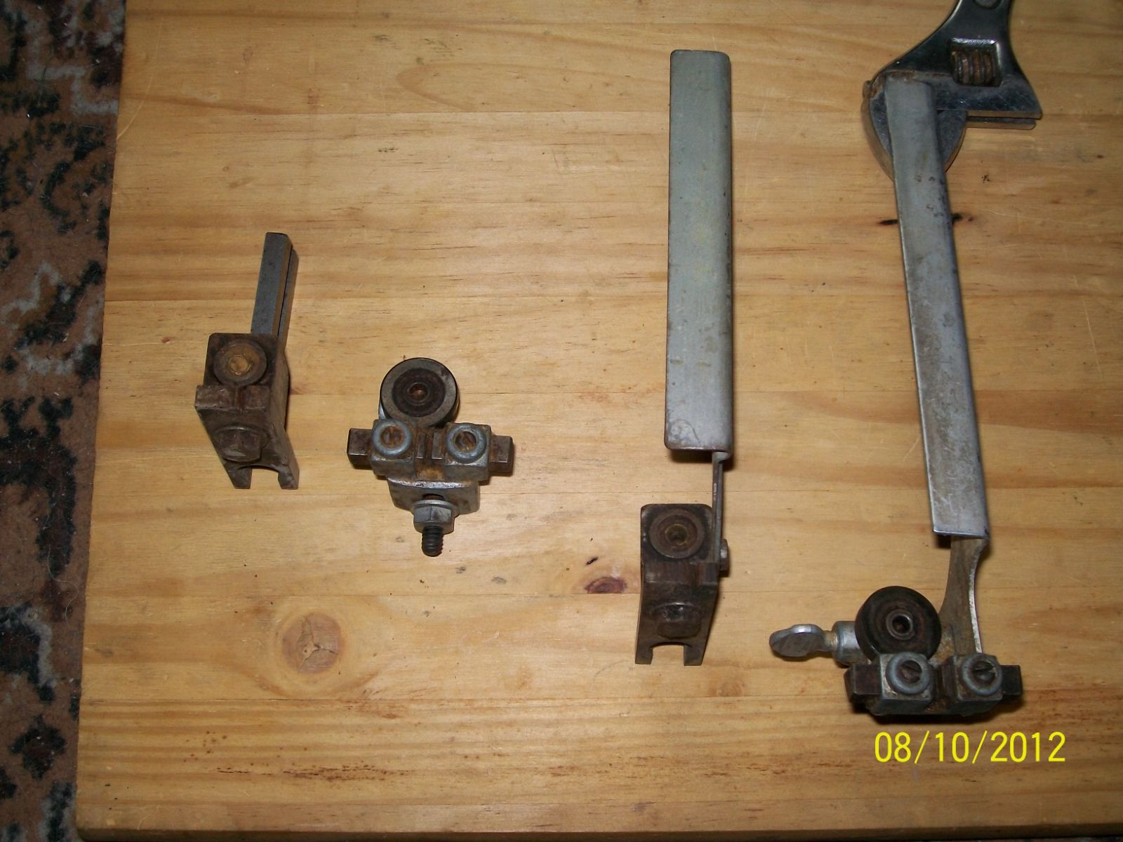

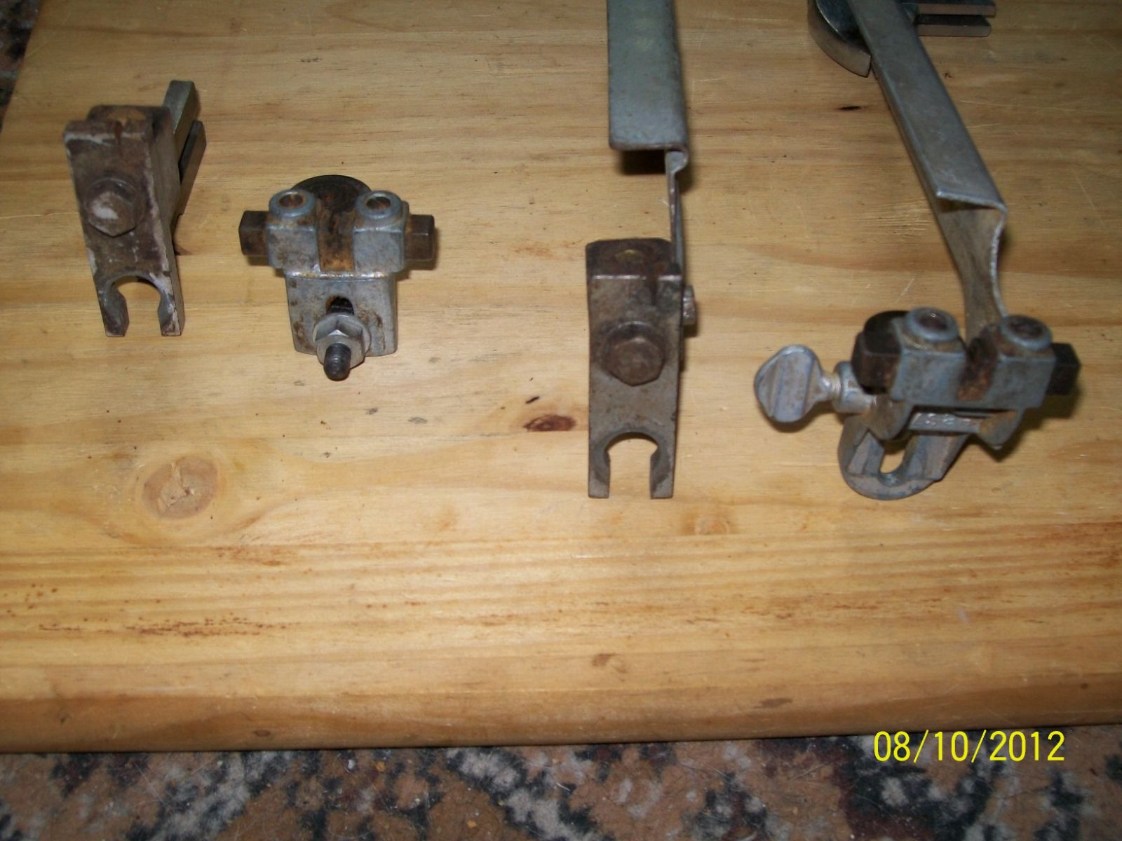

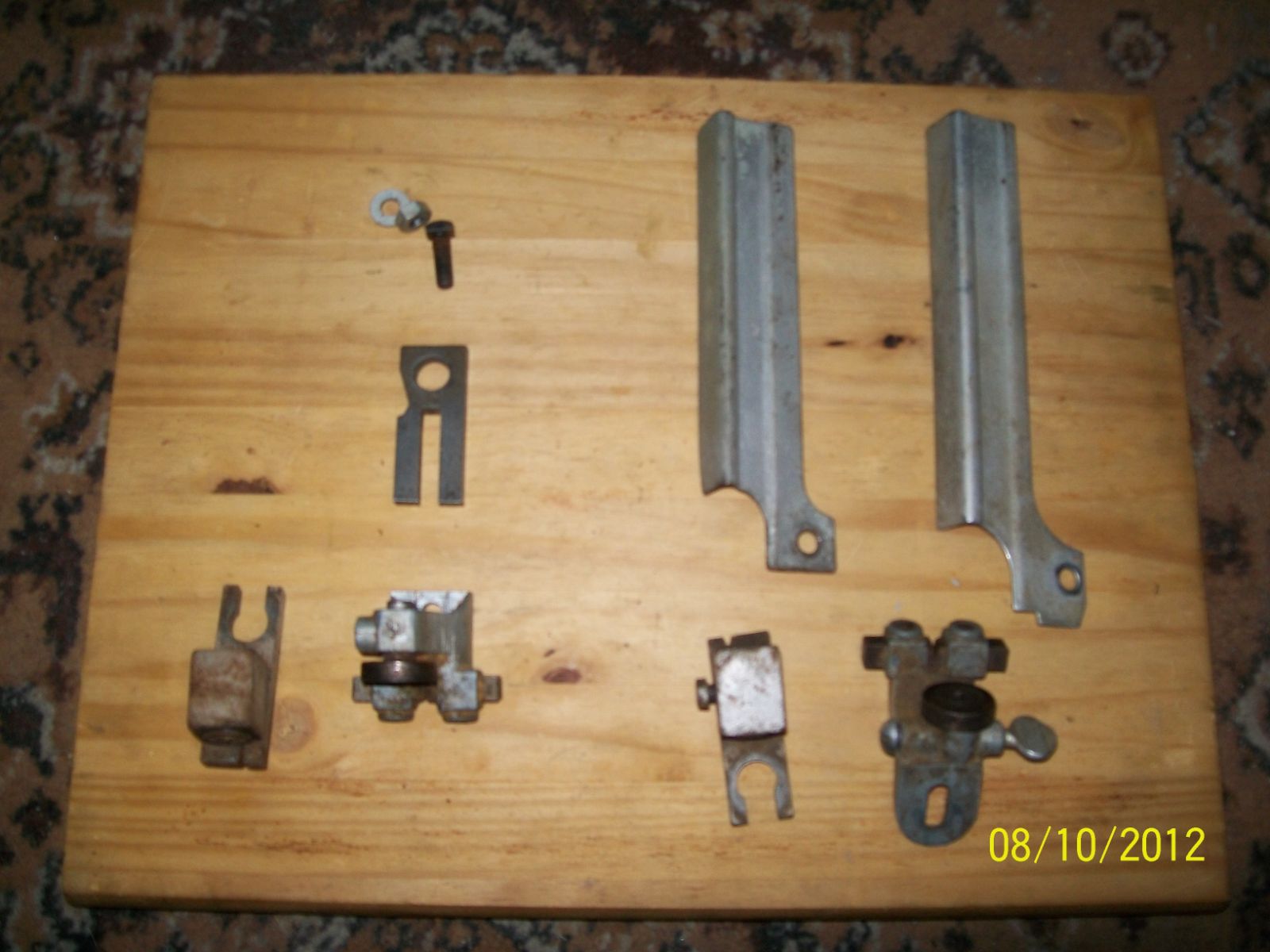

Either your saw has the upgraded blade guides introduced in 1933 or it dates from 1933-1934. After that the decal stated "Delta Mfg. Co..
The earlier guides had no side guide blocks. Below are photos of the earlier 1931-32 guides compared to the guides from the later model Delta Homecraft "Gumby" 10" band saw. They are very similar to the 1933-37 Model 785 guides. I see you also have the hard to find SBS-50-S Lamp Attachment Bracket. :TwoThumbsUp:
100_0560.JPG.7827e38d324eba0cd88986db07683f30.JPG100_0561.JPG.8d99befbf027d049b178e211137857a7.JPG100_0562.JPG.bb8d982bba5b70eda0913c7210980d3a.JPG

I’m looking at motors right now.. Do you think a 1/2hp 1725rpm Dayton motor from grainger would be a good option? More wondering about the 1/2 vs 1/3 hp difference.

1/3 HP is plenty for these small saws, but I believe the old motors were underated as far as HP.
