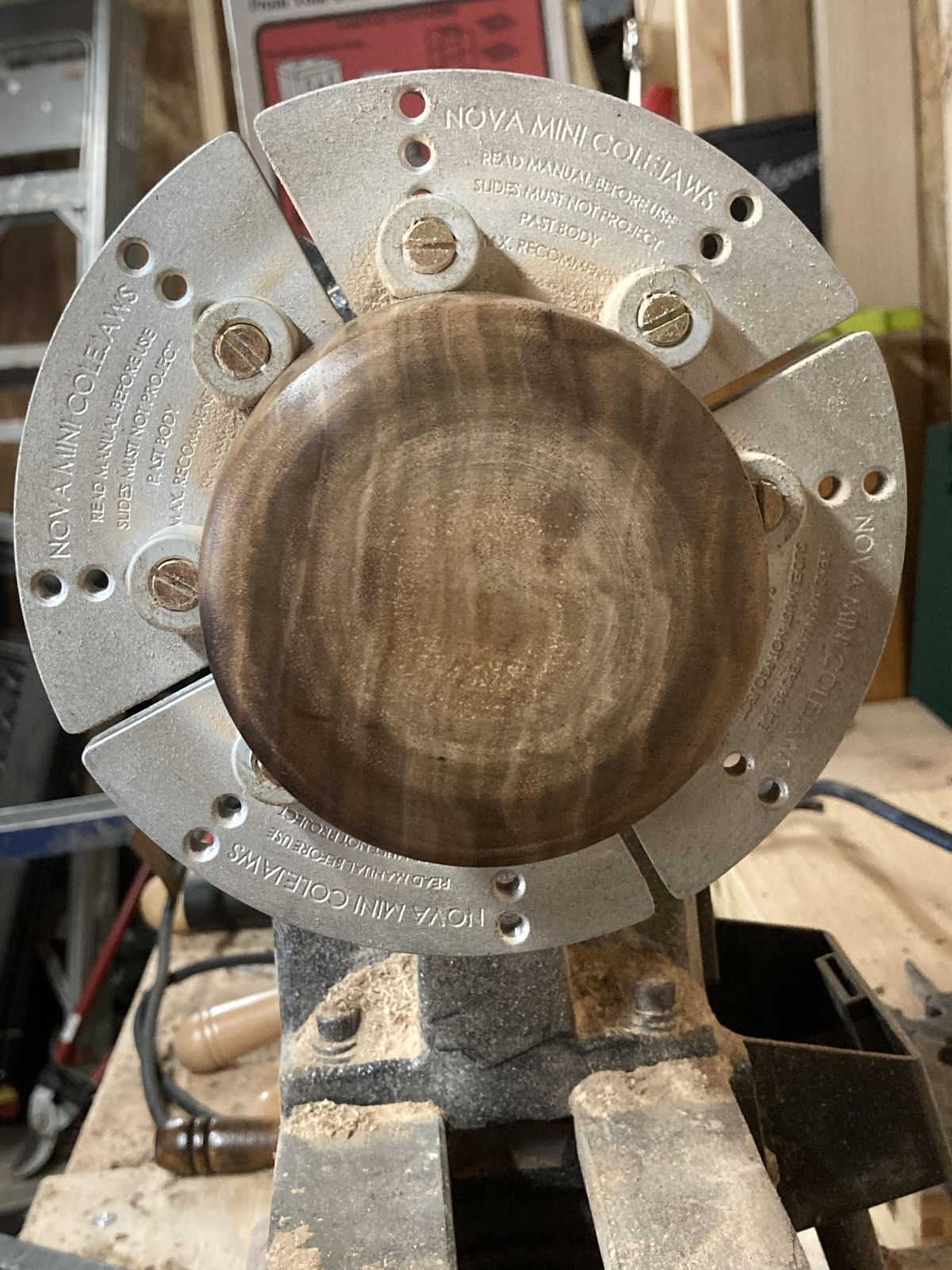

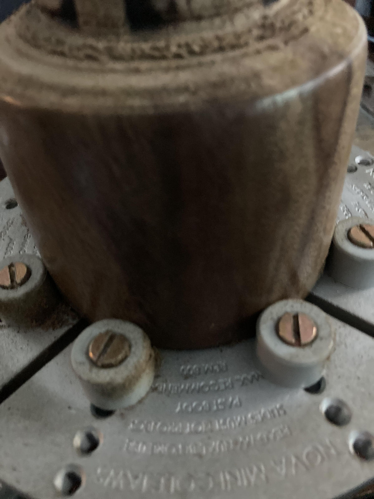

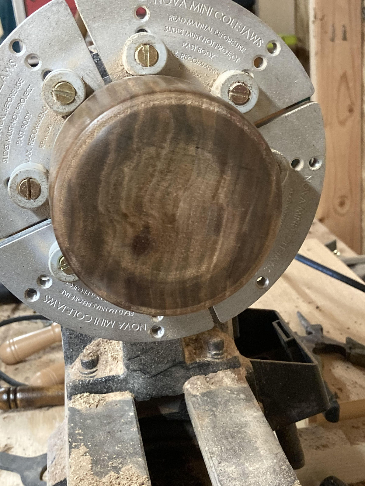

Yea this one I shaved off about an inch of the main material because I didn't want to have a large object I wanted a smaller one.  Which I turned down the tenon to fit nicely to the chuck.  I cut the remaining material off and tossed it.  Now just gotta finish it.  So hopefully I don't run into too many problems on hollowing.  I figured  Id do something while waiting for my much needed laptop to arrive LOL.  After years of not having one I finally got one again.
Edited by AndrewB
Something I have learned over the years is that I don't need, or want to turn down a large block.  Cut it down to close to the diameter you want and then turn.  Save the cut offs to be used later for smaller turnings and make a laminated piece.  I get alot of mileage out of my supply of wood this way.
Yea I've figured that one out now the hard way.  But its alright live and learn.  I'm going to more than likely be ordering more of the 6x6x3 blanks from now on and on occasion when I want to do something different maybe the 4x4x4 some of the ones I ordered weren't even square. More of a diamond shape.
Edited by AndrewB
One thing about your tenon- I always try to make a square transition where the tenon and the turning meet. This allows a nice firm surface for the turning to set on the top of the jaws.
Ah so no rounded corners then for the tennon.  Got it.  Yea I was trying something a bit different.  This one is also another test project for the cole jaws as well.  So once I get done with this Ive got to basically take the chuck apart and lock on the cole jaws again so I can try that out.

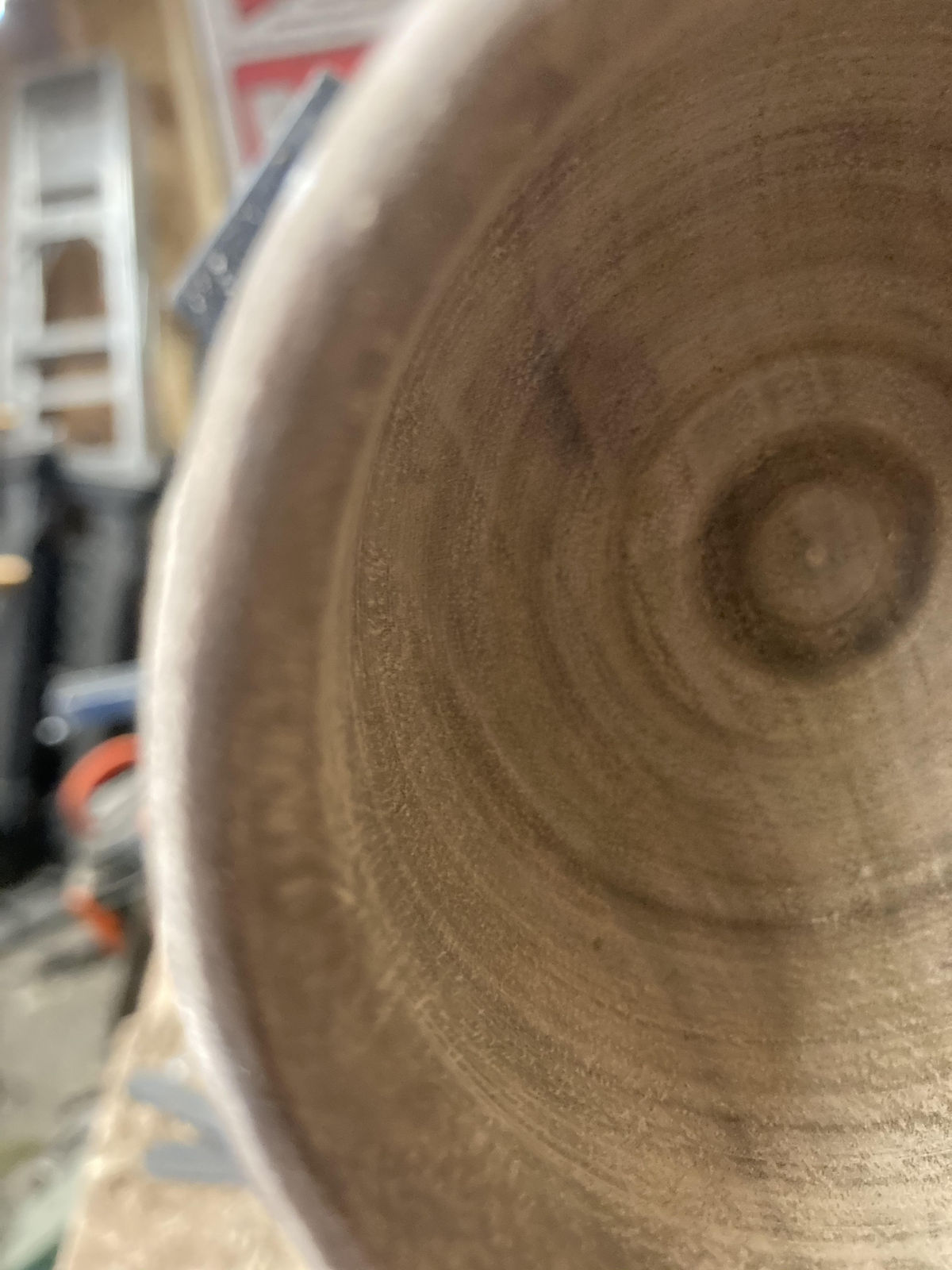

So I've been out working on this some more, got it hollowed.  I like the rough look on the inside with some of the lines.  It is sanded yes.  I actually managed to carve it down to almost t he bottom with some room to spare before I hit the tenon.  I went pretty narrow on the sides as well.  But I did sand the outside before I started hollowing the inside out.  It went quick.  But I like the way it looks.  It isn't perfect it isn't pretty but I like it.  Either way I think its time for some resin and varnish.  I'm seeing why all of you guys are saying POWER SANDER now, I get it.  I plan on getting one LOL.

Well this one is turning out quite nicely.  Bit of a MINOR problem how ever, my lathe does not seem to want to go below 800.  Not sure exactly why.  But I am a bit concerned about that when I go to use the cole jaws for cutting down the tenon and finishing off the bottom of the cup/bowl.  I'm not sure if it will be safe enough for me to even use because of those issues with the lathe.  Not too huge of a deal.
