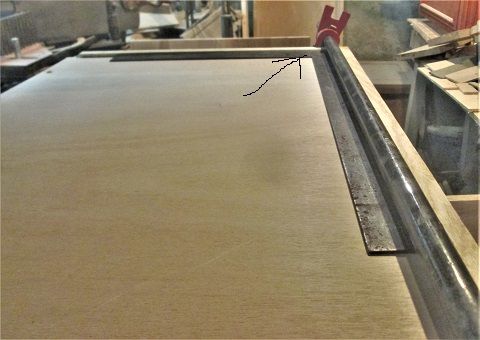

    Not a great day in the shop...rather expensive one, too... Panel came out of the clamps ok....ends needed trimmed a bit.. Square to mark a cut line... A little off, at the g

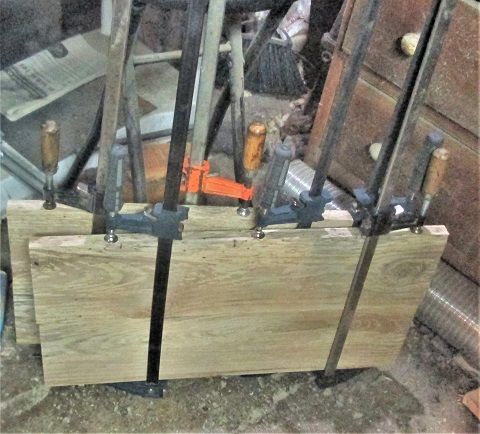

  • Could you at least let me get the glue dry and out of the clamps??

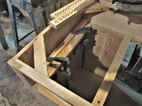

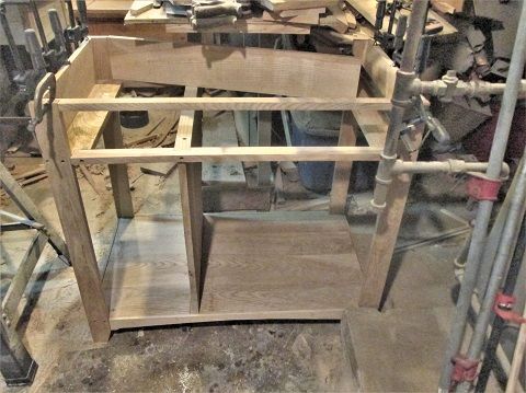

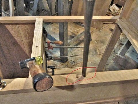

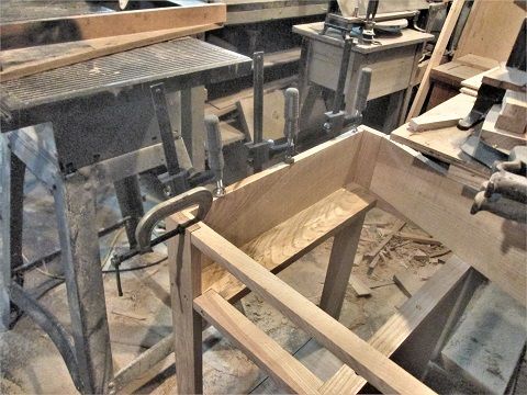

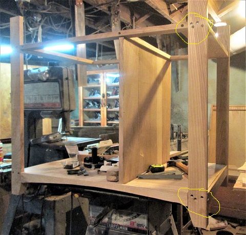

Had to repair some damage cause by the sub-assembly tipping over....onto the floor....both legs I had installed....snapped loose..:ArguingSmileys:
Then have one of the two snap both screws off..:BangingHead:.while moving it to the assembly table.:PullingHair:
(3 hours of screwing in the crowded shop, today..:DevilLaughing:.)
Got one web frame assembled ( still working out the details on the other..):ChinScratch:
Middle part is to attach the divider to the web frame,  wide ends also support the drawer as it slides in and out...will add guides later...BEFORE the top goes on...:OldManSmiley:
Assembly table?:WonderScratch:  I guess you could call it that..:o

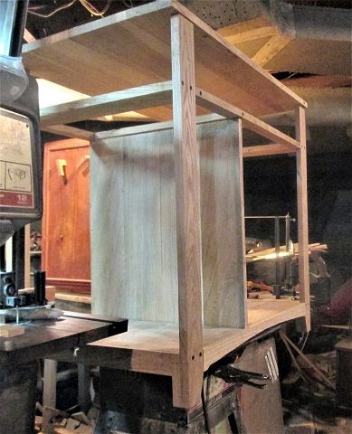

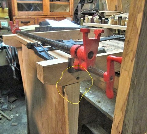

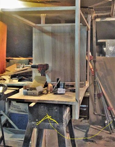

Divider was attached to the bottom shelf, via glue in the dado, and 3 screws from underneath the shelf...Frame was added.:TwoThumbsUp:...then more repair...:JawDrop:

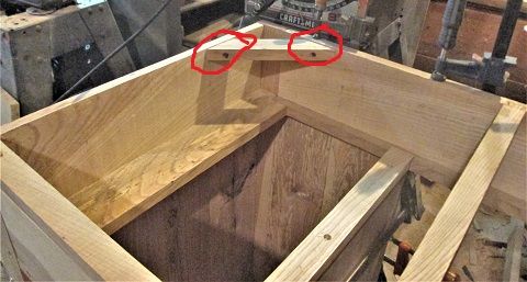

Where the circles are....snapped screws..:ArguingSmileys:.had to move the original leg to the other end..:BangingHead:.two of the holes do have screws in them.....Used BIGGER screws, this time around.:DevilLaughing:.Bottom shelf gets end caps...
Notched to fit around the legs...:ChinScratch:
Shelf sits in the rebate.
Had enough for one day...:OldManSmiley:.need to mill the other web frame, and make a few more panel glue-up....until then..:DevilLaughing:
Put a lid on it....:ph34r:
Stay tuned....:cowboy: ( and I wonder WHY I keep running out of booze..:o)

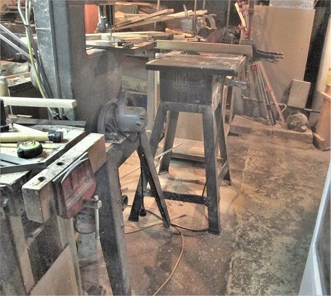

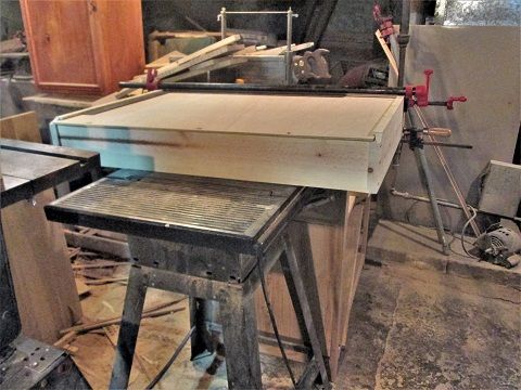

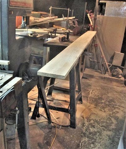

For those that complain about a small workshop...:o

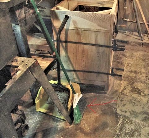

This is where I spent almost 3 hours, today...imagine trying to crosscut an 8' plank...:BangingHead:
I used that 6" Skil saw sitting there...there is a "large" assembly area...:DevilLaughing:
Gets a bit cramped, though...:ph34r:

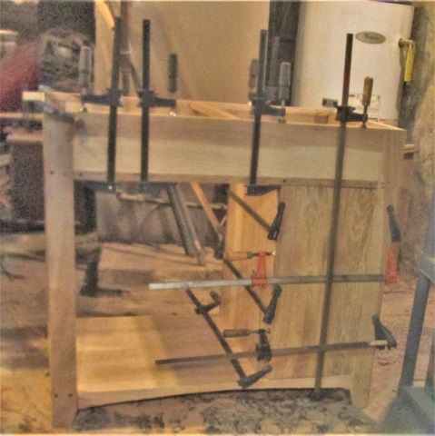

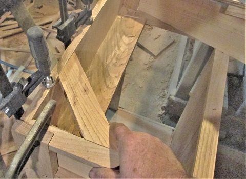

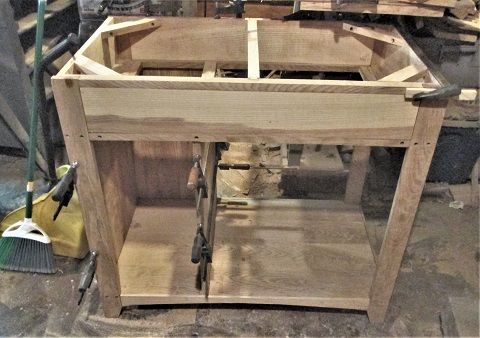

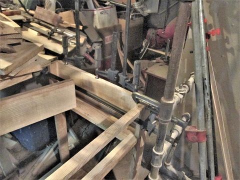

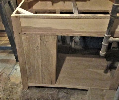

2 glue-ups going on here...frame's 1x was notch to fit around the leg, then glued in place...There is a 1x4 glued in-between the legs, and onto the lower webframe end, closes this end off...and

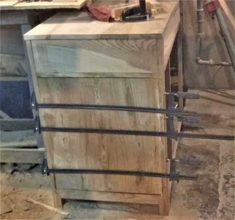

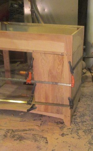

The end with the door compartment.   I also got the part for the back ..B)
and the drawer cut to size and fitted in place...will know more once the clamps on the ends come off.   Got 2 out of 4 corner blocks made...

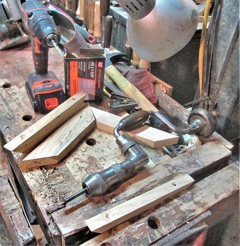

I use these to attach the top to the Island...B)
Like this. :TwoThumbsUp: Glue and a couple screws, then a slotted hole drilled....screw and a washer to attach the top.

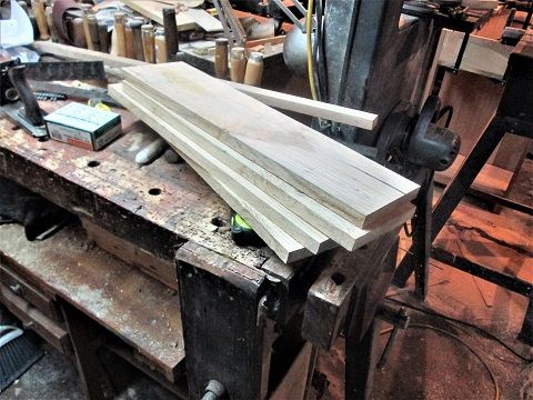

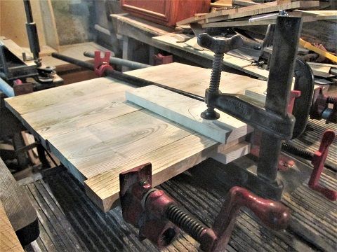

Last 2 planks hauled to the shop...the other 8' plank was cut into 4 sections..:ChinScratch:
Edges jointed, and sorted into 2 matching pairs....and glued into panels...:TwoThumbsUp:
Best looking of the two will be the door, the other will be the back of the compartment..:ChinScratch:..the last plank was cut into 3 pieces...a filler strip added..
And this will close off the end of the compartment....once it get squared up...:ChinScratch:
Where the circles are....snapped screws...had to move the original leg to the other end..
Drywall screws?   Bad choice for furniture.
https://www.familyhandyman.com/woodworking/using-drywall-screws-for-woodworking/#:~:text=Countersink bits&text=Wood screws are better than,they're screwed into hardwoods.
Worked for Norm...:DevilLaughing:

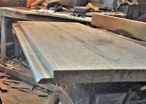

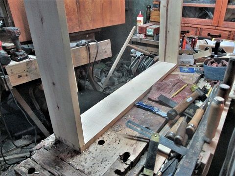

Ok, one panel came out of the clamps, wanted it off the tablesaw, anyway..:BangingHead:.By the time it had been flattened  on one face, both ends squared, and one edge trimmed for width...might as well install it...:ph34r:
Glued to the legs, is all. B) Then since I needed a couple of the clamps on the narrow panels to do this glue up...Squared the ends, ripped for width, but...
It also needed a rebate....as a place to add some glue...:ChinScratch:
As it wraps around the divider. :ChinScratch:

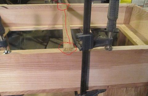

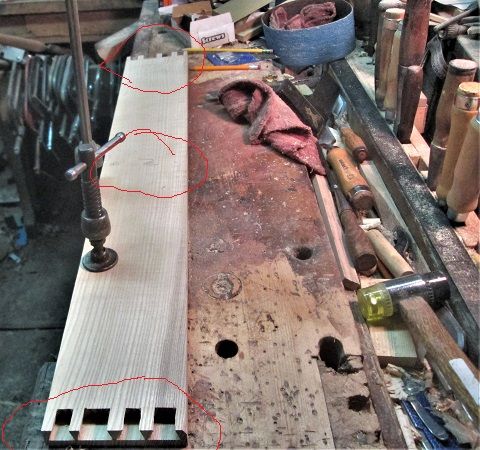

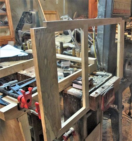

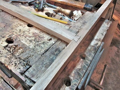

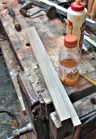

Then some chopping was in order...To attach a kicker between the front rail above the drawer, and the panel for the back...hand tool time!:TwoThumbsUp:
Both the back panel and the drawer front blank were trimmed for length....Dovetails connect the kicker to the back and the rail...Back was set up in the bench vise,,B)
So, when I glue the back in place...I can also install the kicker..:TwoThumbsUp:

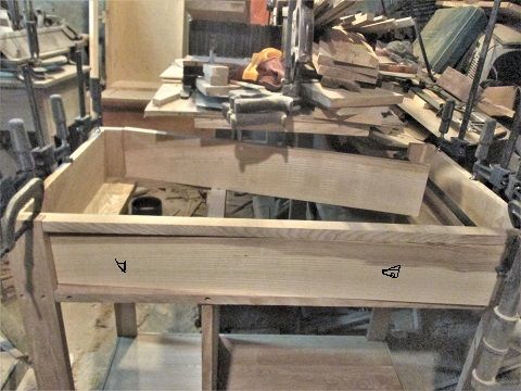

Too many clamps?  :WonderScratch: Kicker details?:ChinScratch:
Drawer slides along under the kicker, keep it from tipping down when you pull the drawer out...:TwoThumbsUp:
Still not done..:BangingHead:..corner blocks...2 more were made, then all 4 were drilled and counter sunk...:ChinScratch:
Brace has the counter-sink bit.  Then glue and screws...:ChinScratch:
And work my way around to all 4 corners...:ChinScratch:.

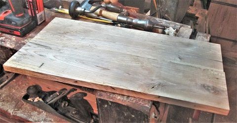

Set the blank for the door on the bench...:ChinScratch:
And that was it, for today....:OldManSmiley:

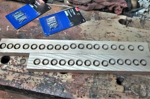

And, made 32 plugs...just have to match the grain patterns to the holes...

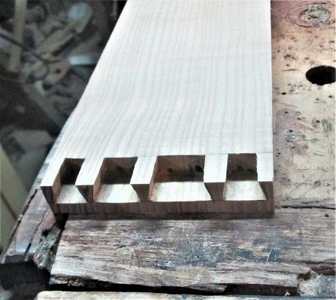

Then a bit of "Pins First"
Might as well do the other end, while I'm at it..
Then the tails to match...

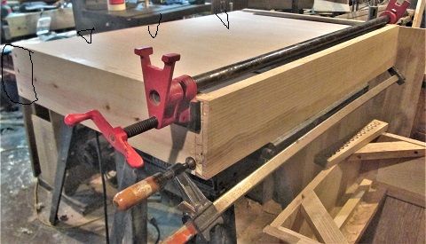

Drawer is assembled, squared up, clamps , screws, and glue applied....:TwoThumbsUp:
Once the drawer was checked for square, 3 screws attached the drawer bottom into place...:TwoThumbsUp:
