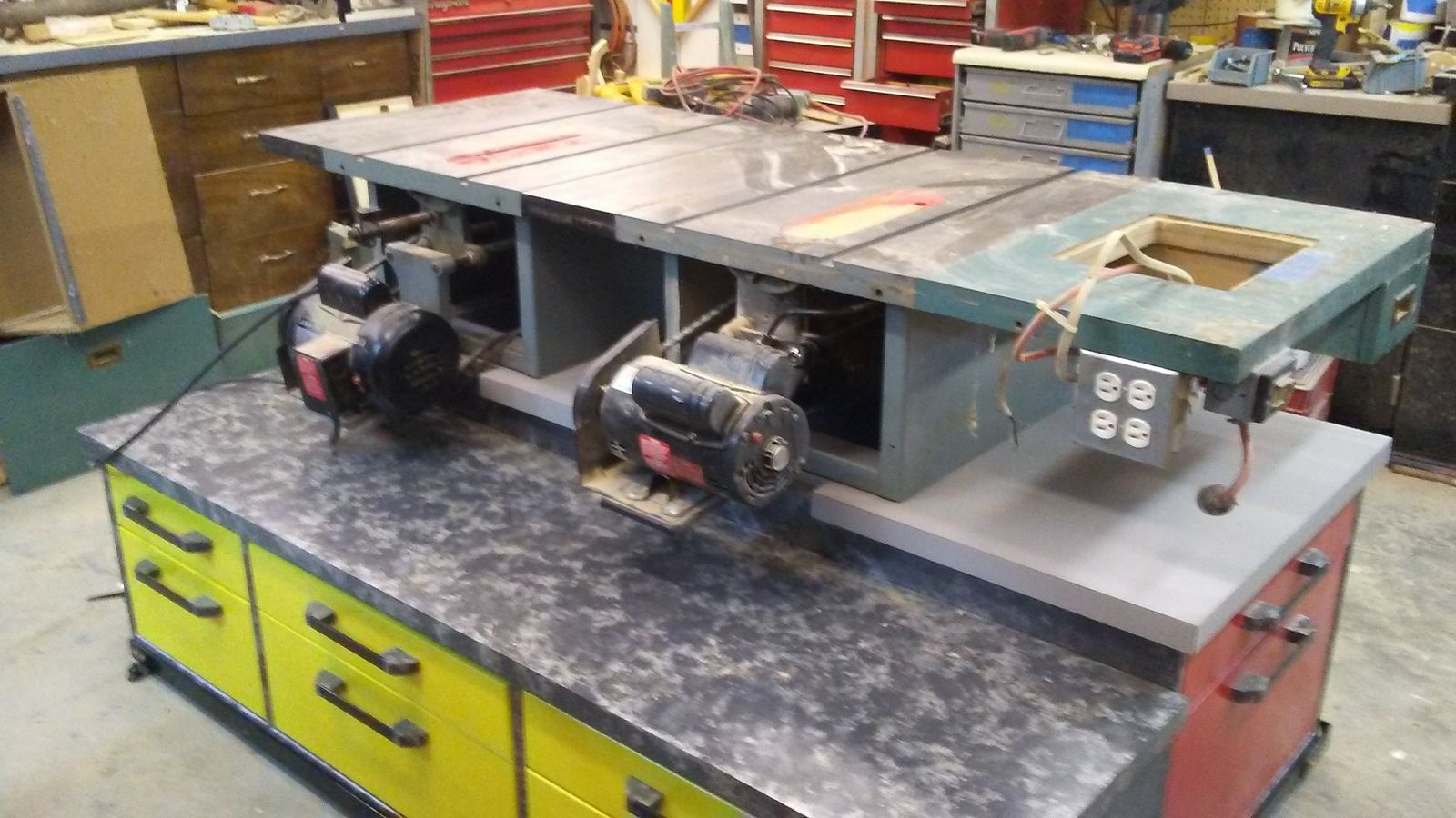

This is set up

  • The bases I sent went to these two saws. I made a custom one for this set up.  Made in America.
No input on the link belts, but i really like that TS setup!
The bases I sent went to these two saws. I made a custom one for this set up.  Made in America. :D

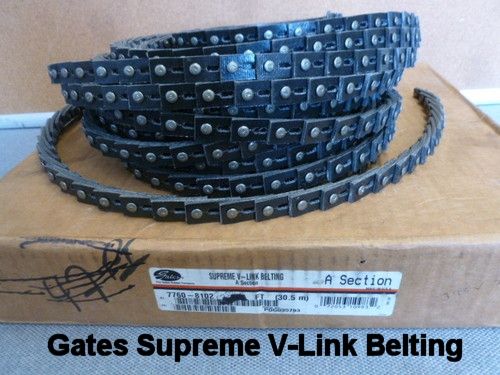

I don't like the plastic... This is the only good kind... Not cheap...
I searched for this and found zip.  Any ideas where I can get some.  Need 8 feet maximum.
E-bay....

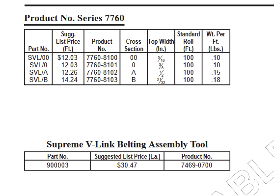

There is an opportunity for you Gunny.  Woodcraft want $50 for a 4 foot piece.  You can get the whole 90' for $125 shipped.  I would buy a 4' piece for the $25 - you end up with 86' for the price of 8!
Does anyone know if that is the right size (width, depth, etc.) for general use. I couldn't get any info in a search.
