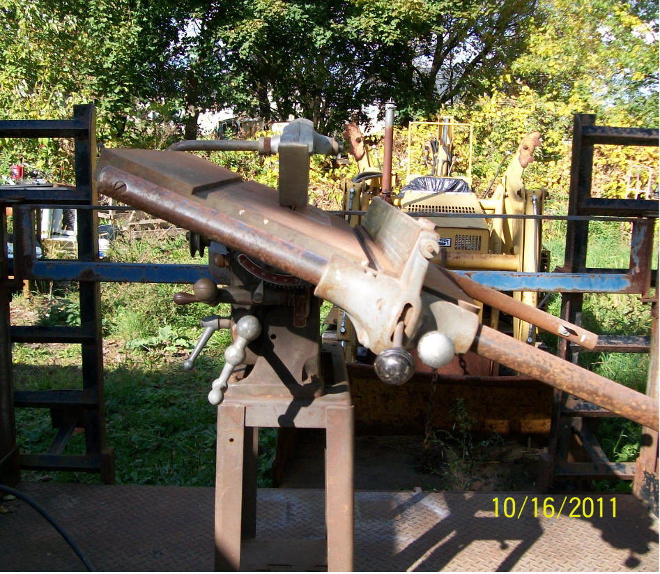

:ChinScratch:...3 sheds, my shop trailer, 4, or is it 5 machines in the truck, plus a few I've got hidden in the house the wife doesn't know about. Might be more.
You know how it is .
When you pick them up for little $ or free it usually takes a couple three to get enough parts to make one complete machine.
I can pretty much guess what was broke on the "Tilty" you parted out. The front trunnion.
The belt guard I spotted in your photos belongs to one of these.
I hate to part out/scrap mostly complete machines, but some of these have to go!

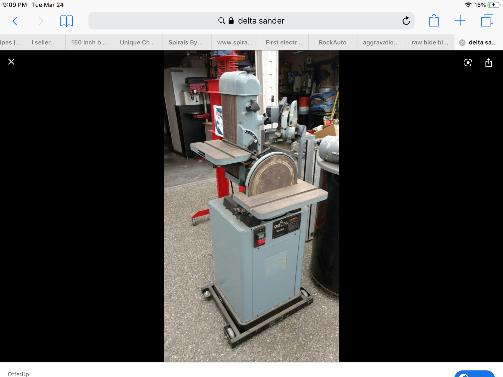

I don’t have one, but would like to find a sander on the order of the one in the picture for the shop. I haven’t lucked into one that I wanted to afford but haven’t tried too hard either.  I like Delta tools because they tend to show up and be reasonably affordable if one is patient.  The sander has simply eluded me.
Some of my stuff is slightly newer but I don’t mind if the price is good.  I usually clean them up to use, so not really a purist collector.  This one I drug home from the scrap yard.  Had to tighten the belt and fix a fuse connector in the control box and it was  off to the races.
I like that mobile base you have the jointer on.  Did you make it or did it come with the machine?
I occasionally see sanders such as the one you pictured up at auction.  Check out the woodworking tools on govdeals.com ; some decent deals can be had.

I don't have one of the belt/disc sanders myself, but I do have the sanding disc and table attachment for the lathe.
I've thought about making an edge belt sander attachment for a drill press.

I made the base from 1/8 wall square tube, some light channel iron, a little flat plate For the machine to rest on, and garage sale special rollerblade wheels.  Not in view is a pipe lug that fits a lift handle with two slave wheels so I can steer like a rudder.  I can set the lift  end on a piece of scrap plywood to get to pretty level and they do not roll away.  It can be a bit top heavy so I do have to be careful.  Everything was scrap and repurpose so the welding rods were the biggest expense.  I have several of these made to move the bigger stuff.  As for govdeals, I have been there a time or two and almost won an air compressor on there last year.  Love the site.
