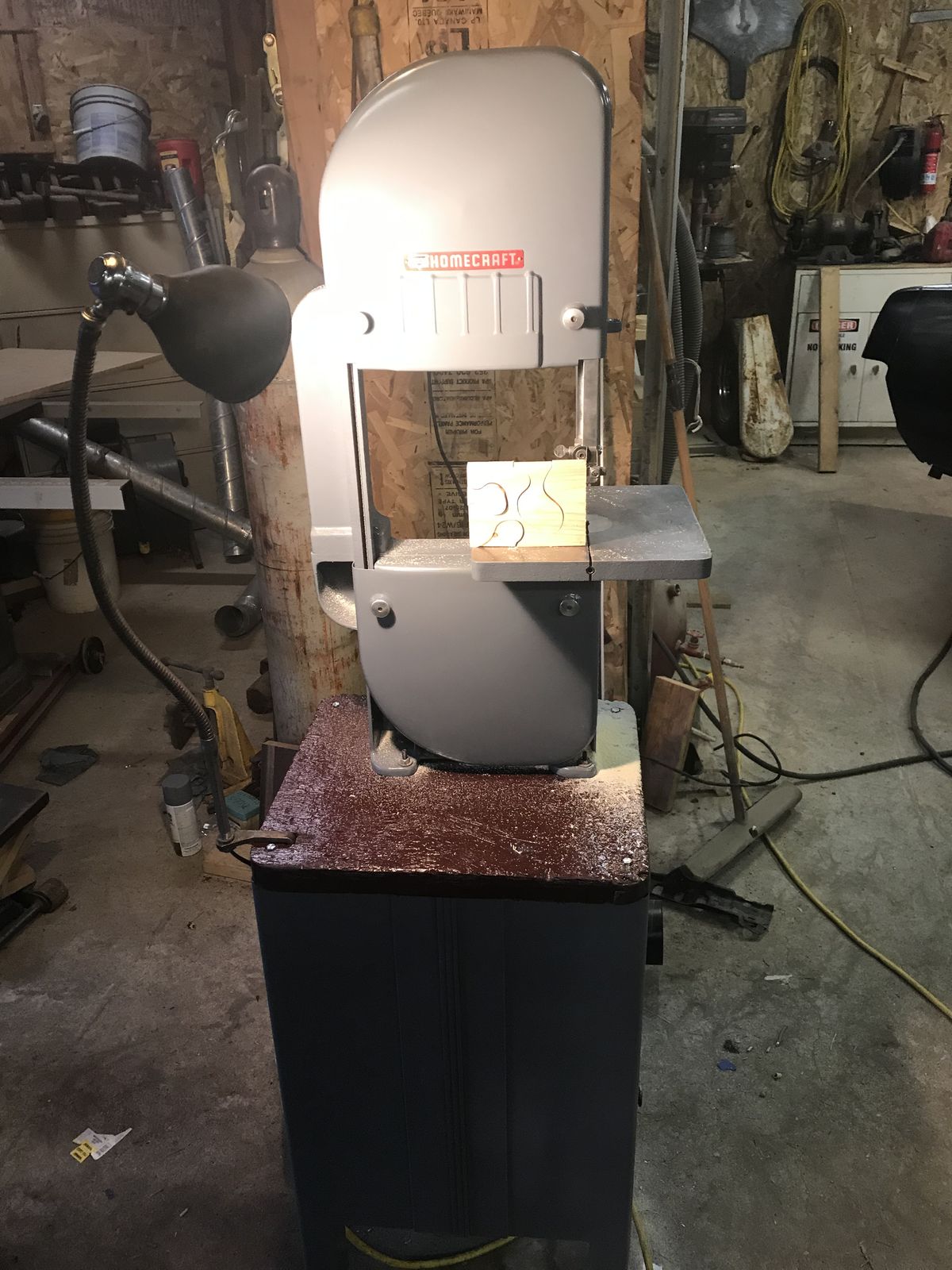

  • All done!  Tuned and adjusted everything and made a few test cuts tonight. Seems to track very well, even with the old blade.  I did add a couple washers to get everything coplaner and it’s happy!  Th

All done!  Tuned and adjusted everything and made a few test cuts tonight. Seems to track very well, even with the old blade.  I did add a couple washers to get everything coplaner and it’s happy!  Thanks for all of the nice comments on this one.  It’s been awhile since I tackled a power tool.  Enjoyed this one a lot.  Picture is kind of poor.  I should have killed the light, I guess.  Sorry for that! 533C7D07-6FBA-41F3-9EB0-844E84D687F1.jpeg.9f8065b13b09a0424fe164be98adeb7d.jpeg
Did you use the same base?  Looks brown in the picture.
I did use the original base in gray and shot the original plywood top with brown.  This photo just kinda sucks!  The work light really messed with it but it was the only one I took so ran with it.

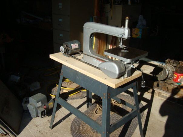

:ChinScratch:...Looking for the Homecraft scroll saw that goes with your "Gumby"?
Edited by Larry Buskirk
Does this make you an enabler?  Lol...I did one of these for my dad a few years back. He still has it.  These are nice project tools.  Do you deliver?  😜

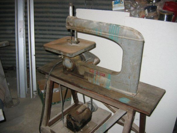

Before and after!

:ChinScratch: Am I an enabler? :WonderScratch:
I'm more into the earlier 1930's, early 40's Delta machines myself.
I got this Homecraft in one of those have to buy two machines to get the one I wanted deals.
:ChinScratch:Delivery? ...Quite possibly, I'm located about 5 miles north of the Ill, WI state line about 2.5 miles west of I94.
