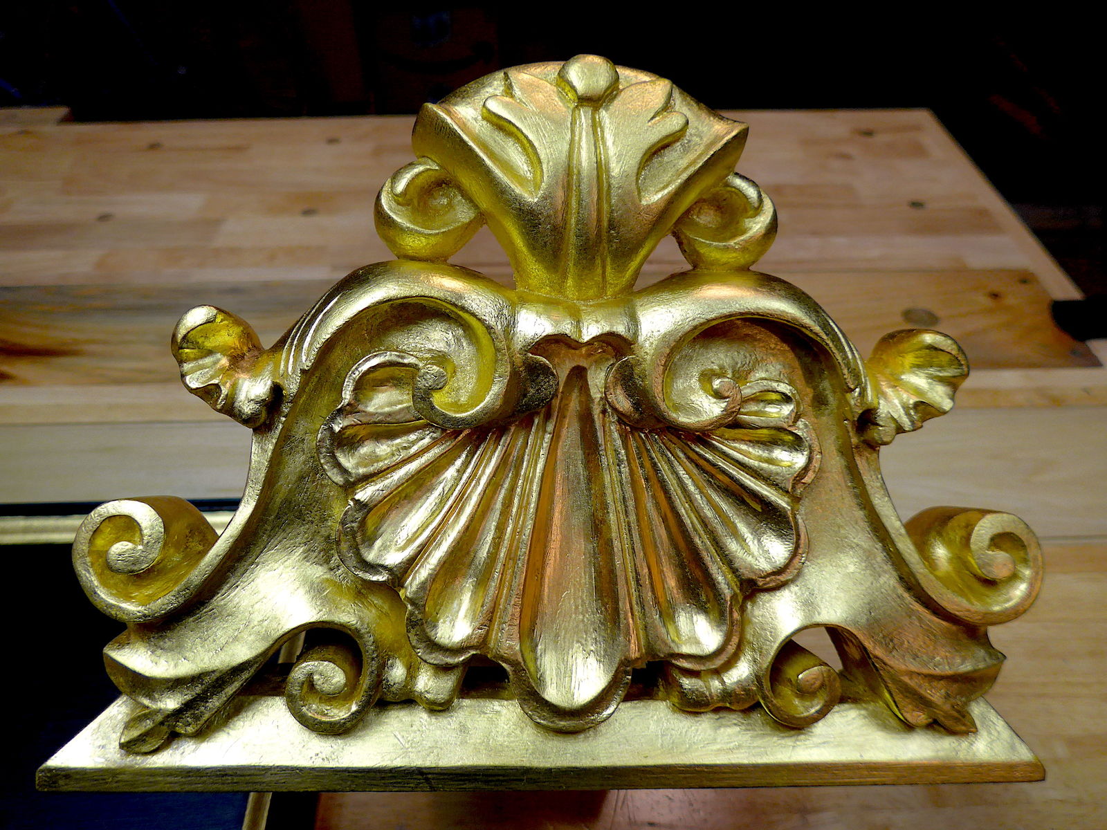

Gene, thank you for the gracious complement. Not to spoil the completion of this shell, I'll show you something similiar that I did from a 3-week trip to Spain/Portugal. The original shell was photographed, high up on a wall, in a Synagogue in Toledo, Spain. The first photo shows the gold leaf applied but not "set in". The third photo shows the gold leaf "brushed" onto the surface. The second photo shows everything completed. You can also get an idea of how the plaque/shell will go together.747233953_L1080052copy2.JPG.cd1428ce105415b7d69d958f5e4616f9.JPG

Here's the first coat of gesso for the plaque and the shell. I'll apply a second coat and let everything dry well before attempting the gilding.
I've started to gild the shell/frame and realized that I shouldn't have given the shell a second coat of gesso. You can see the brush marks through the gold leaf..... no way to reverse this unless I wanted to strip everything away and begin again. The photos show how the gilding process goes, from laying down the gold leaf to pressing it down into the sizing. I'm doing this in stages because I'm not sure of how much gold I can lay before the sizing sets.  I'll try to "burnish everything when the sizing is completely dry. The plaque is done except for some needed touchup to the paint.L1010484.JPG.76cbe4c63b9bf69dea6ce7e8a9ff3231.JPG
Looking pretty darn nice from where I sit Frederick.  Your technique with the gold leaf into the smaller details.  Are you simply laying it in and then rubbing off the excess?
Thank you Cal. My technique for the smaller details is to lay down a sheet/partial sheet of leaf and then use a soft brush to "push" everything down. This is repeated as necessary to fill the details. I try to keep the "crumbs" in the applied area so that they may do some more filling in. My next step is to carefully brush/tamp down the leaf. I really don't do much rubbing, except the flat surfaces, because that will remove the leafing from the high spots.
Painting/gilding completed. Tomorrow, I'll attach the shell to the plaque and hang it on the wall.L1010490.JPG.7fbbb16b1ce3cb017c5a0af631da35cb.JPG
