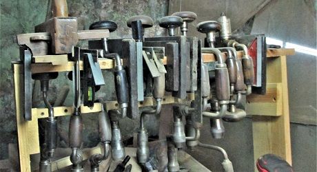

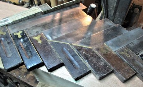

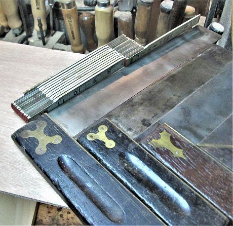

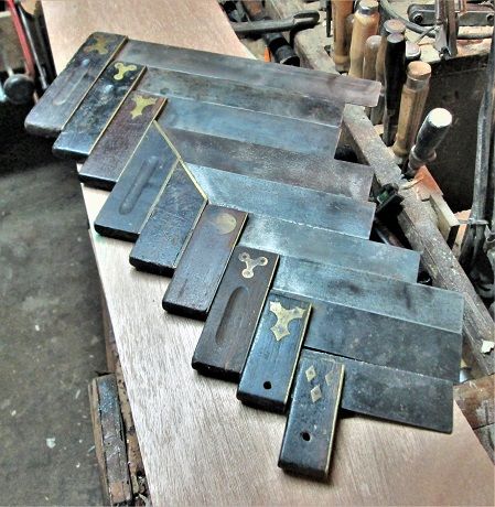

September 29, 20197 yr Author Popular Post comment_203202 Quickest way to get a framing square out of square......just drop it....ever wonder why some of the older framing squares have "dimples" where the two arms meet? A center punch is used to correct said dropped squares back into square....count the dimples, and figure out how clumsy that Carpenter was.... I do have a place to stash most of the smaller squares.... Hard to see, for all the drills in the way. I laid out the better ones... Big one at the top...Stanley No. 20, 12" square....the wee one is just 3", and was in my Dad's toolchest.... Big one will go all the way across a 12" board, BTW.. And, since most 1 x 12s are about 11-1/2" wide.... There are two miter squares/try squares.. One without the grips has Stanley Rule & Level Co. stamped on it. I think I'm set, as far as squares go... Report

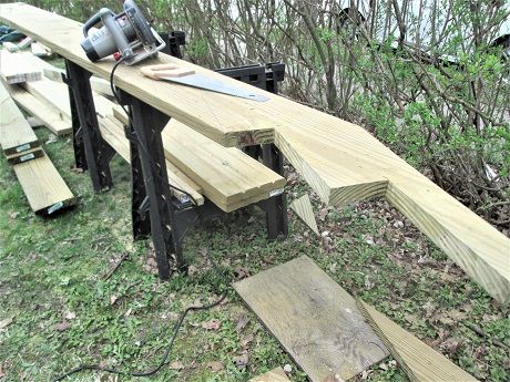

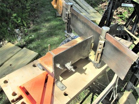

September 29, 20197 yr Author comment_203213 Porch project...last May... Bought a new square...after checking it at the store At least, it helped mark these out... Speed square that I picked...and a cordless Mitersaw... Report
