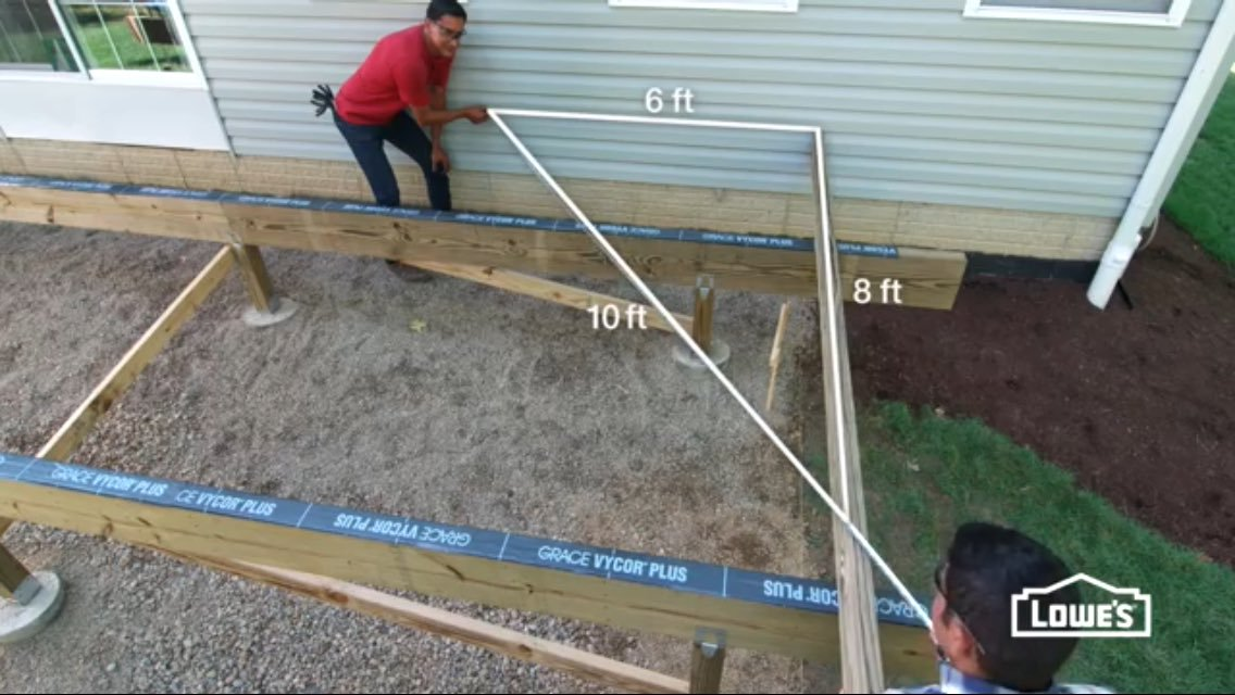

September 30, 20197 yr comment_203296 For the larger projects the 3-4-5 method is a good way to check square and can be increased to 6-8-10 when the project gets bigger. Report

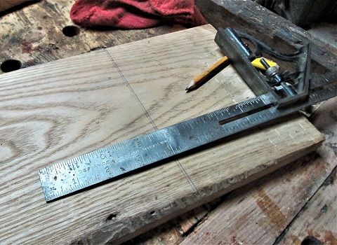

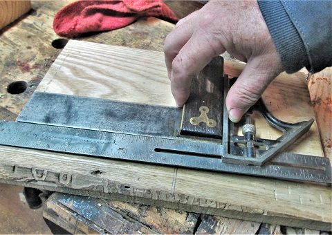

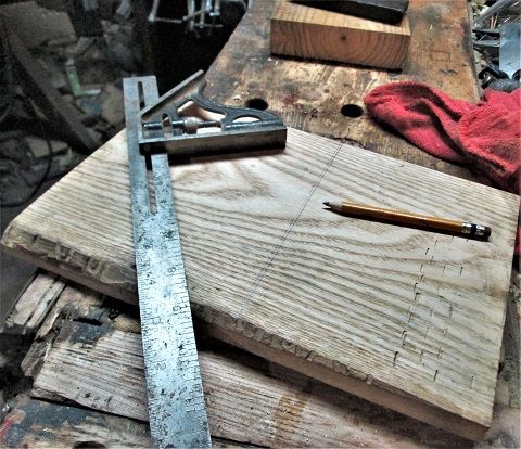

October 7, 20197 yr Author comment_204284 Decided to "test" out one of the combo squares.....a 12" Defiance by Stanley No. 122 same as before. Have a jointed edge on a board, make two lines....mark one, flip the square over, and mark a second line beside the first... IF the "gap" is the same all the way across....should be square....can also double check.. needed an extra hand....one end is up, the other laying on the board...but..no gap. Use these type of squares more for..striking a line along an edge....to mark where a groove would go. Can be used to check a depth setting, too. Note: on the ends of these type of squares, you will usually find a notch.....that is where a pencil would go, to mark a line....remember to either use the notch, or not....but not both, as the line without the notch will be different from the one made with the notch... Edited October 7, 20197 yr by steven newman Report
October 7, 20197 yr comment_204287 Steve, I know about that notch but, don't ask me how I know! Report
